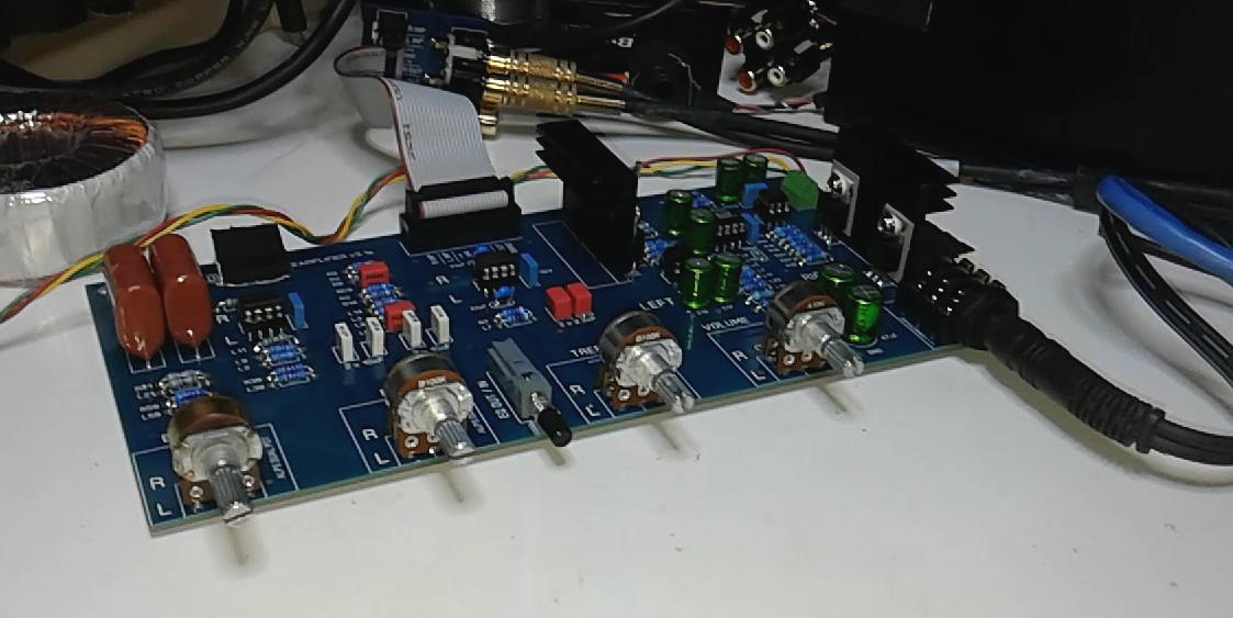

Adding EQ to Whammy
I started my Whammy experience by ordering a PCB from the DIYAudio store. I built it up exact to spec. And I really liked it! Kudos to you Wayne for such an elegant design.
Being so happy with the headphone amp I decided to experiment with Whammy as a line level preamplifier. I transferred Whammy to a PCB layout of my own making and added my favorite rendition of baxandall tone controls. I added a switch to bypass the EQ from the signal. I moved the power supply off board and was able to shrink the PCB to 100mm x 217mm.
I am very happy with the results and will continue with my experimentation.
