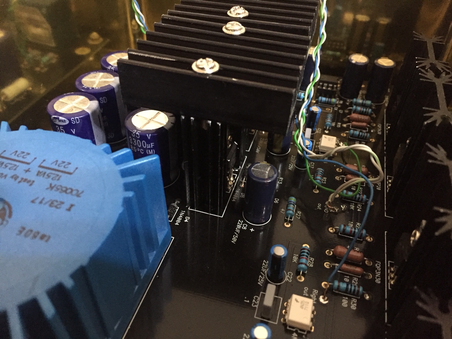

The power regulators get hot upto
58’ C here in Delhi ...unless with proper ventilation...I may have to drill lotta holes just above them in the chassis
I experienced the same thing kpsthakur. I'm about to switch to 2x18v transformer to reduce the voltage difference. Should help a lot with the heat. I'm sure I'll find another project to use the 2x22v on.

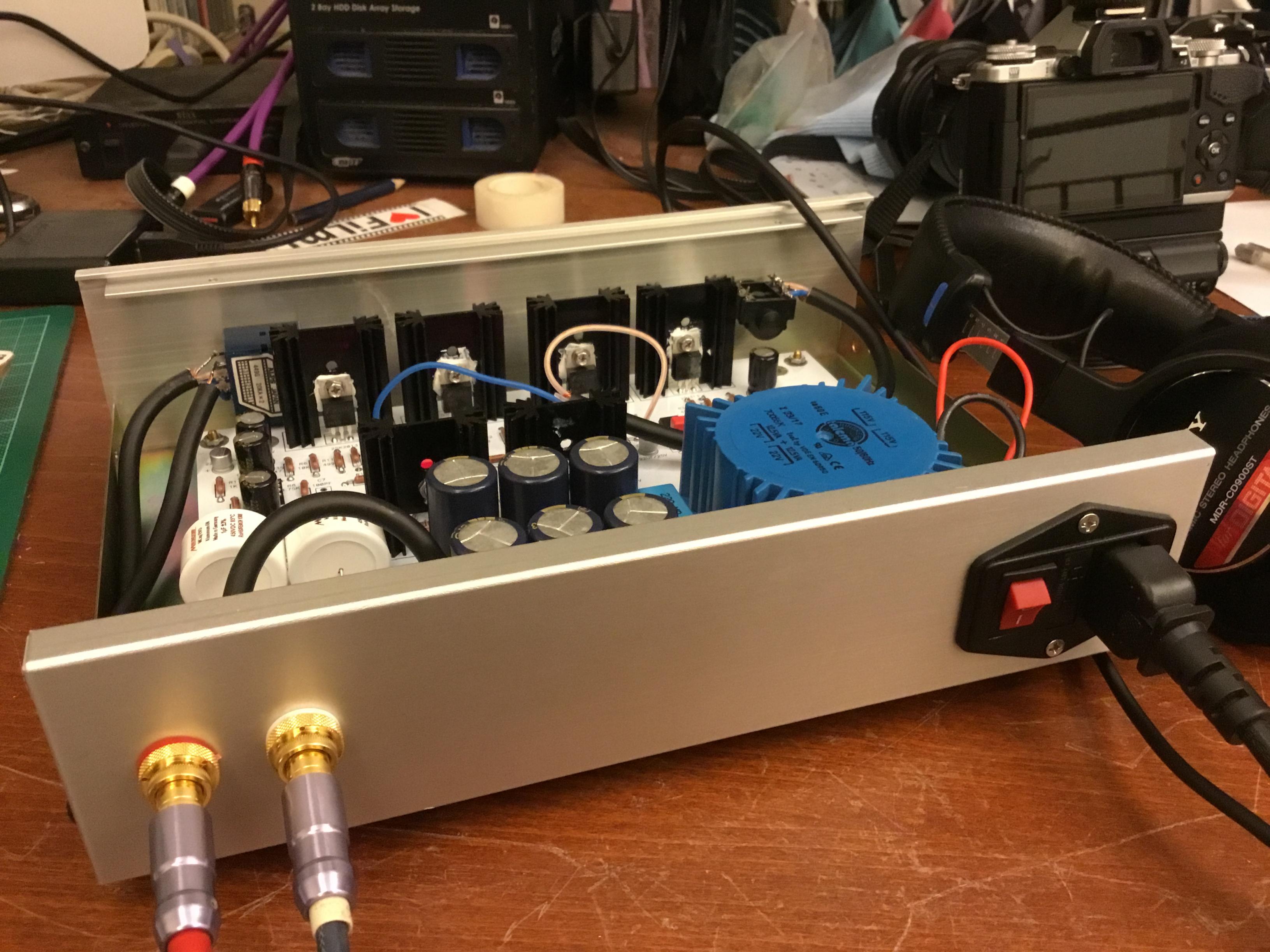

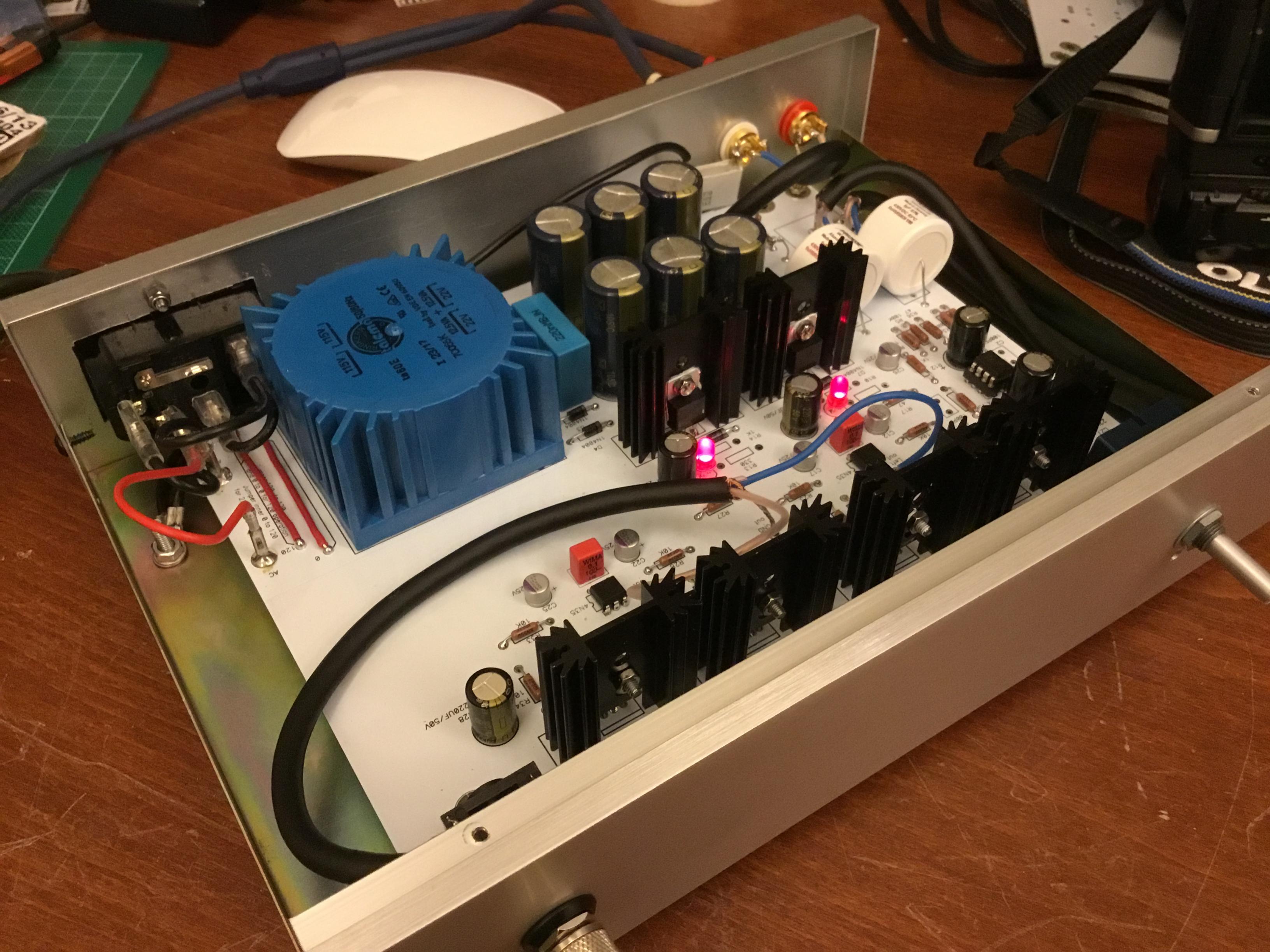

Another one in the wild. Bias set to 112mA. 2SK2013/2SJ313 output devices. LM4562. Sounds awesome, thanks Wayne!

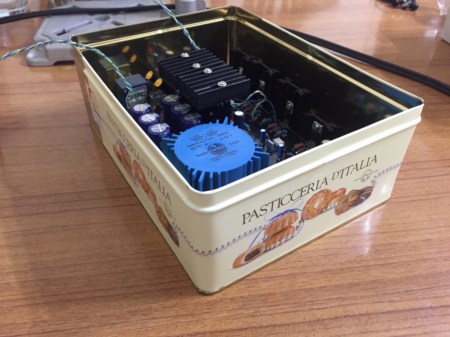

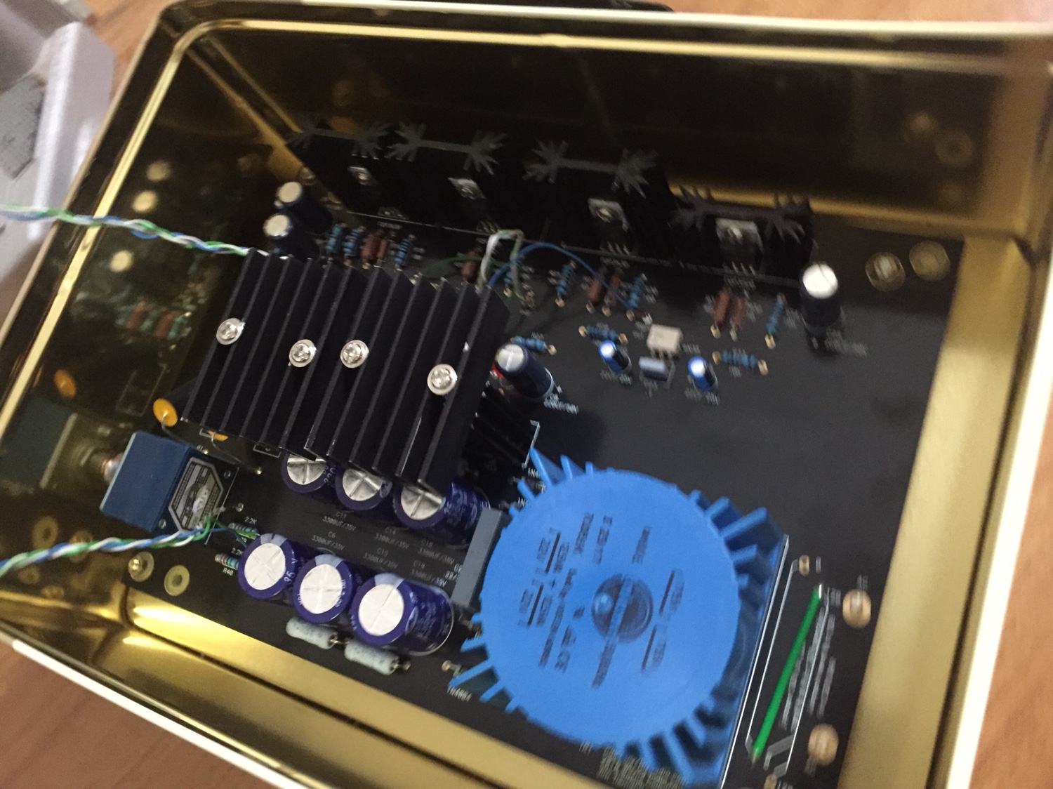

I am going to set this up in a cookie box, which is a perfect size match....
For the power supply IC’s modded the heatsink, looks awefull, but the average temp after 3 hrs of play is around 48 C, output Transistors don’t go above 43 C in my setup

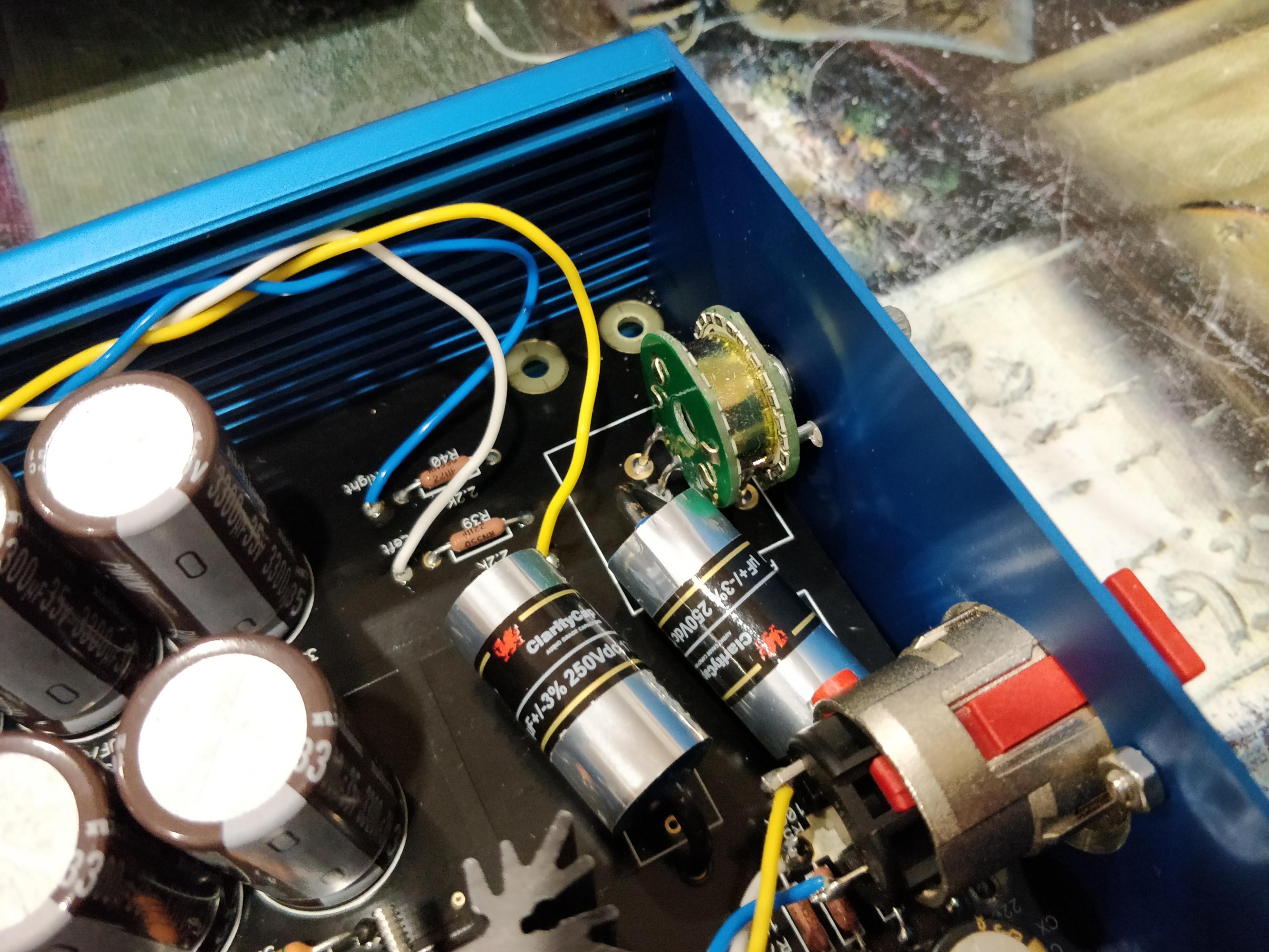

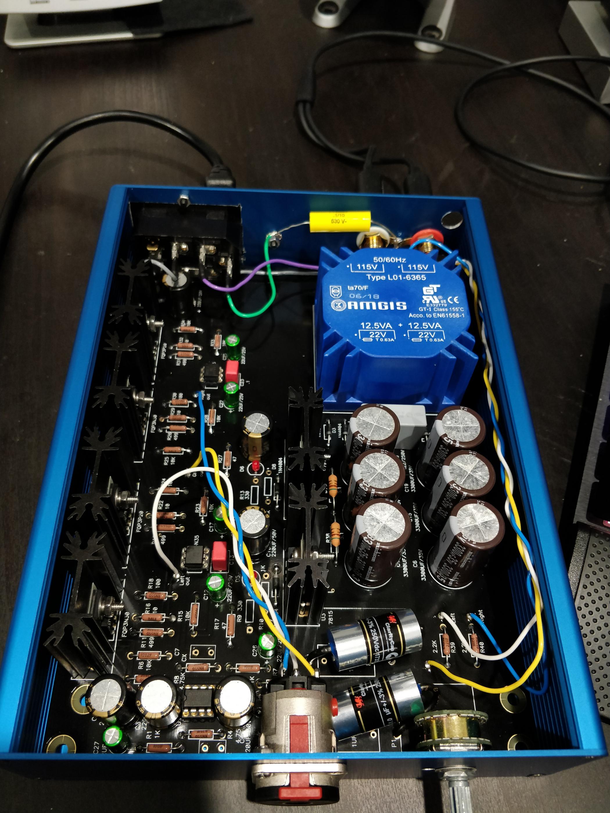

I have done my WHAMMY with LM833 opamp, FQP FETs, 60ma bias, 20KA pots.
The sound quality is awesome. Thanks Wayne.

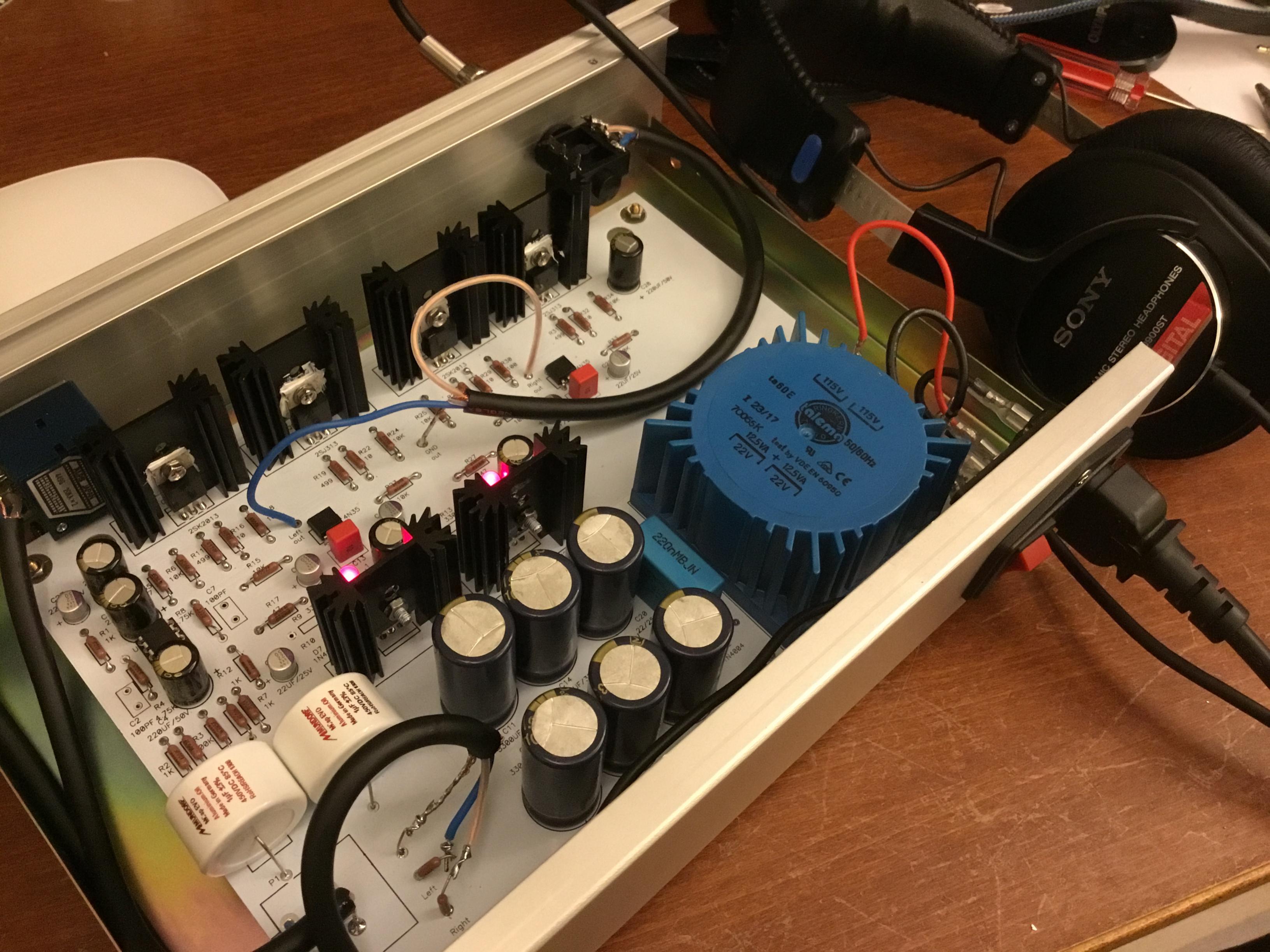

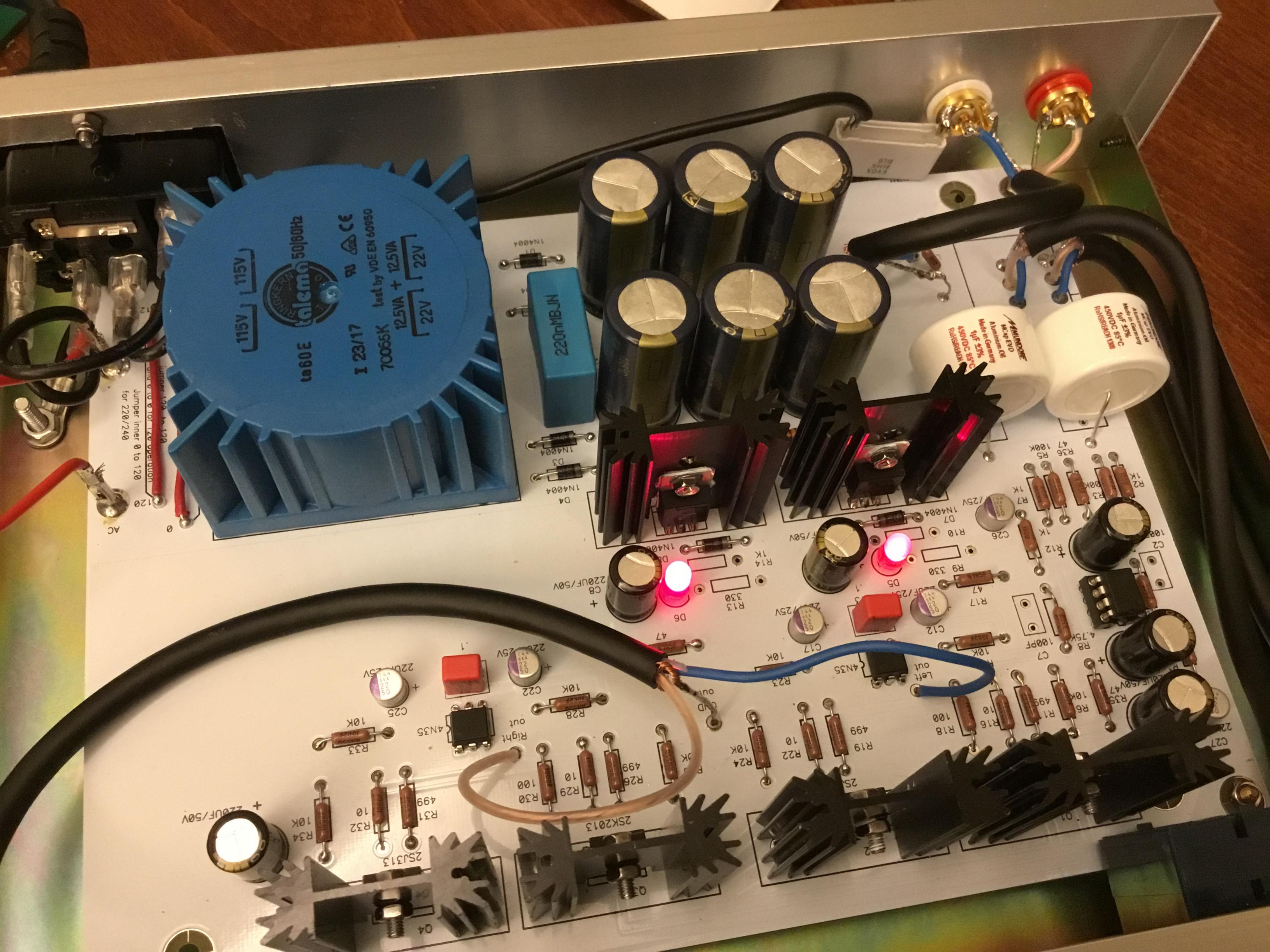

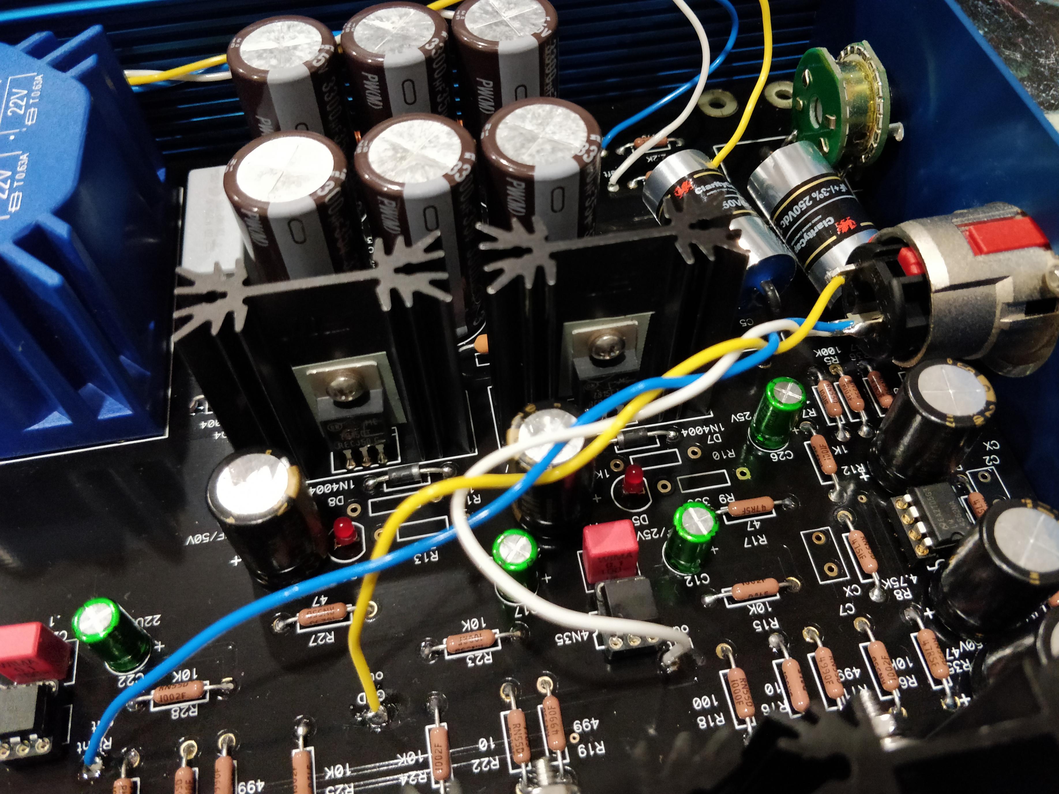

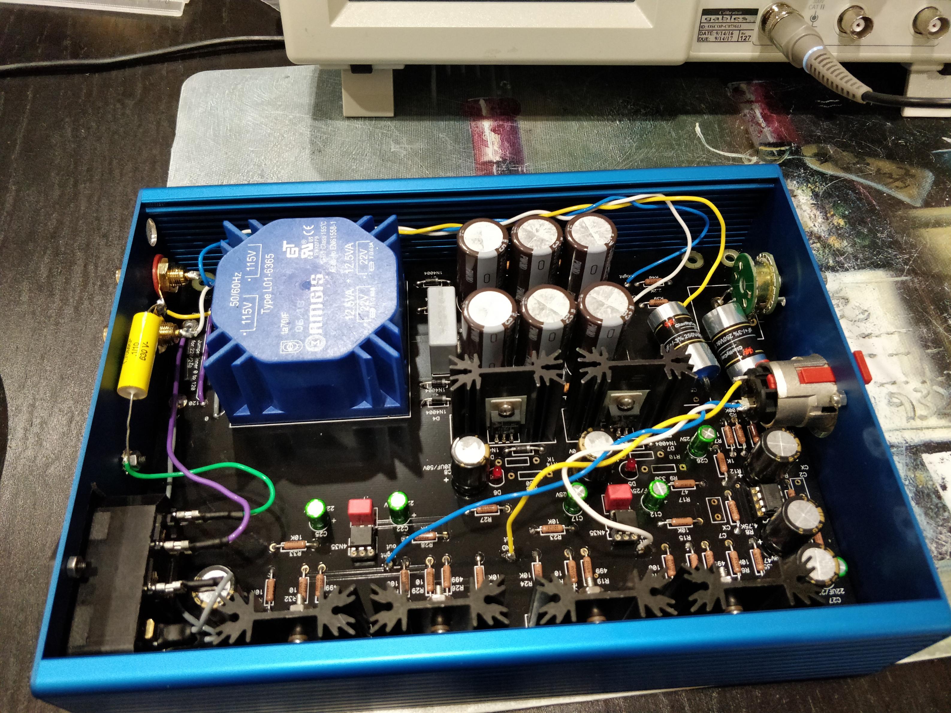

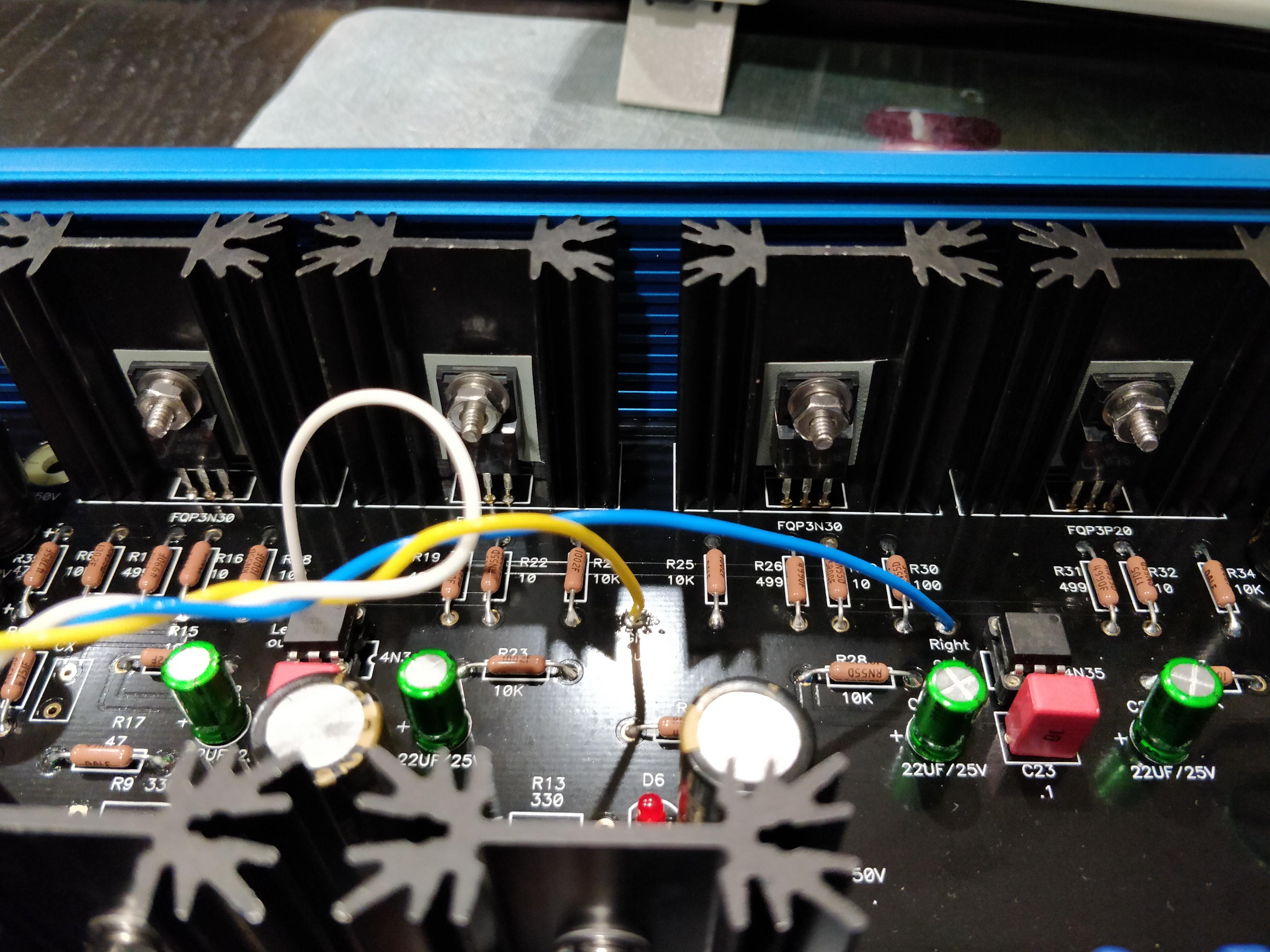

I may have messed something up, while changing the voltage regulators... the 7918 side gives -19.3V and the LED is lit, the +ve side has got some issues...the output is -7.65V post regulation...this is not right...I have changed the regulators twice (7818's), but the issue remains the same...it could be the diodes or if I have fried the LED or something else...not made any other changes to the circuit...any suggestions

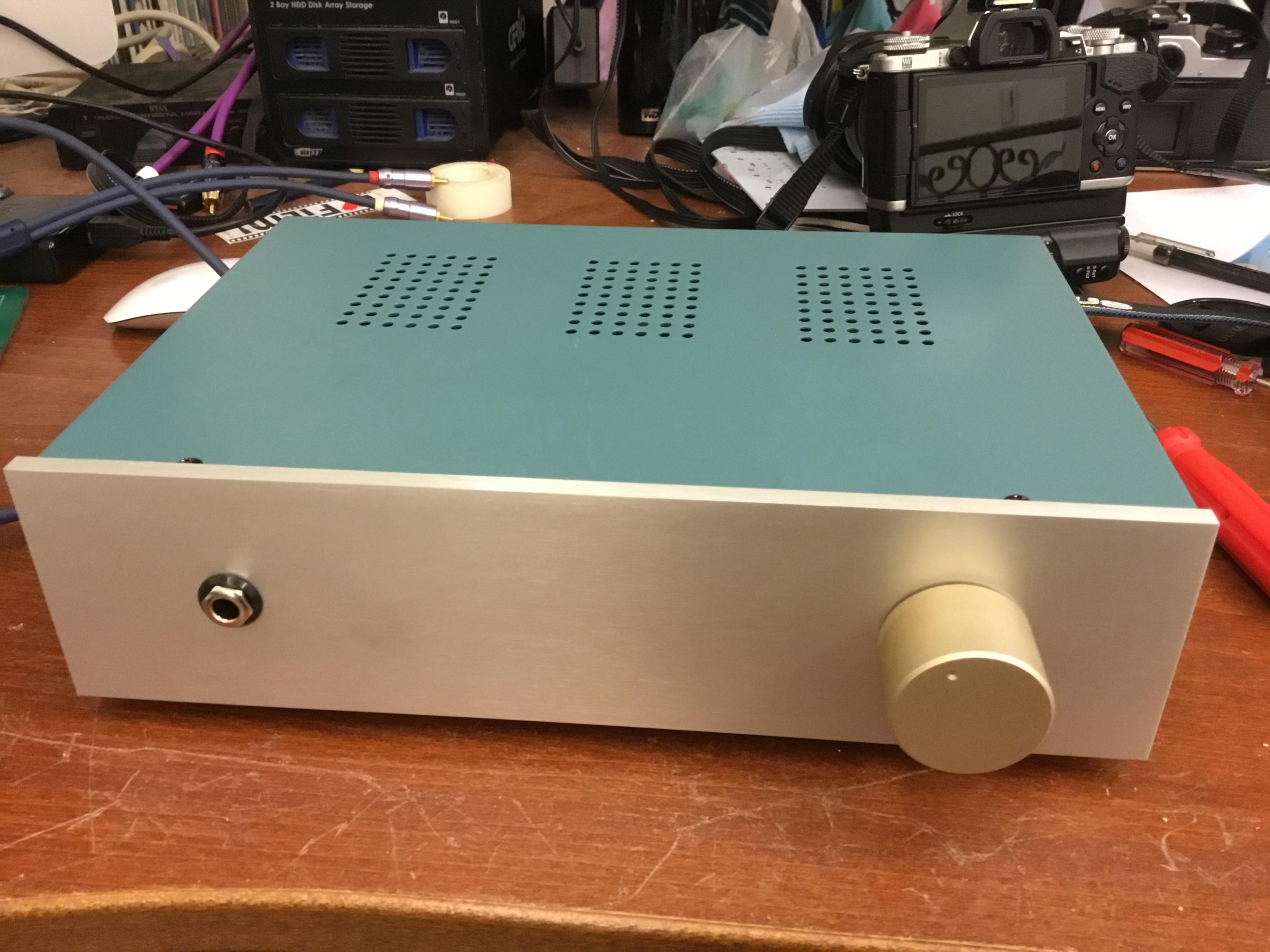

YesNice routing on the wires and the chassis. White board solder mask?
I ordered 10 boards for around USD$100 here in Taiwan.

Resolved
Busted LED...replaced (getting soldering off took almost 2 hours), all is good now....board back in the box now & singing.

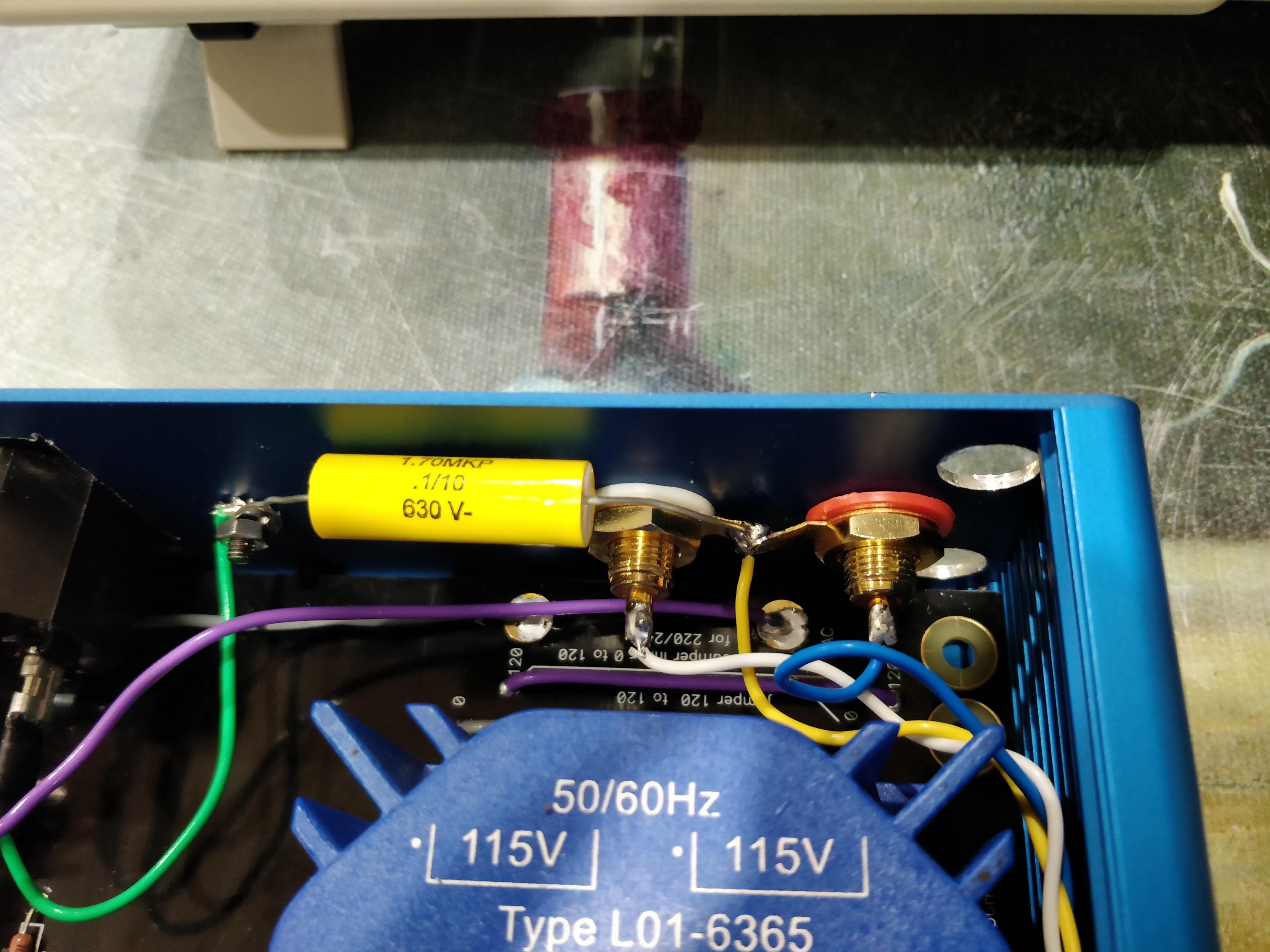

Although I am using shielded cables and twisted to ensure no crosstalk or interference, I feel a very very faint hiss when nothing's playing. Also a power up/power down thump has arrived...none of this bothers me much but would definitely like to troubleshoot. I am grounding the input jacks via 0.01uF cap
- Voltage on pin three is a big clue. Something in the circuit is putting a - voltage on the output of the regulator.
