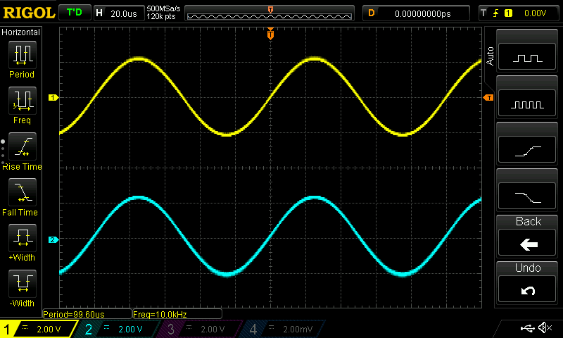

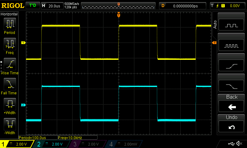

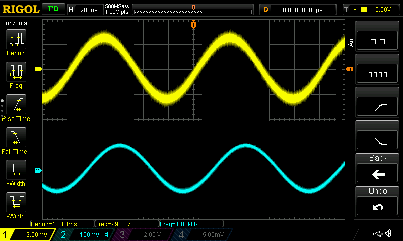

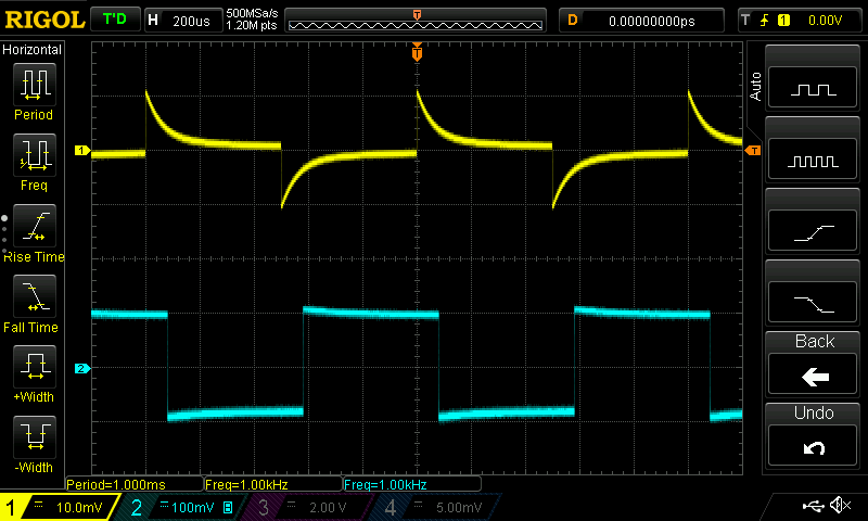

Hi Guys,

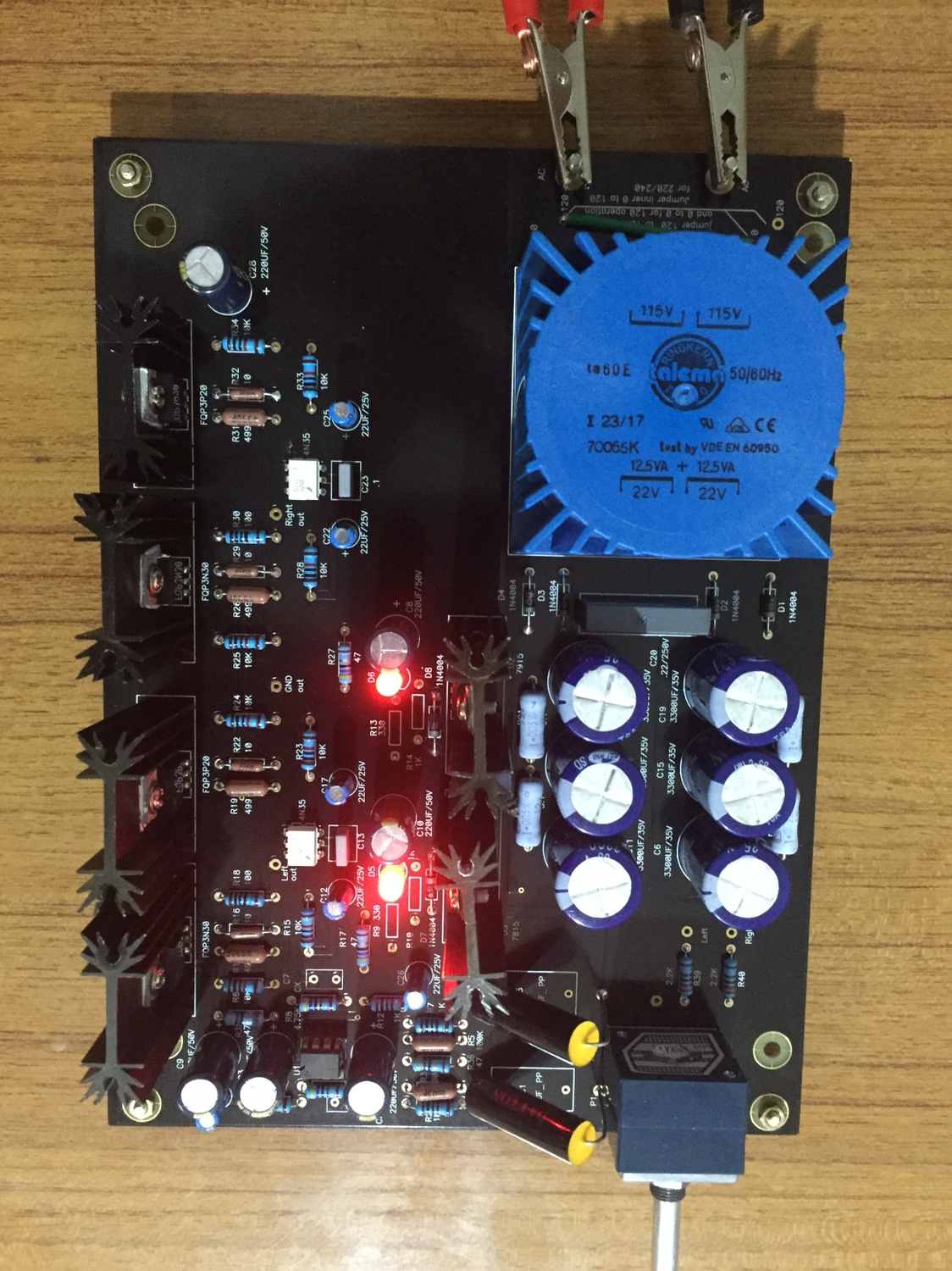

Need your help just finished the Amp and there seems to be something wrong my Right Channel. My Voltage rails are fine +16.7v & -16.7v. However my right channel is not putting out much power at all, and its square wave looks sick...

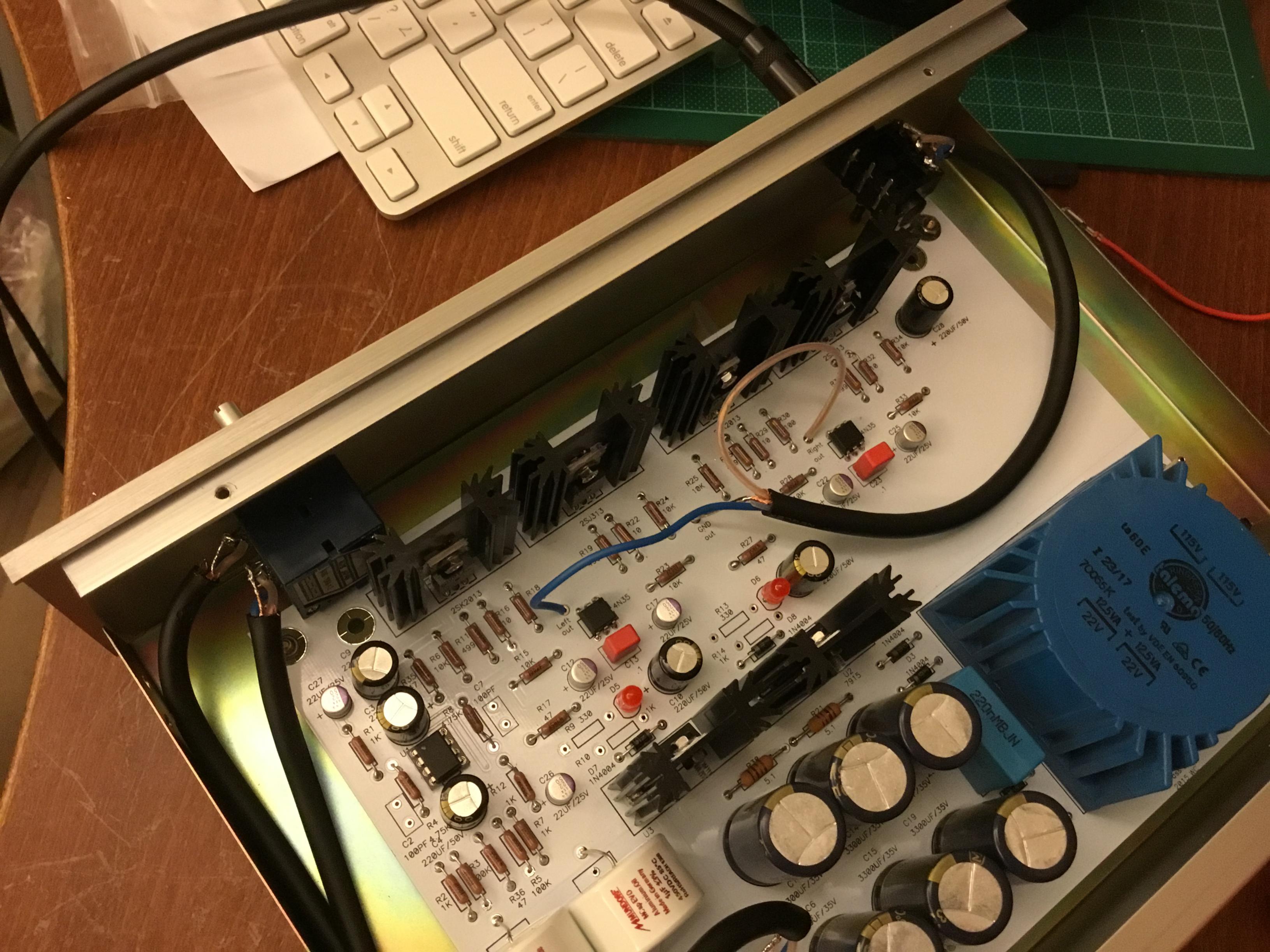

The only non-standard thing I have added is a feed from R10 & R14 to the v12 LED (power Switch) with a 4.7K limiting resistor on the R10 +V link side.
1Khz Signwave 1vp-p Right channel is ~2mV and Left is 100mV
1Khz Squarewave 1p-p - Right channel is 10mV and Left is 100mV
Any ideas where to look next, could this be an issue with my OP-AMP its a Burr-Brown OPA2134PA without the 100 pF caps.

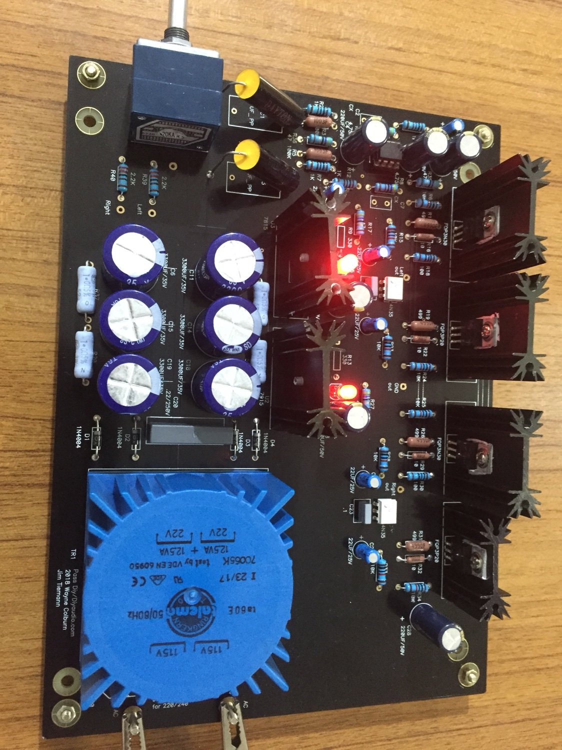

I almost finish my WHAMMY with previous version PCB. Hook up the power socket and wire and I am done with this project. I tried to connect the power everything seems fine. I hear no noise of any kind. Just wondering if I have to install the capacitor between the negative of RCA and ground.
False alarm all good.
Ok I found the issue, I just noticed a hard to see x10 switch on the CRO leads, I must have knocked one to x10 rather that x1, I guess what threw me off was the dodgy looking square wave, Doh.
So now both channels look good and the square wave looks right now 🙂

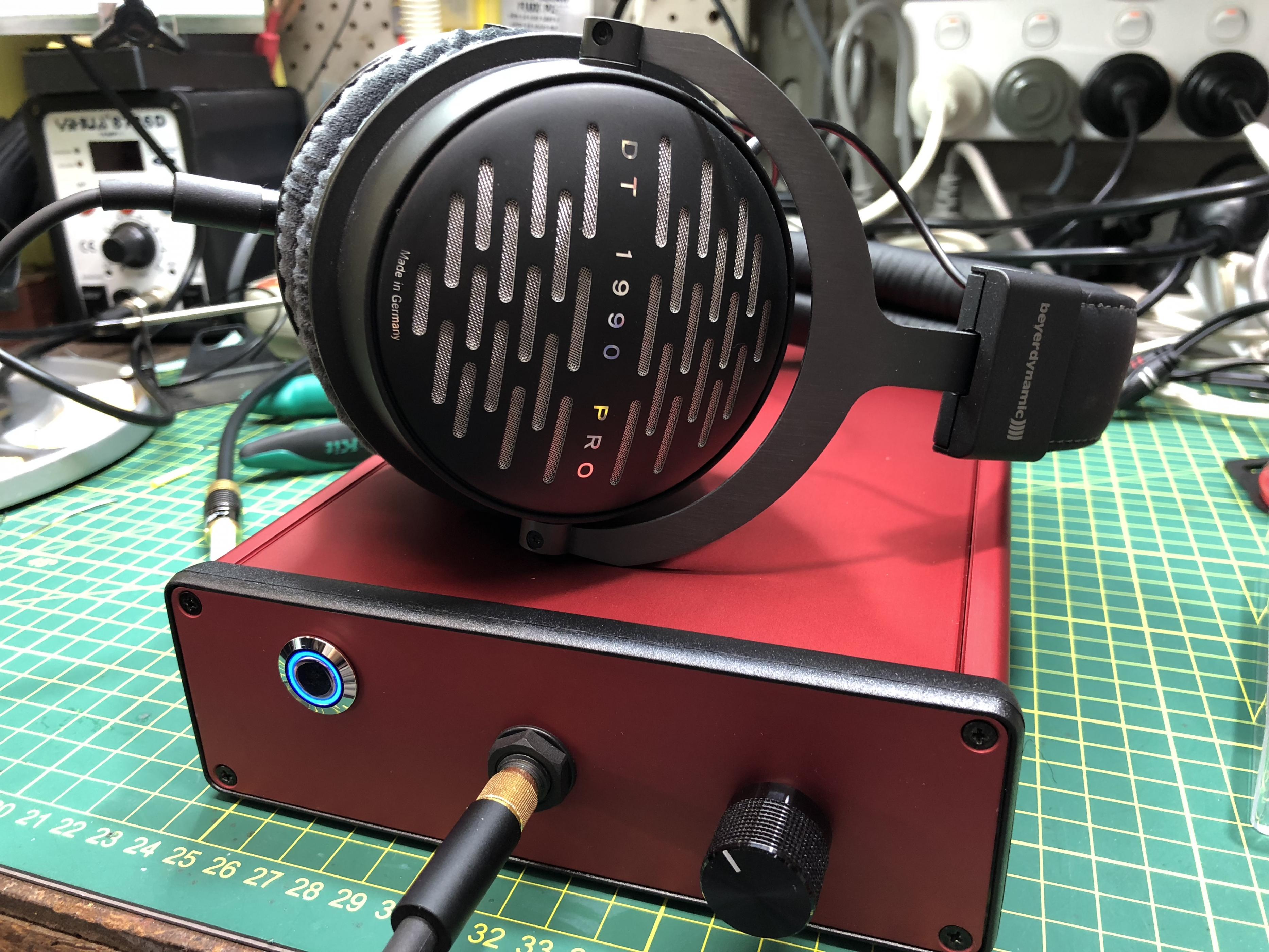

My Beyer DT-1990pro's sound unbelievable on this thing, super happy 😀

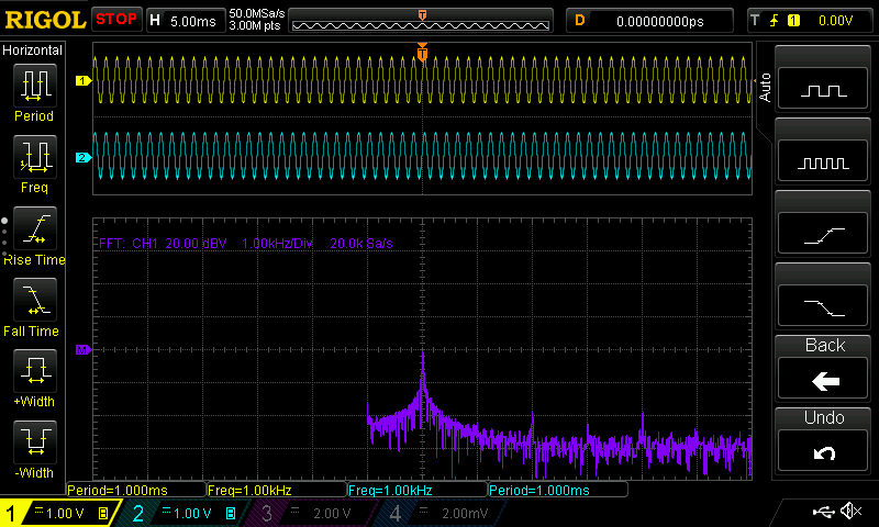

The FFT Graph looks good, 2nd 3rd and 4th harmonics @ 3 4 & 5Khz

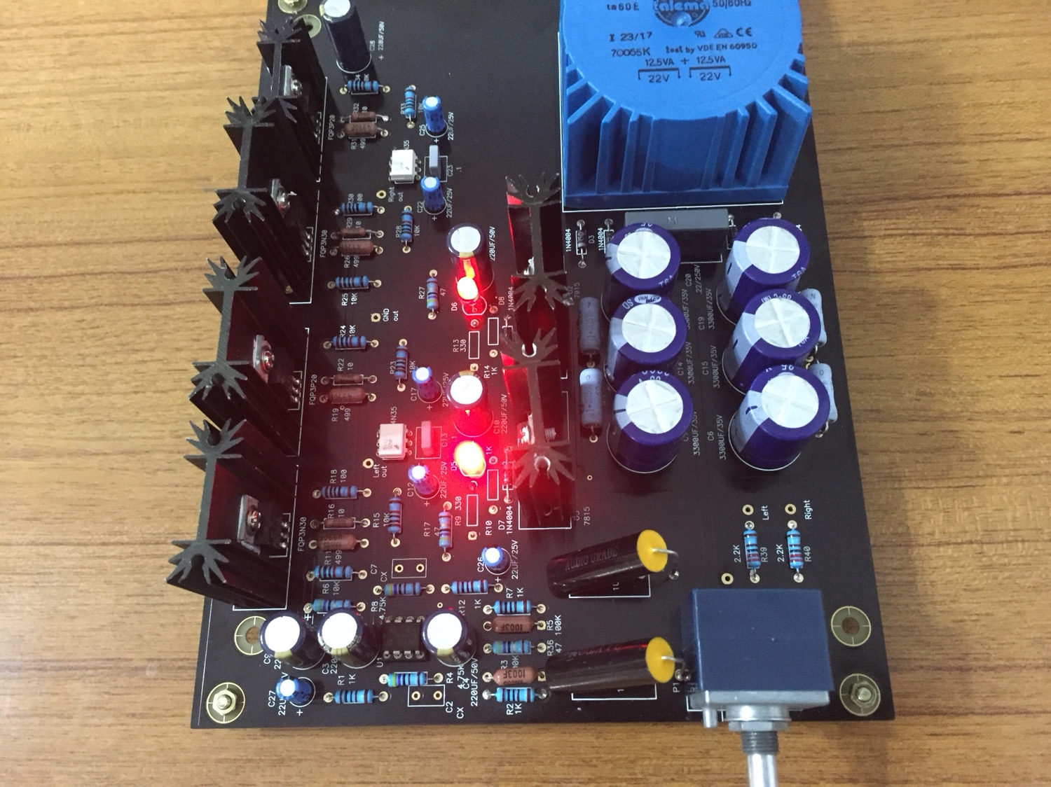

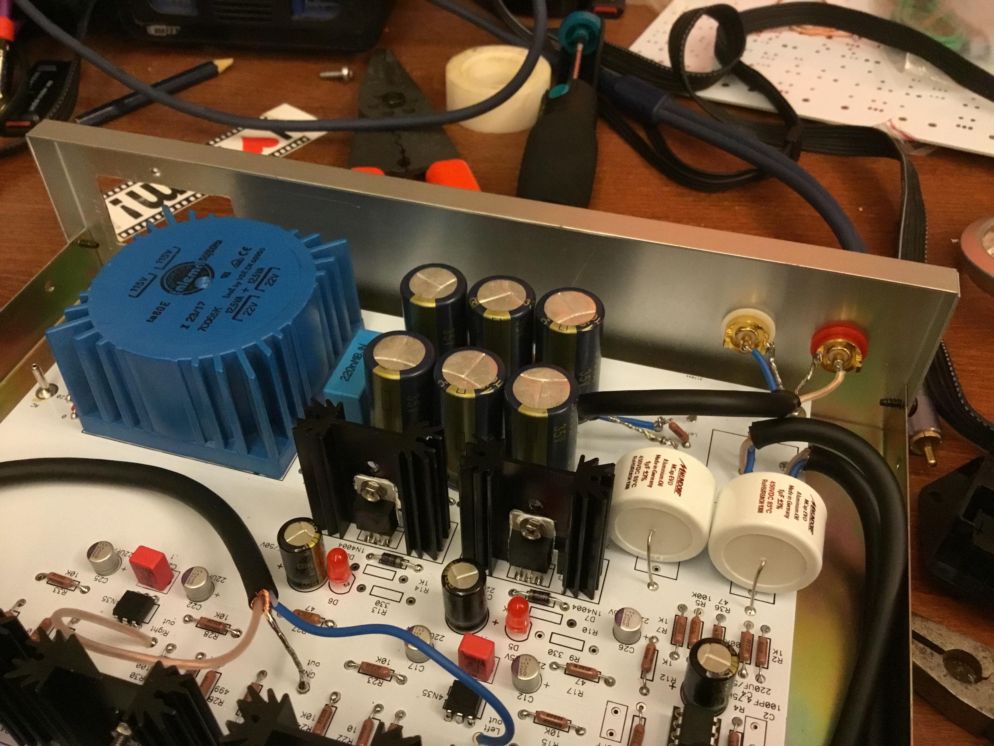

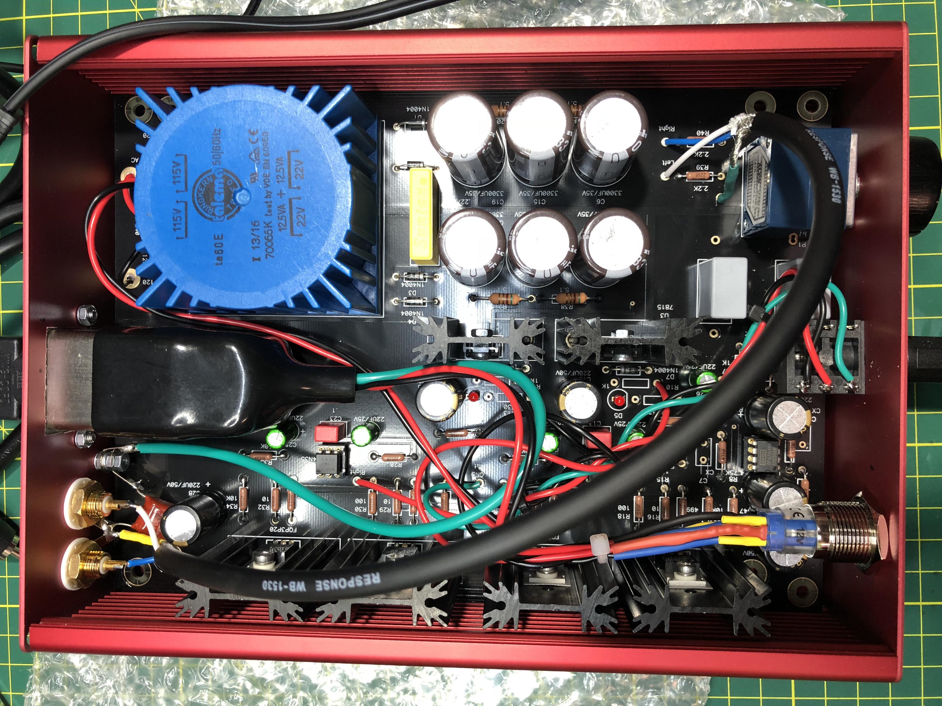

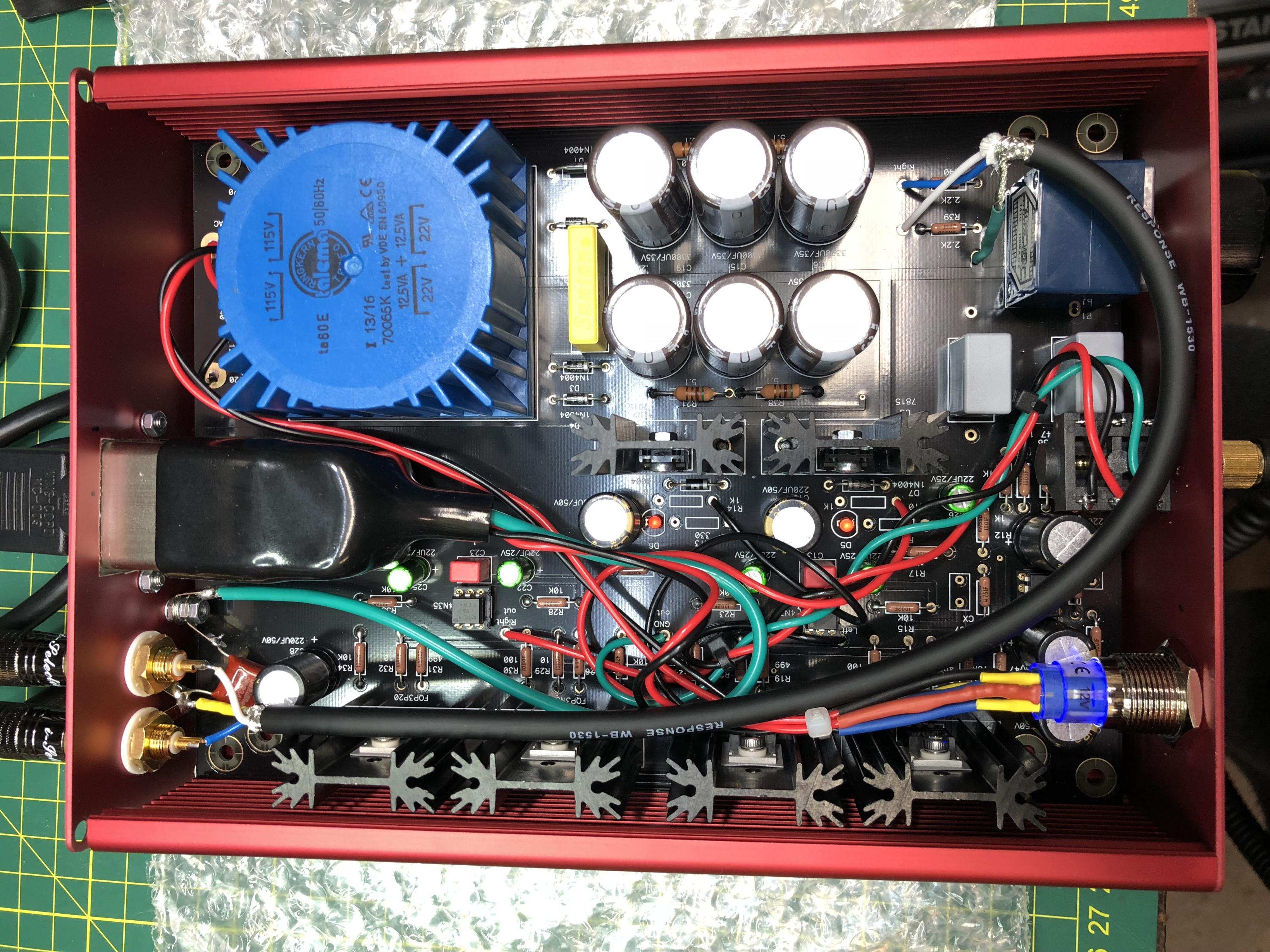

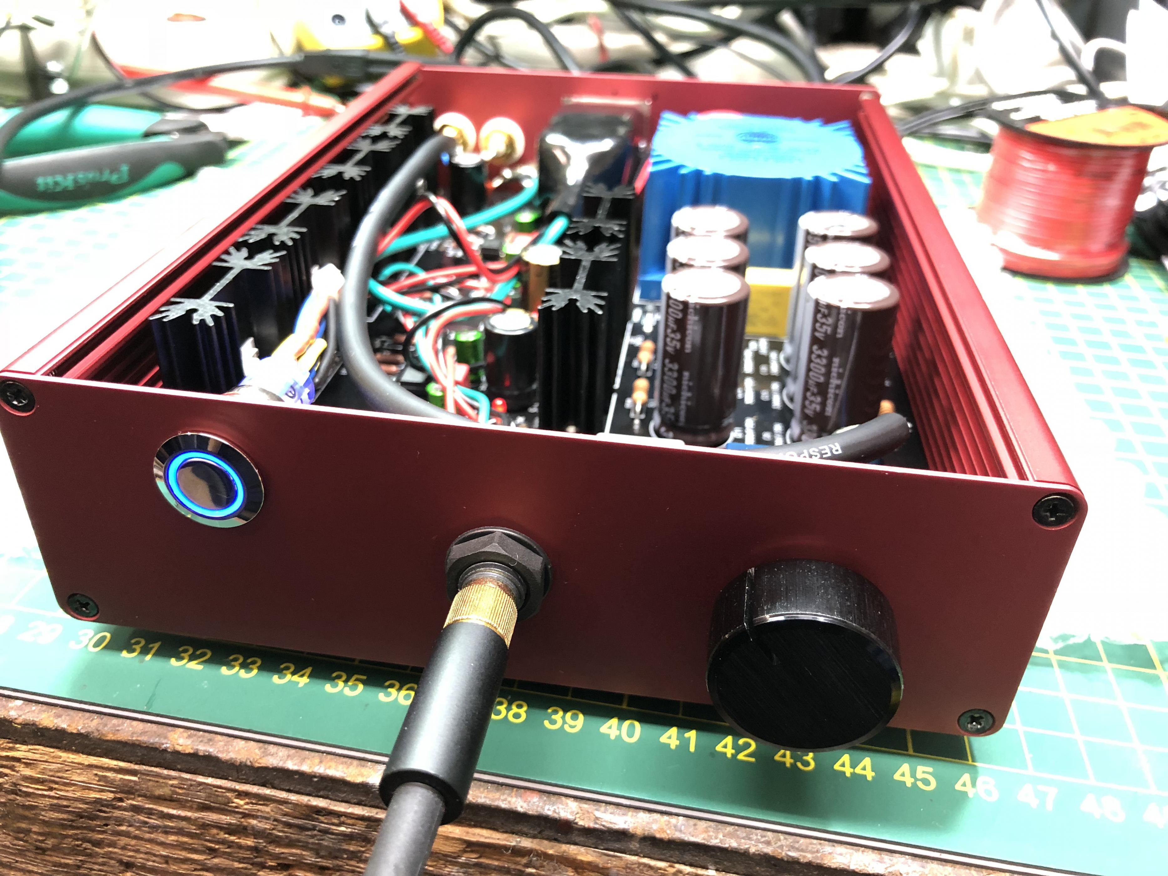

Just before I tidy up the wireing
Front with power switch
