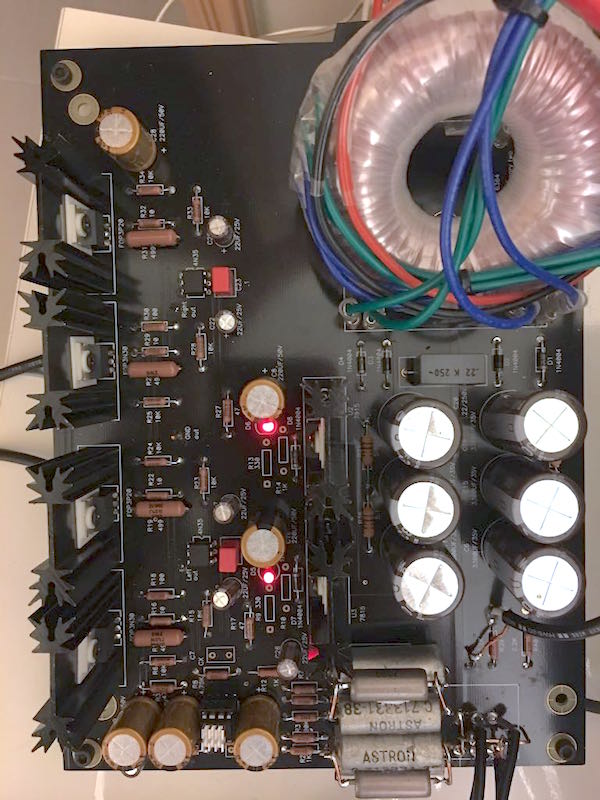

So here is my build:
Pretty much everything was from the official BOM except for the:
- O type transformer;
- old stock oil capacitors;
- Sennheiser HD600 headphone & A-T M50X headphone.
- Tokyo Koen CP601 pot.
So far I have tried 3 op amps: AD826, RC4580, and LM4562.
I got AD847 and Opa134, I am waiting for the 2 into 1 adaptors.
The RC4580 has very good mid and hi SQ; although the bass is a bit muddy.
The "hot" AD826 is quite a good overall performer-bass is clean and solid and I can hear more details; mid and hi are as good as RC4580.
LM4562 is by far my favourite. SQ may not be as analytical/detailed as AD826 but very smooth and fluid, analogue and comfortable feel; no hearing fatigue after 3 hours of use!
The most expensive op amp I ever bought was the ADA4627(SMD) and one of them has extreme popping noise. I feared my solder gun was too hot and destroyed it...
When some more adaptors come, I will transfer them to a new board and check again. I hope I did not kill it. It cost quite a bit.
And the Whammy amp drives my Sennheiser headphone beautifully; but not too good with my M50X. Of course HD600 cost twice as much.
more subjective & biased listening experience with other op amps to come 😉

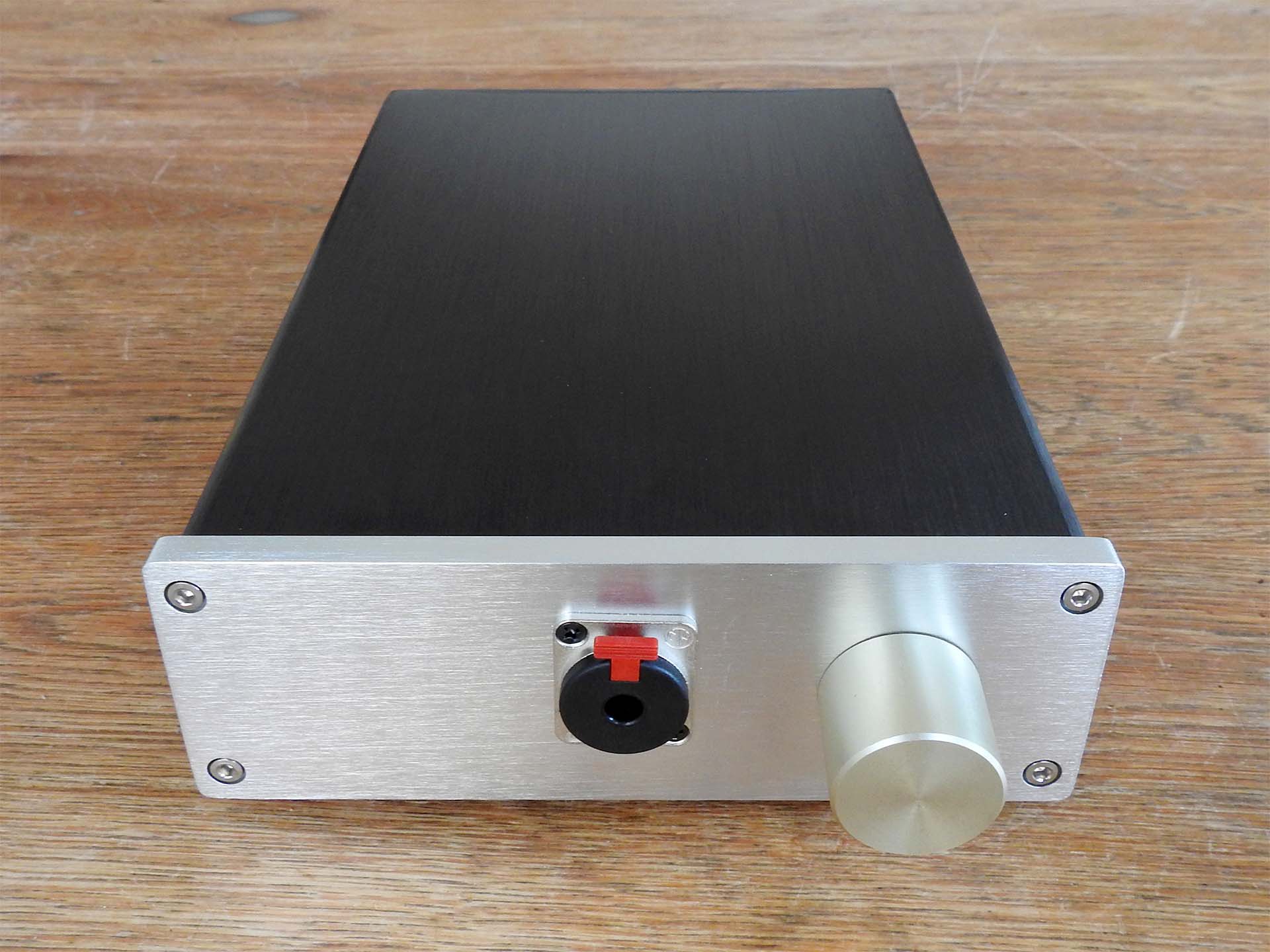

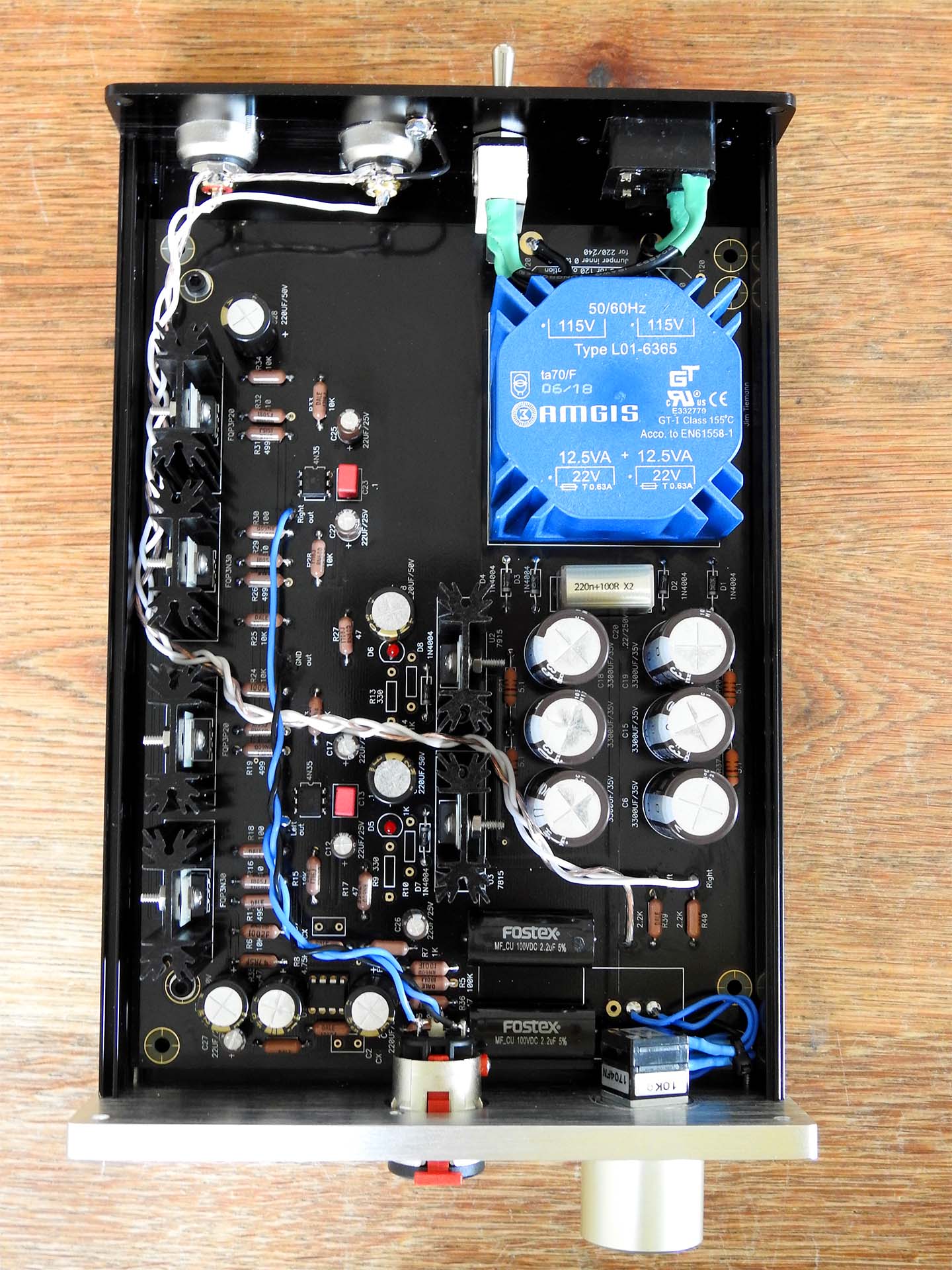

My WHAMMY is finished, thanks Wayne for this nice little amp, like it 🙂.
The Breeze Audio 1706 case is a nice and cheap fit for this amp. One side of the pcb glides into the lead and you need only two spacer on the other side to fix the board.
Thanks for the suggestion... I've found a type 1706 with knob, on/off switch, holes for the phones and rca entries and power inlet... and in black 😉My WHAMMY is finished, thanks Wayne for this nice little amp, like it 🙂.
That will save me a lot of drilling and nasty issues.
Nice job and thanks for the heads up on the 1706 enclosure ordered one from aliexpress
