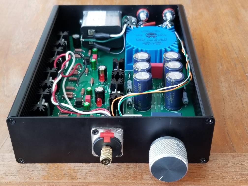

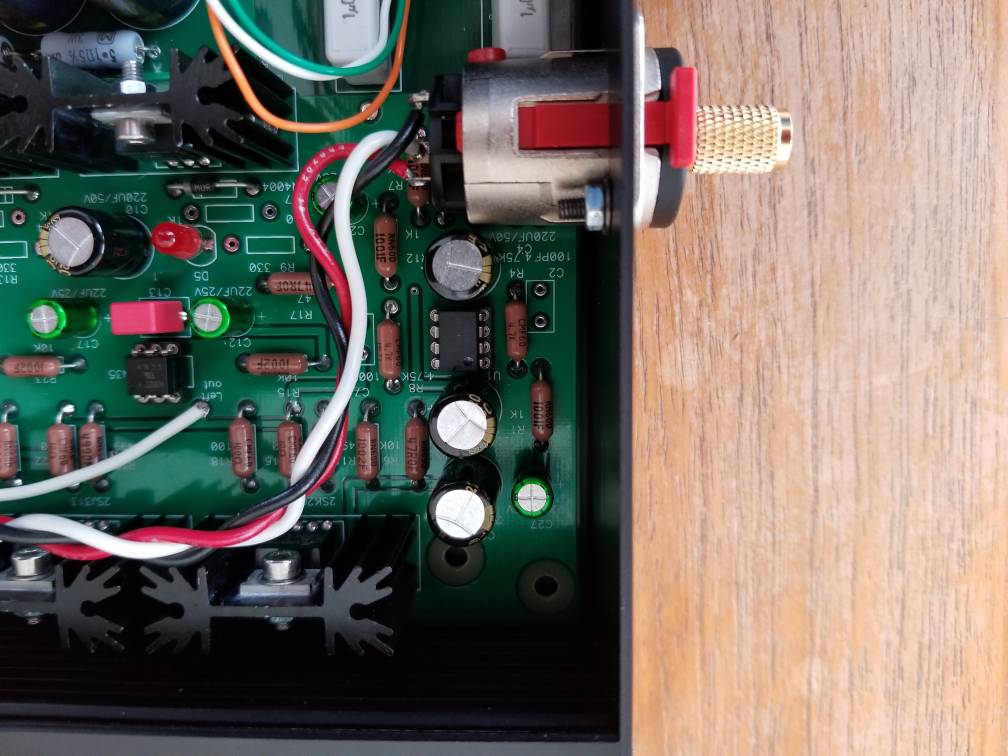

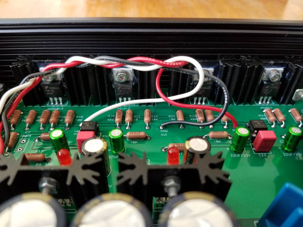

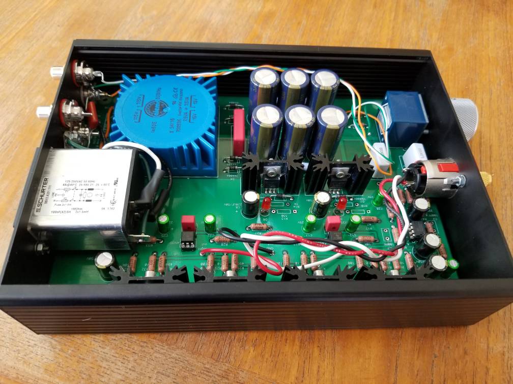

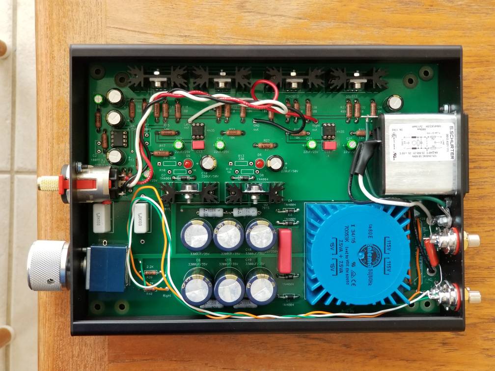

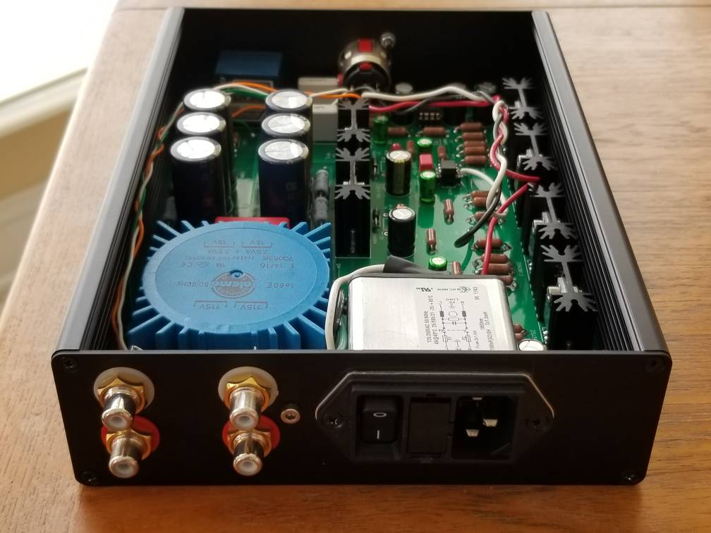

I just wanted to drop a note expressing my sincerest thanks to Wayne and 6L6 for this project and build guide. I finished my WHAMMY over the weekend, and I was immediately overwhelmed by the quality of the sound. I am currently demoing a headphone amp that retails for close close to $1000 USD, and my WHAMMY (at 1/5 the cost) is easily its match and more.
As to the build guide, this is only my third full build and everything went smoothly from start to finish. These instructions are very clear and easy to follow for those of us just starting out with DIY.
I built it stock in the Hammond case with an AD823. Listening so far with some AKG/Massdrop K7XXs.
Any thoughts on another op-amp that might match well with the K7XX's? Not that I'm looking for any improvement, but I'd love to see how some different op-amps compare with these headphones.
Thanks again to everyone who has contributed to this project.
