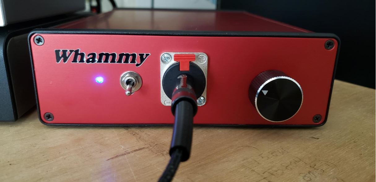

"WHAMMY" Pass DIY headphone amp guide
I believe you. I don’t want to have the hearing damage level on 1/4 of full volume so I like to increase the volume knob’s margin of pleasant output.
“ ..permanent hearing damage in a time less than a typical Beatles song” 🙂
Added a front panel gain switch....a minor pain...tight spaces!

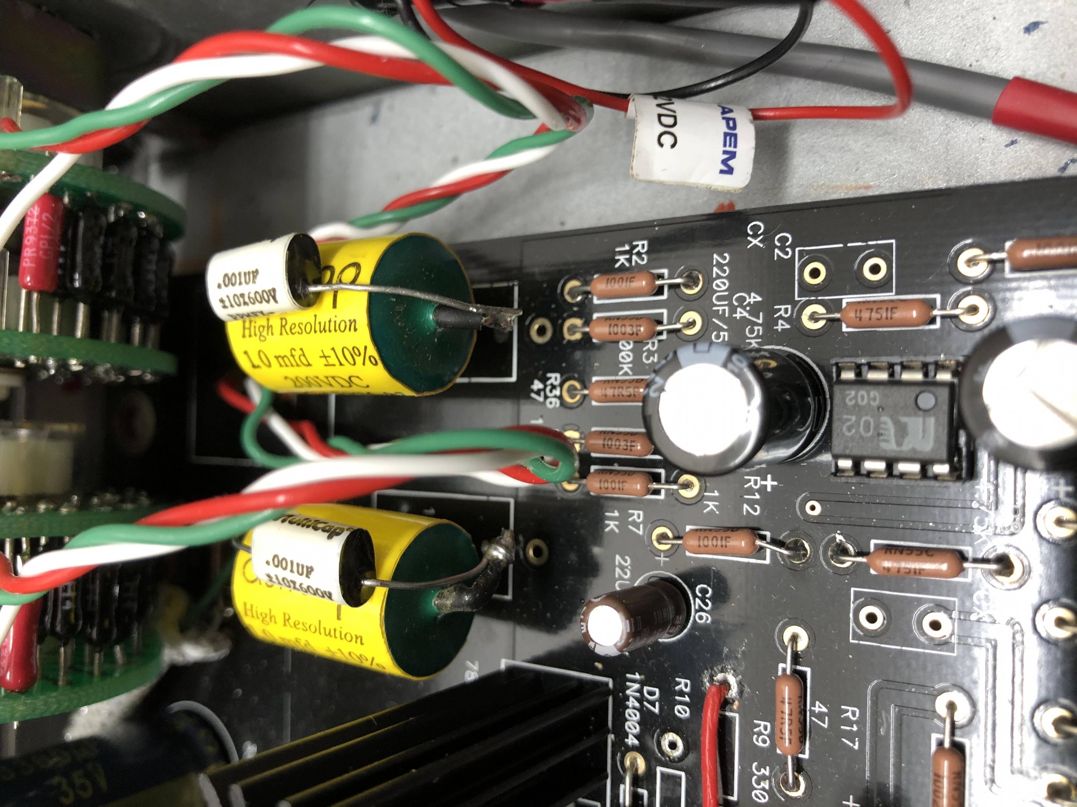

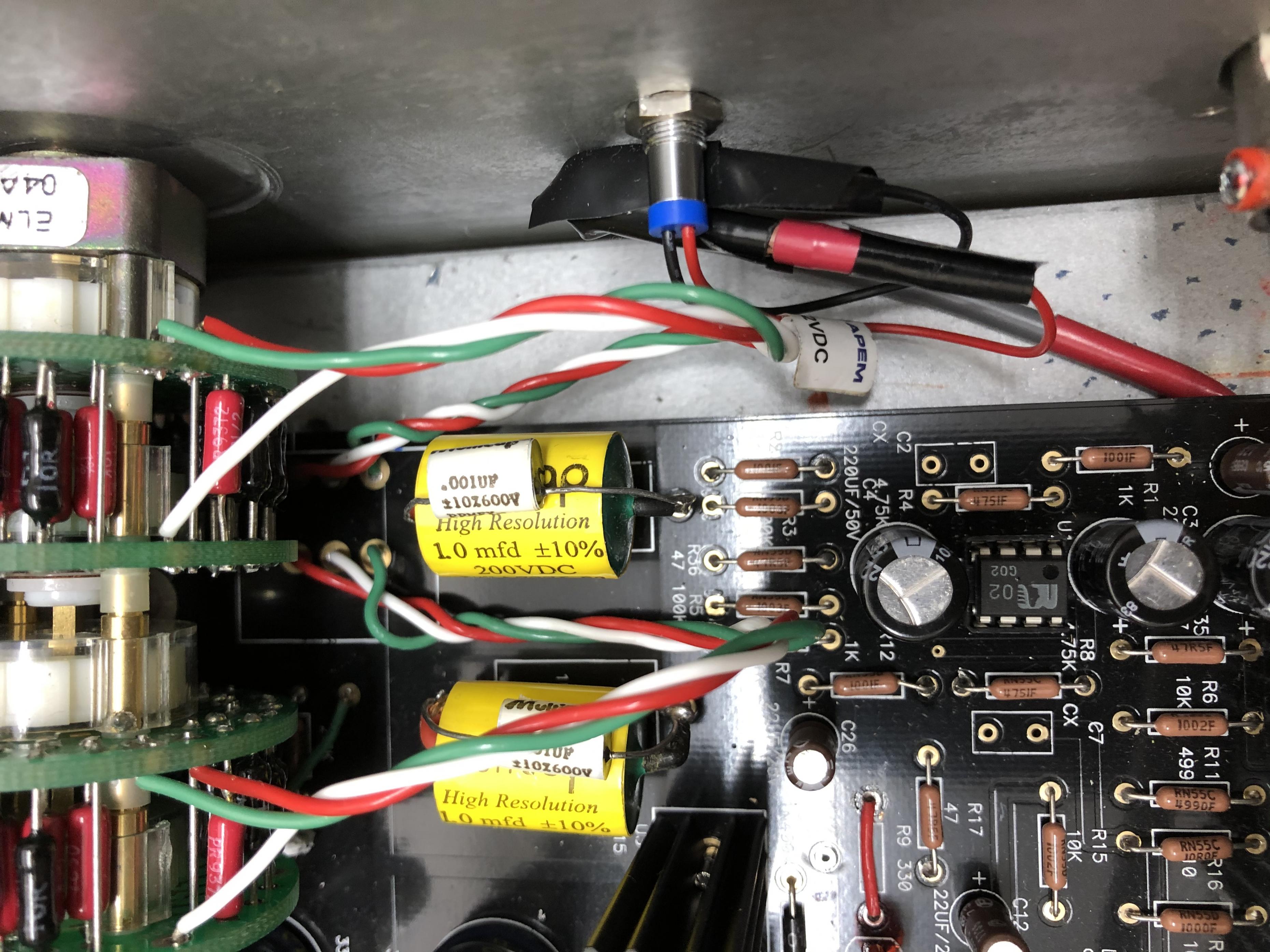

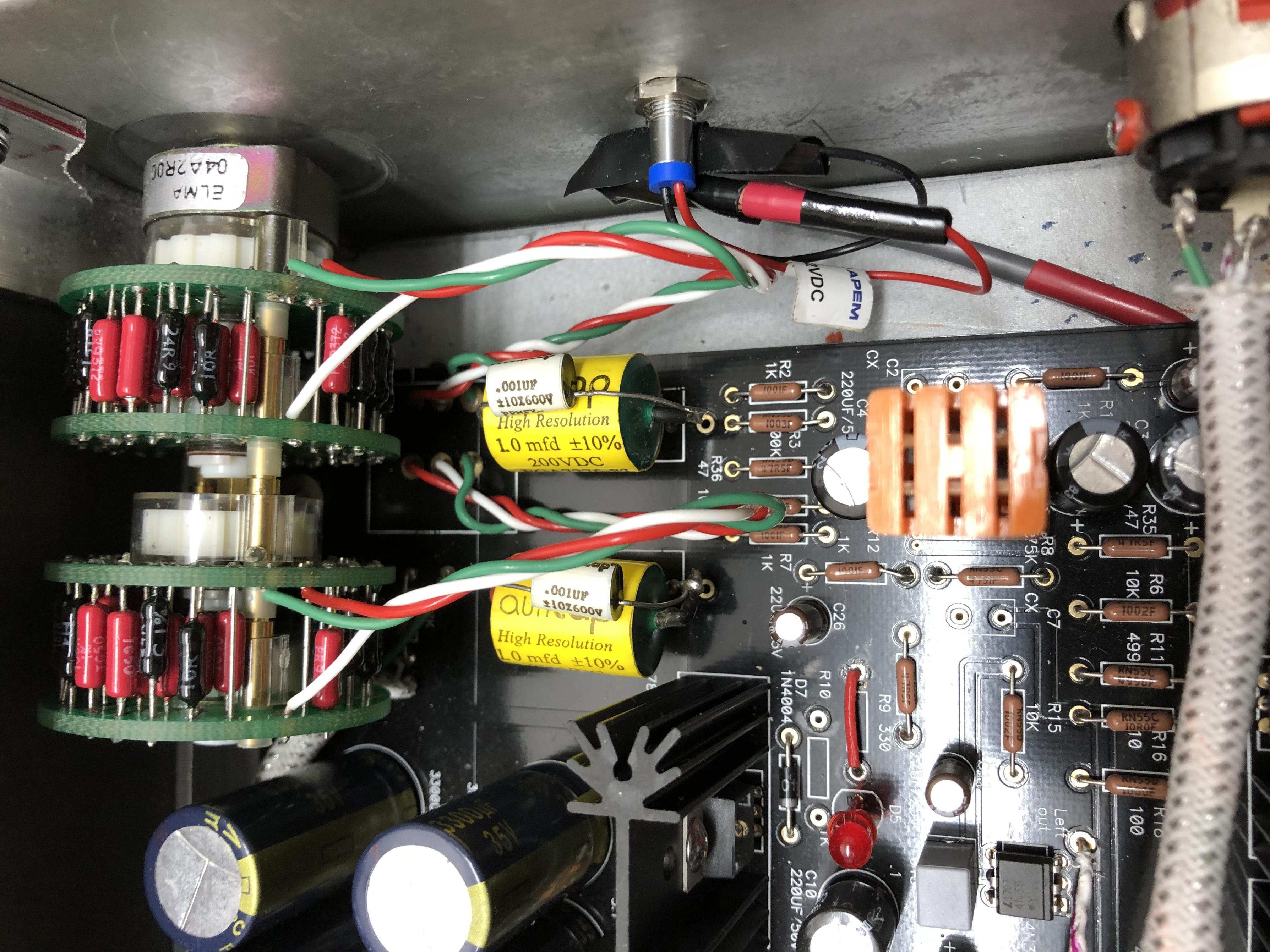

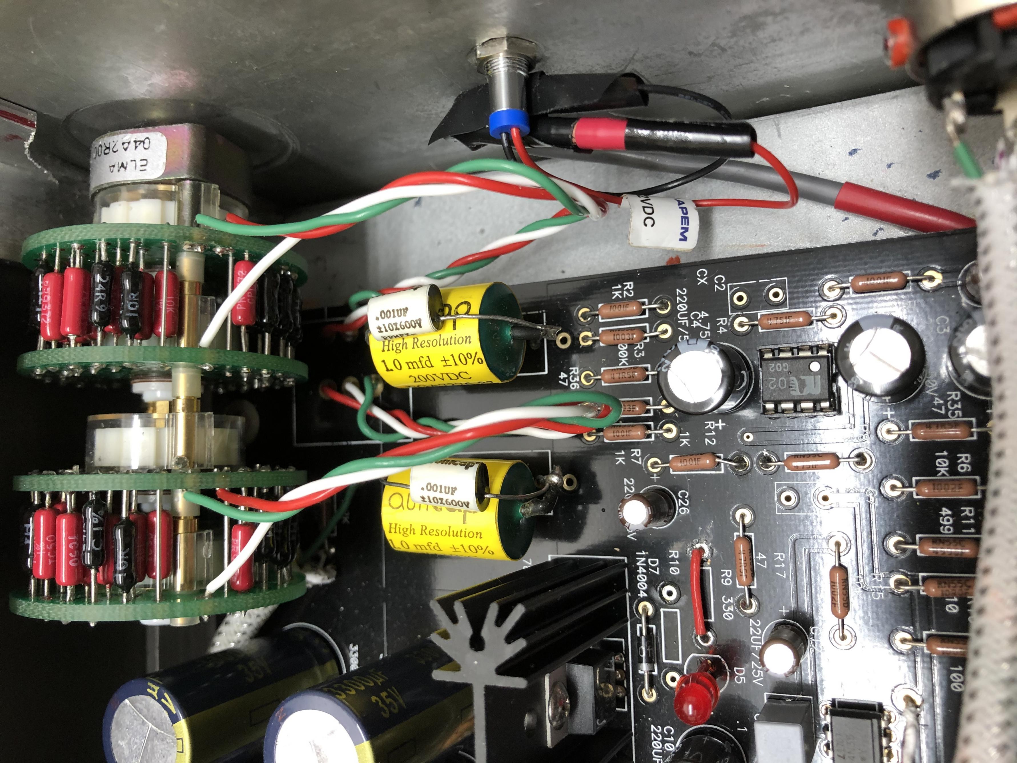

Hi bajjisw, how was your WHAMMY configured with Burson V6 Classic. I asked because I was trying the Burson V6 classic in my Whammy and it did no work. After I installed the V6 Classic and turned it on all I heard was static. So I turned it off then installed back the Muses 02 and now the when I have both left and right channel plug in at the input the sound does not sound correct. When I unplug one of the channel it works. Can you please tell me what did I miss?
Thanks for your help
My version has straight 15V regulators. No LEDs or voltage dividers. I have the input capacitors C1 and C5. I also skipped C2 and C7. Others as specified.
Both V6 classic and vivid worked without other changes in this configuration. One thing I double checked at first is the opamp orientation. Pin 1 is on the side with the little notch down the side.
When was the last time your whammy was ok? What is your configuration? Was Muses 02 your original ? What is your source ? Does the music sound the same with only left or only right input?
I dont know what to suggest other than conventional debug with good pictures. Check common issues like insecure connections and grounding for both channels.

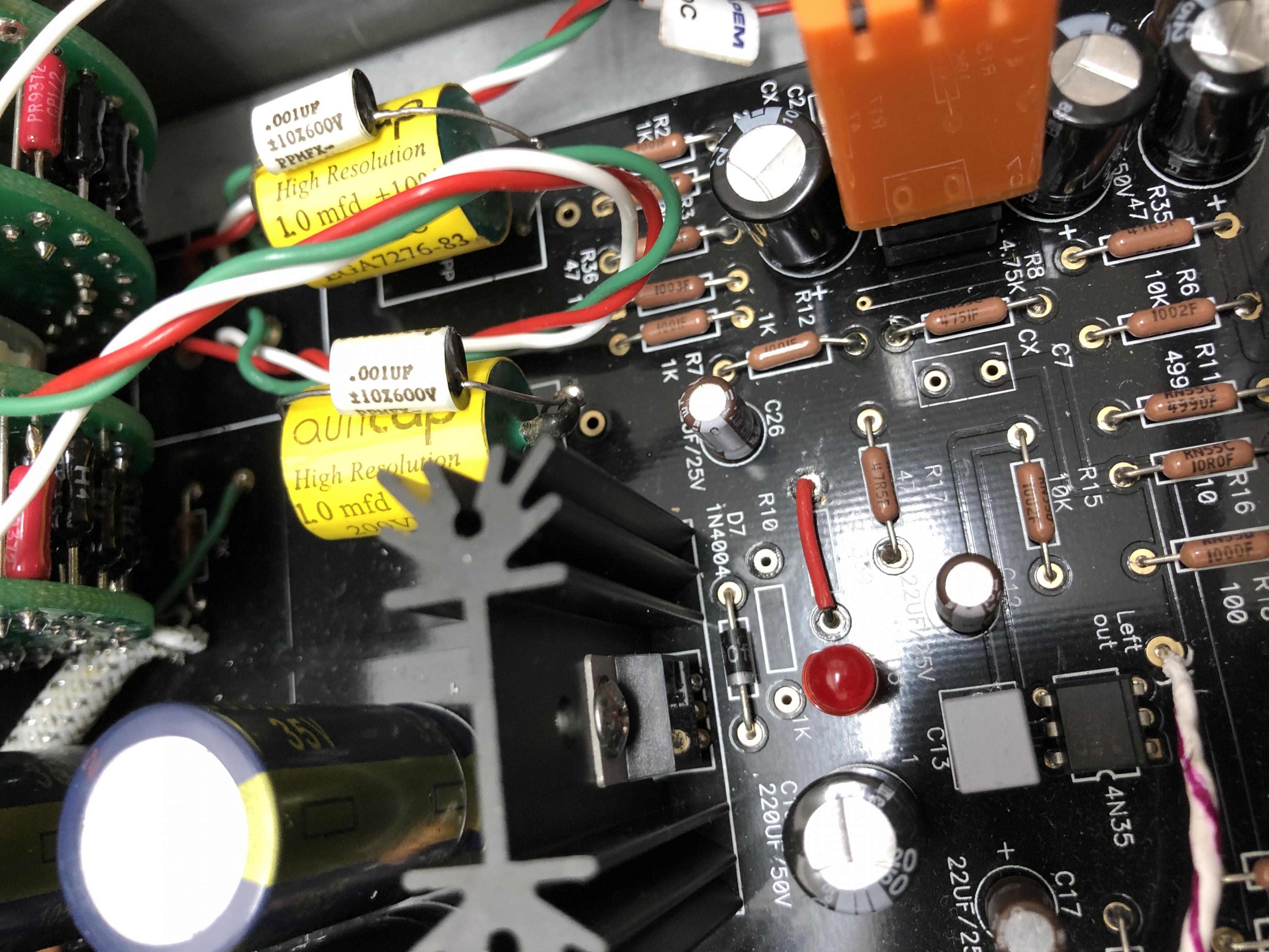

@2 picoDumbs thanks it looks and felt it was in there although when I inserted the Burson it was a tight fit I have to move both of the caps. I might have broken the Cap connection. I will take it apart and check the solder connection.
@bajjisw—
When was the last time your whammy was ok? ---It was working up until I tried to V6. I’ve been using it for a year now.
What is your configuration? – No resistor on R9 and R13
Was Muses 02 your original ? – No it was not I bought the kit at the DIY store and used the stuck OP amp then upgrade it to Muses 2
What is your source ? – For testing I used my IPod
Does the music sound the same with only left or only right input?--Yes
See pictures it looks correct

Thanks for the pictures and the responses. Yes , check the caps next to the opamp socket. If that's good,
Check the voltage at the opamp without source and then with L only, R only and both connected. Pins 4 and 8 wrt ground.

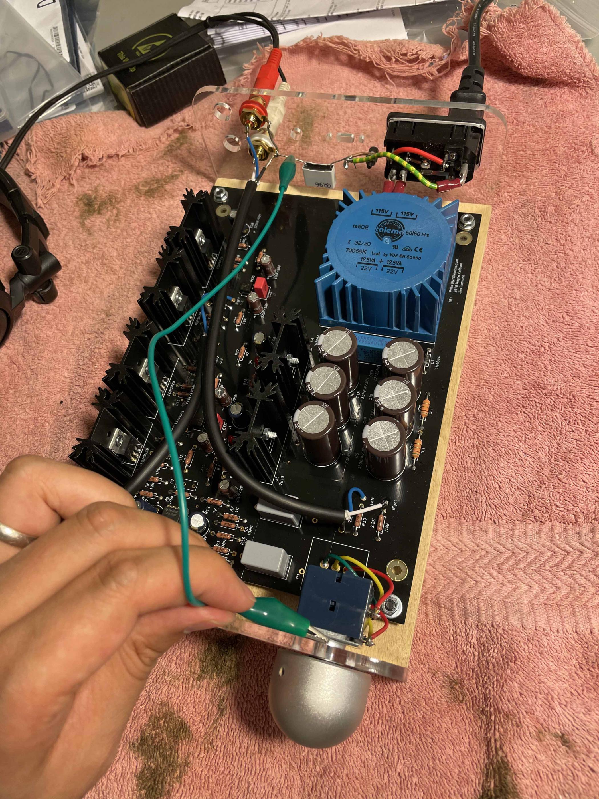

Hi Everyone,
I got my Whammy PCB fired up tonight on a temporary acrylic/plywood test enclosure.
All is well except I noticed some pretty serious buzzing, which gets louder with increased volume pot position.
The volume pot is particularly sensitive to touch and picks up a lot of noise.
As an experiment I used a clip lead to ground the body of the pot (see last picture), this seems to fix the issue and it is fairly quiet, only with a slight buzz with the volume turned right up.
Is it normal to have to ground the pot, am I missing something? Should this amp be quieter than what I am seeing?
I have planned to build a wooden chassis where the pot will be mounted directly in the wood, I may have to devise a plan to allow for it to be grounded.
Any help would be greatly appreciated!
Jeremy
EDIT: I just did some digging through the thread and it looks like this is a fairly normal issue. I’m an amateur so this is a good learning experience!
I guess I will need to sort out a grounding tab for my pot.

This is pretty common and has happen to me when I built my first Whammy; the pot's outer shell still isn't grounded properly and/or you could also have the RCAs at a different ground potential too. Check that the negative side is connected to the same return point that the pot is. The fact that you said it goes away by taking a test lead/clip and connecting it to your board's return point, as well as that you hear the noise go away when you touch the pot itself (thereby grounding it) proves that the shell isn't returning right. In my case, while I had the pot mounted into the face plate with solid contact, the face plate wasn't actually contacting the sides because the anodizing on all sides of the case panels prevented that. This is why one of my first steps when building anything now is to sand off the anodizing on the mating surfaces of the chassis and then use my DVM to prove I have solid continuity.
With that said, IMHO the most straight-forward solution to your problem is to put your project into a chassis. 🙂

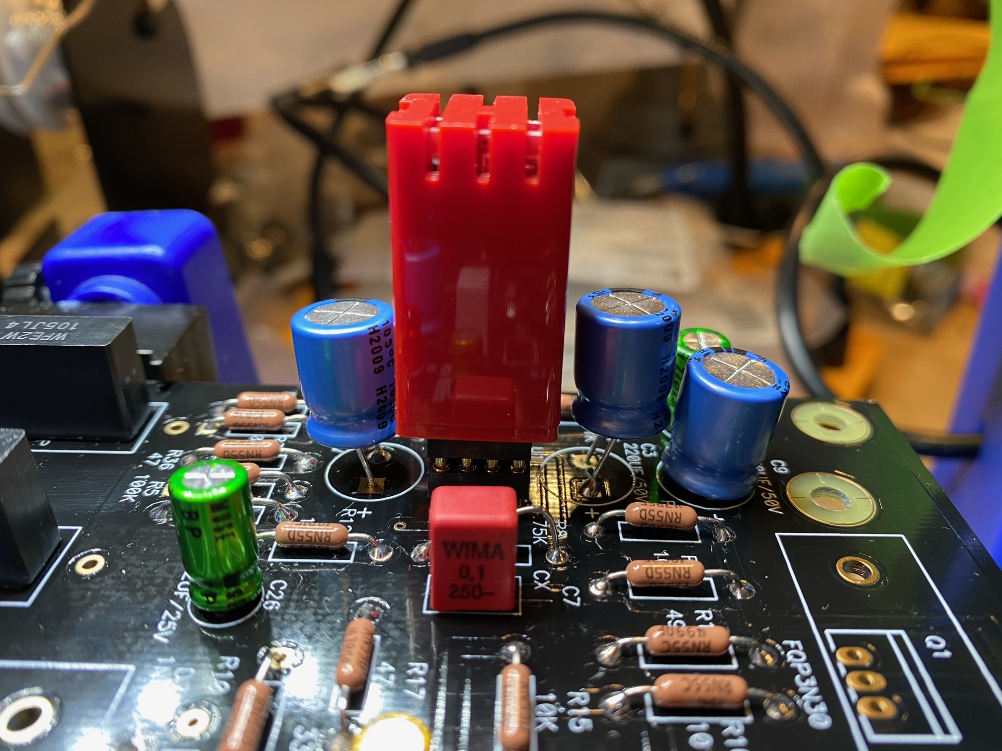

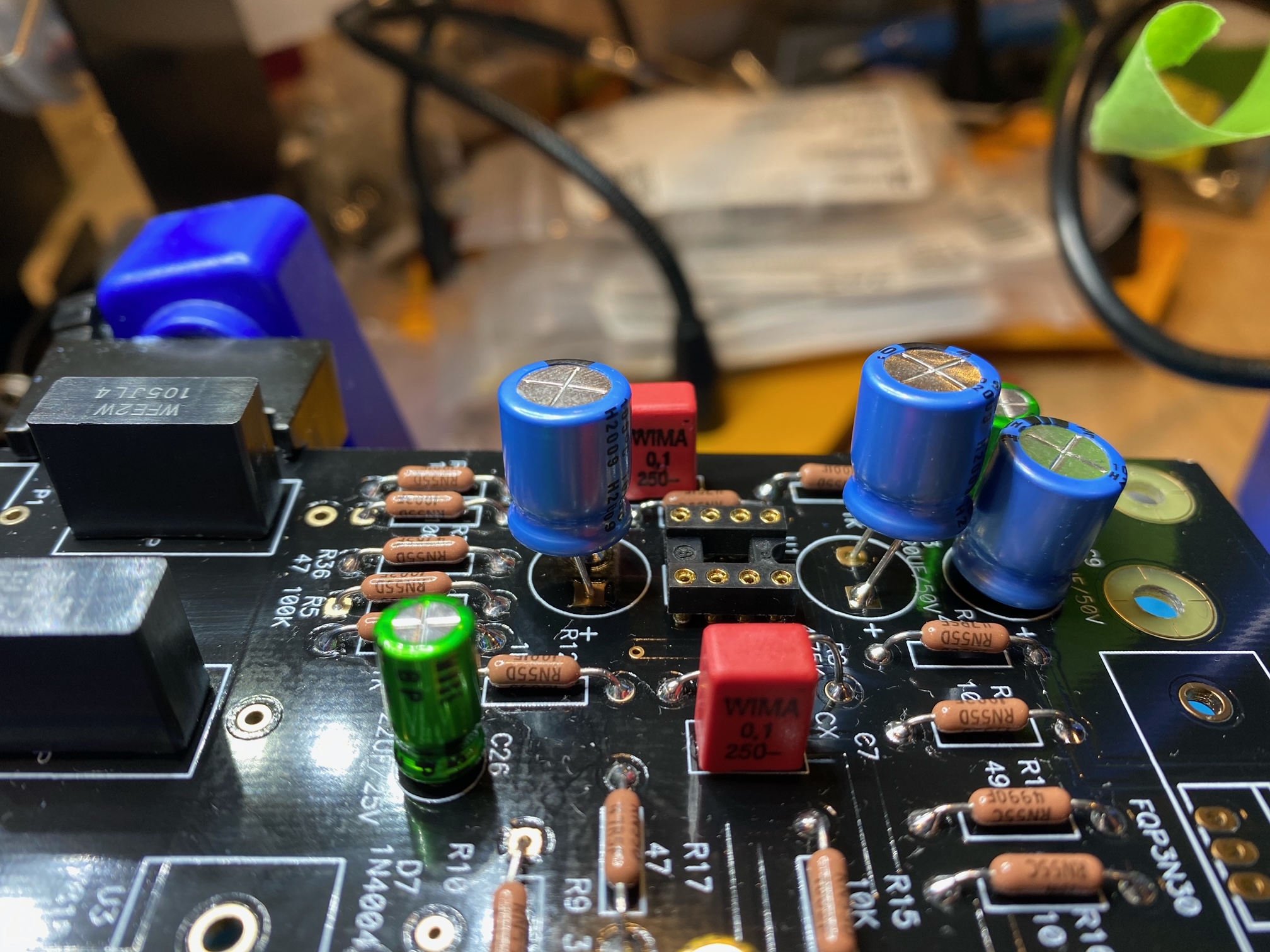

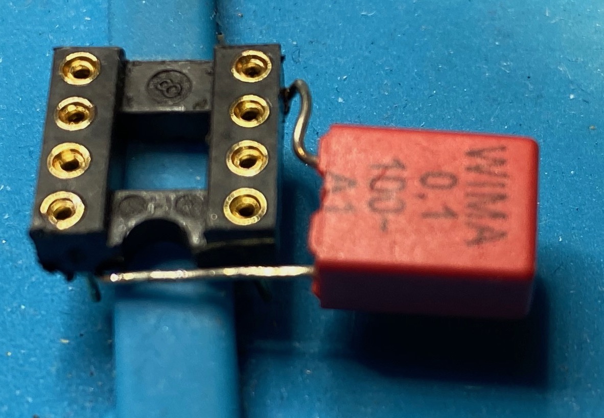

I wanted to confirm the need for the bypass cap mod for the Bursons. I started using the Classic in my second Whammy about a month back (when I was doing a review). Unit sounded fantastic, and I was using it all day long for conf calls. However, about 2 weeks ago I started noticing a faint whining sound at the upper register of my hearing. When I read this post yesterday it got me thinking: what if what I am experiencing is what the Burson data sheet recommends, "After installing the SS Opamp please allow for at least 100 hours or burn in time before carrying out the following steps." I was roughly at about 100 hours of use and viola, the noise appeared! I have no idea why it takes this long for this to manifest itself, so I am hoping someone else can shed some more technical light on this.
To prove this out, yesterday I built myself a DIP8 adaptor with a .1uf@100V Wima (see pictures). I did some A-B testing with the Burson Vivid I am reviewing now, as well as the Classic that I'd been using. The noise is gone. I tried the SparkOS dual and noticed nothing detrimental, although the SparkOS in my first one that also gets roughly daily use over the past 9 months or so has never exhibited this noise.
And what is interesting is that I noticed the very top end become clearer and was less fatiguing after listening for 30 minutes. I wonder if this is what some have described as "listening fatigue" when listening to the Vivid?
In any event, I am building a third Whammy now and have just soldered the bypass cap right to the underside of the bound-mounted DIP8 this time (see picture). As you can see on the board-mounted version I took the time to add heatshrink tube to the leads to prevent shorts, as the V+ (pin 8) gets precariously close to pin 8. This is also why I added some clear silicone sealant to the DIP8 version as the lead the winds around the base can easily be accidentally shorted and no one wants to let the smoke out.
--Tom
