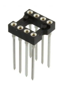

That is a 16 pin version; can't find an 8-pin version there. Did you find one of these?

From the data I could gather, Advanced Interconnects doesn't offer an 8-pin version, but it is quite possible that I could simply not find one.
From the Farnell link to the E-Tec products, it does seem like a ready-made solution is available. :)
Part QIT-308-W001-01 seems to fit the bill for the dual opamp configuration recommended by Burson along with the recommended 100nF => 0,1uF capacitance. I haven't yet found a source. Farnell => Newark shows no parts (at least when I click on the USA link).
One could potentially get some of the $0.15 parts from the link Mark provided. With a relatively small bit of work I could modify it to a nice 8-pin at less expense (I haven't checked shipping).
These seem close, but also not available in 8-pin
https://www.mouser.com/datasheet/2/273/098-259748.pdf
Also, by looking at the parts used in the products provided by Mouser, they're relatively expensive. With an 8-pin adapter (I have a toy boat-load of them) plus some caps and some solder, I think I could put one together. Below are some caps. I chose the search criteria based on the type of cap used in the Mill-Max data sheet. I cut the link from the search and filter criteria I used. I then pasted the link into a new browser window to see if it kept my search criteria. It seems to have worked for me. I hope it carries through.

A Do-It-Yourself alternative is to get a longtail Wire Wrap socket and solder one or more capacitors underneath, yourself. I bet there's room for 3 parallel capacitors: one axial lead and two 2.5mm leadpitch "radial lead" caps. FlagLeft, Torpedo, FlagRight.
DigiKey Product Link
_
Then I could stack just two of them and still fit the Burson in between the Nichicon FGs.... I was wondering if something like this existed!

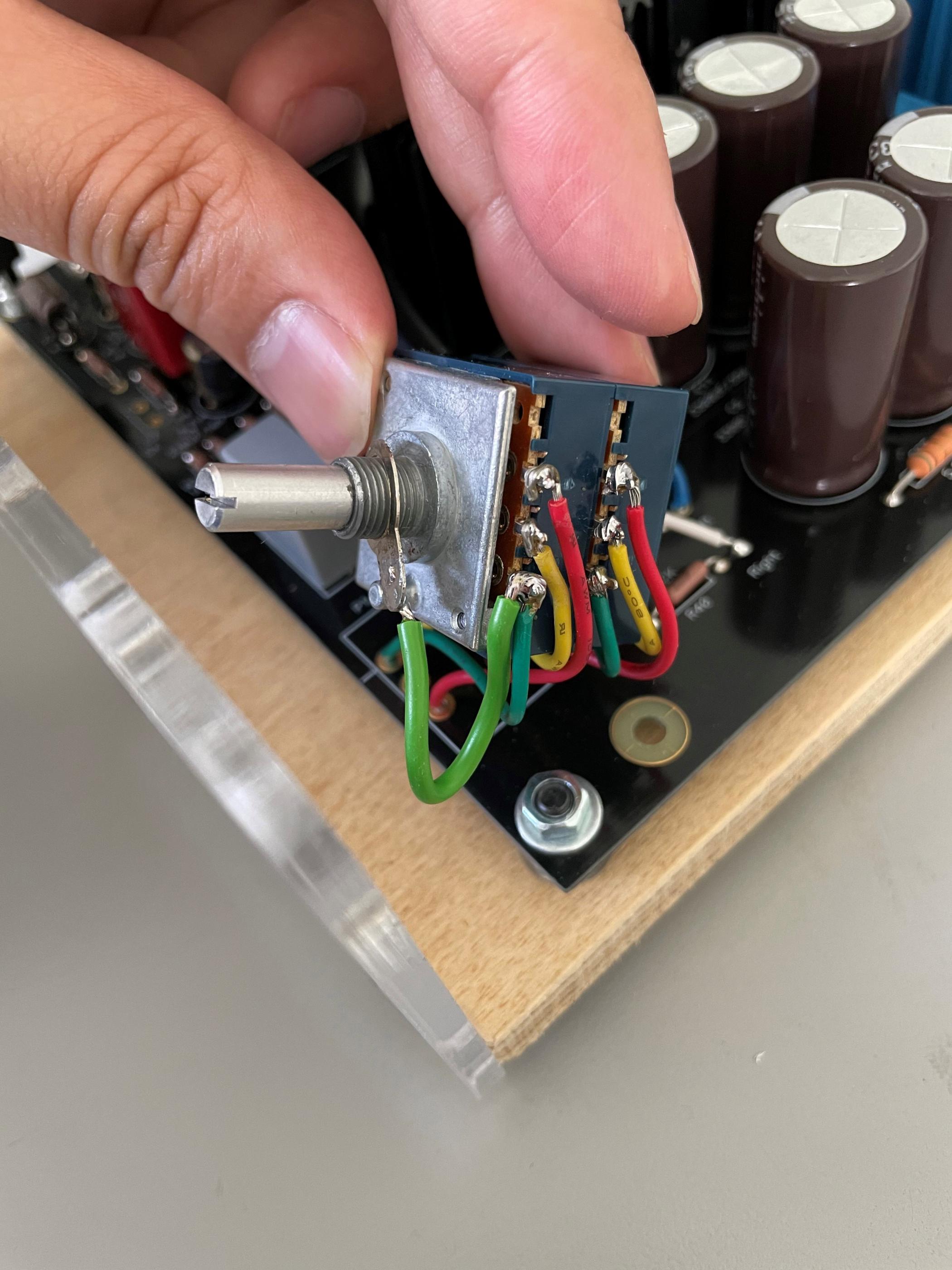

This is pretty common and has happen to me when I built my first Whammy; the pot's outer shell still isn't grounded properly and/or you could also have the RCAs at a different ground potential too. Check that the negative side is connected to the same return point that the pot is. The fact that you said it goes away by taking a test lead/clip and connecting it to your board's return point, as well as that you hear the noise go away when you touch the pot itself (thereby grounding it) proves that the shell isn't returning right. In my case, while I had the pot mounted into the face plate with solid contact, the face plate wasn't actually contacting the sides because the anodizing on all sides of the case panels prevented that. This is why one of my first steps when building anything now is to sand off the anodizing on the mating surfaces of the chassis and then use my DVM to prove I have solid continuity.
With that said, IMHO the most straight-forward solution to your problem is to put your project into a chassis. :)
Thanks for your response.
I have fixed my issue by grounding the pot body. I did this by using a conductive ring sandwiched between the pot body and the chassis which has a wire grounding wire attached to it. I then attached this wire to one of the ground pins on pot. See image attached.
Attaching the pot body to circuit ground solves my RF issues.
In doing this I had a thought about safety grounding, should my pot actually be connected to my earth point rather than circuit ground as this would be the case if I had it mounted in a completely conductive enclosure.
Only connect the board/circuit (and corresponding I/O) to the central return point or you will create a potential alternate return path. Only connect to earth ground through the ground isolator cap (or diode + resistor + cap if you take that approach). I like to think of it as making sure all currents come back to the same return point.
