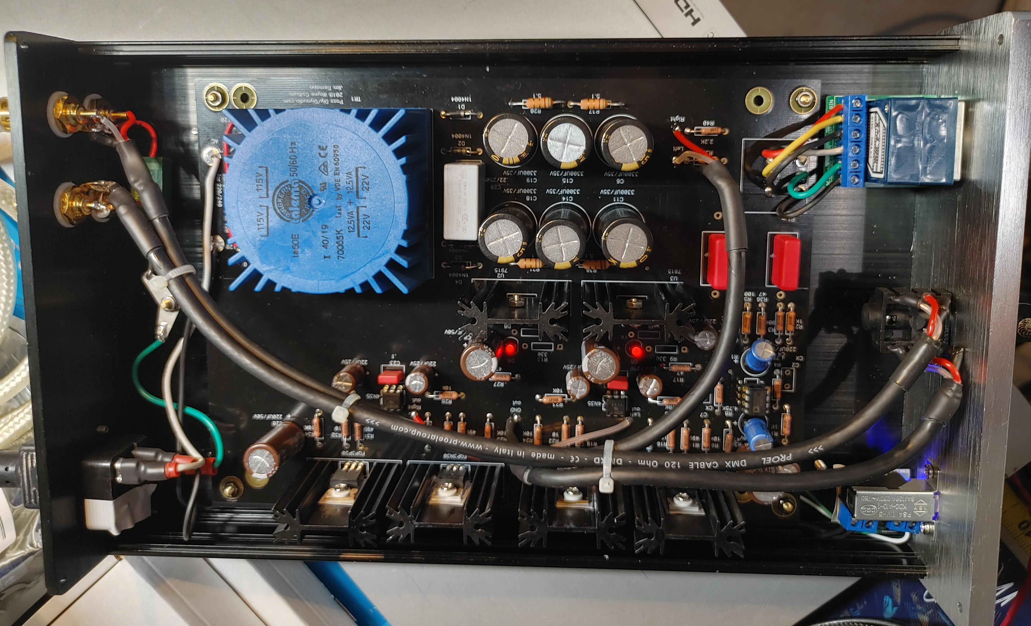

After about 10 years away from DIY projects, I am back at it. Here is the Whammy I just finished. The case is one I bought years ago on EBay and worked great.
Now to rolling OpAmps.
looks like the same chassis i got. 1907 chassis? i would turn around the back panel if i were you. Then you dont need to cross the signal and high voltage wires 🙂
I considered it, but wanted to keep the printing on the back correct. And would still have to deal with the power switch. In the end I just used shielded microphone cable. The amp is dead quiet with no noticeable hum.
