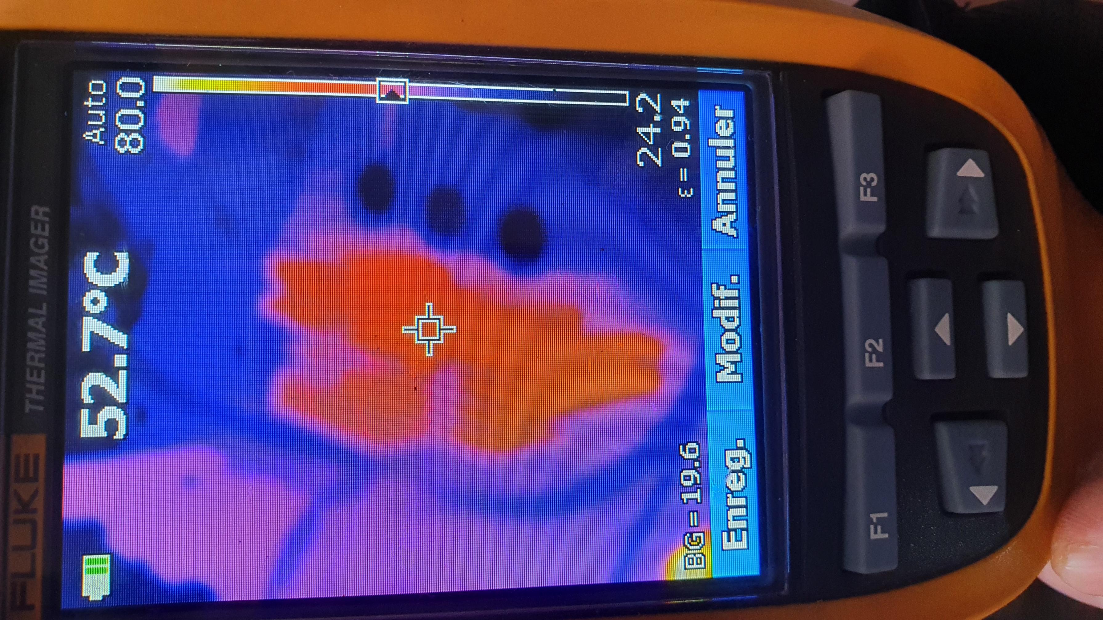

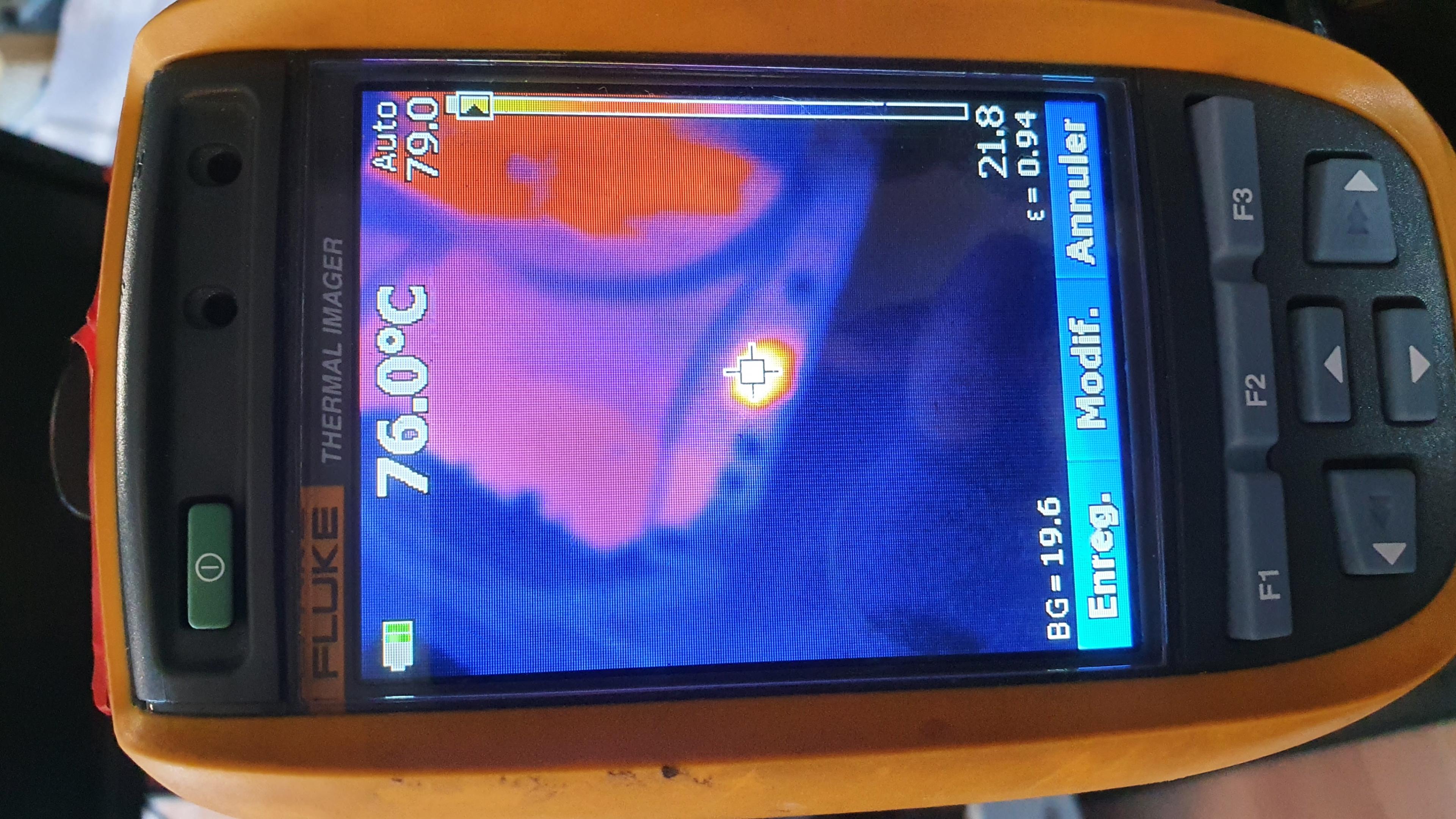

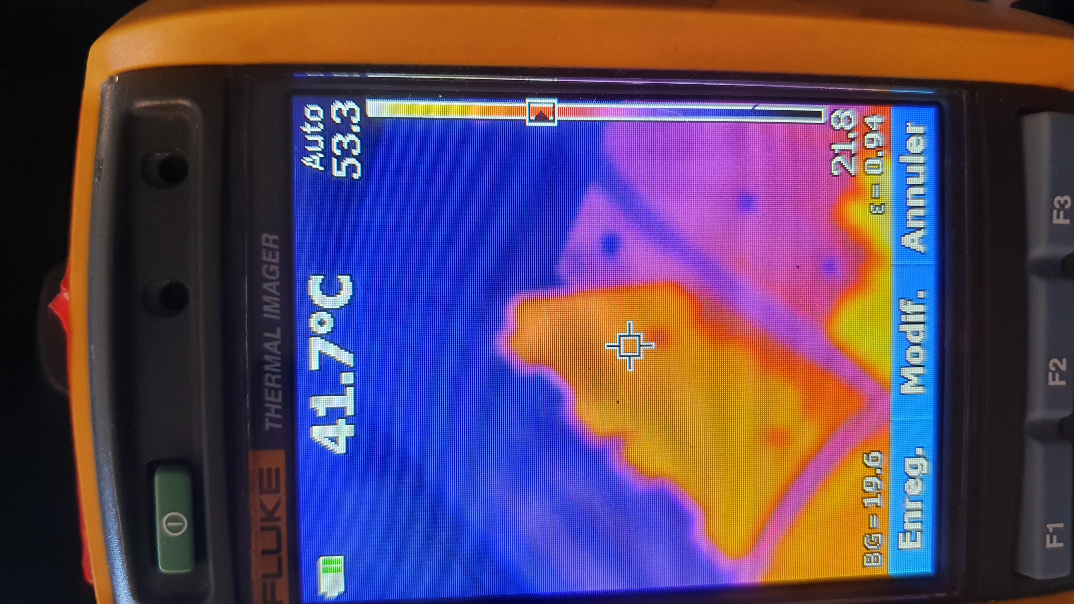

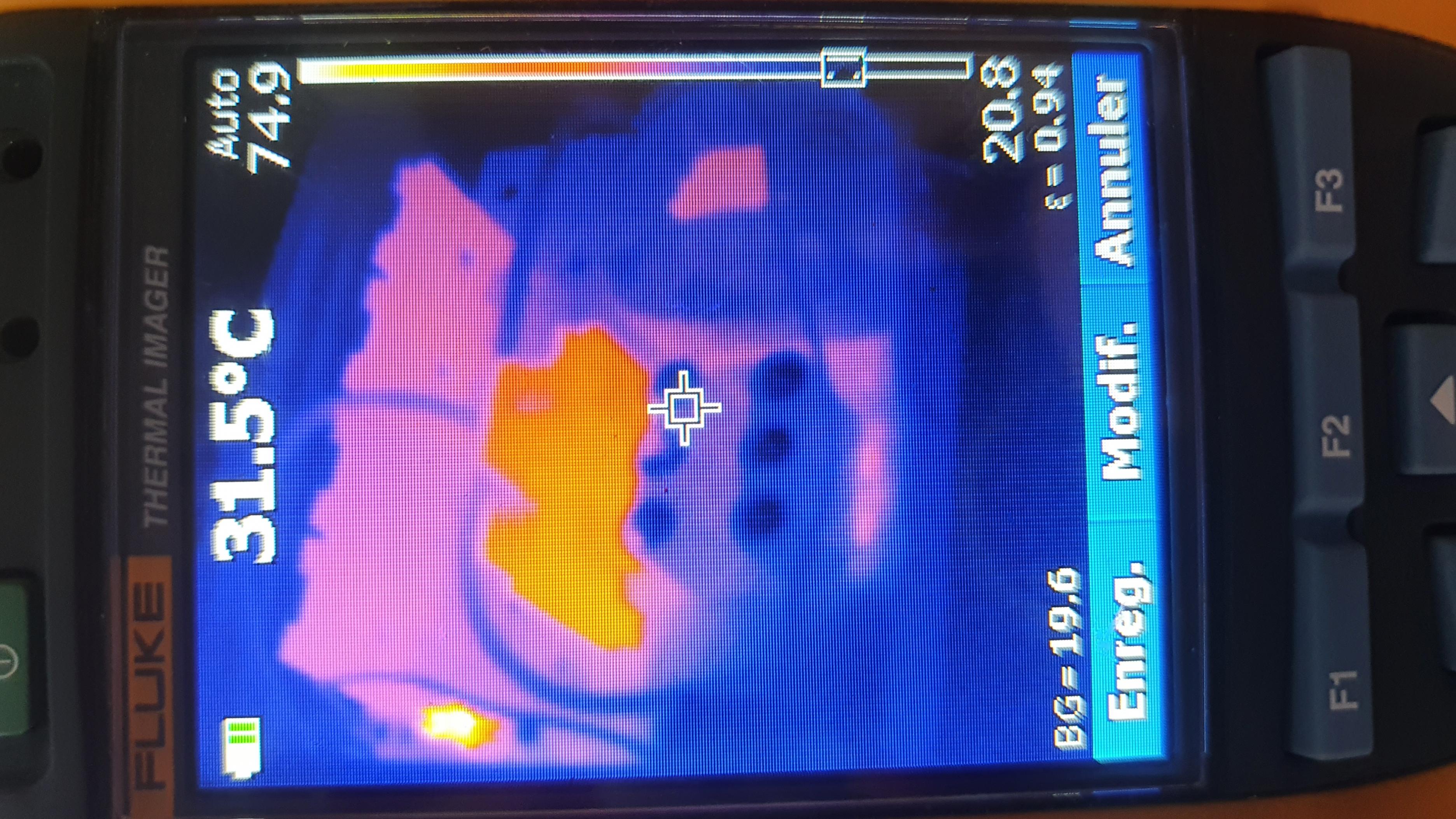

Hi all,
I have some cool thermal pictures of my whammy in its latest and greatest state.😀
Subjectively, touching the burson hurts in <1s, and touching the regs start to hurt after 10s (basically just tickles a bit).
Ambient temp was 19.5°C, and the case is in the open on my desk (well ventilated)
Burson audio v6 vivid 76°C (naked, without plastic cover!. I subjectively prefer it this way)
Regulators 53°C
Output mosfets 42°C
Transfo 40°C
Details on my build:
87mA output bias (6.9ohms output resistors)
22v transformer
LED psu config
IRF9610PBF/IRF610PBF mosfets
The heatsinks installed are 40% bigger than the stock ones.
Output DC was <1mV
I verified that there was no oscillation with scope.

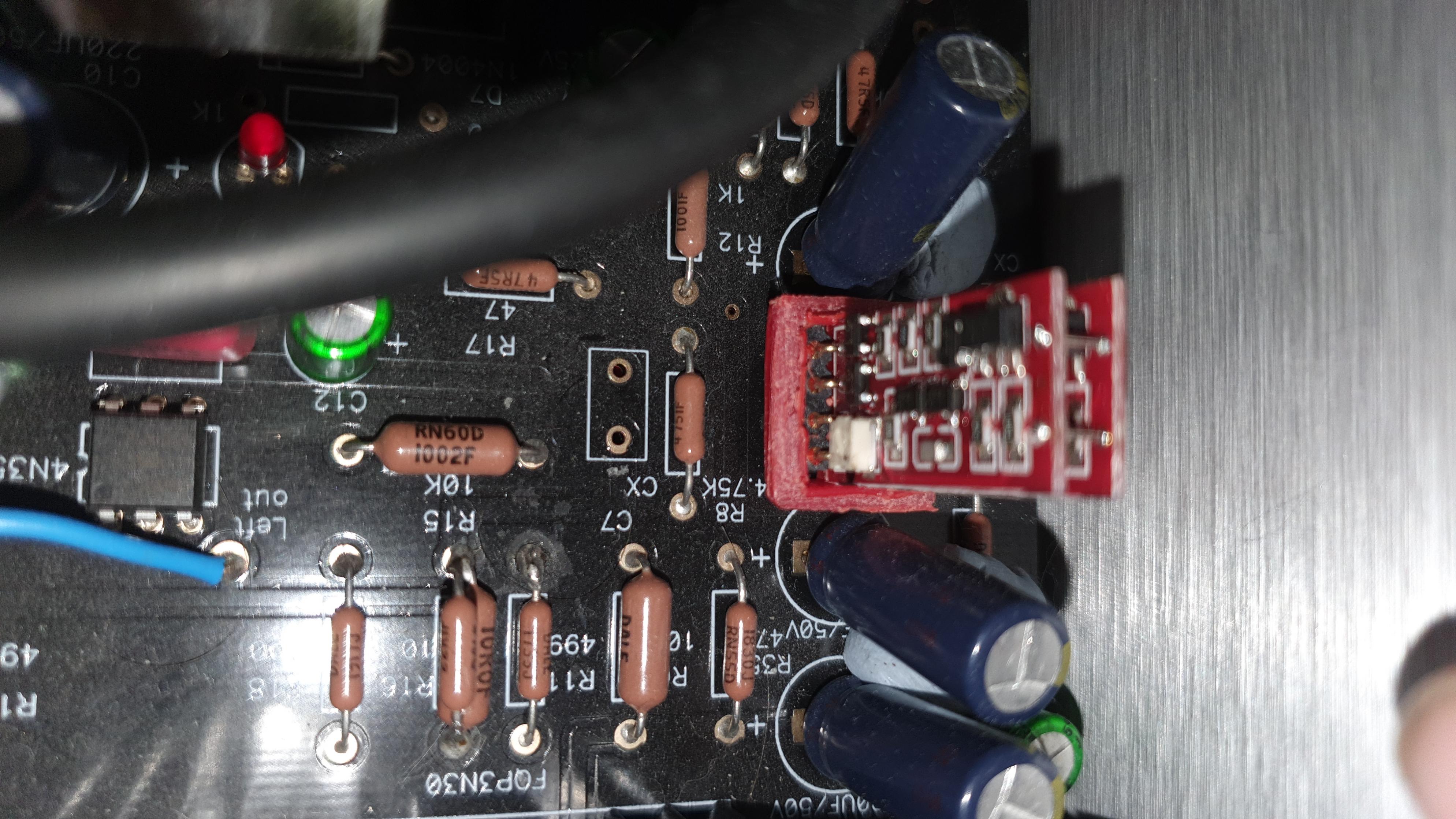

Hi Matigane,
Having 76*C on the Bursons is excessively hot (IMHO) - they should draw about 16mA at 25*C and rails of +/- 15v - the max ambient operating temp is listed as 52*C so I'd suggest reducing that IC temp by at least 40*C for reliability and longevity.
16 mA at 30 Volts is almost .5 watts and that will get toasty. A three watt resistor at a Watt gets pretty warm also.
About the current draw for Burson V6 data sheet says about 14 mA for a dual V6 but my own measurement in Whammy was 27 mA at -+15V or so. I raised the value of the serial resistors a bit to be sure the voltage got below the max. specification (I use red led as voltage ref. so have >16 V from regs). I wrote a mail to Burson about my measurement which is about double up compared to data sheet but got no response back on this one......apart from that they have been responsive.
I think the Burson V6 dual will survive many years. As I don't sell amps but only build for myself I am not too concerned. If it should break down one day I will take it as part of the fun. It sounds very good.
I think the current consumption specs on the Burson site are for the +/-15volt rails and the 600R load (that they use for measured results) - I have no idea why you would use nearly twice the current at approx. similar rail voltages in this application.
Yeah, they're tough little things and have a great sound - very dependent on the quality of the rail supply.
Yes, 76C is uncomfortably high, but consider that the ambient temp in the case is well below 30C, and that I removed the plastic cover which definitely helps the thermal dissipation.
So I would indeed be worried about running the burson in a not so well ventilated case and above 15V.
My measurements are fully in line with MEPER's,
PSU before the R36 is +/-16.8V.
After the R36, the voltage seen by the V6 Op Amp is +/- 15.4V.
Having 1.35V drop across R36 (47ohms), my V6 consumes 28.5mA. (I see the same value during idle/playback)
This is consistent with the second V6 vivid I measured, and the V6 Classic was more in the 26mA ball park.
If some of you want to try, you can remove the plastic cover by gently sawing the bottom, as seen in the picture.
Subjectively, I preferred the naked V6 vivid (I have a stock one for comparison): there was less bloom / bleed of bass and mid into higher registers, and the high are also less strident, which is my main reproach to the V6 vivid.
Interestingly, doing the same on the V6 Classic did not change the sound based on a quick test.
