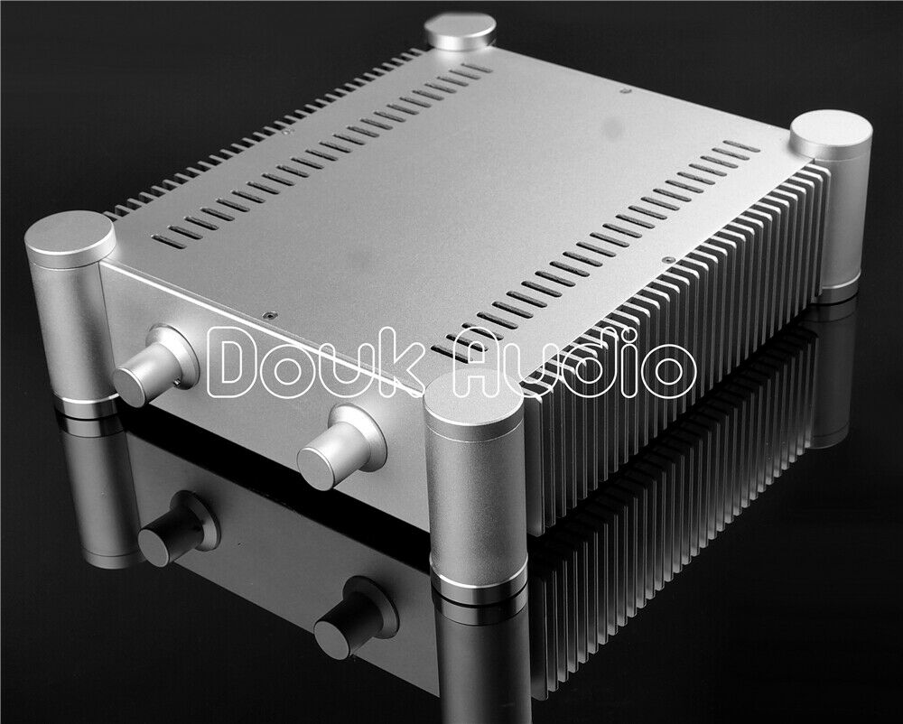

I purchased one of these cases with the same intention, at the moment, it's mounted on a piece of plywood.

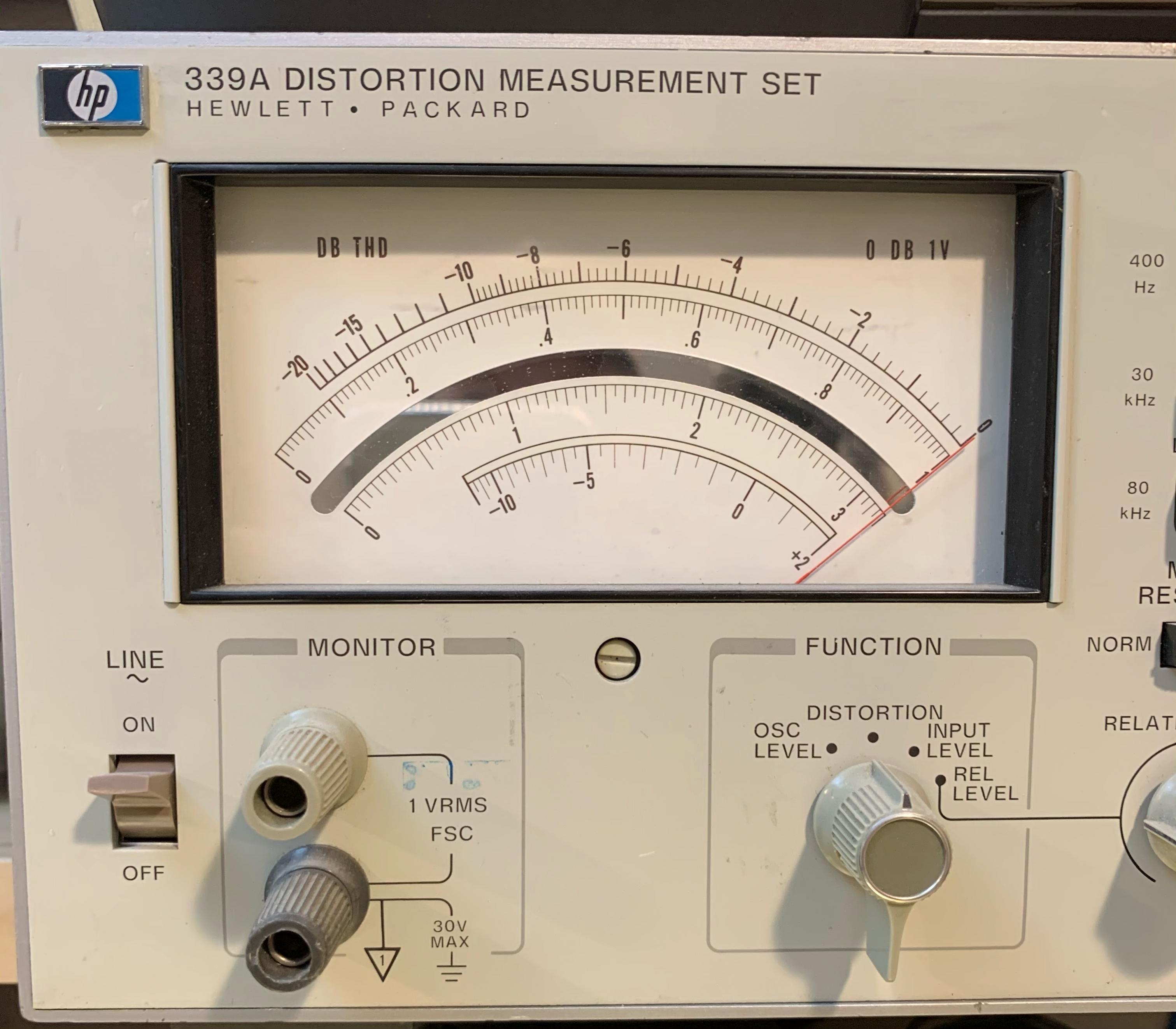

I did some measurements with audio precision. With the lowest thd op amps I ve tried, highest harmonics pops at around -110dB at full output voltage. (Since you seem to be interested in numbers)

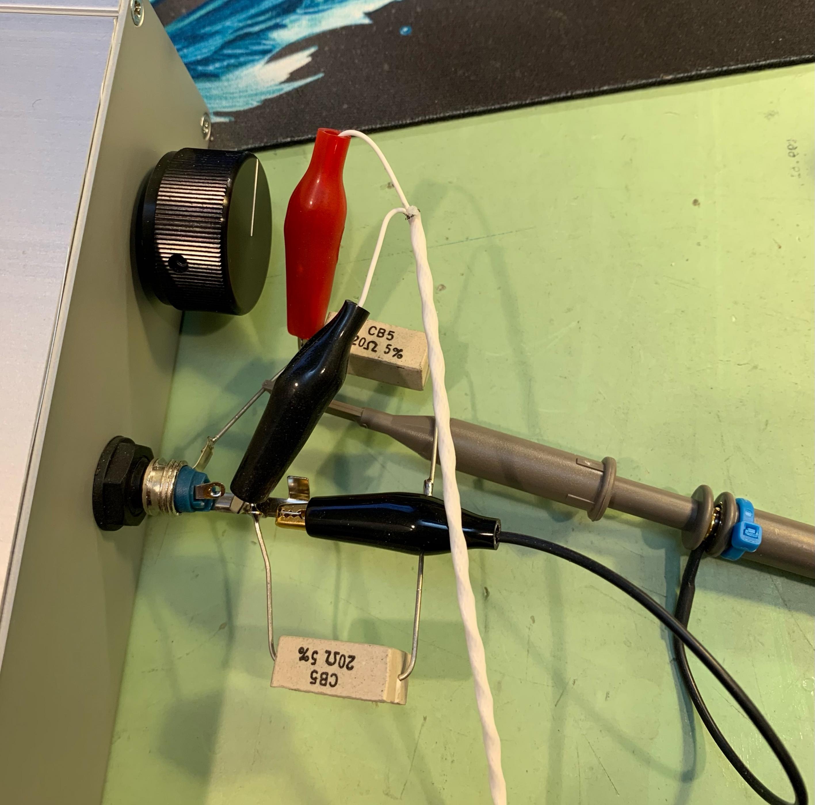

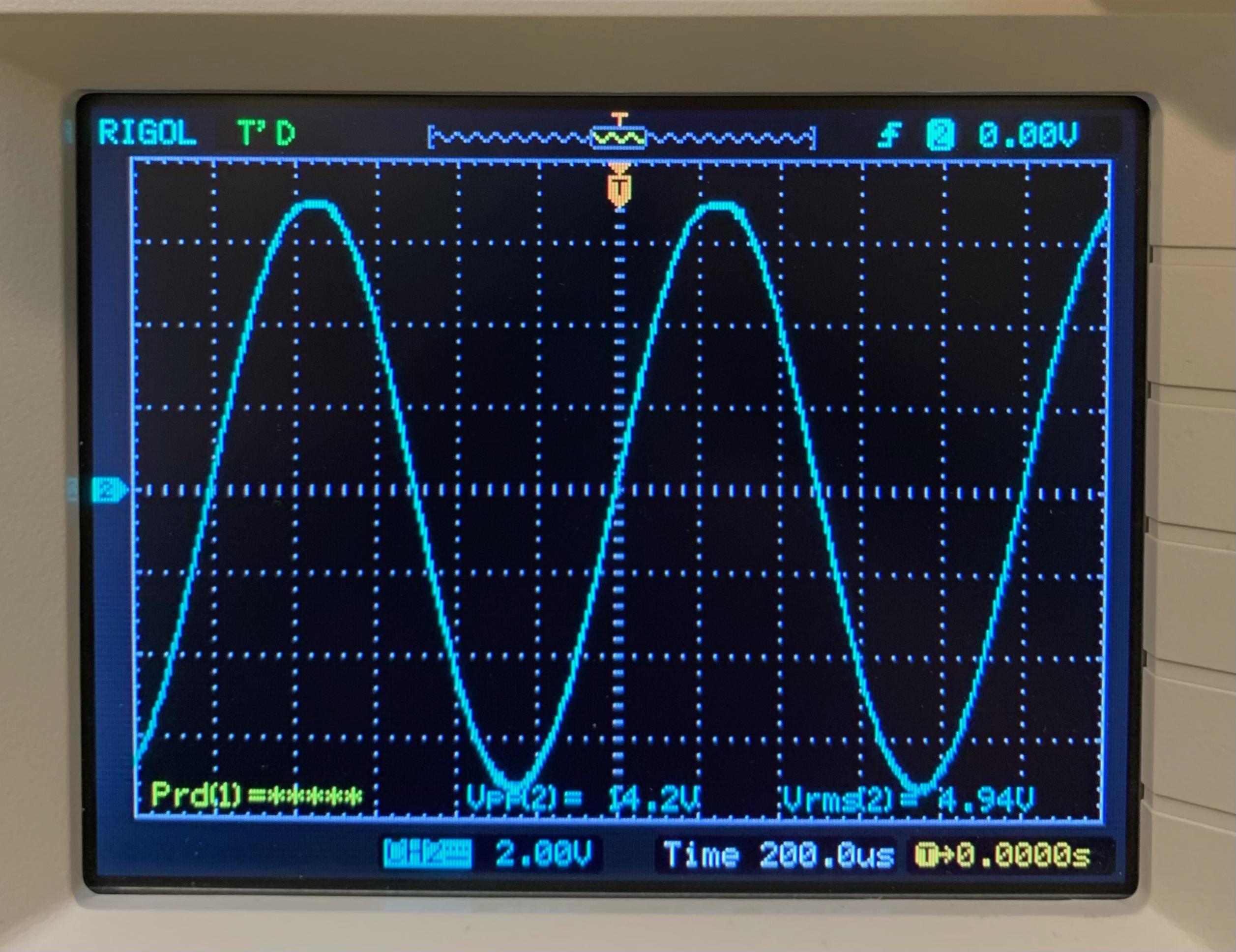

Being the curious type, I rigged up a 40ohm load for the whammy and measured it.
At 1% distortion (I.E., just starting to clip) it's happily pushing 4.94Vrms into 40ohms, for a real 610mW.
The least efficient headphones in your group are (from what I can find) 87db/mW.
For every doubling of power you gain 3db, so that series would be 87db/1mW, 90/2, 93/4, 96/8, 99/16, 102/32, 105/64, 108/128, 111/256, 114db/512mW, at which time you will be doing permanent hearing damage in a time less than a typical Beatles song, and the amp is still not clipping. You don't listen that loud, nor do you really ever want to.
Yes, it's possible to increase the power. But honestly, why? It's not going to make it sound 'better'... If you want to find happiness with this project, try a bunch of OpAmps and see which one delivers the most smiles. :yes:
