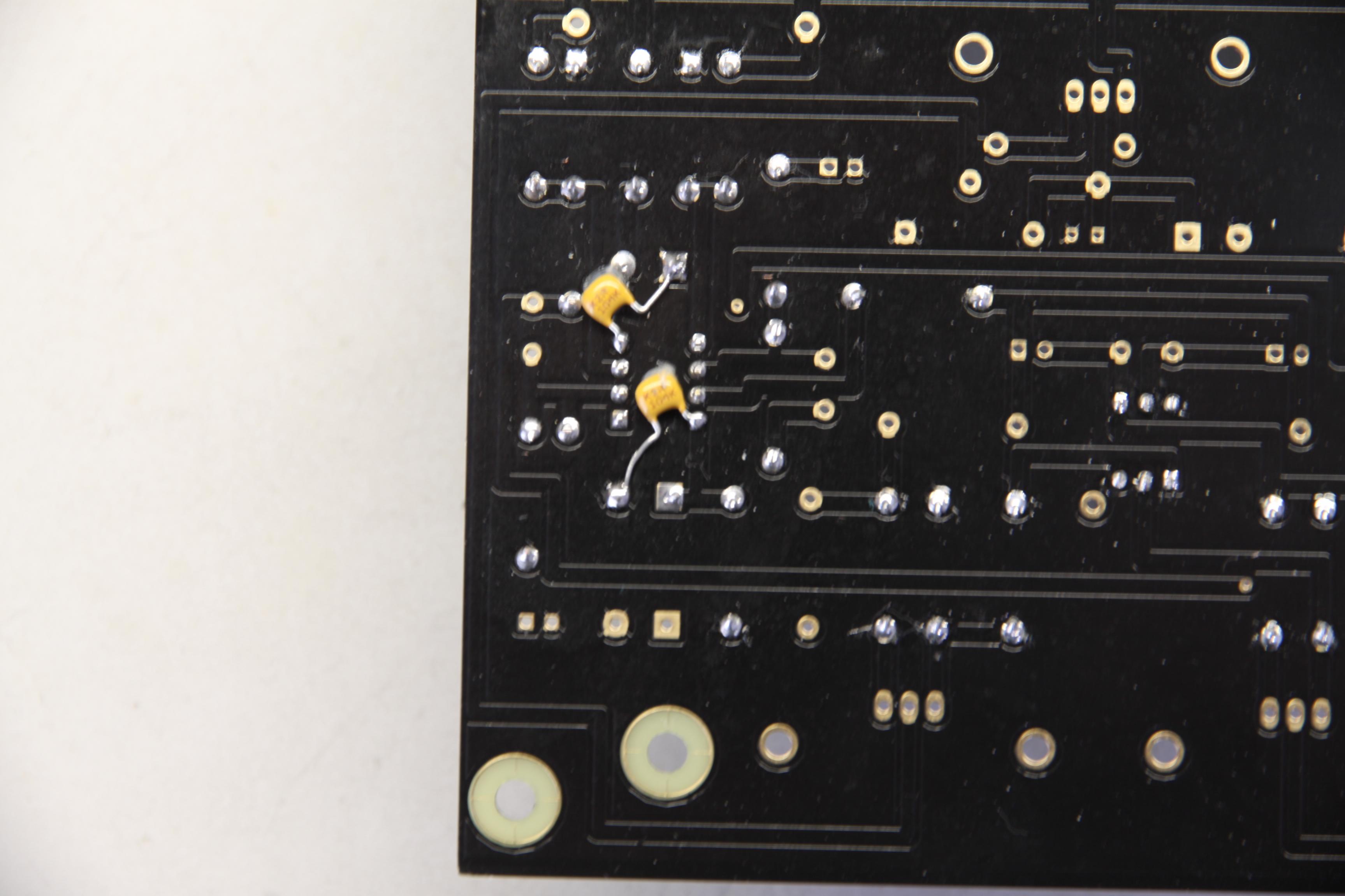

I am trying to debug my WHAMMY amp build. I based it on the BOM posted in this forum. Things are not going very well...
The power supply is working fine -- I used the red "led reference" option and I measure -16.95V and +16.93V on the rails.
The amplifier part, however, is not working properly. Regardless of what is connected to the input, with no load on the output, I see zero DC voltage on the "left out" and some random -1.640V on the "right out"
The question is what is the best way to diagnose this further?
I am using AD823ANZ opamp and IRF9610PBF/IRF610PBF mosfets. I suspect that either the opamp or mosfets might have gotten zapped.
I understand that it's nontrivial to diagnoze things remotely with such little detail, so, any suggestions are appreciated.
Attaching a photo in case I am missing something stupid.
On the photo -- currently not using C6 and C11 caps on the ps as I didn't receive the right quantity.

Are any of the heatsinks getting warm ?
Input voltages at op amp socket - pins 4 and 8 wrt ground?
Input and output wires: I don't think I've seen the shield used for ground.
More general question: what are the bang for the buck mods on this guy (other than rolling op amps)?
TIA

Can you post your photos here please? The link you sent requires joining google photos or something, which I don't have time or the desire to do.
Also, are you using the DIYStore Whammy board or your own? You did not state that above.
RE: the MOSFETs, have you tested them with a tester or using this technique?
How to Check a MOSFET Using a Digital Multimeter | Homemade Circuit Projects
--Tom
