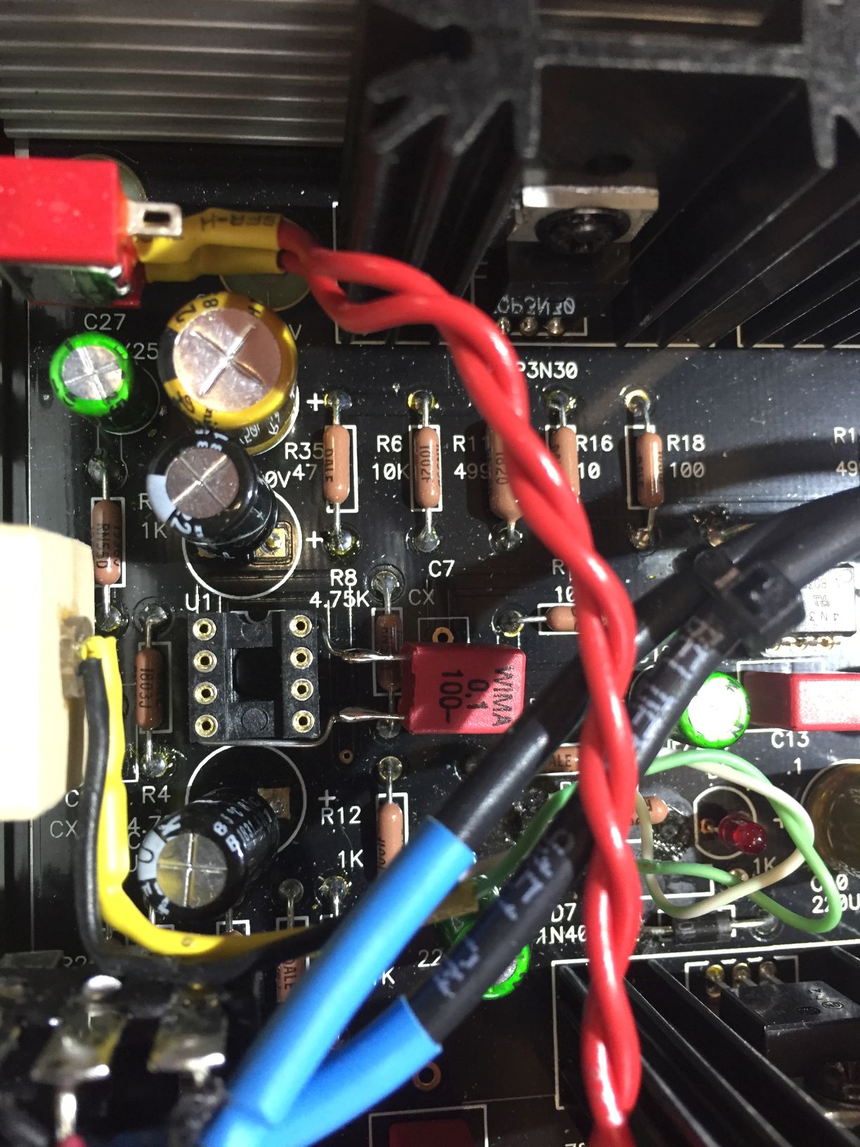

Your responses to my Burson post challenged me to dig further into the opamp power supply. I decided to add a second stacked socket with the Burson-recommended 0.1 MKP cap mod. It also gave me a convenient place to measure the power supply voltages right at the opamp pins. I found that using only the red LED regulator references, the voltage at the pins was still well within the Burson spec:
Main Rails: +16.7 -16.8
Opamp Rails: +15.45 -15.53
That's about 1.25V drop across 47 ohms. 1.25/47 = .0266 (26.6 mA).
So, the Burson V6 Classic does draw more than specified, at least in the Whammy circuit.

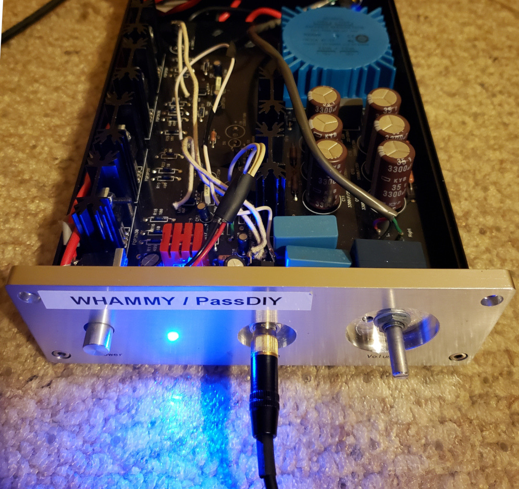

It came thoughtfully packaged with 2 DIP-8 adapters. I had already installed such an adaptor in my Whammy.
My build was with the PCBA from the diyaudio store. I sourced parts myself and stumbled many times with lots of rework.
Supply: +/- 15 V straight regulators. no LED or voltage divider
Input: Samsung Galaxy S9 plus. Volume two notches below maximum
Headphones: Sony MDR-7506
Gain with the Vivid V6 seems to be higher than with the baseline OPA2134PA. Gain matching was by ear. I realize this is not as accurate as with instrumentation. This was not a blind test. I heard the songs below with the OPA2134PA and then swapped it out for the Vivid V6, leaving everything else the same.
I had to move surrounding components a little. The footprint of the Vivid V6 is a little larger. Luckily, the box I used is big enough for height. so I'll let it stay a while.
