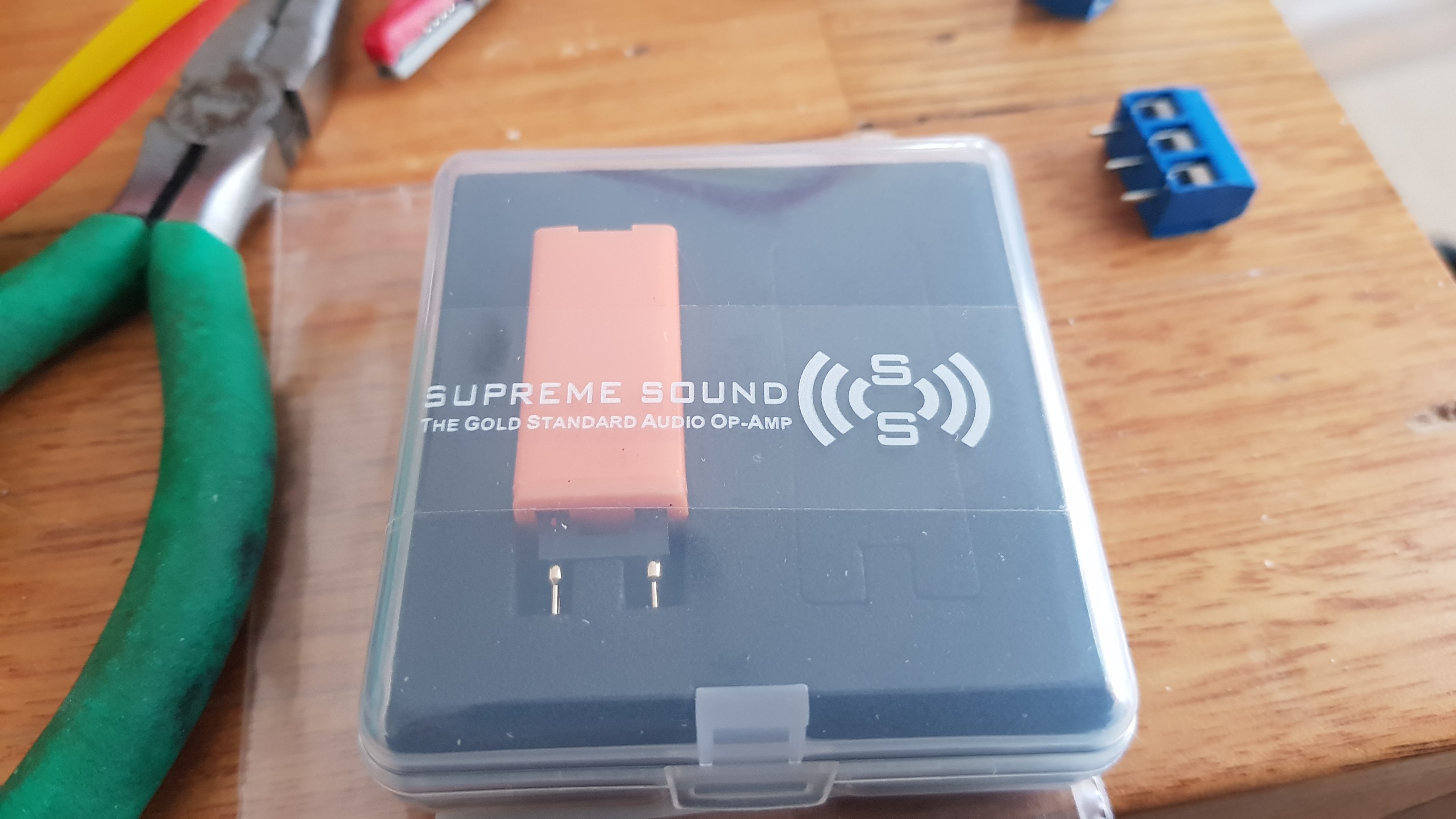

New try on mostly SMD Whammy.
First testrun finished successfully.
No burning components till now 🙂
Final wiring required to test the sound.
No OP amp rolling possible I have settled on AR823.
Hopefully this was not a mistake.
Testet in my old Whammy with OPA 2604 but wasn`t much impressed.
Some tested the AR823 in the whammy results sound not so bad.
This is incredible. Love it.
Thanks a lot.
I also like it in its own way.
Yes you are right. AD823. Typical typo.
Maybe do you mean the AD823 which is a JFET input, dual opamp from Analog Devices?
Google finds no opamps called AR823 ...

Its hard to see from the package, but did you go with the classic or vivid? Interested in hearing about your listening and/or testing experiences with these.
It's the classic.
I had already informed them which one I was interested in before other people said what they liked.
I have a few other opamps to compare with though, so it will be fun.
