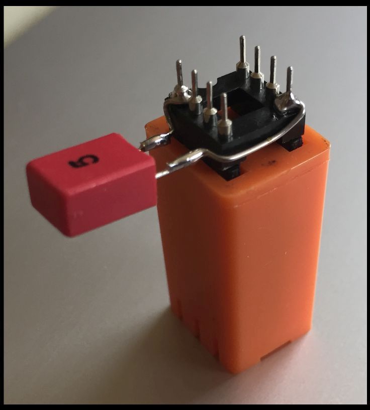

Burson V6 MKP Cap Mod
I thought I would share how I added the Burson MKP cap mod to my Whammy. Extra DIP8 socket, scrap resistor leads soldered to the pin shoulders, careful not to get solder on the pin extensions.
Note: I also replaced the original adjacent original spec 50V electrolytic PS caps with smaller diameter 35V caps to make room for the Burson plastic housing.

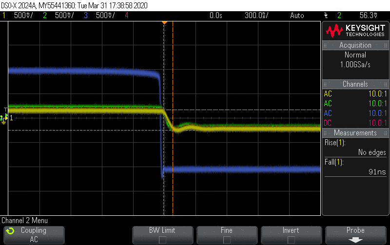

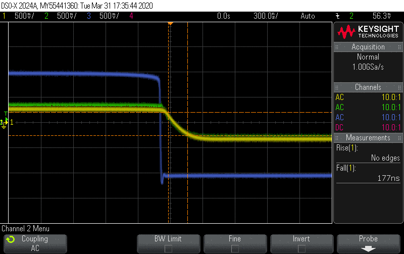

As already posted before, I checked the 10kHz square wave response with a scope and saw interesting behavior when zooming in on the transient:
Vivid seems to have 2 slew rates (4.2V/us and 25V/us), with the fast one only working at low levels and being "under-damped" Maybe that explains a tendency to exaggerate details.. hmm:
Classic seems to have a single slew rate of 15V/us:
Note that we are talking about events in the MHz range way out of audio band.. who knows

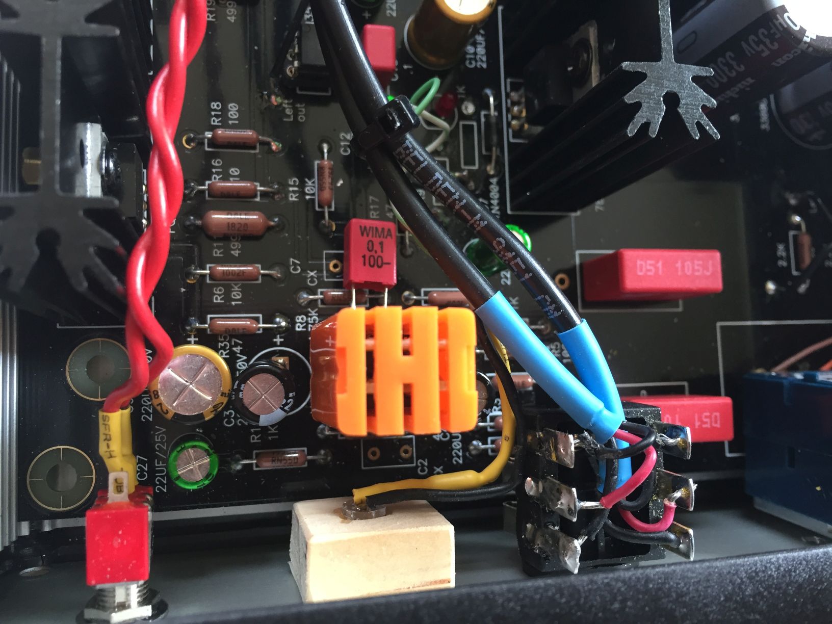

Power on indication
After spending some time with my second build, and giving thought to a third one, I had one of those moments when thinking about power on indication. For those running the LED voltage reference, try running a short piece of fiber optic cable from the LED to an opening in the front panel. Short, sweet, and simple. Probably give this a try for v1.3 later this year...digging back into ham radio right now.
