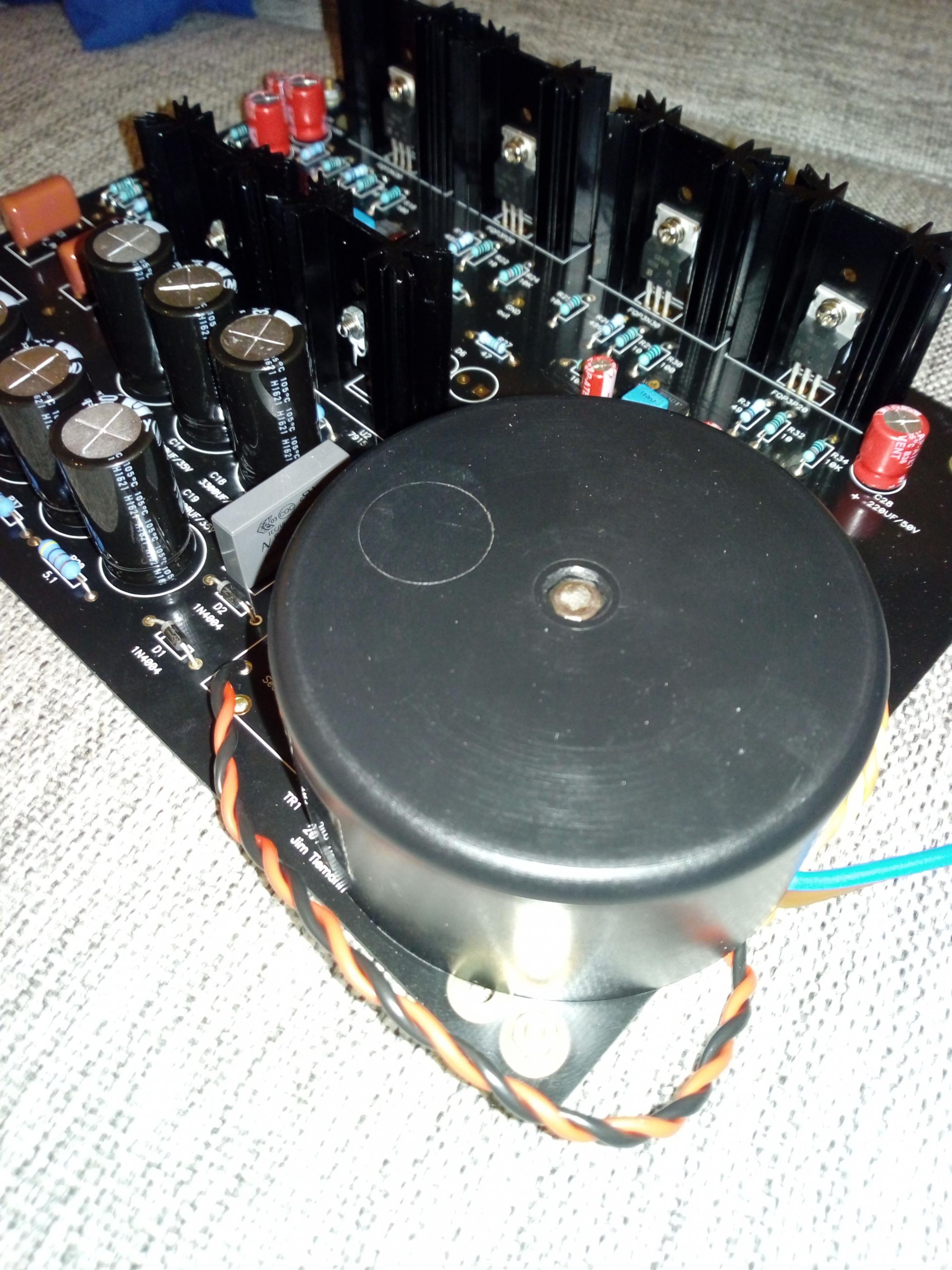

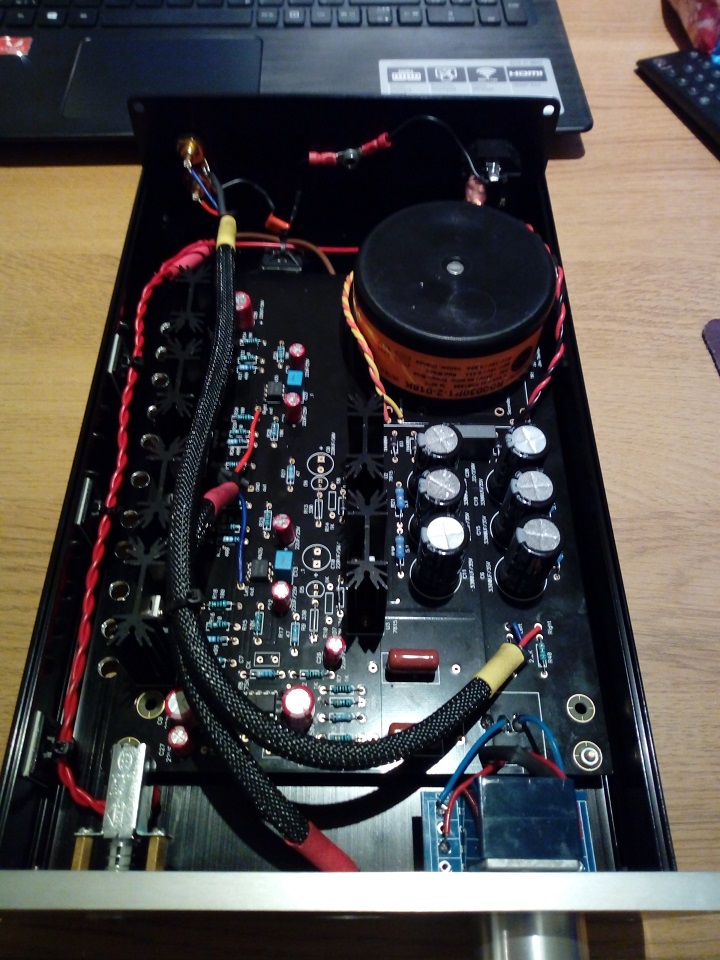

As others have pointed out, 18V transformer is plenty. You can also use any other encapsulated or potted transformer. Like this one (30VA 2x18V).
You only need to drill one 4-4.5mm hole in the PCB.
