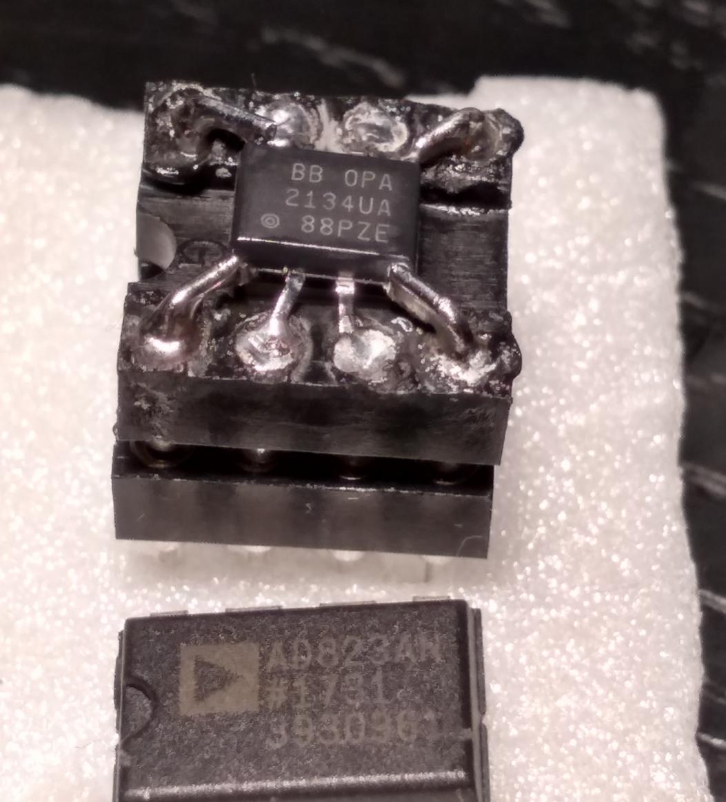

This was my first try in soldering SMD devices. It does not look very nice but it works! 🙂

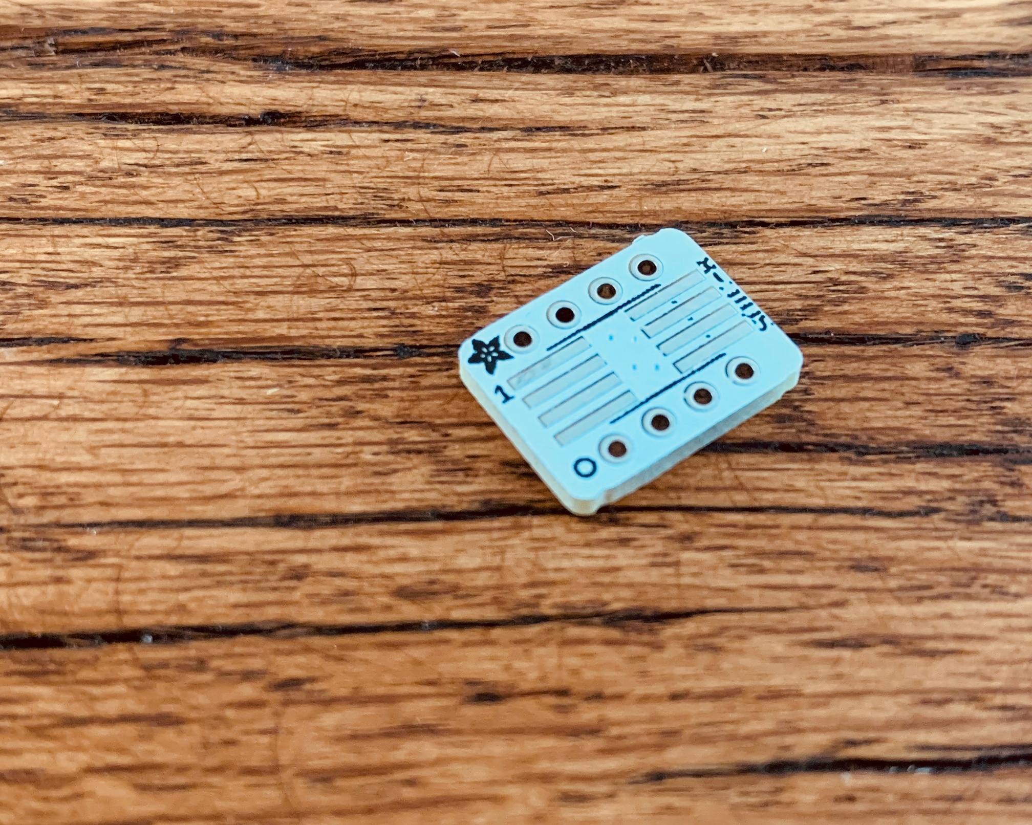

Finishing up a DIYA project to be released this month; it includes the forehead slap "oh duh" realization that it is possible, practical, and perfectly legal to include two DIP-8 sockets on the PCB. One of the sockets marked "SINGLE" in top silkscreen text, and the other socket marked "DUAL". Straightforward design allows the user/builder/listener to plug in and use either a single opamp (one amplifier in a DIP-8, such as LT1122, AD817, OPA627) or a dual opamp (two amplifiers in a DIP-8, such as LM4562, OPA2134, NE5532). All it takes is an extra DIP-8 footprint on the PCB and the ability to connect things together properly.
What about SMD opamps? They're not very interchangeable so they're difficult to swap in and out for experimentation ("opamp rolling"). My approach is to mount them on SOT-to-DIP8 adapter cards and then plug those cards into either the SINGLE socket or the DUAL socket, same as with thru-hole parts.
