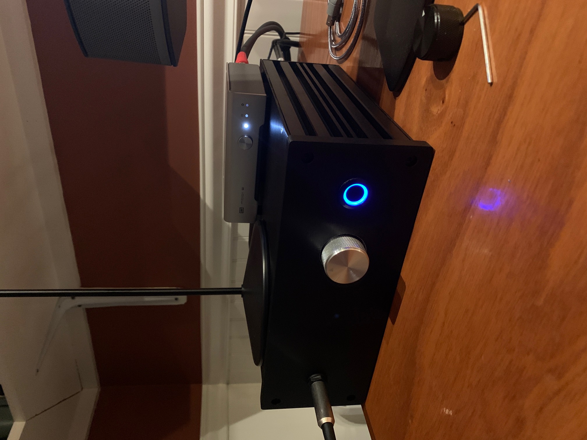

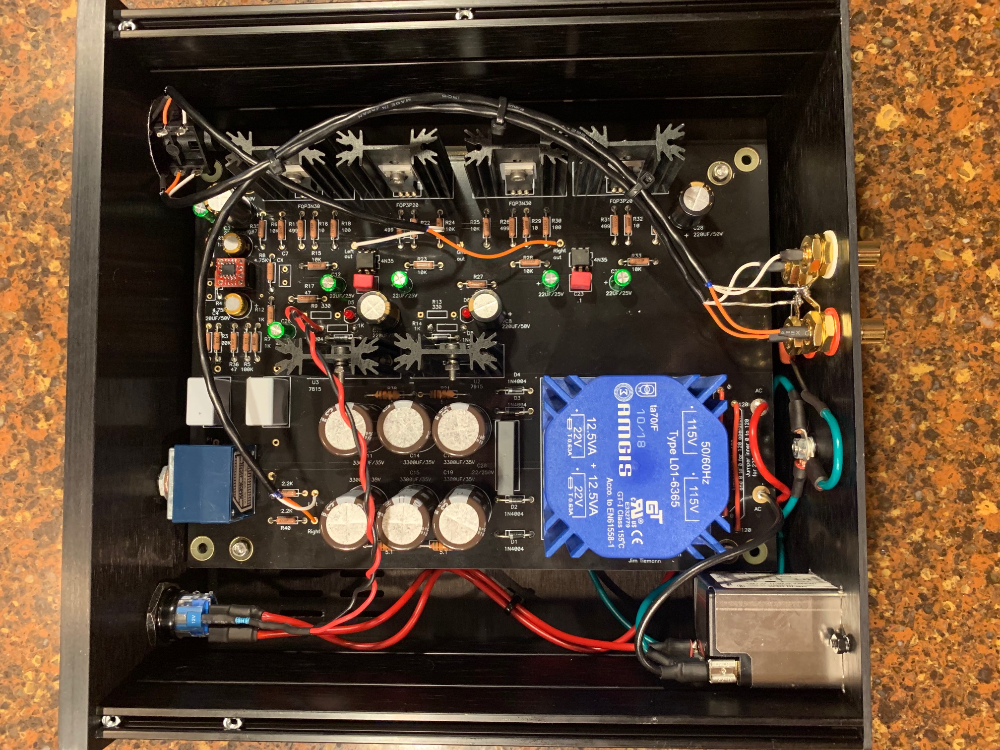

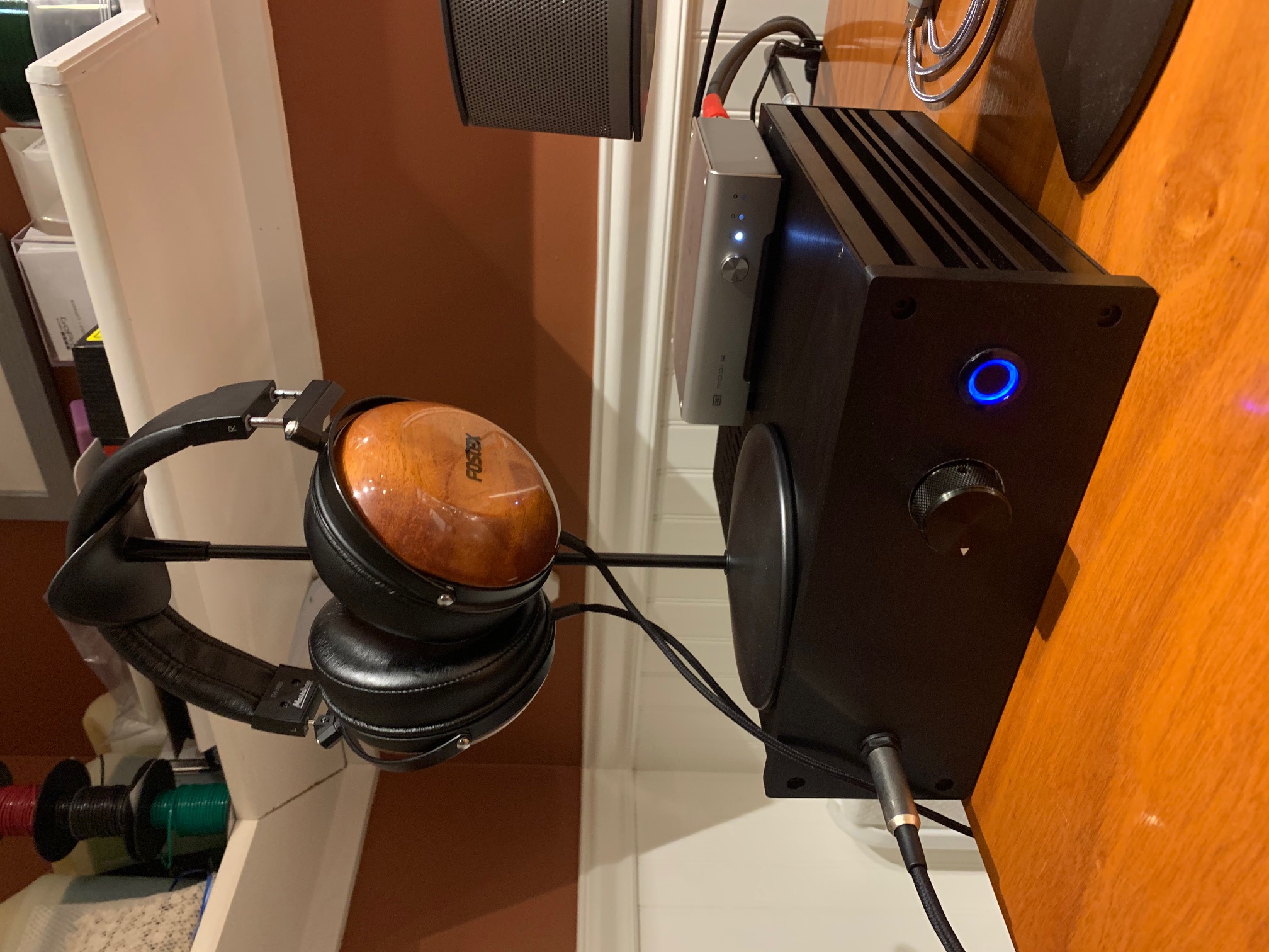

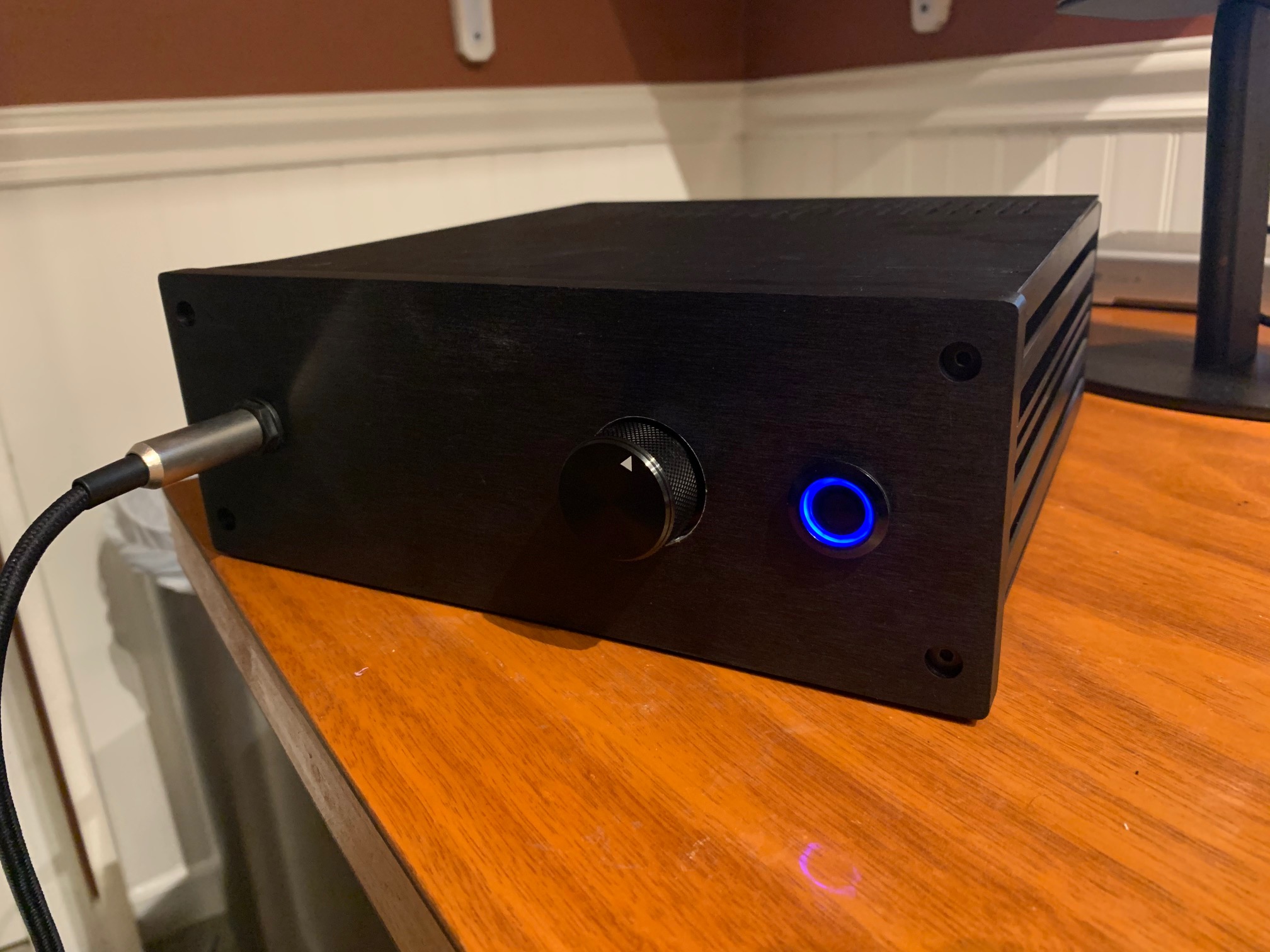

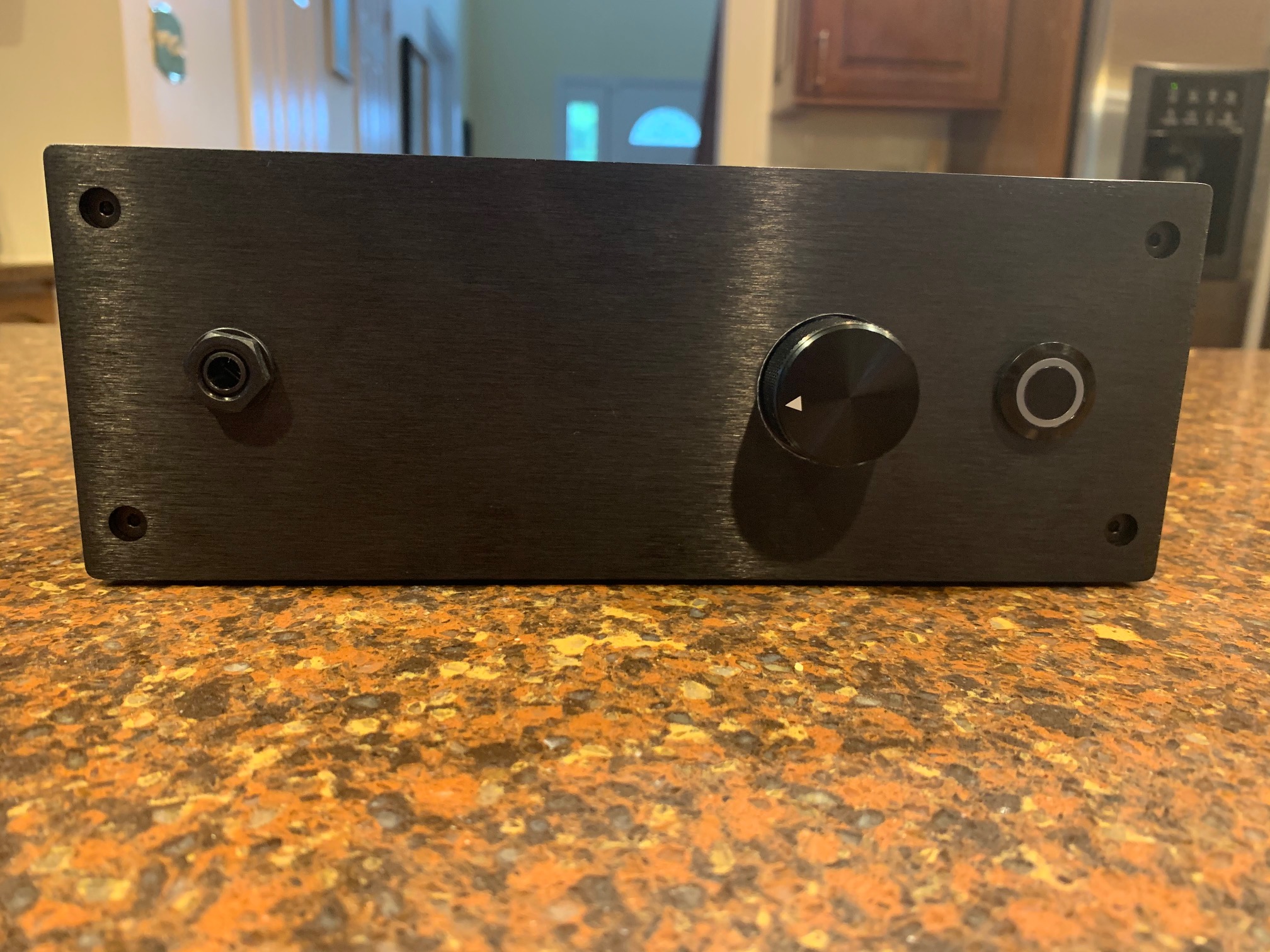

Hey all!
Thanks again for all of the assist on this.. Thanks to 6l6 for the great instructions, Wayne for the design, pFarrell for being a great friend and helping me endlessly.. 2 picoDumbs, and avdesignguru for stepping in with some suggestions and tech support!
Overall, I'm really happy with the finished product! Had a buddy with a drill press and a lot of patience help me with cutting the holes in the galaxy 2U case. The Whammy is perfectly quiet, no hums or noises.. The only 'janky' part was that I didn't recess the volume knob fully enough and couldn't get the nut on the POT.. So I had to run a ground strap to the rear.. I tried to solder the ground wire to the front face of the pot, but it was taking so much heat, I was worried it would damage the POT.. So don't look to closely.. lol.. not proud of my solution, but it works for now..
I"m listening via Tidal/iMac -> Modi Multibit --> Whammy -> Fostex TH-X00's
My first HiFi experience, and very happy!
PS.. swapped out black vol knob for the silver one.. much bettah..

SkyPirate, it looks like you found the same solution I did for the LED power: the pads on R9 and R10.
What did you use for the power switch? It looks great!

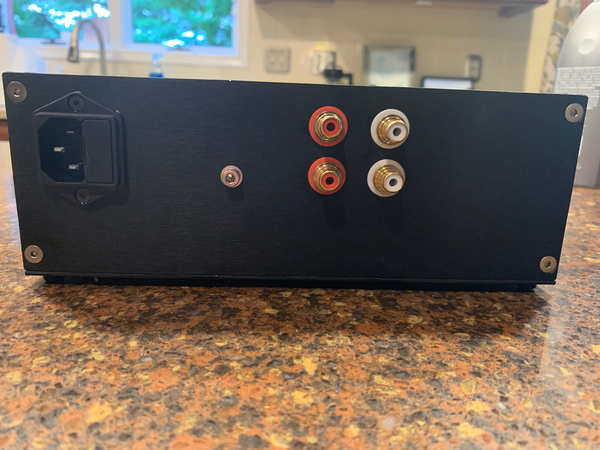

Did you wire it for pre-amp output with a switched jack?

Thanks for the kind words.. I def leaned on a bunch of folks with it. I did use a switching jack and wired for pre-amp.. I don't know if I'll ever use it for one (pfarrell trying to talk me into building power amp).. but just in case!
As far as the switch goes, I used the rec in this thread somewhere..
APIELE [3 Year Warranty] 19mm Latching Push Button Switch 12V DC Angel Eye Halo Ring LED Metal 0.74" 1NO1NC SPDT with Wire Socket Plug (Blue LED/Black Shell): Amazon.com: Industrial & Scientific
It worked very well.. Came with a cannon type plug that's pre-wired but I didn't want all of that bulk in the case, so i just connected my wires direct to the spade terminals with female spade connects..
