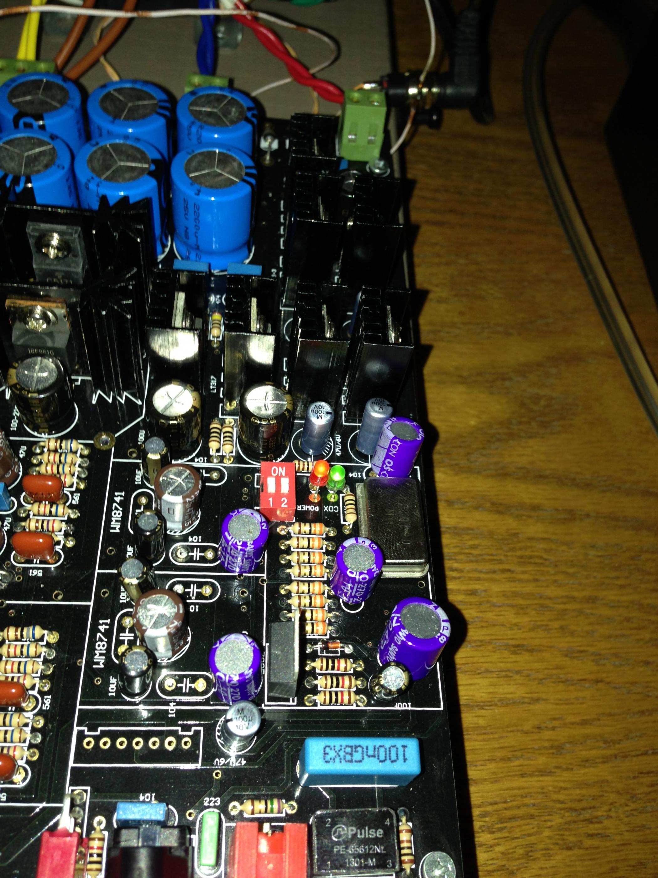

Here is a pic of the setup that I keep in my top desk drawer at work;

Heres my Mod list on my DAC7 with dual WM8741 chips:
replace 4 opamp biasing resistors from 1k7 to 4k7.
(1k7 is way to much load for the op-amps.)
replace 2 opamps with MUSE8820
remove all the blue 0.1uf capacitors
replace 5 supply capacitors with os-con's.
(The clock and WM chips love the increase in clean power.)
This is money and time well spent I'm very happy!😎

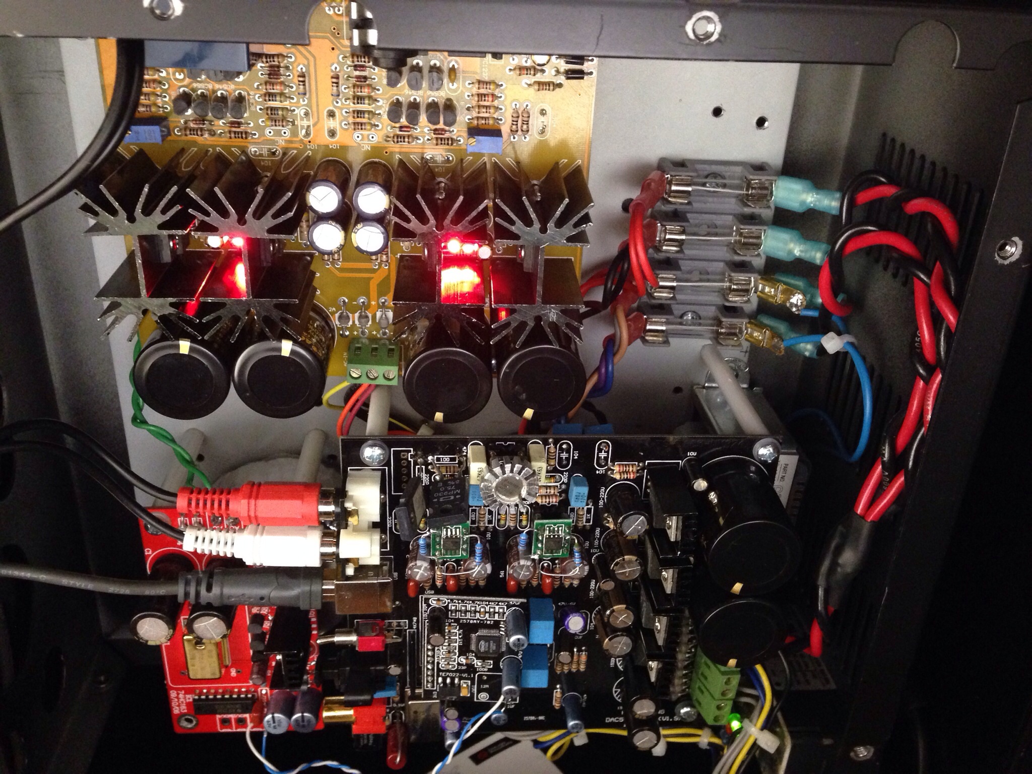

So I decided to rearrange my components inside the metal case I'm using to free up some space for some burson op amps in the future. The shuffling around of the transformers and boards went fine, however, when I turned it back on again, I was rewarded with a "device not recognized" code from windows🙁
I will order another board and hope that takes care of it. I really wonder what I could have done to cause it to die, no issues during construction, maybe esd possibly, who knows?

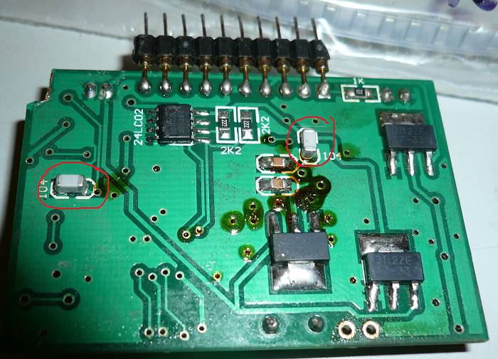

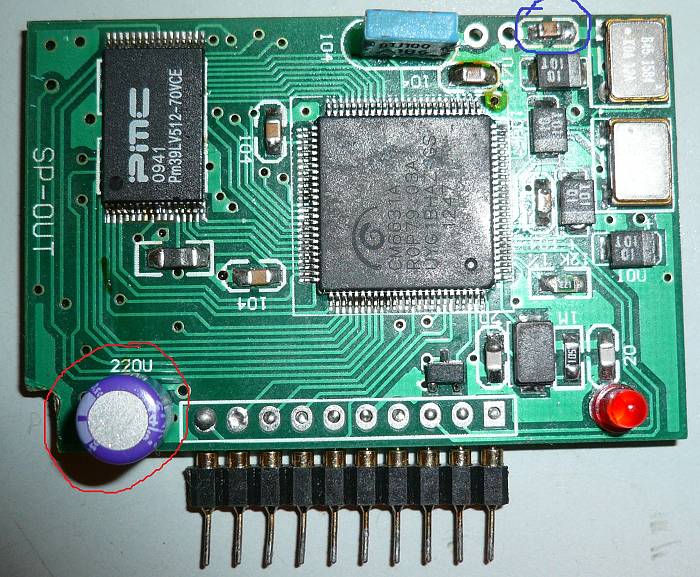

share my 2cents, did some mod, not the dac board,
but the 10pin cm6631a usb card which comes with the DAC5 (transplant to the 9018 board now)
Have improvement extending the top and bottom.
- replaced the bc 100uf with oscon sp (red circule).
- replace 2pcs X7R 0.1uf with CP0. (output from 3.3v regulator)
Orginal comes with unknown grade ceramic caps.
I did try replace the 104 caps next to clock(blue circule) with a 0.1uf CP0, however, SQ becomes bad.
enjoy ~😉

Here's the photo I promised. It's great to see people testing different components and sharing their results. The OSCON's are great at noise suppression. It may be beneficial to add them on top of the 104's.
I managed to get spdif to the main board, and the output sounds like playing cards in bicycle spokes. It looks like the problem with mine extends beyond the usb board...
Now I need to decide what direction to go from here. Am a little hesitant since I really don't know what or how it went bad.

I think I found the problem: there was a tiny, flat piece of loose solder between a pair of pads that would have grounded the signal out from the 8741, so at least I now have a clue as to what I've done. The piece was close to one of the resistors near the opamp socket, and the nearby 104 box capacitor. I did break protocol by not blowing everything with compressed air as usual, and this is the price.
