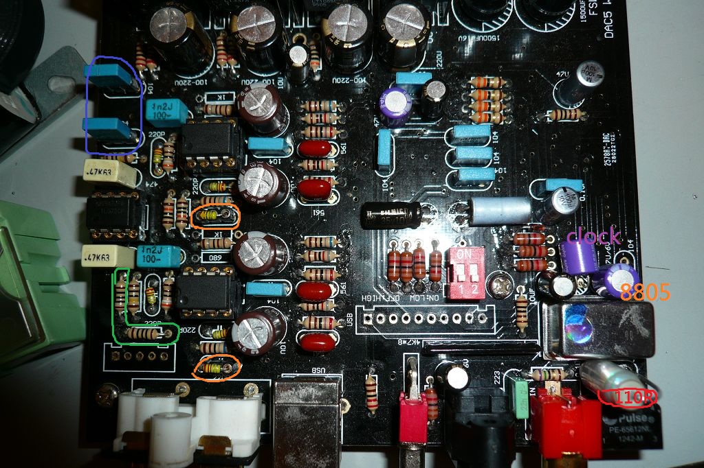

phase: the "L" shape in green color are both RR14&LR10 in signal path(100R) you are looking for. please share more details of better resistors.
i don't have a scope and don't even know how to use it.
Orange circule color is the RC3 in opamp feedback path, installed a socket for the mica cap 220p.
- removed the C6 (104) film capacitors next to clock, i guess the oscon has enough low esr.
or i may try put CP0/X7R SMDs if i can get some of it.
- replaced the R5 (110R) for dale, no idea which series it is, original come with bejing718factory 1%.
- installed socket(in blue circule) for TU1 and TU3, may try some mkp or kp series and see what it will sound.
I will let the R5 run in then i will try the mica capacitor. I want to try the low impedence resistor from vishay s102 for R2, R5, LR4&8, RR4 and RR8 (feedback resistor and coxial input), any better/cheaper suggestions?😕 The s102 aren't cheap(lots $$$)...
after i replaced parts, i can immediately heard the difference.
i will just let it run 24hrs for a few days with low volume.

Yes. 104 film. Parallel with the oscon(upright position) on right hand side, just above the XO.
This is the mica i'm using for last 2 weeks. Treble has extend further and more transparency. I may pick up some philips silver mica and try later.
After various mod, bass and treble has extend, however i find out 3 negs:
1. mids now become very dull & thin(e.g. paino solo).
2. the 317/337 regulator output is almost 17v, i had a 16v 100uf as output capacitor.
3. the pcb has tons of plating through hole, some capacitors are way too far from regulator
Done something:
removed the 104 smd from pcb for 8805 digital supply underneath, which is connect together with oscon.

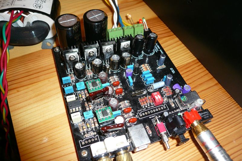

Kent, I see your picture, and the 220p locations, hopefully the parts burn in and settle for you.
I might try some film caps there and see what happens.

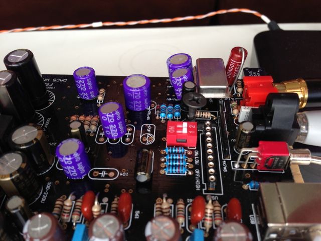

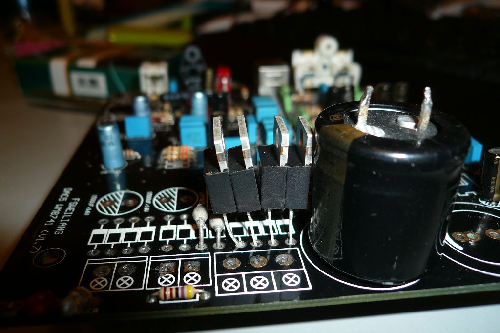

power supply caps
I removed all the 100nf bypass capacitors and the all the cheap round 100uf's.
Once you remove the bypass it enables you to use 3 of the 5mm holes for much better larger caps and the other 3 are a much smaller 2mm spacing. I ended up using what I had. My next mod will be to change the digital decoupling (currently silmac ll) 2mm spacing with Nichicon LF, one is laying down and the other is by the reg.

The most noticeable change really was from the 100nf caps, cost a about $7,replacing them made the opa627 able to be heard. I have an opa2134 coming to replace the tl072, should be here by now actually.

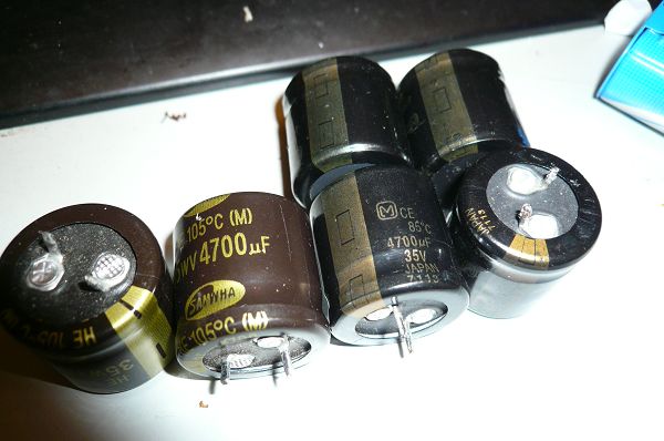

I had some Samwhas come with v1.7/1.9, that was horrible(guess due to minimal cost)
replaced with a nichicon(unknown series) at very begining ( come with v1.3 labels were buried, markings were all fade out not sure if fake, but maybe old stock).
Got tired try to get better mids, replaced with a bigger & better nichicon kg . I agreed that main capacitor makes a significant different. Before the mids were dull, percussions were appear in front of the volina 😱 . now they locate where they should be.

I haven't found many caps that will fit where the large ones are, most are 30mm at least.
Maybe I should just get the aerovox...
I have heard that the crossing frequencies don't always sound natural when bypassing, maybe Ill try taking a couple out the next time I'm in there. I do like how more room is created by removing the small ones to make way for some decent parts.
The os-cons sound very good on the clock, and on the dac chip also.
philips do have a few 40v capacitors that fit on this board.
