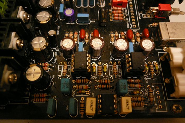

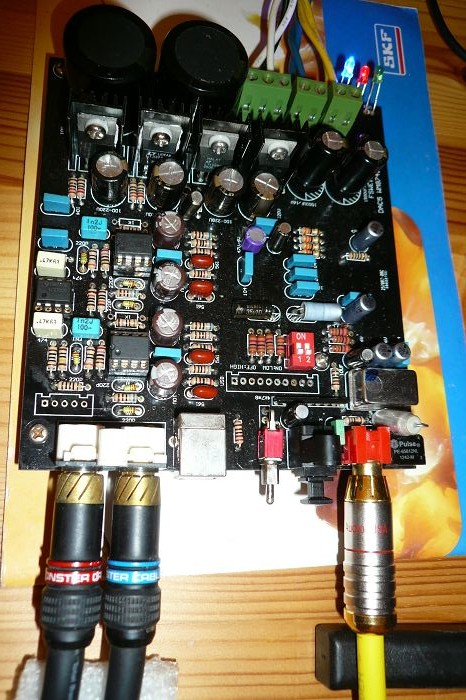

For a absoulte beginner like me, play and learning(try improving or messing up) the electronics with
my little dac5 seems to a good start.
v1.9
orginal with LT1117 instead of AMS1117
1. LM317/337 replace with LT317/337, get a crisppy sound.
2. Remove biasing A for opamp(LME49720), is getting too hot, suggested by weilang.
3. by adding 2 extra capacitors on the main capacitor, i get a bit more deep bass
4. replace the orginal BC013 10v/100uf on wm8741 pin8&9 with a oscon 6.3/47uf for digital supply.
* Muse 50v/47uf and elna 35v/0.47uf
**3&4 has a very much improvement, especially with oscon SP on digial circuit. more pleasant to listen with this little dac.😛

Can anyone show me where the output resistors are on my version 1.9?
I have some foil resistors to try in their place, but haven't been able to locate any 75 ohm resistors without lifting anything anyways.

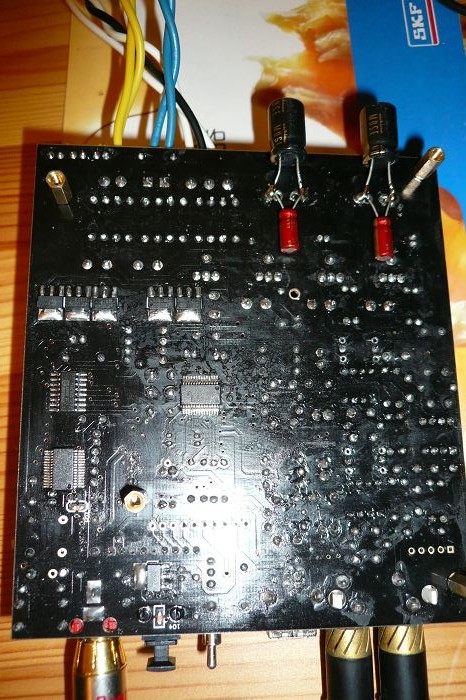

I have done another simple mod, replace the philips 10uf/6v to oscon on the LT1117 output cap to 8805. sonic changed, but wasn't as i expect as good.

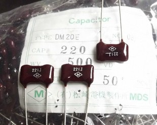

i've also brought some 220p
by reading other opamp circuits, replacing the RC3 & RC6 with the caps on above they said have some improvement. is that ture?

I appreciate seeing the pictures of the resistor removal, might try that too.

Any idea which are the 100R out put resistors?
Suppose I could poke around a bit.
I have some film type resistors that may benefit in these spots.

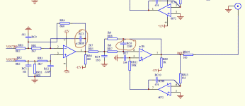

I haven't done the color band capacitors RC3 & RC6.
Read some posts before, said too big or too small will make the omamp self-oscillating.
Some say replace ordinary color band with mica capacitors can use a smaller capacity, is that ture?
And i don't have a scope, therefore i will leave it untouch at the moment.
100R output resistor:
replace 100R with film capacitors? replacing it or add an additional?
