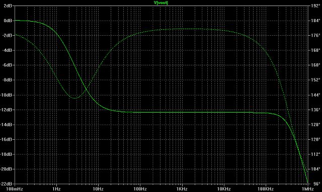

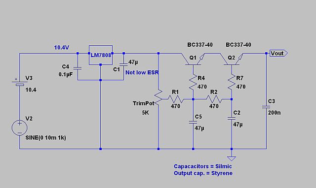

Finally had time to do a little work on my DAC5. Courtesy of Mr Weiliang I got a scheme, and immediately saw that WM8741 analog PSU is possible to significantly improve. Original PSU is simplest possible - LM317 with two resistors and two capacitors, nothing less nothing more.
For simplicity I chose to make a PSU with LM7808 and cascading cap. multiplier on output. Everything is located on a small PCB 2x2 cm and were used on both sides of the PCB.
Final capacitor is my favorite capacitor for audio - Styrene. Placed close to the DAC chip.
Their efforts paid off. I recommend to all owners of this DAC that changes the analog PSU for WM8741.

Do you set the output to 5 volts?
Is that also on the Vb pin of the connector (pin 1)?
Yes, Vout is 5V. Set this voltage with 5K trimpot.
"Conector pin 1"..... You mean pin1 on 7808 or what?

I controlled output voltage of my new regulator. Dropped to 4.88 V on DMM. I set it to 5V and closed the box.
Really step up in sound quality.

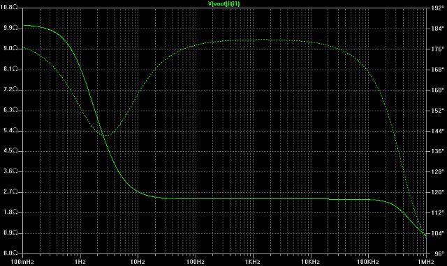

Just answer on some questions received in PMs.
Yes, cap. multiplier fully linearized output characteristics of LM78xx, LM3x7 or LTxxxx voltage regulators.
LM78xx spice model has in "Examples" folder in LTspice. For 8Vout, Rx should be 2.89K.
You can simulate with LT1085-12 also, just for checking.
I use cascade cap. multiplier because it sounds better, for my taste, than single CM.
Best diying.
