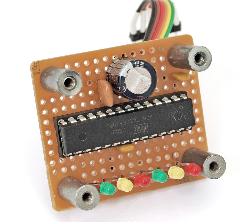

here's a link to an spdif 'meter' I designed for the arduino. its cheap and mostly easy to build. it does depend on having a wordclock pin on some chip, as its basically a freq counter in firmware and maps the wordclock freq to a discrete led for your front panel. if you have i2s on a system, that will have wordclock.

pic of it:

That's very slick. Maybe someday soon I can make some time to start something like that, I like it.
I really want to get boards made for that spdif meter. a lot of people like to know what their sample rate is (to know that their audio is not being resampled).
I don't love doing pcb design, though. if anyone wants to take a stab at this, I'd be more than happy to help out with the schematic or connection netlist, but I just hate doing eagle work (which is the only pcb designer tool I know).
maybe there could be a group buy, as well. the more the merrier.
