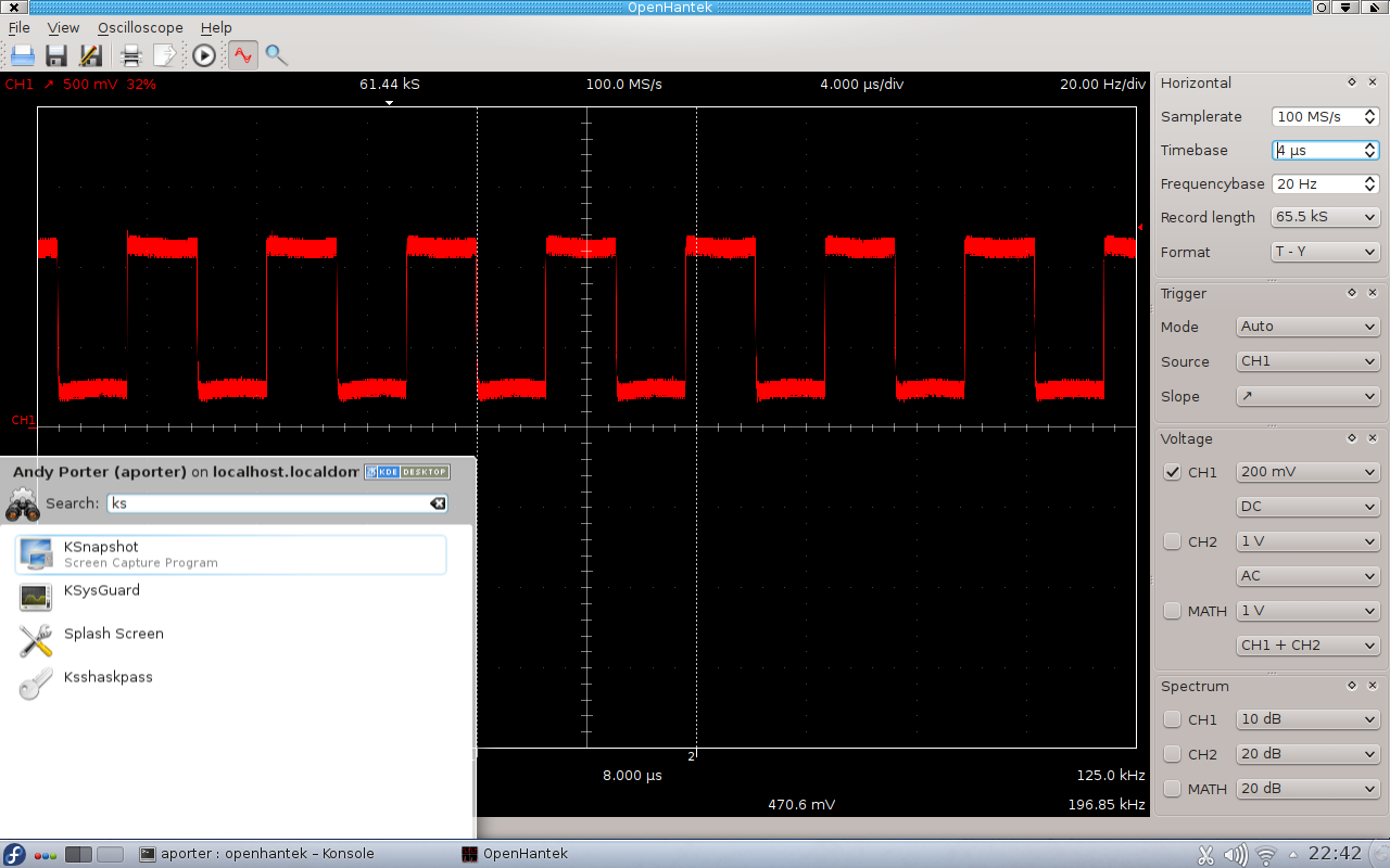

I have a v.1.9 of the dac5 bought as a kit from Weiliang (without the USB board) and am after some help in debugging it. As recommended when @bcmbob was working on his, I've checked the outputs of all of the voltage regulators and they're all fine. However, the only sign of life that I get is the power LED - I've tried driving it with both optical and coax inputs but I hear absolutely nothing. (I've tried toggling the input selector switch, again to no avail.)
From posts earlier on this thread I realised I'd mounted the oscillator round the wrong way (it was getting very hot). I've now got it orientated correctly but nothing obvious has changed so I'm thinking about the next step. First off, I'm wondering whether I could have broken the oscillator by having it the wrong way around. Does anybody know?
I think a burned out oscillator is a good guess. What test equipment do you have available?

I have a multimeter and a hantek 2150 DSO. However I'm not too confident in the scope -it's about 20yrs since I last used one. I'll order a new oscillator and see what happens. ..
I recall that the optical input was a bit particular as to what would actually pick up and make sound, might want to try several sources before you give up.

So, I've checked the input voltage to the oscillator (4.95V) and scoped the output of the oscillator (see attached pic). The latter is confusing as it appears to show that the output has period ~24uS whereas I think I'm expecting ~0.1uS. When I next get the chance I'll check the scope against its built-in signal generator and also try reducing the time base when looking at the output of the oscillator.

Google"audio-talk wm8741 eBay", and you will see a thread named" another eBay dac", or something like that. A few posts in you will find a link to a .pdf, copy it and keep it in a safe place...
Thanks phase - I found it. I've replaced the oscillator and things have improved somewhat: the spdif LED now lights-up when I connect (the digital output from my DAB tuner) to the coax. input. The toggle switch between USB/spdif input also causes this LED to go on/off as appropriate.
However, there is still no output of any sort :-( I haven't managed to find a cable to test the optical input yet - need to go up in the loft and look through some boxes.
