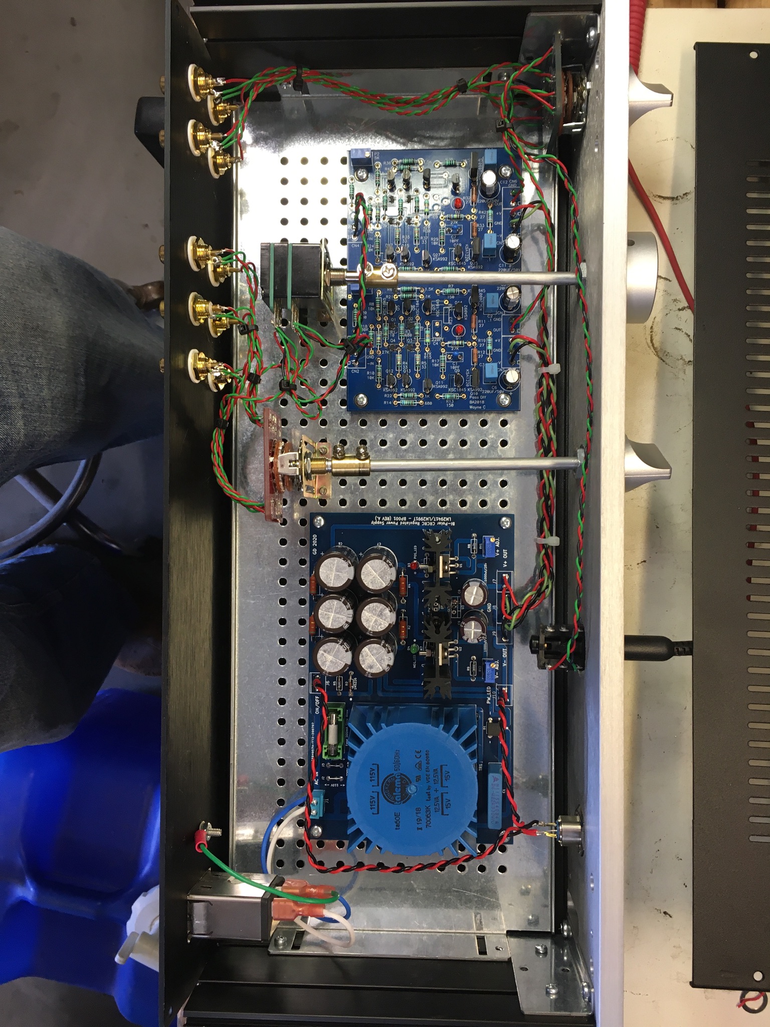

Ya that was my reasoning. Sure it's easier and cheaper to just change some resistors to get more gain, but where's the fun in that? People like the iron in projects like the M2X, I figured why not try it with the BA 2018 (with it's low output impedance) to get some of that character?

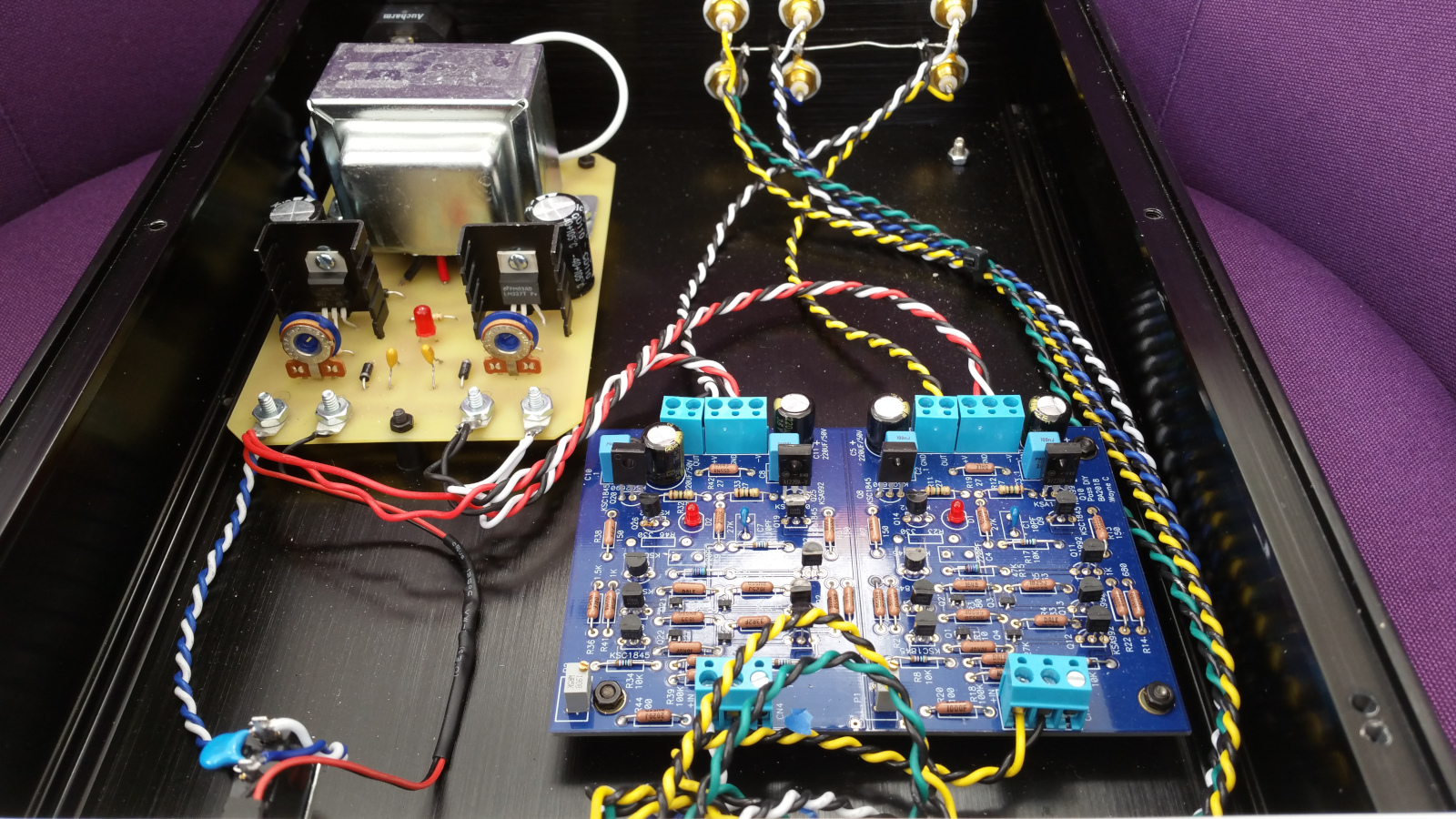

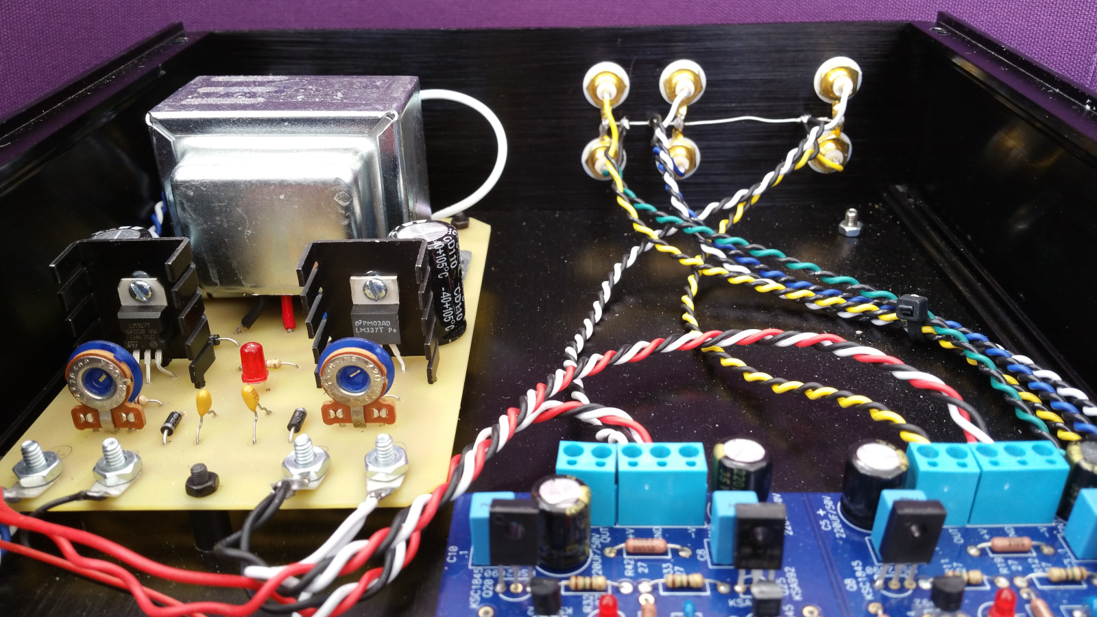

It’s astonishing how good this preamp sounds and dead quite.I built mine stock with Gaza’s power supply. I did splurge and use a TKD potentiometer however I went with 10k and it gets to loud to soon wish I used 50k. I may go back and lower the gain. However I like it so much I am going to build another one with Mark Johnson’s VRDN and a remote controlled relayed attenuators with display and really nice case.

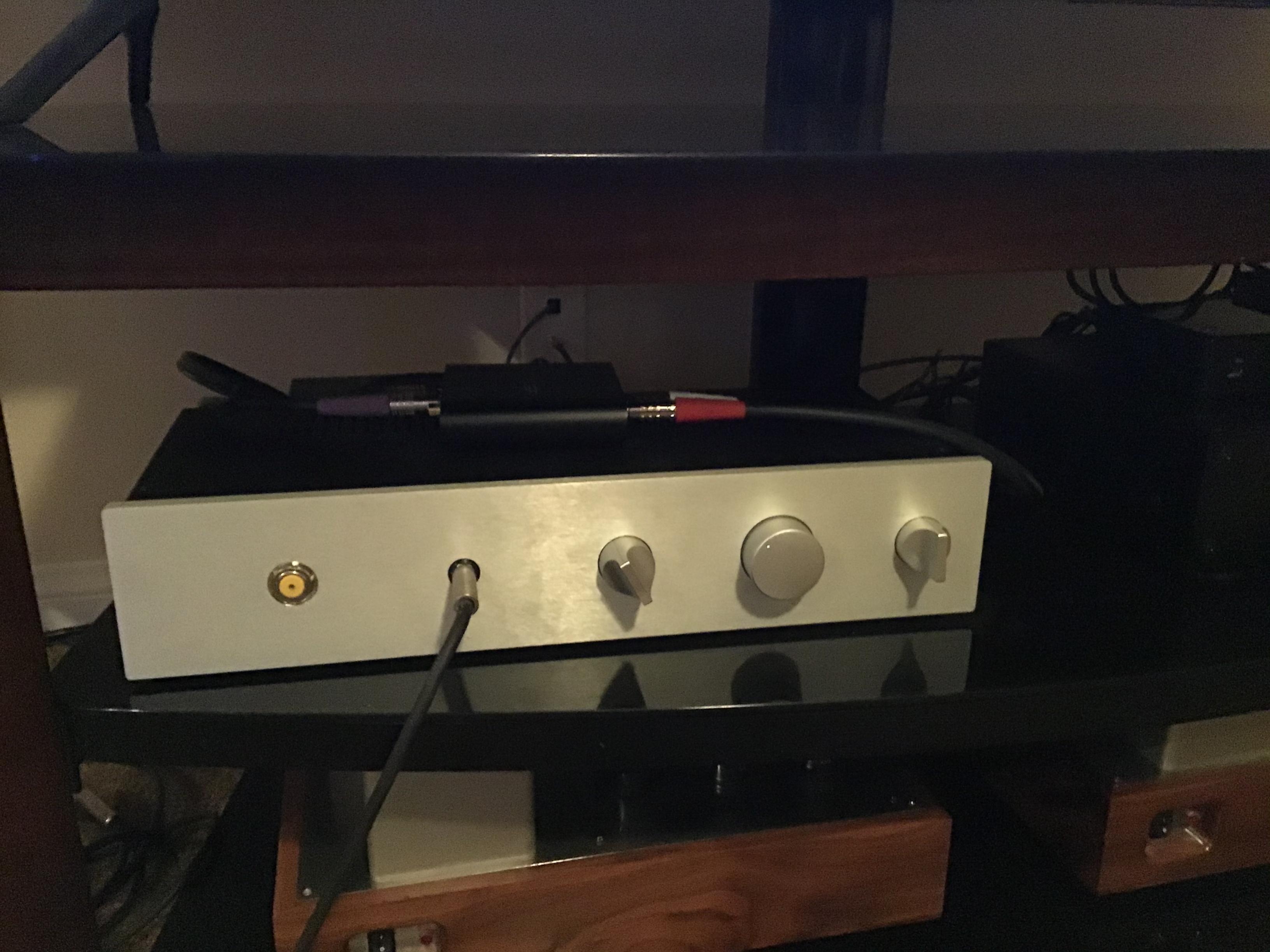

Some pics, really like DIY audio store case with pan with holes made building a snap however 10 mm front was a little challenge learned you can use forester bits on aluminum and comes out quite nice to recess volume and selector knobs.

May I ask which chassis that is from the store? For the purpose of getting a sense of scale.

To be more helpful with potential solutions... If you're only looking for gain, you could consider Mark's comment in post #1233. It would be far simpler.
In addition - From ZMs post re: 10k nominal: A choice like the JT-11P-1HPC may be something to consider. I have these and will be using them (as specified by Tom C - I cannot take credit) in the front end of a couple amps.![]()

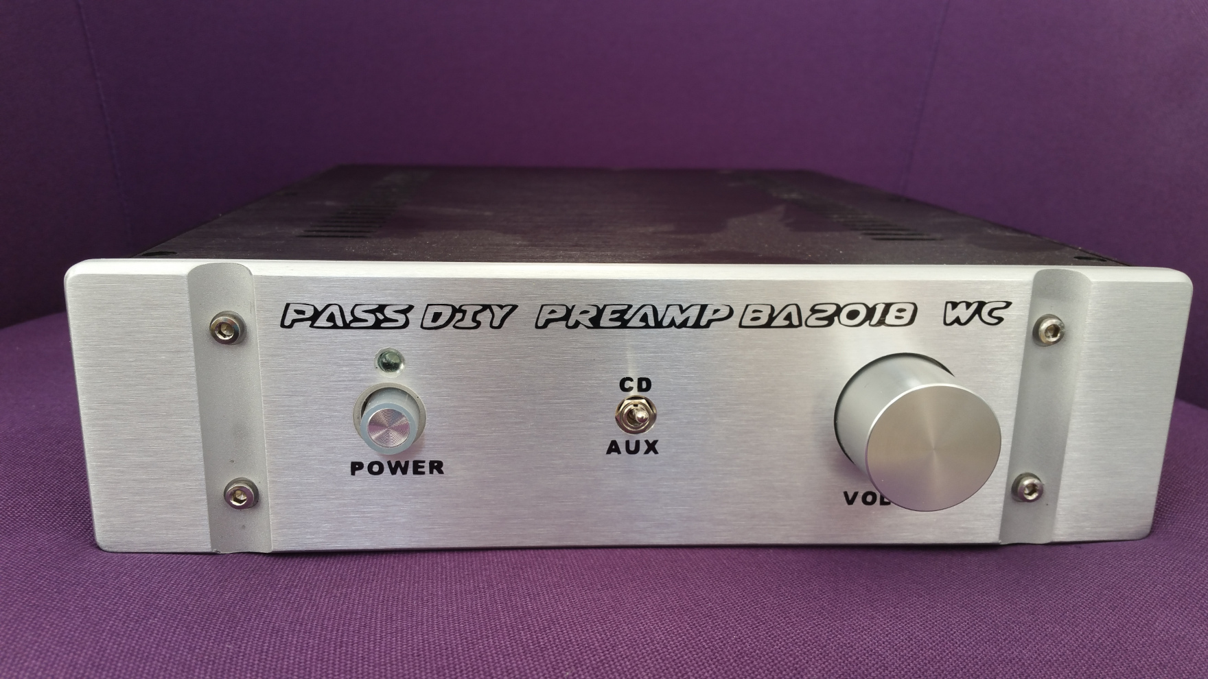

One thing I've noticed when playing this preamp, compared to others I have, is that it sounds great at low volumes. I followed Mark's advice and bumped up the gain 6 dB feeding my F4 into 97 dB speakers. It sounds great overall, but the nicely percussive low volume stands out for me. This preamp deserves a lot of respect.

I have used that exact Jameco PSU, it absolutely will get the job done nicely with zero fuss!
Lastly, with RCAs remember to connect - IN to GND at the input. Just a short bit of wire. Check DC offset after you do that.
