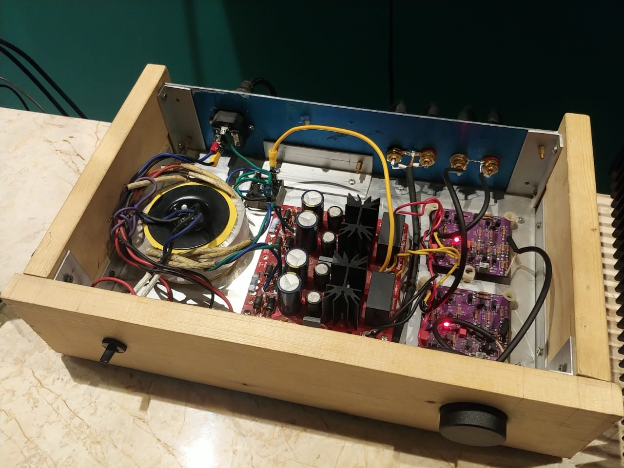

Have got my build powered on and playing music...
Initial impressions are very positive.
Thanks to Wayne for making the design available for the DIY community. My thanks also to the folks who have contributed to this thread making the build easier for me, and of course to 6L6! 🙂
Some details of the build:
Glassware Dual/Bipolar Low-voltage regulated PSU running at +/-18V DC
Antek 2 x18V AC 50VA transformer
DACT type 50K potentiometer from Ebay
Gotham GAC-2 microphone cable for input
Mogami W2314 for other signal cables

Thank you very much, William! 🙂
Nice build, Zman01!
