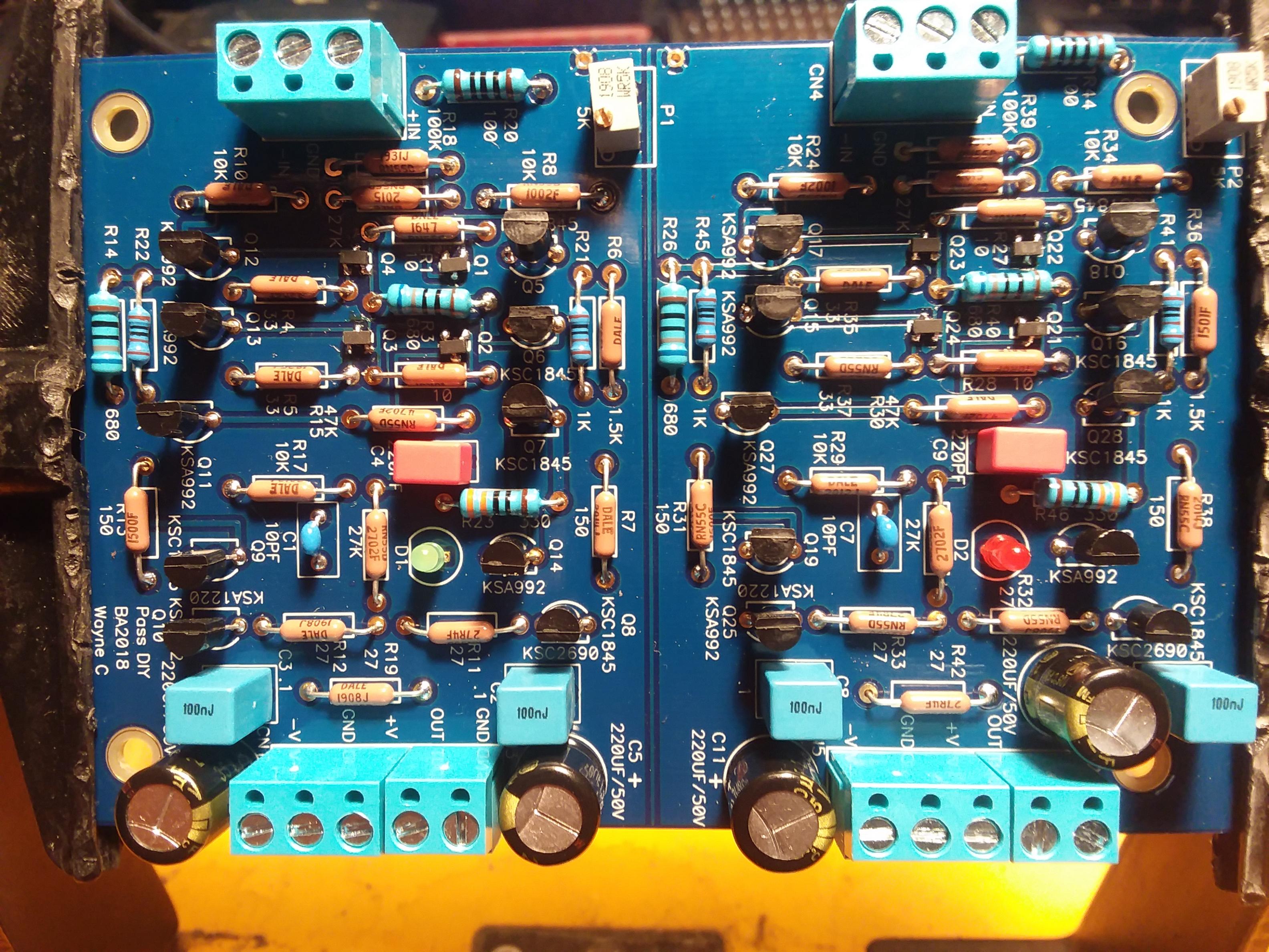

I built Wayne's today, fairly easy job knocked it out in a few hours. One thing I would have liked is a snap point to separate the boards if you wanted to do so. Also, all the parts tossed into one bag is counter productive, it took longer to sort that all out then it did to stuff the board. I would suggest it easier to order from Mouser and write the part location on the BOM. That way, you aren't trying to read codes or meter every part. It's nice to have the parts, but I think the group pack defeats the ease of just ordering it from the site. Just say'n

The LEDs are not just lightbulbs for each channel. The circuit is designed around using the LiteOn LTL-1CHE as a voltage reference.
I'd suggest swapping the green for the red provided in the kit. 😀
I got that, but I didn't have 2 in the pack. 🙄 lol What I did was look it up and sub this:
https://www.mouser.com/ProductDetail/Lite-On/LTL-1CHE?qs=ImLoyPzIOkVHLfnGR%2BrysQ==
The specs looked the same except the OV which was 2.0 (grn) vs 2.1 (red)
AM, I good there, or should I order a $8 LED?

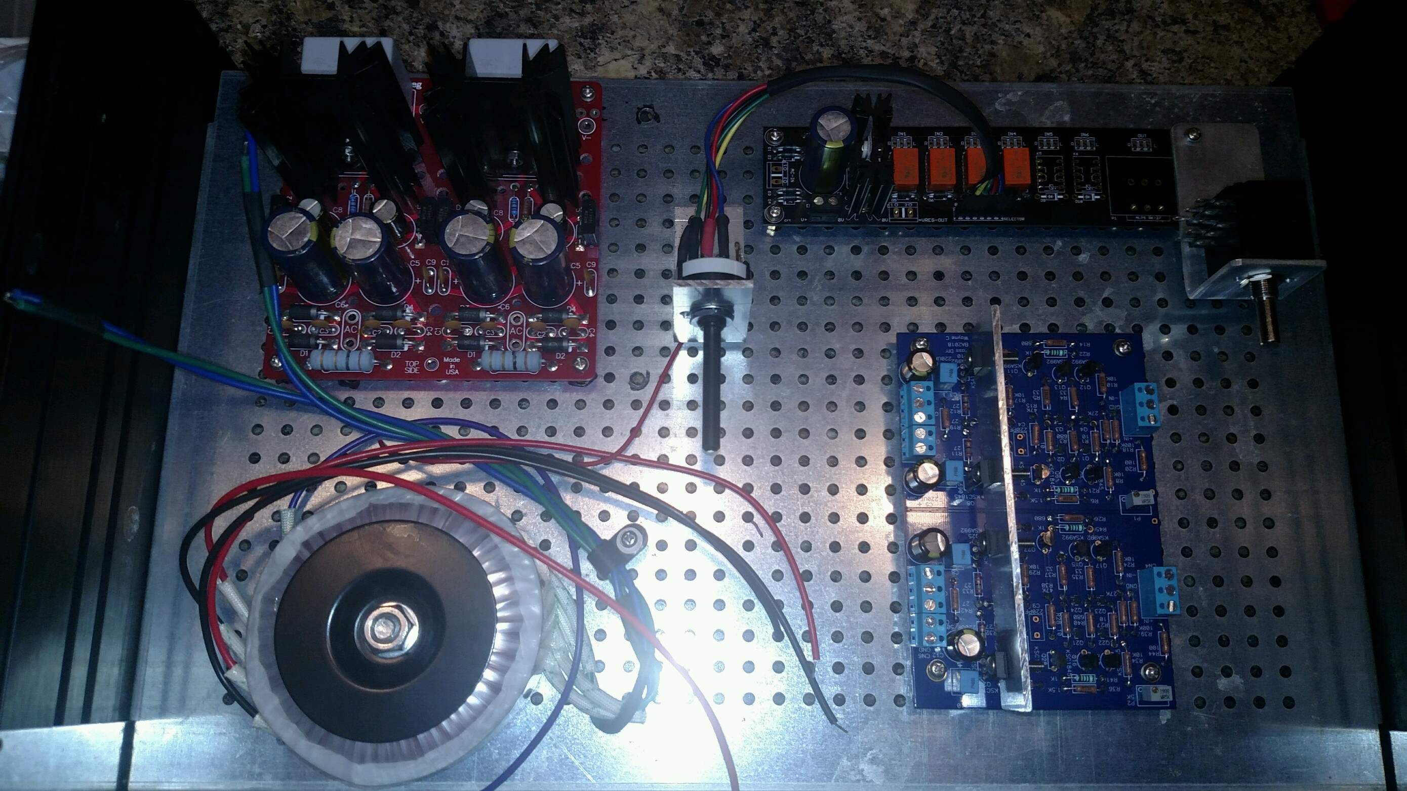

I read through 6L6's Pearl 2 build guide - and I answered one of the own questions. It appears that the power supplies need to be separate - the linestage needs <= +/- 26 volts and the Pearl 2 needs between 29 and 40.
For a two chassis solution, I guess it would be ok to build two power supplies in one, and the linestage and Pearl 2 in the other.
Or maybe a 3 box solution - linestage with it's power supply in one, and two for the Pearl. Any other ideas?

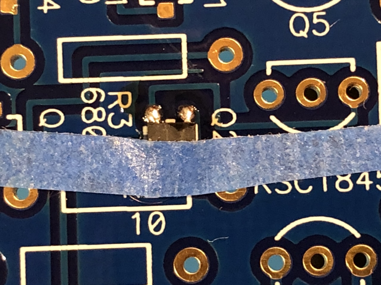

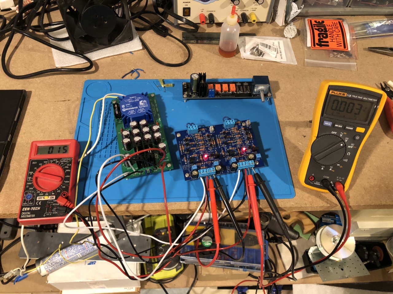

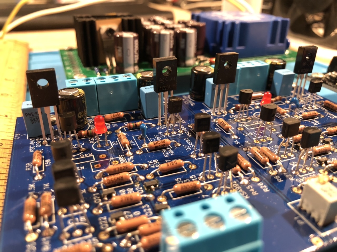

Well after reading through this entire thread, many unplanned parts order expenses and a rough start with the surface mount parts I fired up my BA2018 line stage today. I am pleased to say it turned on with no smoke, no fire, and no fury, and the DC Offset adjusted nicely to around +0.009v DC on both channels. I hope it’s safe to assume that it will function as designed from this point on...
Next stop on this journey will be to listen to it and to order a (custom) Slimline 2U case from the parts store.
Here’s a summary of my build so far:
-BA2018 big output transistor version (I am not planning a headphone jack, I was just short on the JFETs, LOL)
-Peter Millet PSU configured for +-18 VDC (15v transformer; R4=16.9kOhm; R6=16kOhm)
-Salas/Tee-Bag I-select relay controlled input selector/volume pot (Alps 50k Volume Pot from Parts-Express)

to glenv6
Very good build and specs (offset).
You also used the self- adhesive- tape- technic for the Toshiba -SMD-JFets.
Good looking PSU.
Enjoy the sound!
Dirk
Good looking PSU.
Enjoy the sound!
Dirk
