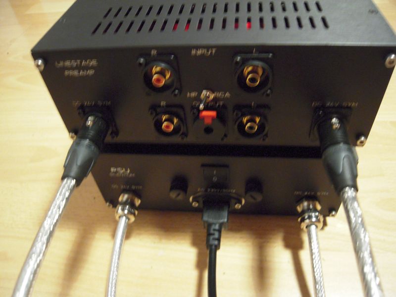

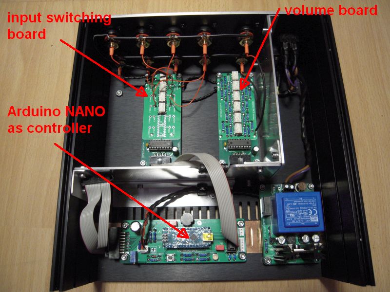

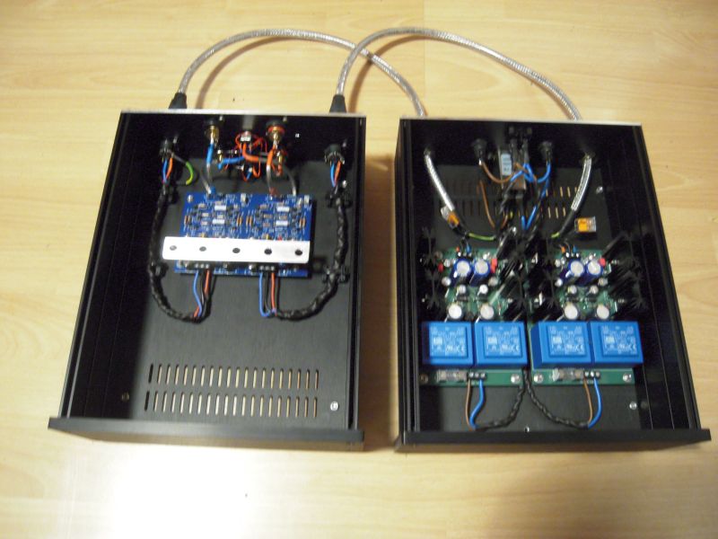

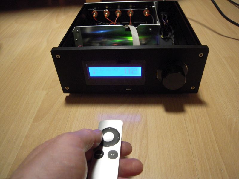

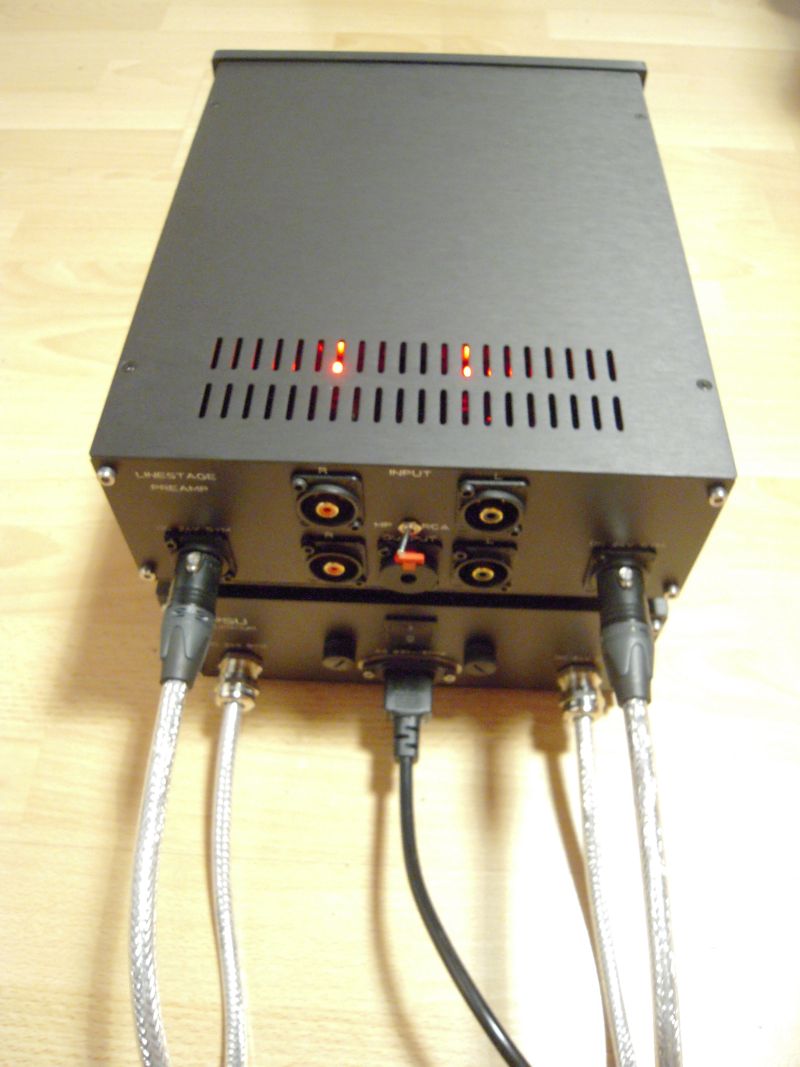

I have built my Waynes Line Stage in 3 cases:
-one case for the preamp
-one case for the PSU
-one case to control inputs and volume.
My WLS is a dual - mono - construstion (o.K., both channels in one case -
some call this monoaural....).
I have spent a lot of efforts on a silent PSU. I also selcted / matched all Toshiba -SMD-JFets, matched the OnSemi/Fairchild - BJTs and used
matched Toshiba TTA004/TTC004 output-BJTs (because i use my WLS also
as a headphoneamp). I also matched each resistor from left to right channel....

Dirk, it certainly looks like an impeccable installation, congrats!
What volume control are you using here?

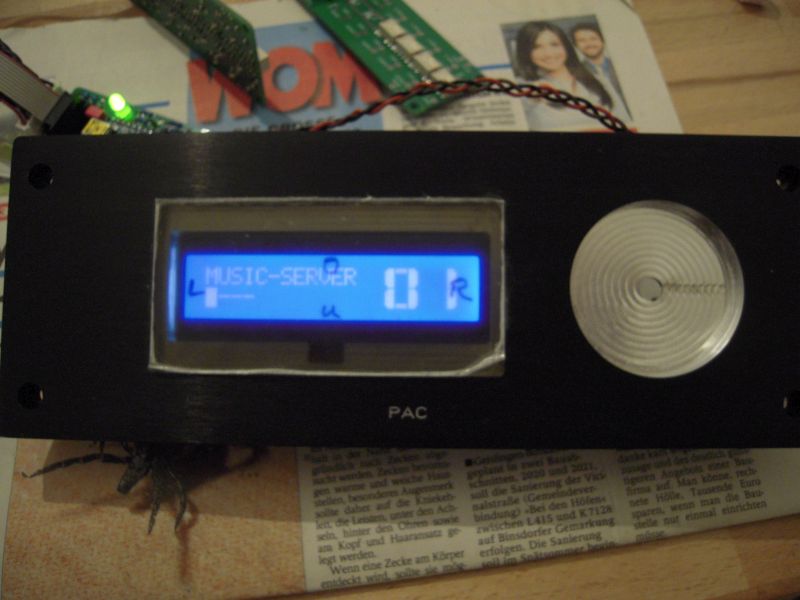

Looks great Dirk, that's a lot of matching. 🙂 I ordered extra to do a little matching myself, but not as much as you.
to ClaudeG #1947

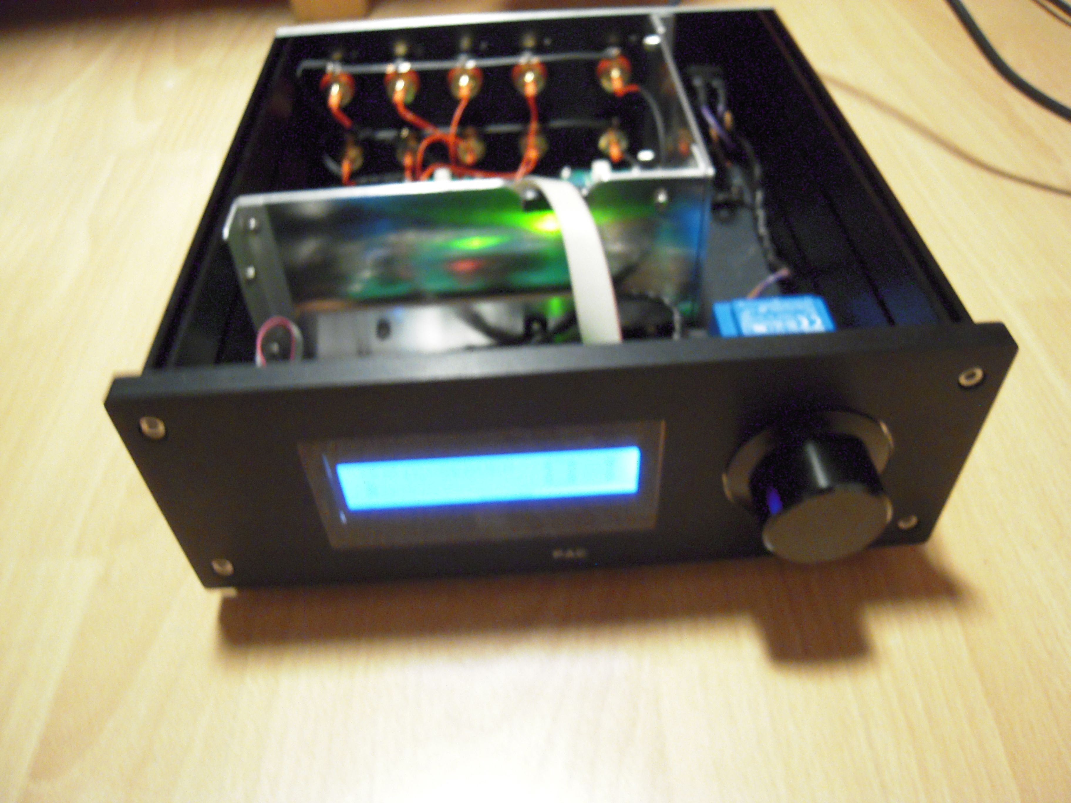

Hello Claude,
the PCBs for the input and volume control are sold from a german DIYaudioshop (it is not my work!).
It is based on an ARDU..O Na.o as controller. The sketch / programm is freely
downloadable.
You can add a display and IR-control/remote ( I used an Ap..e remote).
I send you a pm.
Greets
Dirk

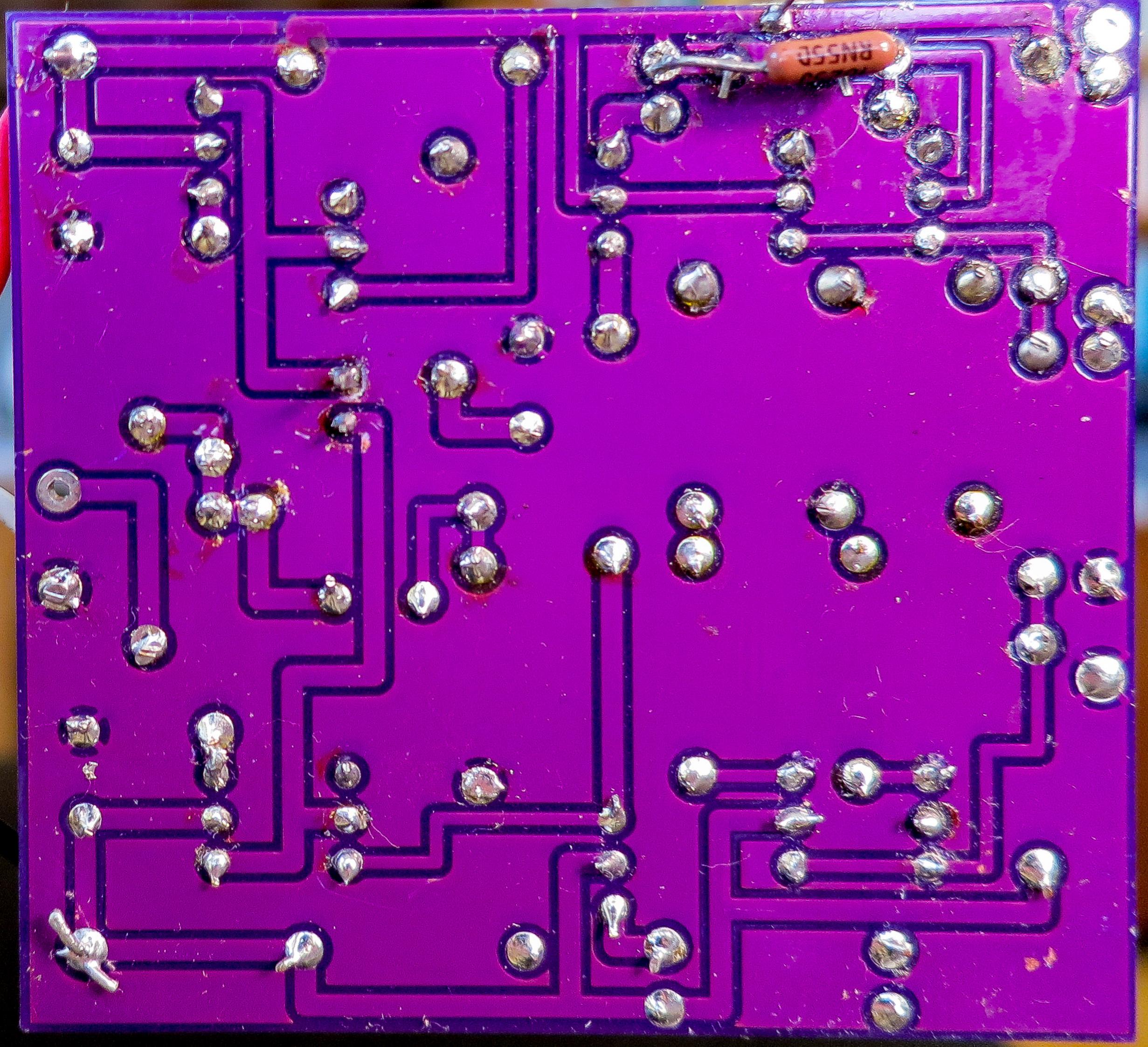

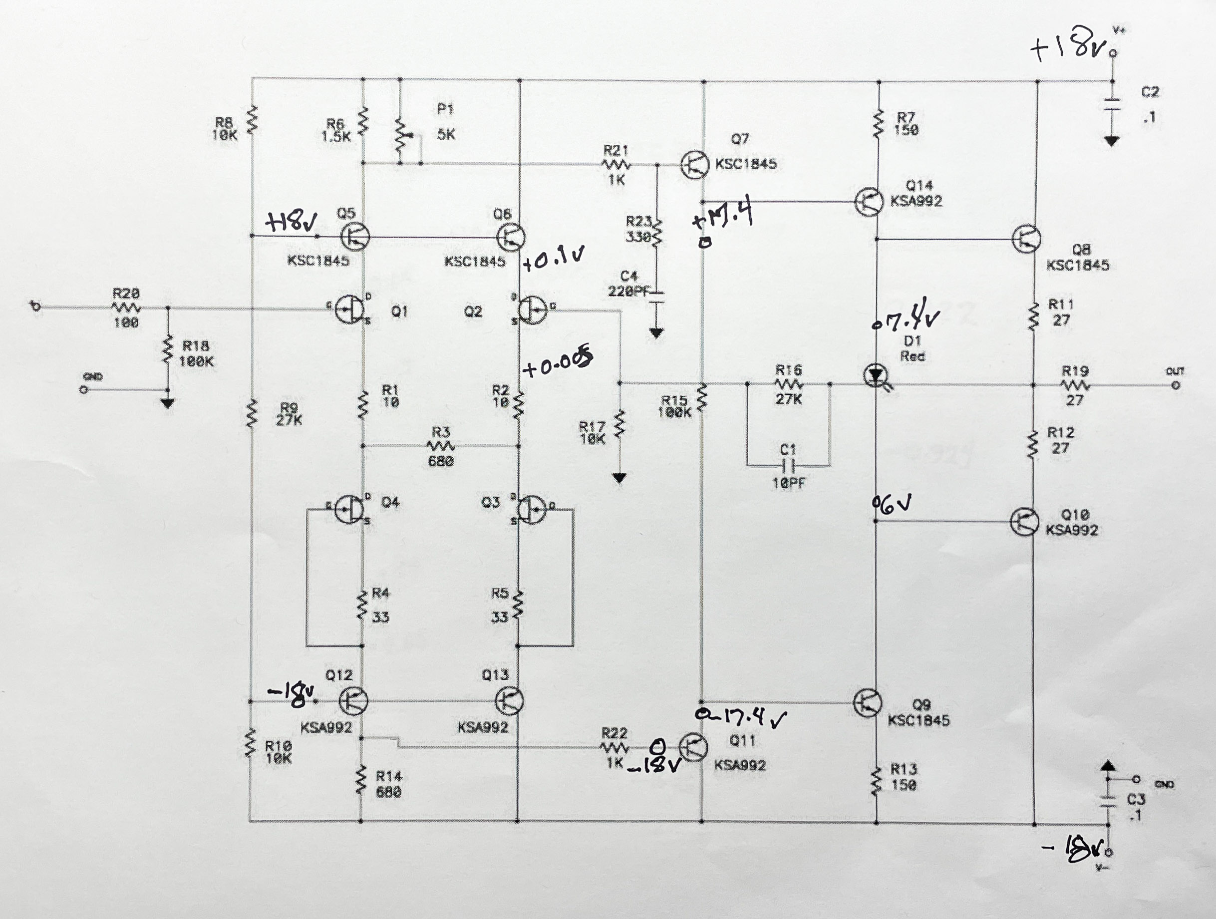

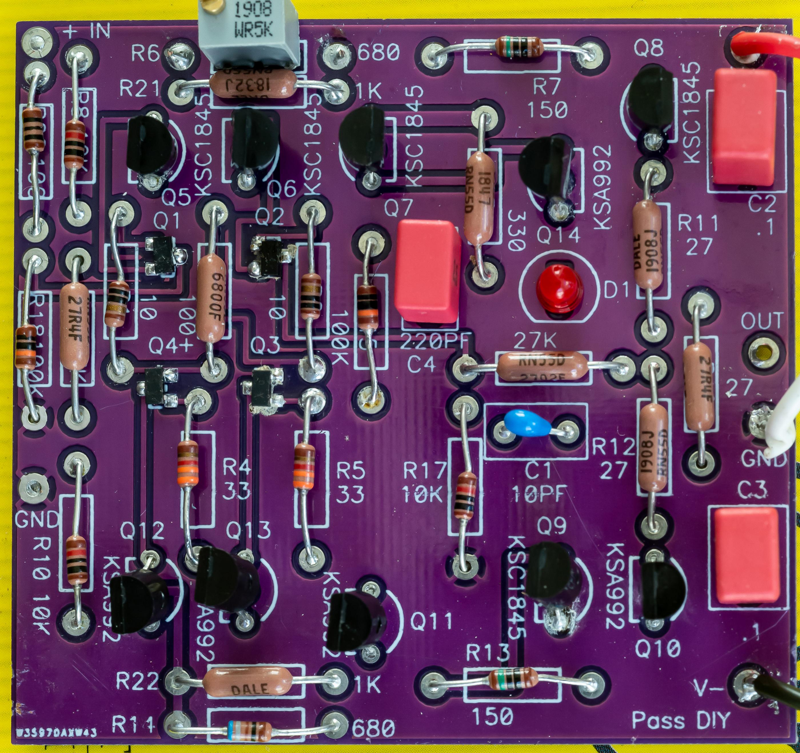

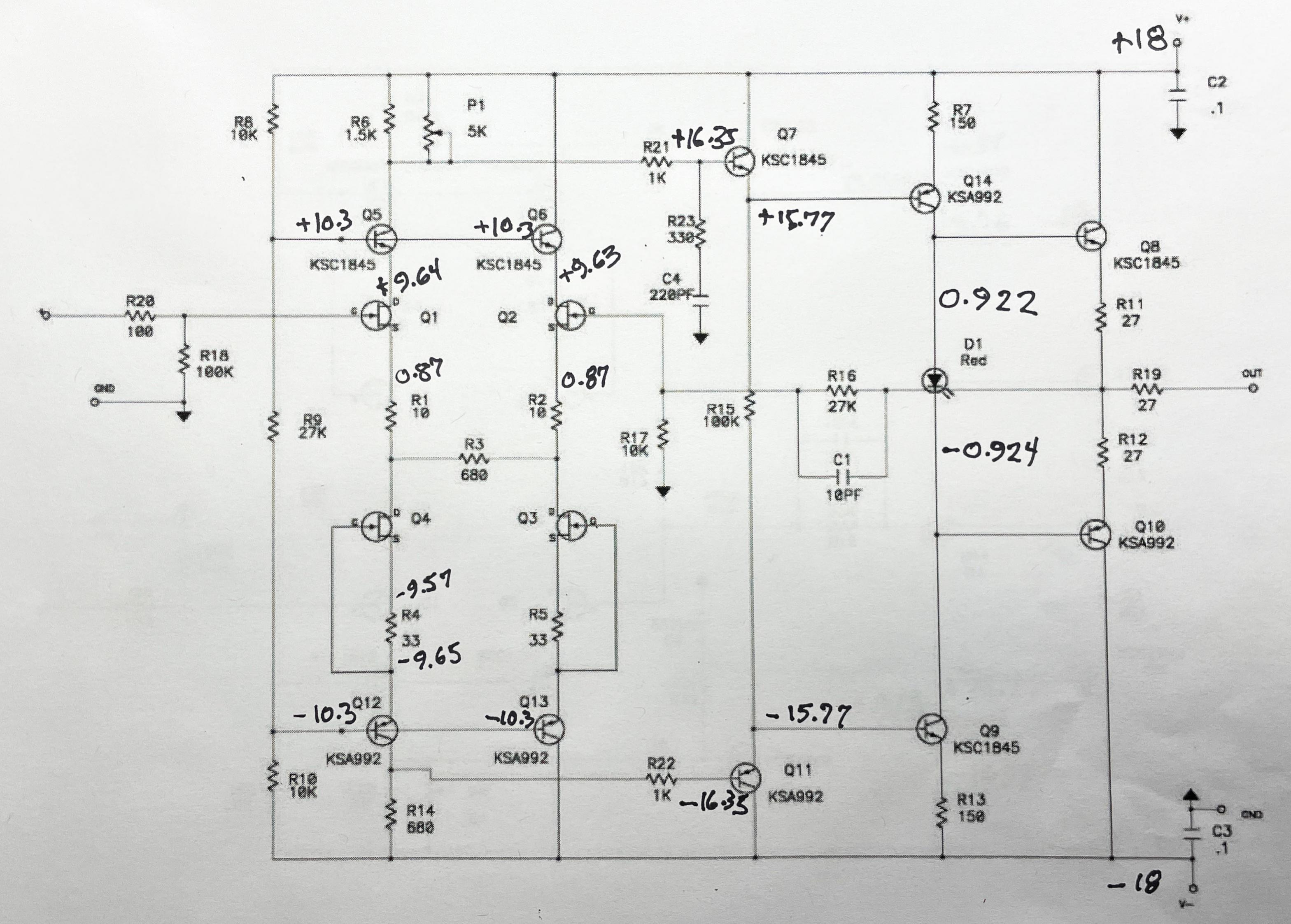

I built up a pair of the original purple boards and listened happily for a few months. Then one board stopped working. Since I had slightly butchered it by lifting some traces while trying to R&R a transistor I had installed backwards, I decided to build up another board, as I had extra PCBs and parts.
The second board never worked. I've inspected everything over and over, and have looked for mistakes, but I can't see anything. The board that works draws 30mA per rail, it is easy to balance the DC out, and the LED is brightly lit. On the board that doesn't work, the rails draw 18mA each, the DC offset never gets below 6v and the LED is dimly lit. I figured with one working board, I should be able to figure out what was wrong with the other board, but that has not proven to be the case.
I could build up another board, but at this point I think I'd rather learn something. So I am asking for some troubleshooting help. What should I measure to find the problem, and why?
I have included four images. Two show the front and back of the non-working board. and the other two show DC voltage measurements of the good and bad boards.
Any help appreciated. Thank you.
