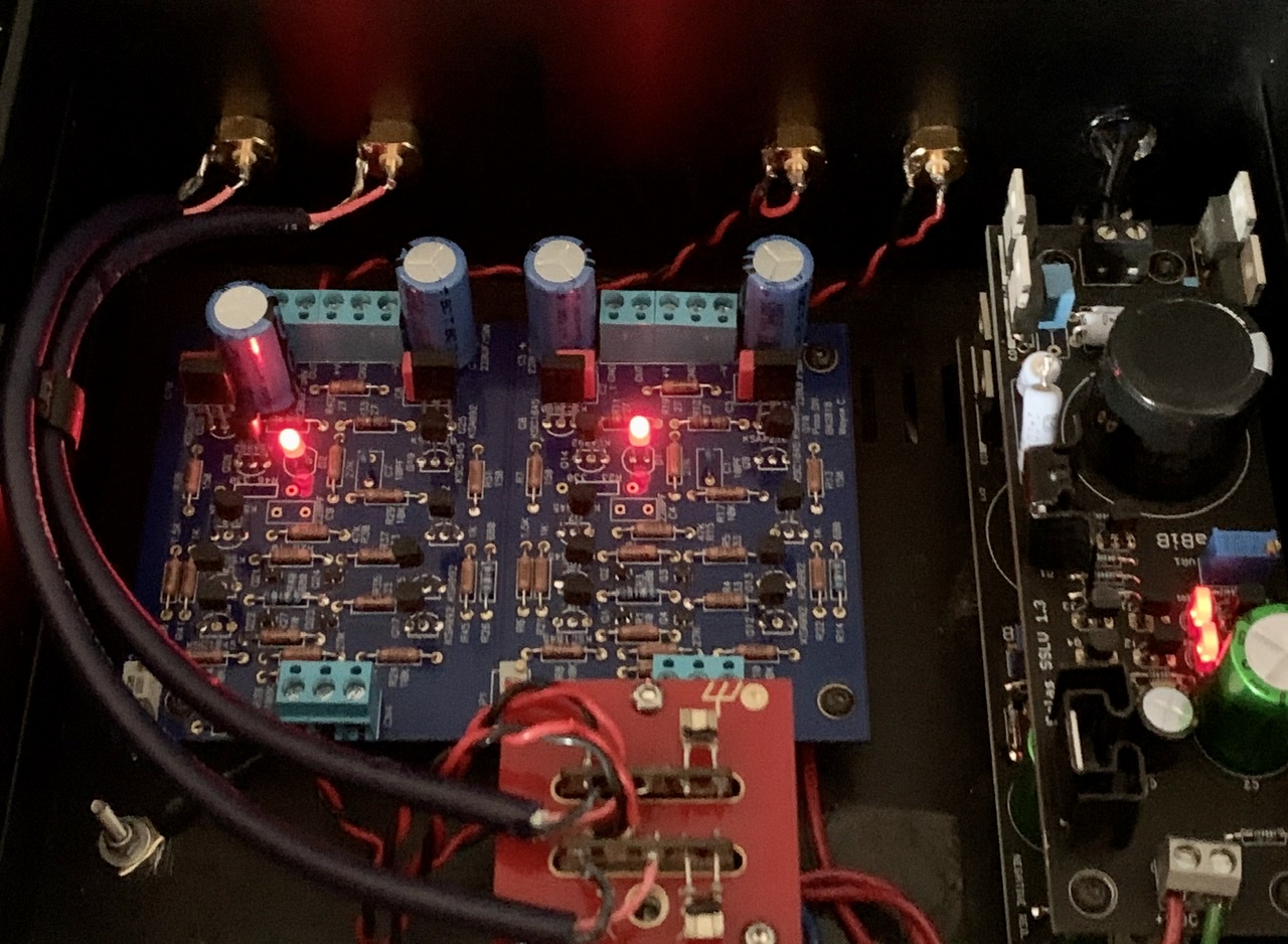

Many thanks already.
It feels so cool to have self-built, highly praised device in front of me.
I‘m not yet able to lend it my ear, but I’m close!
Connect inputs is next, then ... the serious dream begin (making decisions about final Lay-out, chassis/knobs etc...)
Already happy!

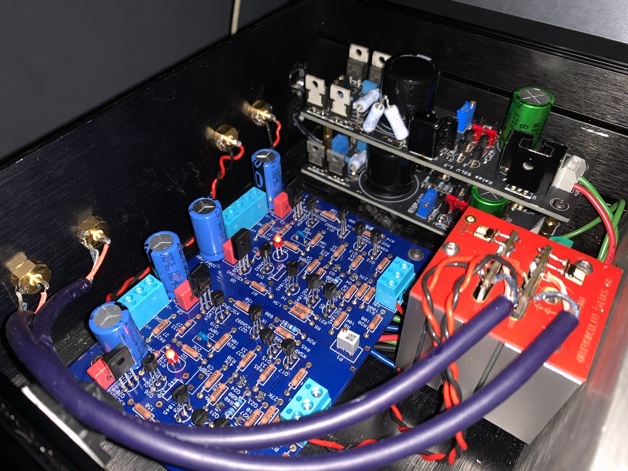

Another WCLS18 is alive. Sounding great so far. Coming from my BA3 pre, this LS really adds more detail and oomph to the bottom end. Really awesome linestage! As far as the build goes, I have a 2U chassis with an attenuator and a Salas UltraBIB. Makes it really easy to swap in different boards and adjust the voltage as needed. The bottom plate looks like Swiss cheese 😀

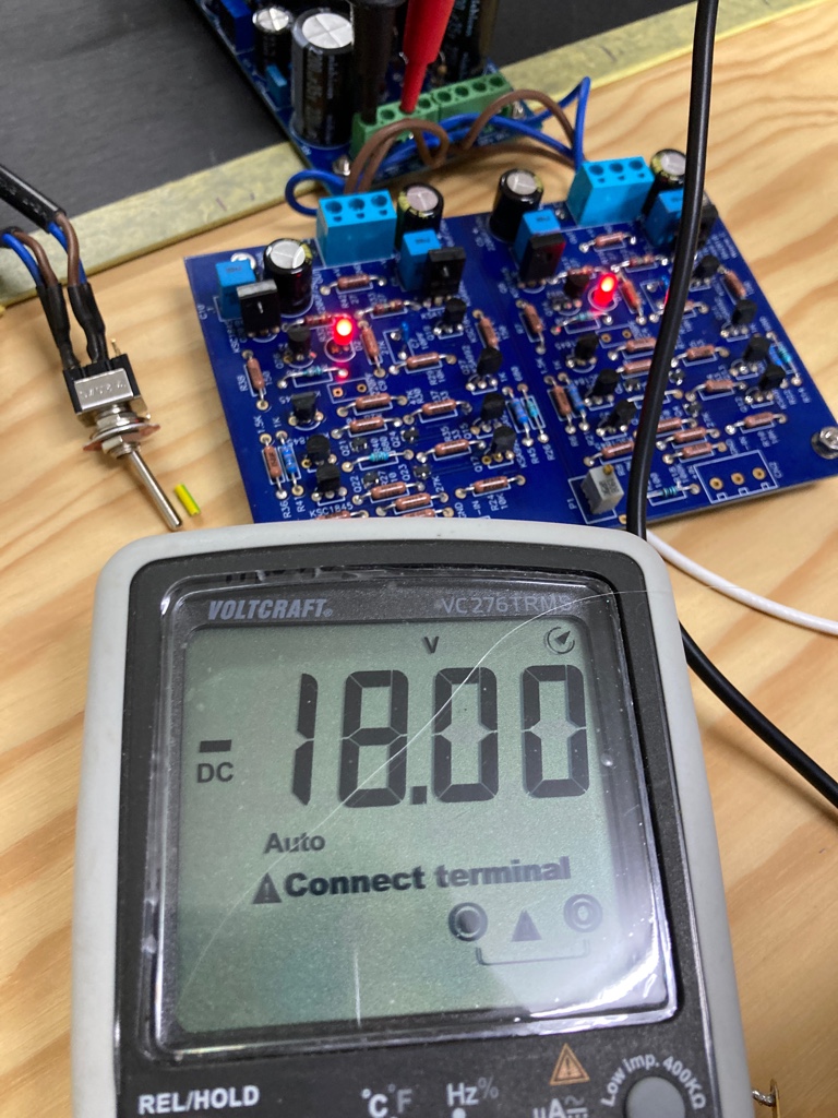

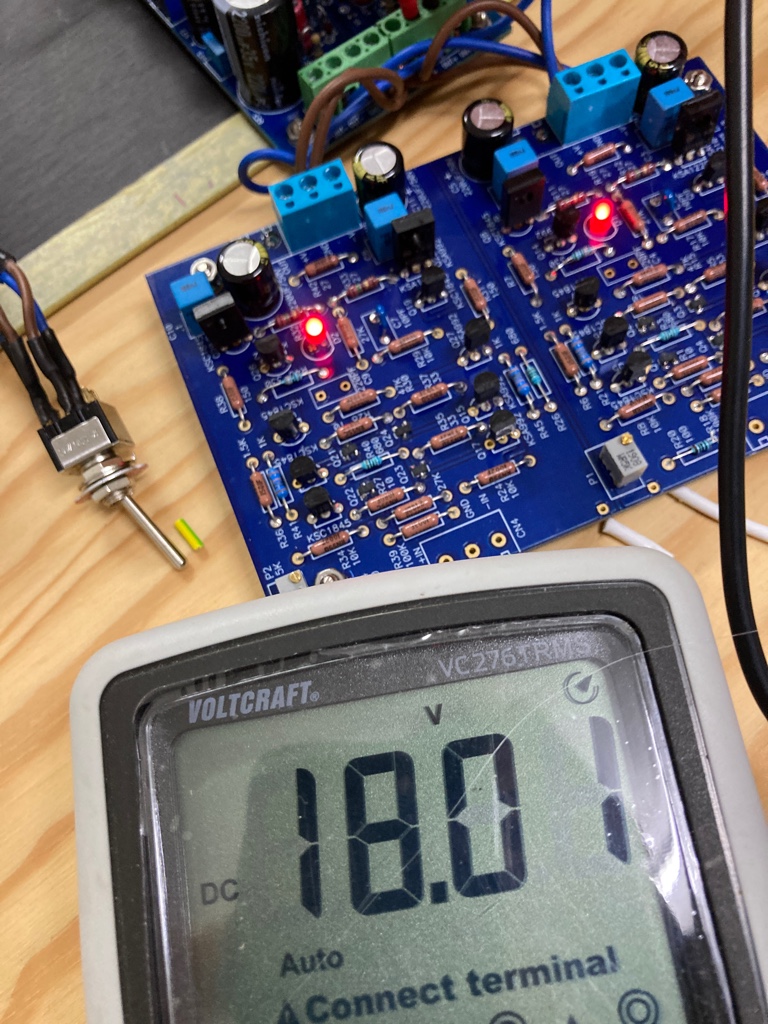

I am starting to do some measuring/adjusting P1 on my board. My VRDNs are both putting out exactly +/-18V which is a good starting point.

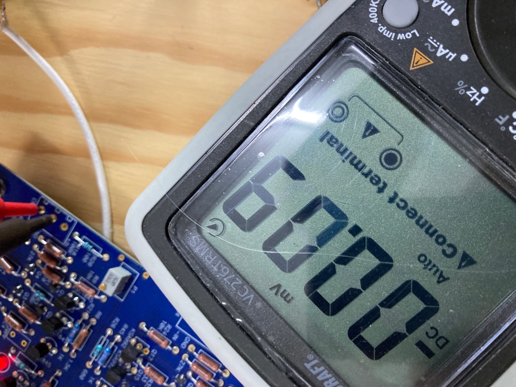

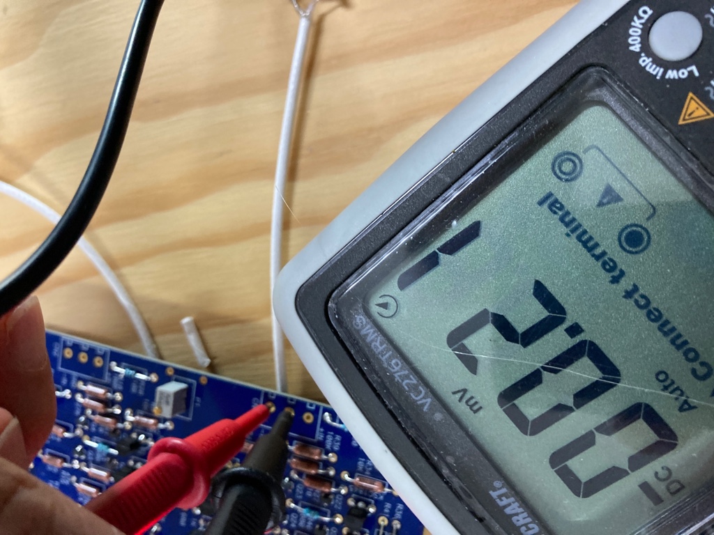

Before going any further (e.g. removing R16 to set P1) thought I'd measure the bias as-is. I was surprised to see about 590mV on both channels (1st photo). Then I remembered on the F5 it was recommended to short the signal inputs, so I (probably wrongly) connected +IN, GND and -IN on the input side. This ended up making the bias 2V on both channels (2nd photo). Same result if I only shorted -IN to GND and left IN+ floating. So that wasn't the issue, and clearly isn't helping (or correct?).
Am I correct in measuring the bias as shown? Note that since I'm not using a chassis yet (unless you count bolting everything to cardboard) I haven't connected the IEC ground to anything, and haven't set up a floating ground between IEC/chassis and the signal ground.
Any tips before I proceed? I will eventually remove R16 and compare R6/R14 while adjusting P1 as recommended, but I want to make sure I'm measuring and set up correctly. I read that P1 doesn't have much effect when R16 is present so I doubt playing with it would correct my 590mV bias.
Floating inputs:
Shorted inputs:
Wiring overview.
Note the probes were swapped in all the photos, so displays showed negative biases.

I swapped the multimeter leads (they were reversed above) to get a better photos, and only had -IN shorted to GND with +IN floating. Plugged it in and both fuses blew at the same time.
So something's clearly off... BTW, I ordered T 80mA (slow blow) fuses based on my calculation (15VA/230V ~= 65mA). Should these be sufficient assuming normal operation? I've got 8 more thankfully...
Do you mean bias (Iq) or DC offset? Looks like you’re measuring for offset.
Sorry, yeah I meant offset. Darn, it's too late to fix my original post.
