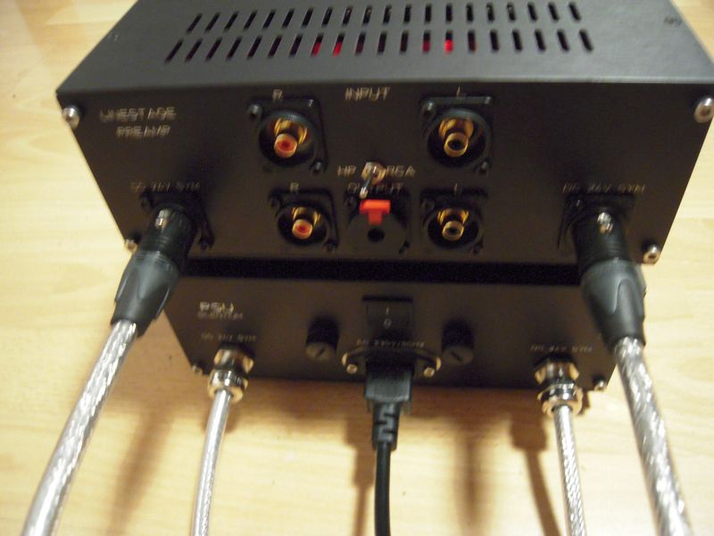

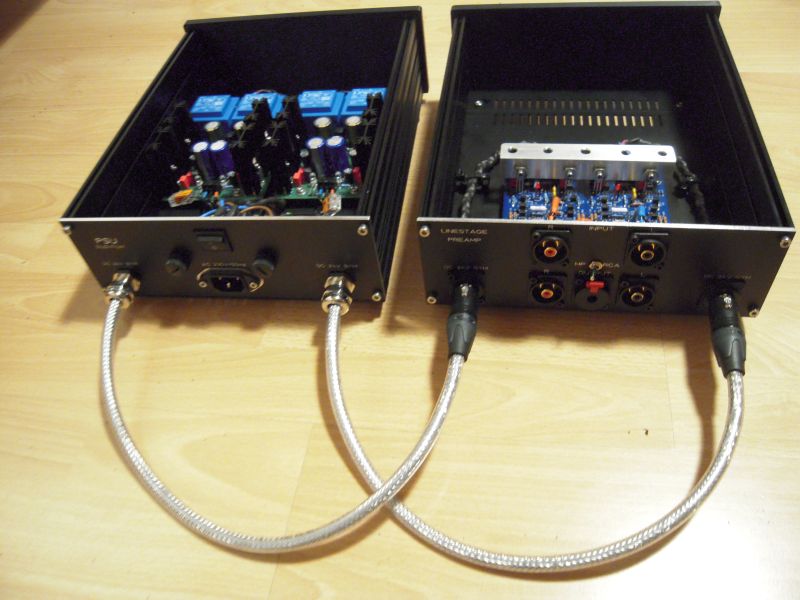

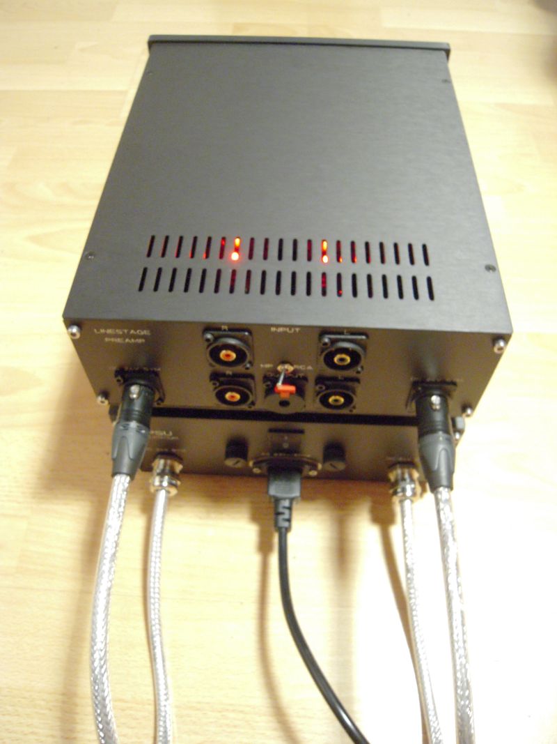

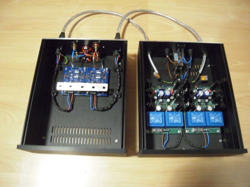

Hello members,
I put my Waynes-BAF2018-Linestage and the PSU into cases.
Dual-Mono in two cases. Each channel has its own PSU.
You will ask: 'Where is the volume pot and input selector?'
Answer: 'In another (third) case...'😀

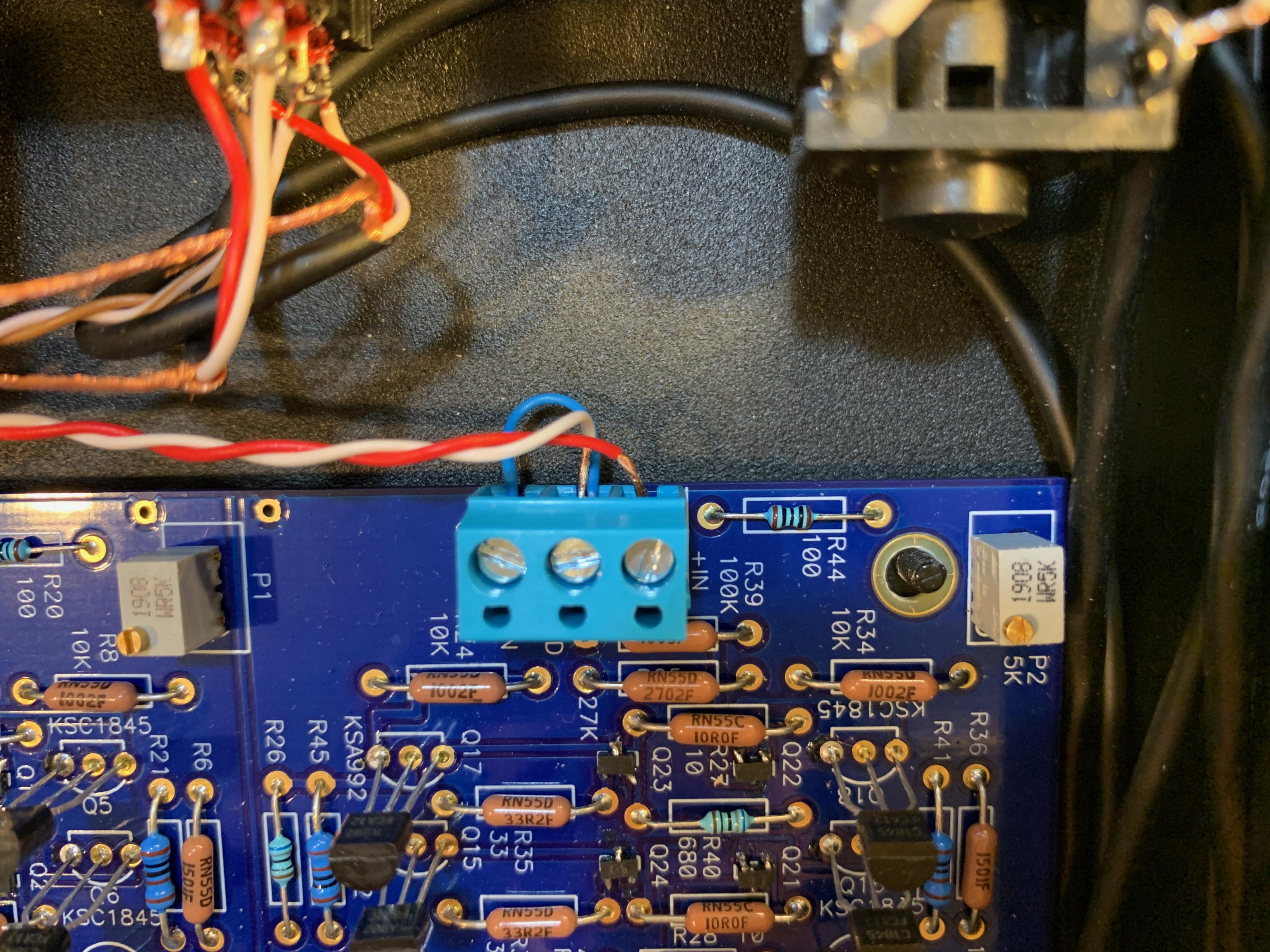

Obstacle ahead: wanted to do the input connection, but single ended...
I think it is just as Wayne explained (#263, https://www.diyaudio.com/forums/pass-labs/329240-waynes-ba-2018-linestage-27.html#post5699074 ), but this surpasses me—R17 being deep inside the pcb, am I really supposed to feed the minus in there?
No shortcuts (connect ground to both in- and gnd or something)?
Thank you!
Thank you!

Sorry to bug you again (connection-method seems to be cleared), but could you explain what exactly Wayne was about in the aforementioned post (#263, in this thread) of him?
If I understand correctly, CN3 connects to one side of R17. The [IN-] boxes on the schematic are connected to each other, but the line isn't drawn between them because it would cross a lot of other lines and make the schematic more cluttered. This notation is similar to how a schematic may show multiple unconnected ground symbols to make it more readable when connecting them all with lines would make a mess.
Of course I could have totally misunderstood the question. 🙂
Ahhh,I see. Noted. Thank you 6L6!Don't attach the input -IN to PSU GND. Merely make a small jumper to attach - IN to input GND. (CN2 and CN4)
I‘m convinced that it is not that complicated. Wayne was talking about the purple boards, those we’re working with got things changed (this is how I understand 6L6)
And I believe he did the same on his ba-3 but reversed the decision...
