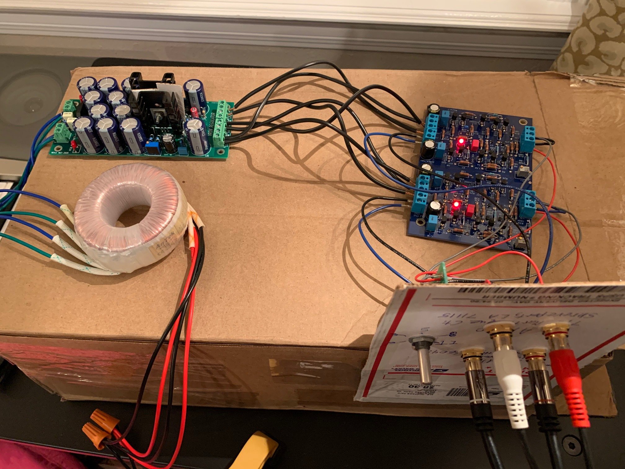

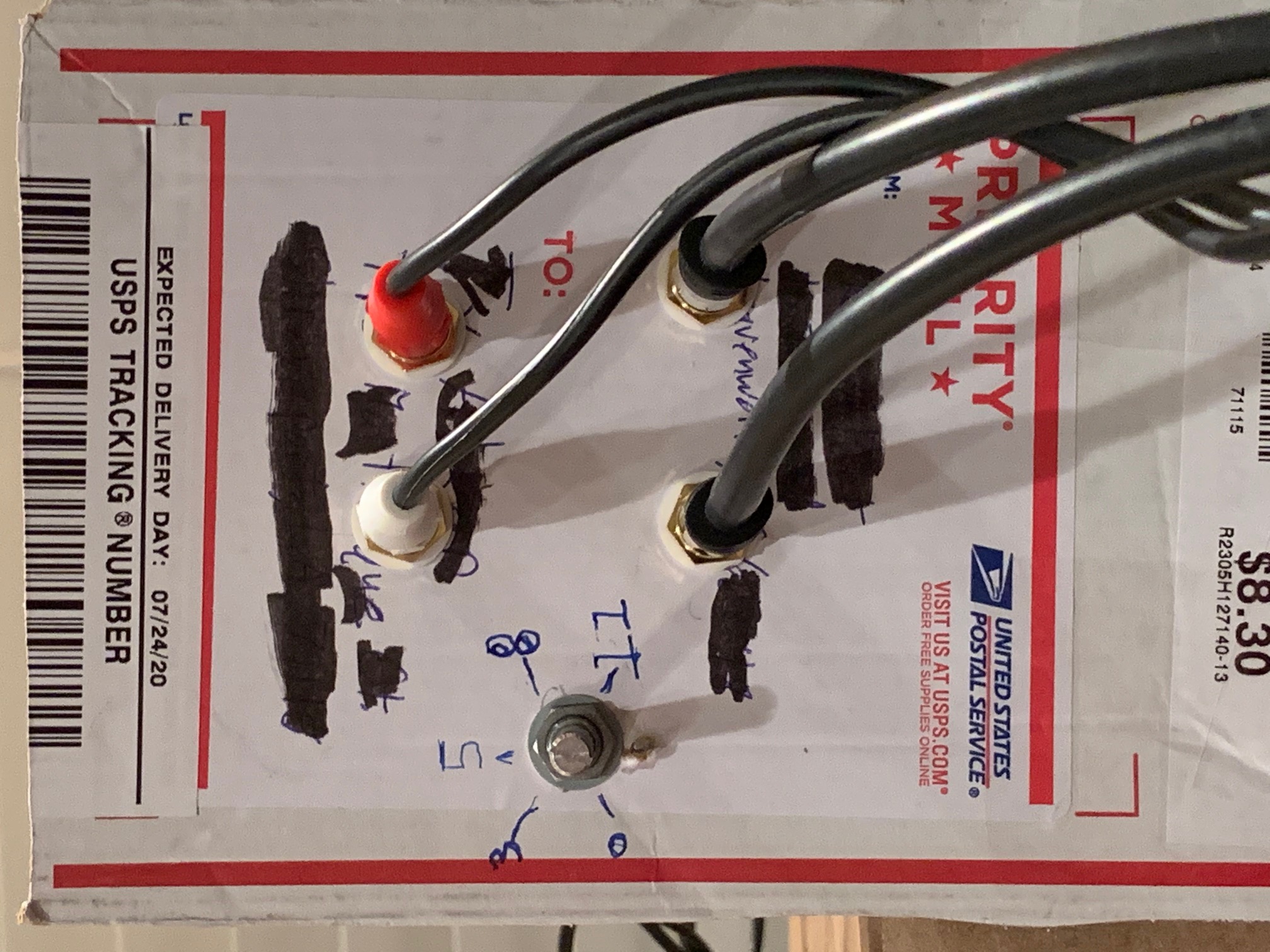

Hey Boys she ain't Purty but this Gal sure sounds Great.
My music source is a Raspberry Pi with an Allo Boss DAC,playing FLAC files. I have had to use the Software Volume control. This is somewhat lossy at a lower volume than 100%, not anymore.
Turn the software volume to 100% Hooked the BAF 2018 to the DIY Store F5 and Holy Catfish Batman. I had forgotten how good "Kansas" sounds. Ella Fitzgerald, Sheryl Crow, Nina Simone, Robert Cray,Little Feat, Los Lobos, and don't forget ACDC.
Have to Give a Big Ole Redneck Chest Bump the all the Folks that made this possible.
Mark Johnson for the VRDN power supply, Rick Ray for the VRDN pcb, pfarrell for some pointers,
and who can forget my fellow Pro Pilot 6L6 for all that help.
Thanks Folks
Now for Proof:
Mine Goes To 11 Man.....!
