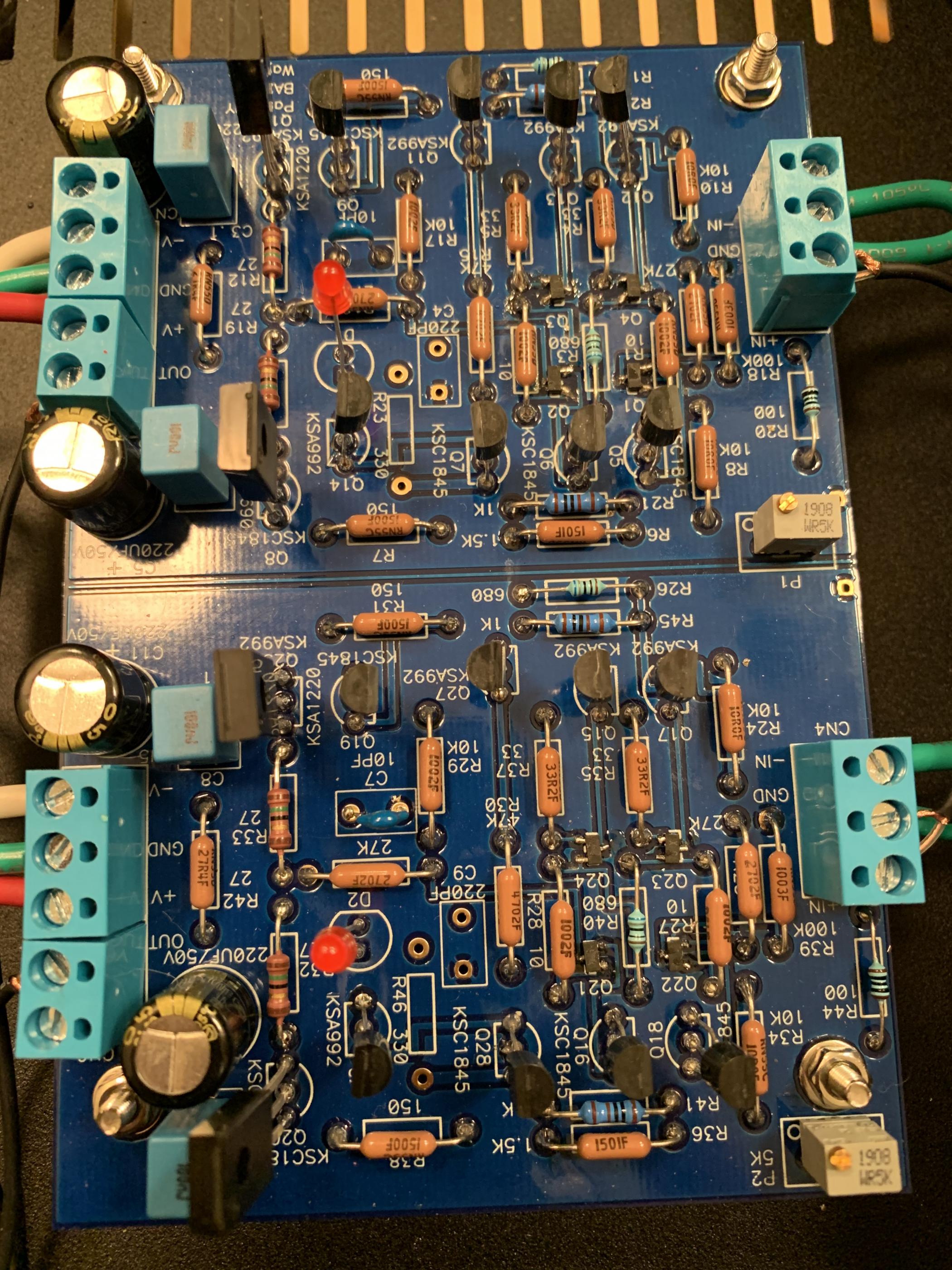

How constant is the DC offset supposed to be? Mine is dancing around constantly and swinging between + and - 500mV. For the large outputs it seems low powered too. I tested with headphones, then DIY F6 and output seems low and lacking bass. It's clean sounding and quiet, no hum or noise, but volume has to be over half way. I suspect something's not quite right. I used the pmillett PS suggested and have it at 18.5V + and - solid.
Mine drifts around between +/-5mV with the board out in the open. So +/-500mV seems high. Unfortunately I don't know enough to offer any advice.
Stinkpot - As always, please post a series of well-lit, in-focus photos. Do this first.
Something is not right, most likely a missed solder connection somewhere. That’s a lot of dancing on the output.
The big output transistors increase the current capability, not the gain. Gain is about 3.6x with the stock feedback resistor. Don’t confuse where the volume knob needs to twist with gain.
I had an offset problem with one channel that was caused by flux residue
around one of the jfets. Cleaning that fixed my problem. So perhaps you might
have a look at that, in addition to the other soldering.

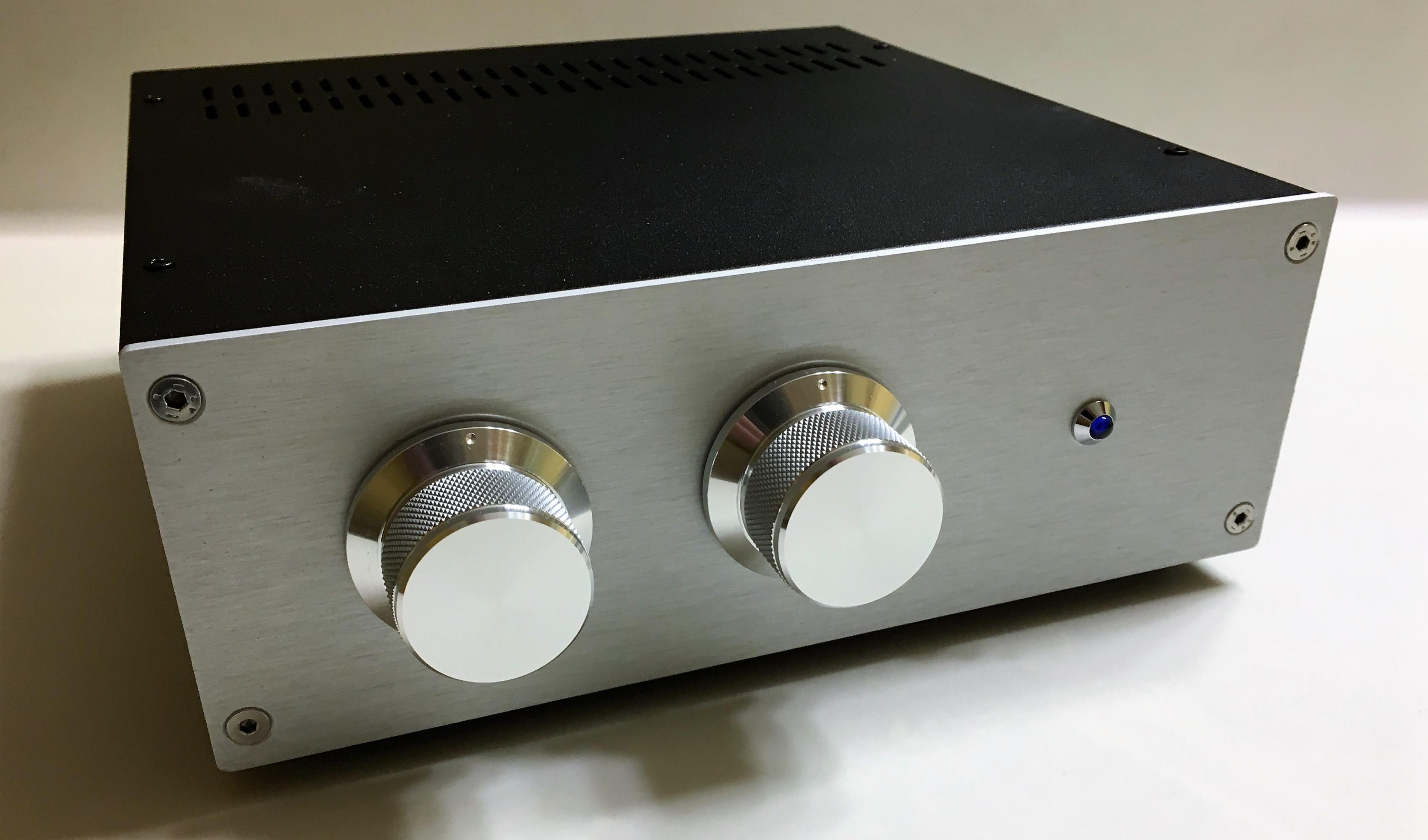

Outstanding Workmanship
Wkcox you guys are killing me with those nice cases. I guess it is time for me to get me one of those. What kind of "selector" switch is that you have. Kind of looks like a "Glass-Ware"
You can view my "Case" in post 1585!!!😀😀
Mine Goes to 11
Mine Goes to 11

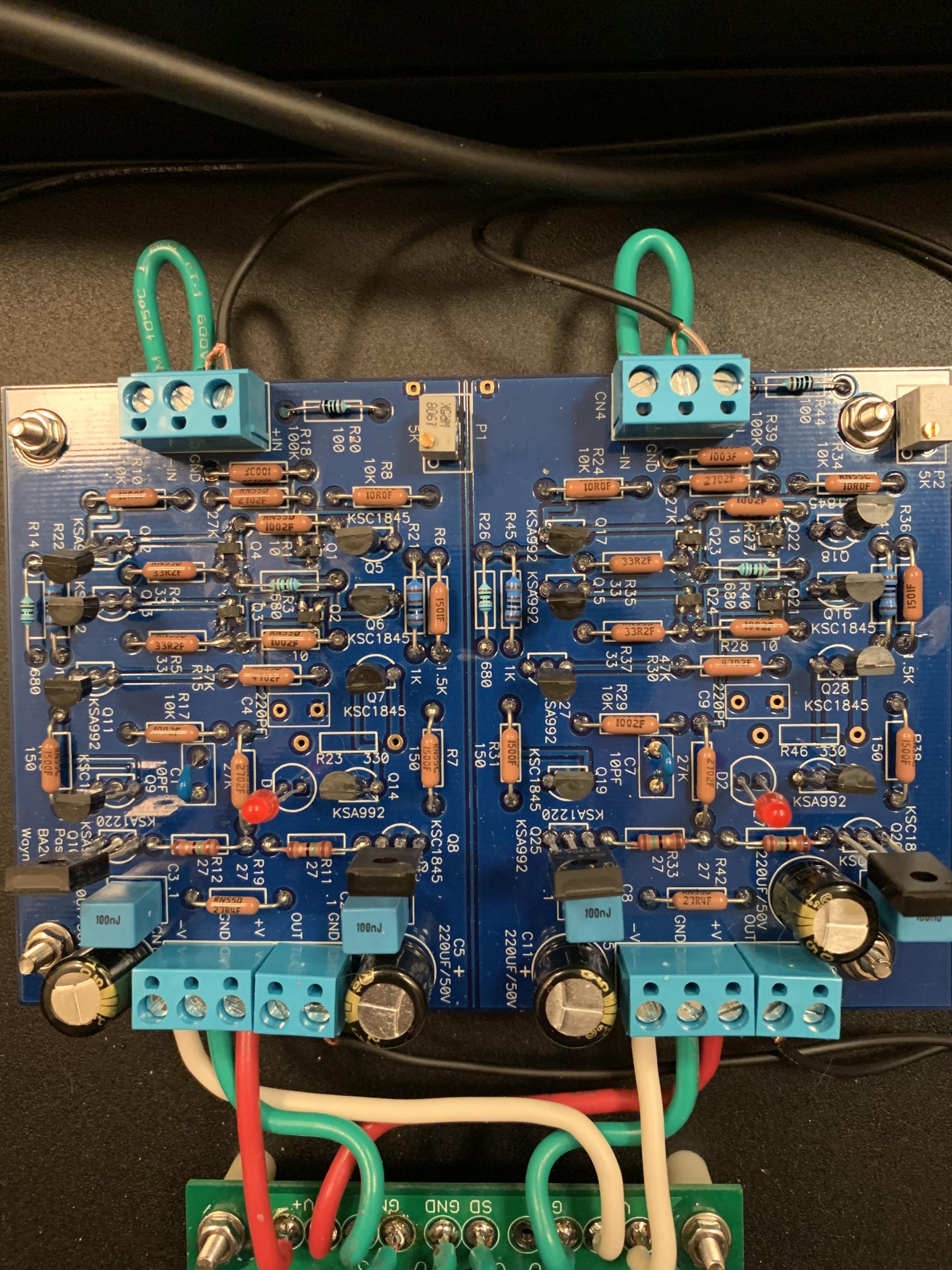

Check R8, R10 and R24, R34 just to be sure my eyes aren't playing tricks against the schematic and values.
Edited - Check R1 and R27 too. Essentially, check all 10Rs against all 10ks.
You’ve got 10ohm where the 10K go and vise-versa.
10R0 is 10.0 ohms
1002 is 100+two zeroes, I.E., 10K
10R0 is 10.0 ohms
Absolutely fantastic!! Looks superb, well done!![]()
Thanks Jim. Your encouragement and continued support of this site is awesome!

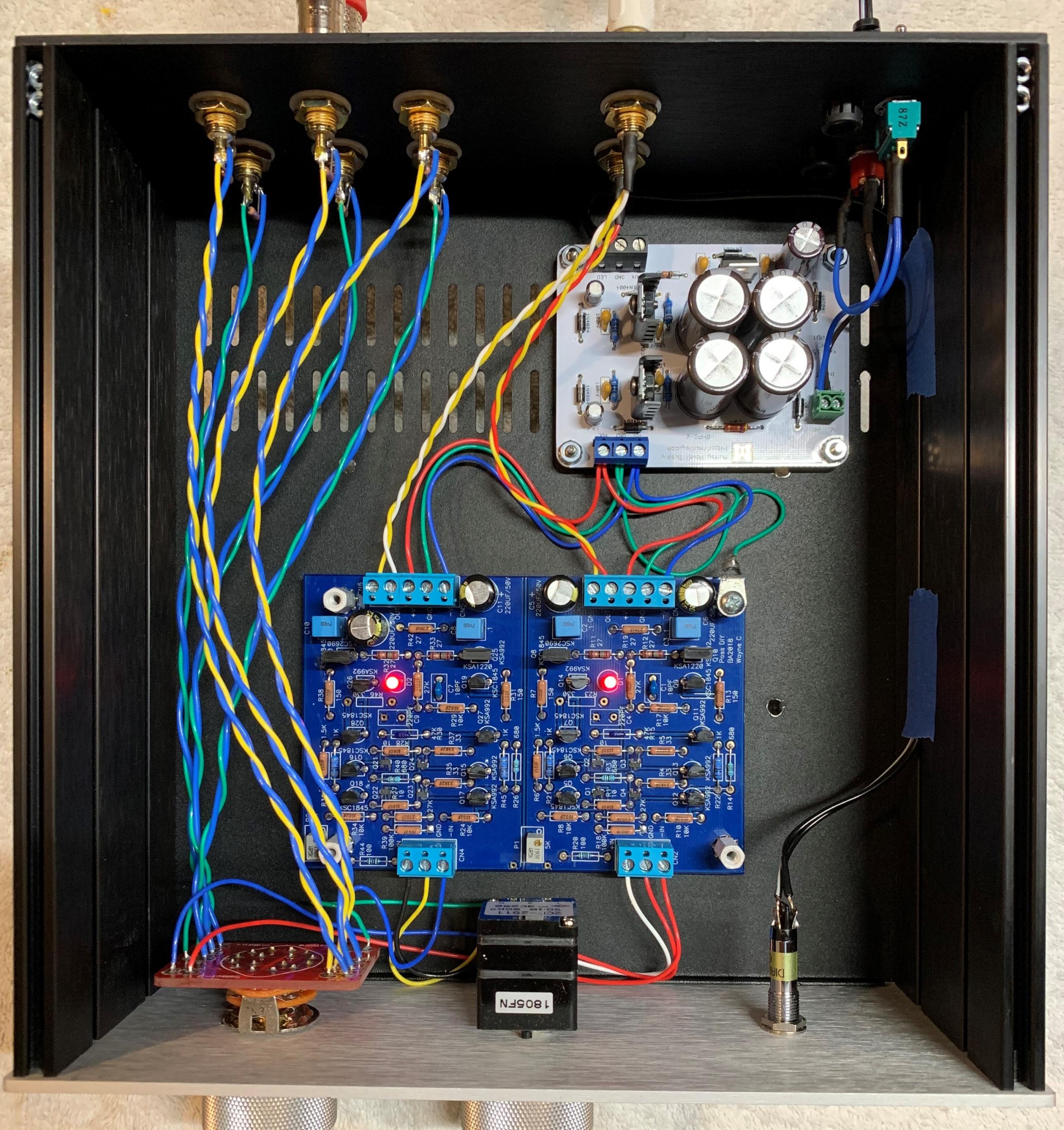

Yes, the selector is a GlassWare Select-2, which selects from 3 inputs. Their Select-5, which I also have, selects from 4 inputs. Great switches and but confusing naming convention!
I highly recommend the HiFi 2000 cases from the diyAudio store. They're very high quality and an excellent value.
@WHCox
When I see long runs of nice twisted pair wiring from back to front of preamp enclosures I wonder if the switches shouldn't be located at the back and actuated via long front-to-back shafts. Wouldn't that be quieter (if less colourful)?
Or is the cost/benefit unfavourable?
No transformers, switching power supplies, or 120 VAC in the case so little potential for interference or noise pickup. Absolutely no hum or any unwanted artifacts at max volume in my system or on the test bench. It’s been my preference to keep transformers out of the case when building preamps for best performance without the need for shielding.

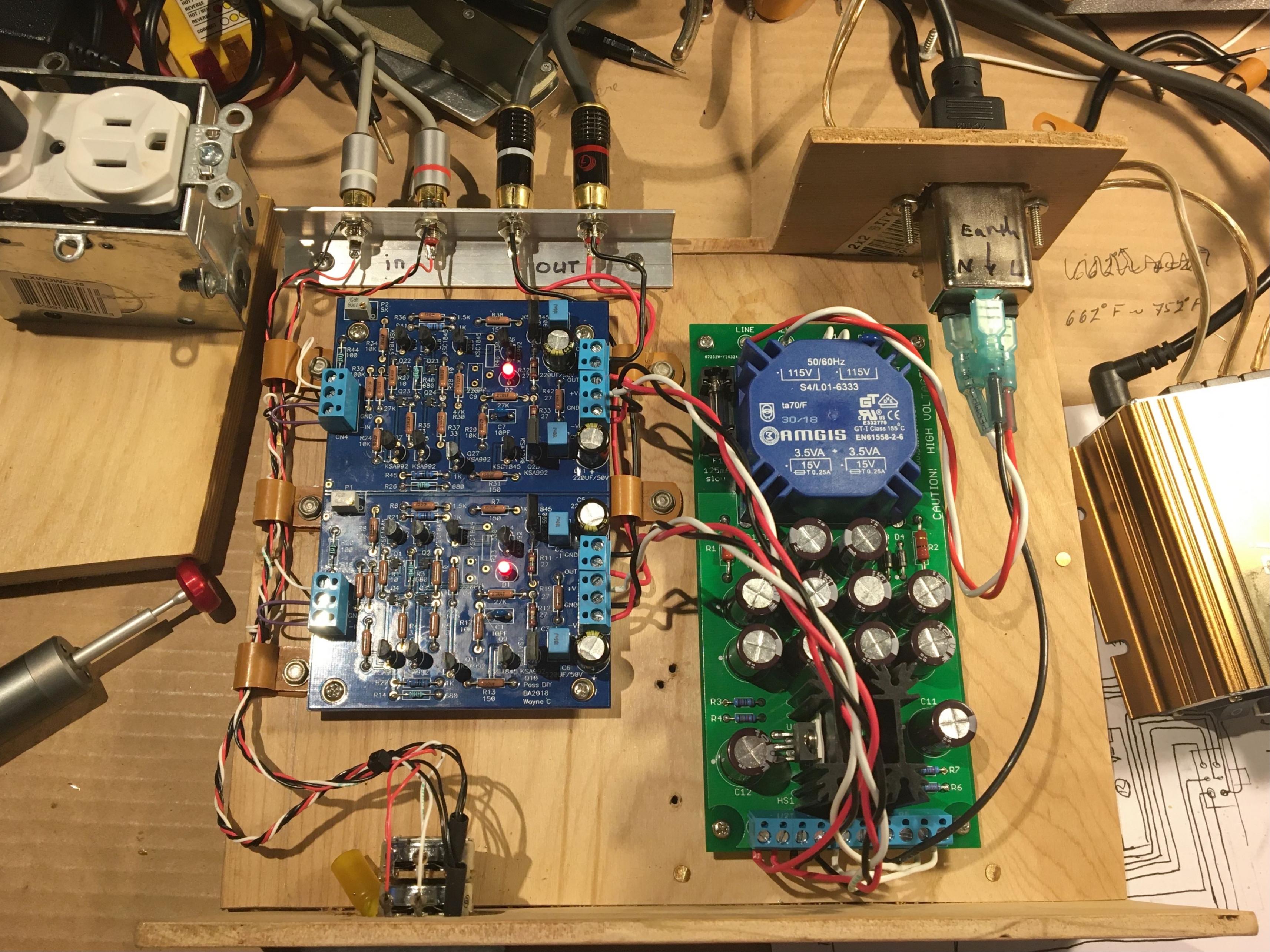

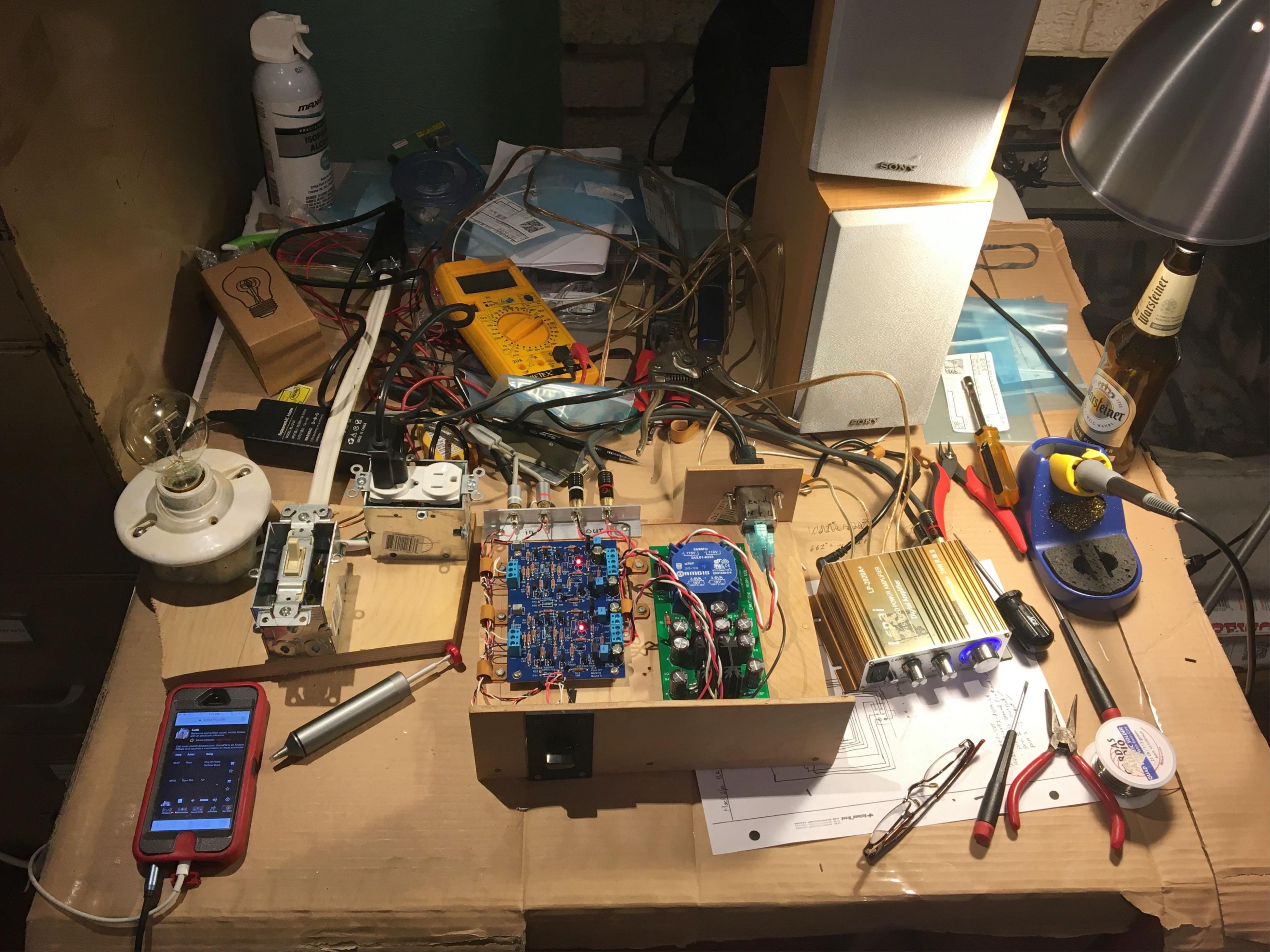

Up & running
Up and running on the first attempt this evening. I am so happy. Now to add an I_Select board and sort out a proper chassis. Many thanks to 6L6 and this forum for getting me this far.
The input lines from the RCA to the Pot and back to the PCB are long and are acting a bit like an antennae and inject a tiny bit of 30 hz hum (more when I but my hand near them or touch them). I added a ground wire between the pot faceplate mounting shaft and the RCA jack ground plane (that little piece of right angle aluminum) and that knocked most of it out. In the final application, the power supply will be in another enclosure, the pot will be at the back (on an I_Selet board), the wire lengths will be far shorter and there will be a better grounding scheme with a metal enclosure which I expect will remedy the problem. Any comments or guidance on this topic are appreciated.
On the power supply (Pete Millet Design) the voltage from Ground to V+ is 15.5V and the voltage from Ground to V- is 14.7V. Is this normal variation? Do I have problem on the power supply board? Will this even have an effect the BA2018 linestage performance?
Thanks and be well.

You should have used one of my PSU boards. It uses the same regulators as Pete's but mine has adjustable output voltage so you can match the output for both the positive and negative exactly.
On Pete's PSU don't worry about the voltage variation it happens with regulators they will hardly ever equal each other so it's quite normal. Hope this helps.
Looking good!
Rail voltage difference won't make any effect on the operation. The two regulators have very slightly different internal reference voltages, so of you want to get the output voltages matched, you need to put pots in place of R4 and R6. (20K, tie one leg to the wiper and use them as variable resistors)
Talking abut layout noise is kind of a moot point when you are not in a metal chassis, when you are in metal we can discuss.
Having the PSU in an outboard enclosure isn't necessary, it can be quiet all in one box. Save the outboard PSU for a phono stage where it genuinely makes a difference.
