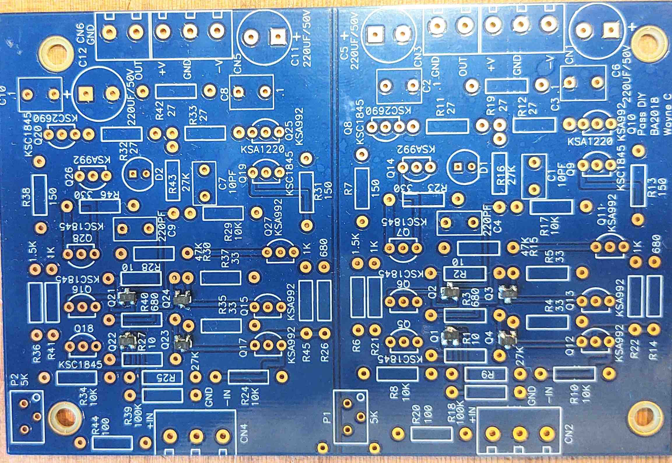

I need some help troubleshooting my build. I'm using the board from the store and powering it using a ultraBIB psu set at +/- 20 vdc @ 200 mA. When I power up the LEDs do not light and Q8 and Q20 get very hot.
I installed the leds so that the cathode(short leg) was towards the flat side on the silkscreen.
It is configured as a line stage using the digikey BOM in this thread (KSC1845, KSA992, 2SK209BL) I have double checked all the transistors to make sure the correct ones are in the right spots, they are.
I double checked all of the resistors and they are the correct values shown on the silkscreen with the exception of R6 and R36 which read 894R and 929R respectively instead of 1.5K, but since they are in parallel with P1 that should be OK.
I have cleaned the board and checked it for shorts and cold joints under magnification and found nothing.
I have attached pics of my build so that hopefully someone can see what I'm missing and point me in the right direction.
