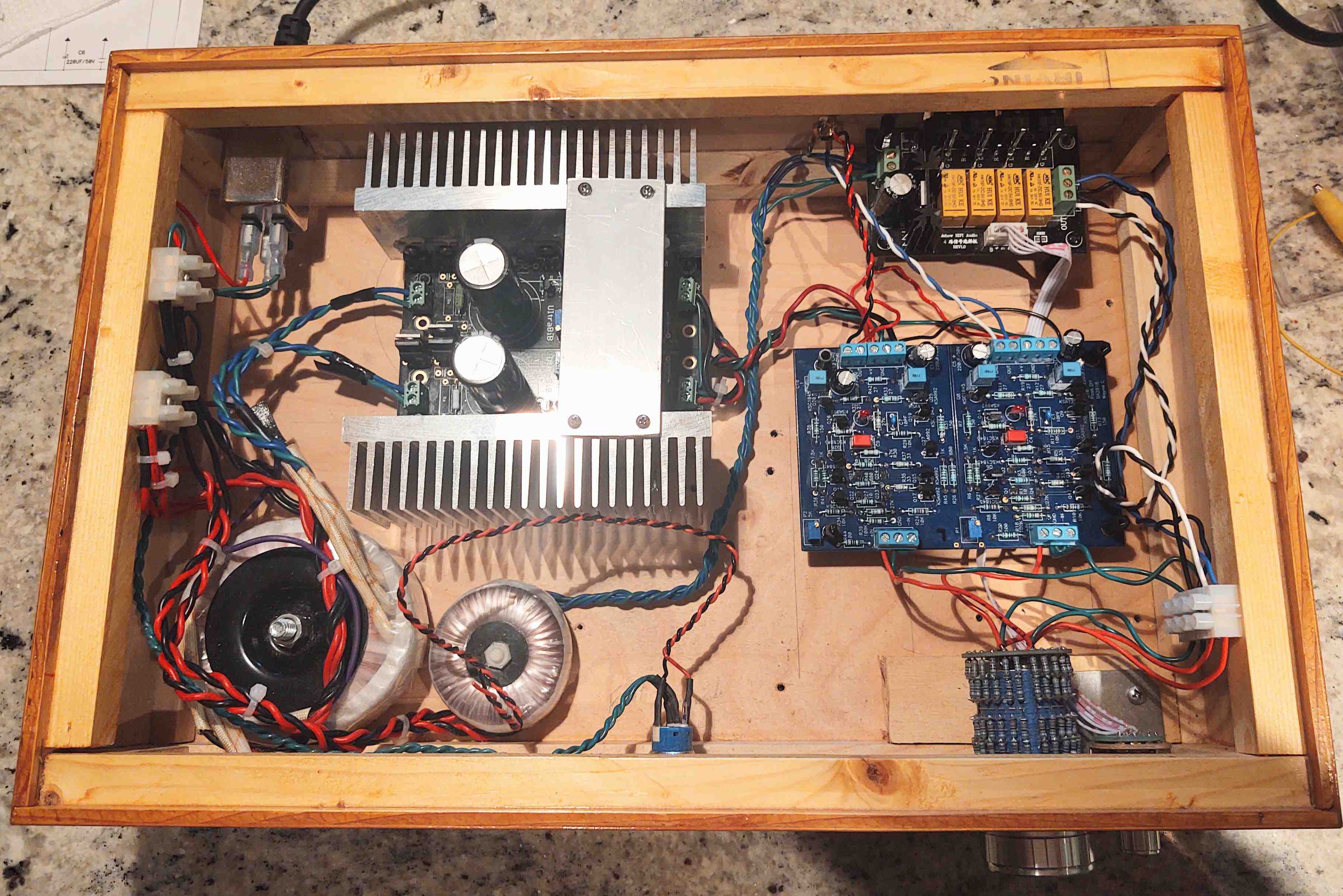

I finished up my copy of Wayne's pre burn in for about 5 hours or so to settle and gave it a listen. I had cobbled it together from spare parts that I had laying around and made a plywood box to house it. So it is a budget build. It is very detailed and dynamic, using an Aleph J paired to some 2 ways it sounded on the bright side compared to the Aikido preamp that was there. It clearly has a lower noise floor than the tubes. I then paired it with a DIY audio Sony Vfet and some horns, wow, a match made in heaven. Not bright, just right. Excellent clarity and sound stage, very transparent, really really nice sound. Thank you Wayne for making it available to us.

PJN—Looks awesome and NOT budget. Nice work. Top panel is just a drop-in friction fit? Love it. It's a great preamp! I liked reading your impressions of combos. I have a recently completed Aikido. My Wayne's pre is totally silent. Aikido does have some "hush", ear to 97db speaker cones but I'd call it quiet. These 2 preamps alone is why one needs 2 complete systems up and running to bounce around with.

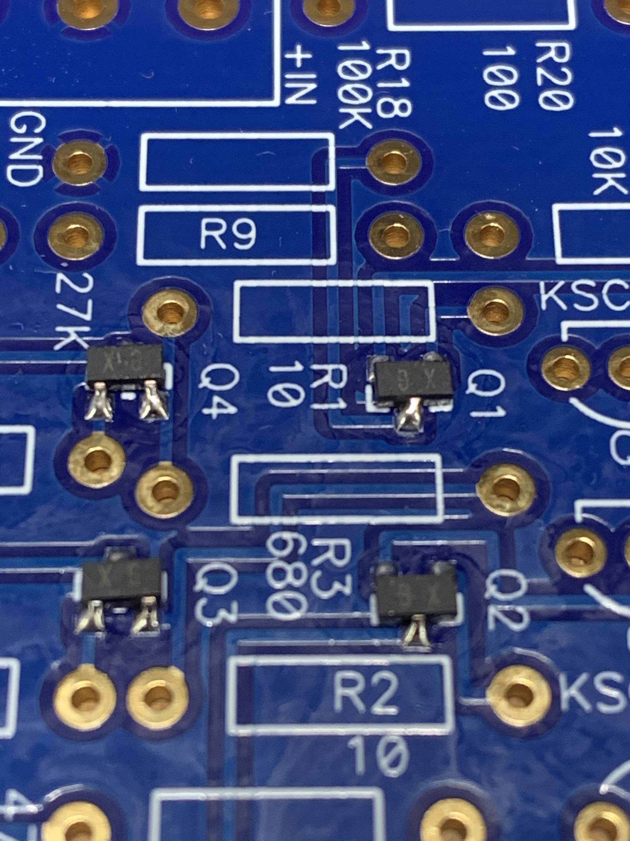

Mouser delivered my JFETS today. I'd heard that they have a habit of getting lost so I ordered twenty of them. I was thinking that this should cover any infant mortality (due to never having soldered any SMD components before) and to allow a few of them to escape in the journey between the anti-static packaging and the PCB. Holy crap those really are tiny!
I had read folks had tried a few different methods of attaching them, but what worked for me was to use a flux pen on all the PCB pads then tin them with a thin smear of solder. Next some more flux, then while holding the JFET in position with needle point tweezers apply some solder to the single leg to hold it in place. Some more flux then solder the other two legs in place before finally re-soldering the first joint. I must say it wasn't quite as bad an experience as I thought it was going to be, but glad I found my old Antex 15W iron with a tiny tip.
All in all it seemed to go fairly well. Now that my nerves have settled a bit, it's time to clean the board a bit more then continue with populating the remaining components.

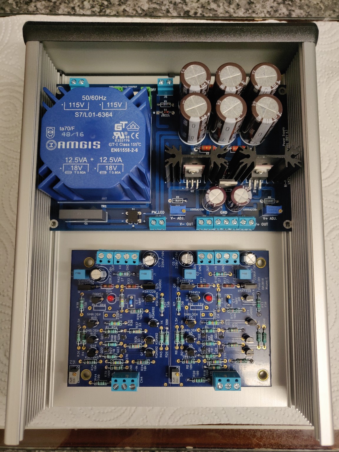

Boards are fully built, just got to drill all the necessary holes in the enclosure and wire it up. Will probably crack on with that at the weekend. 🙂
I also posted a pic of the measured ripple noise from the output after the final smoothing caps. Must say I am quite happy with that result. 🙂
