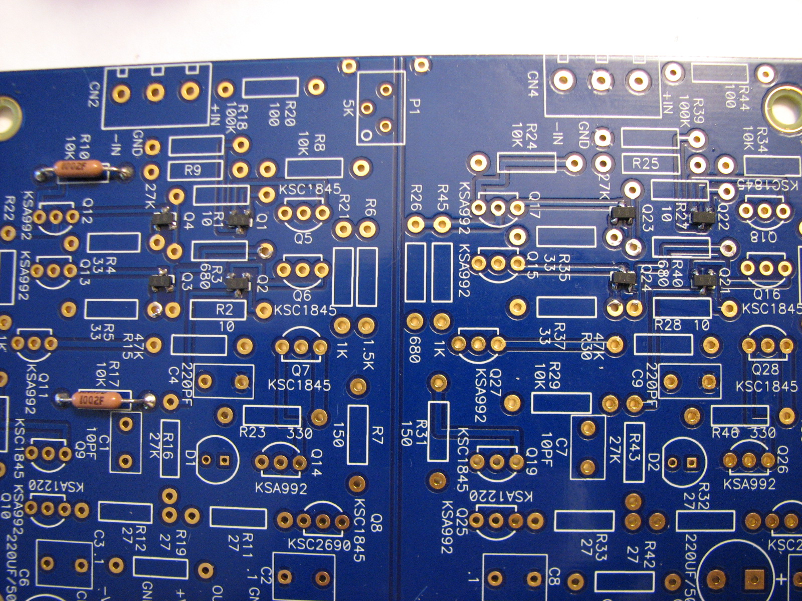

Are Q9 Q14 (and their 2nd channel mates Q19 Q26) the proper devices? Those are the odd ducks in the row. I cant tell from the photos, could you double check that please?
Just soldered in the teeny J fets on the new store board. Much easier this time.
I smeared just a coating of solder on to the single pad side, held Jfet in place with 6l6 scotch tape method. Worked perfect!
Once in place, heat on the single tab on solder coated tab sticking it in place. Over to other side and solder down the two remaining tabs. Then a touch on the initial tab.
The new solder was perfect for this, melted fast and flowed easily making this chore much easier.
One of the Q4 feet looks like I better take a second look, solder melted super easy and just flowed over the pad and tab. Sometimes I notice soldering looking worse in pics...

Had the chance to check out my board.
BPD,
Q8 gets hot, but Q10 doesn't. The voltage across R13 is 2v.
6L6,
Q9 is KSC1845
Q14 is KSA992
Q19 is KSC1845
Q26 is KSA992
The same as shown on the silkscreen.

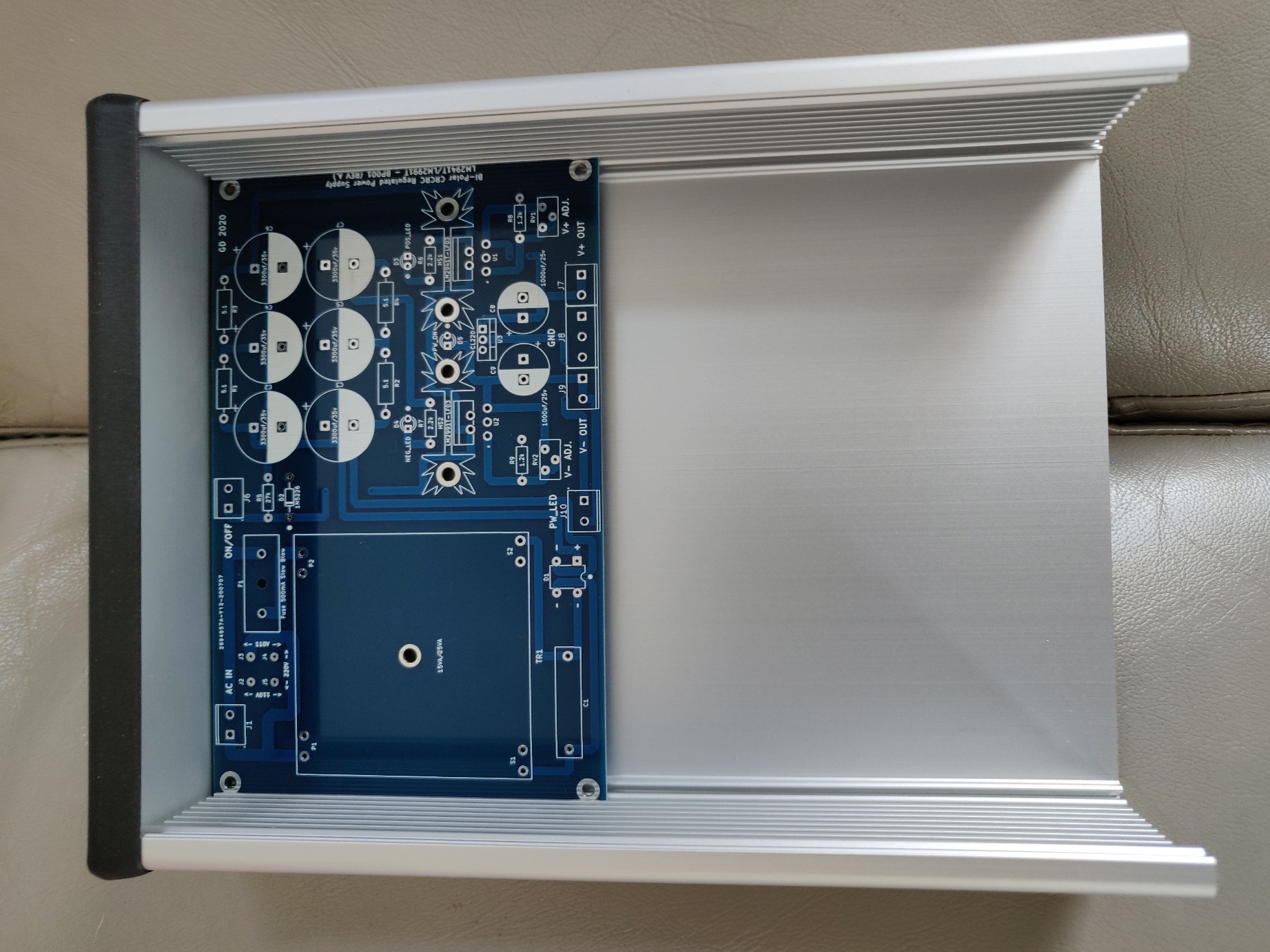

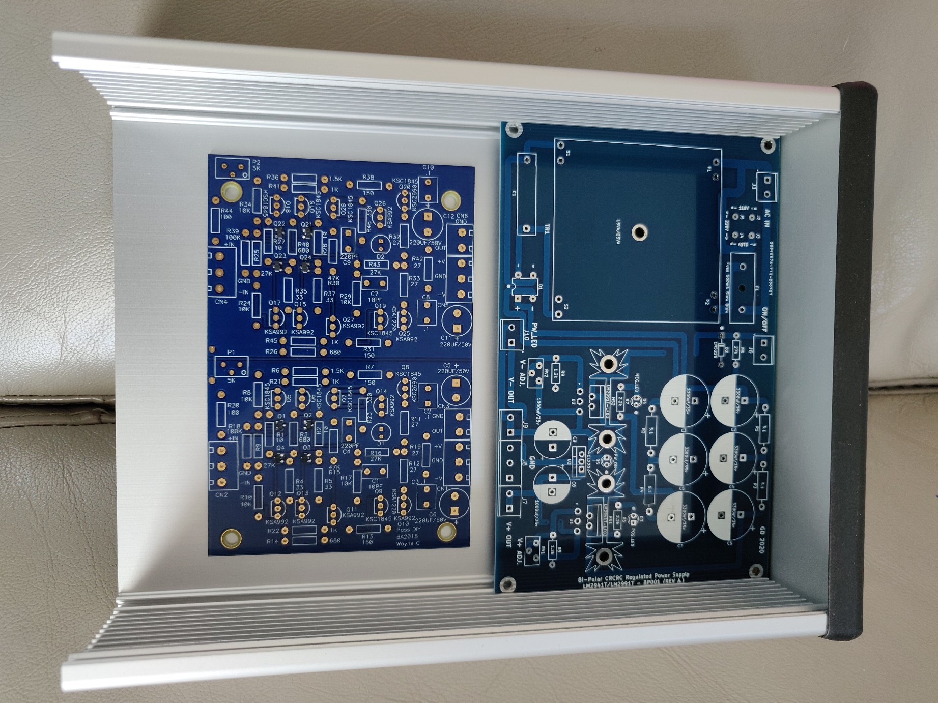

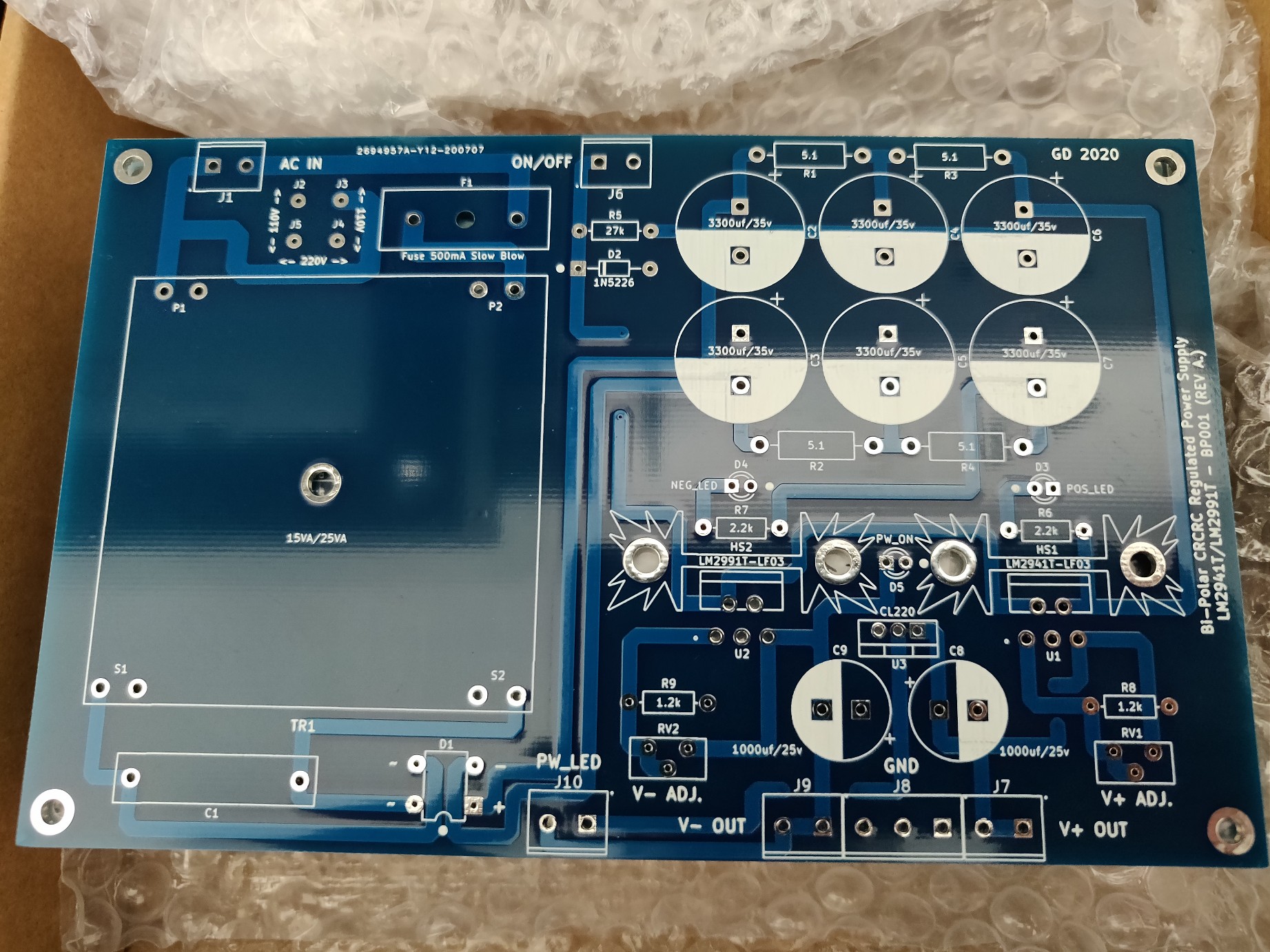

Got my boards back from the fab house and they look spot on! Slides nice a neat into the Hammond enclosure with plenty of room for the Linestage PCB. This is my spare one. I already have a Linestage built and ready to go. Just need to build this power supply and make sure everything checks out. 🙂
Things are looking up, I powered up with the LEDs just inserted but not soldered, LED lights, nothing gets hot and was able to adjust offset to 0 my. I also replaced Q8. Now I need to assemble it all and give it a listen. Thanks all for your help.
Just got it hooked up and it's playing music. Letting it break in on my garage system before I give it a serious listen, but sounds very clear.
