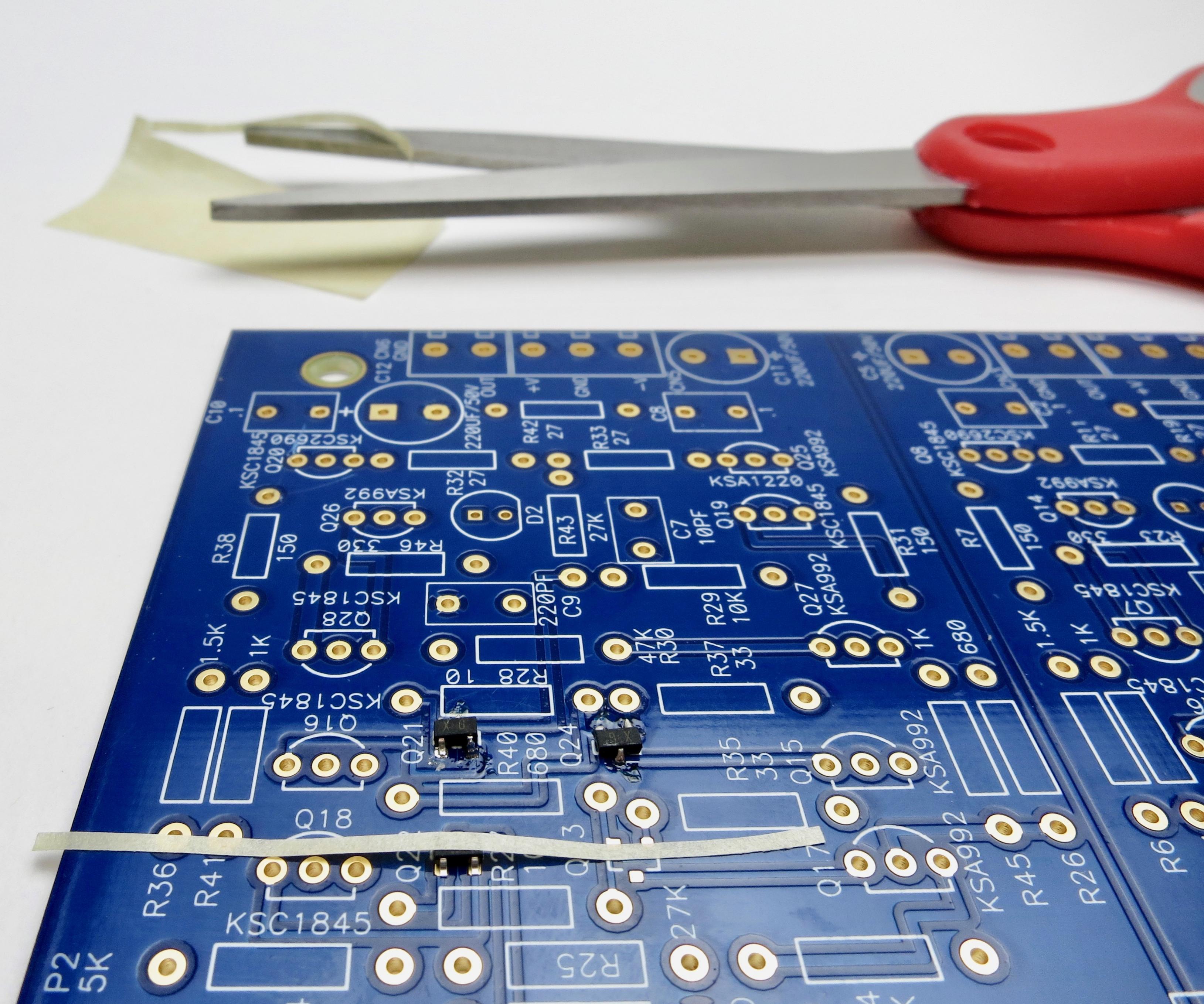

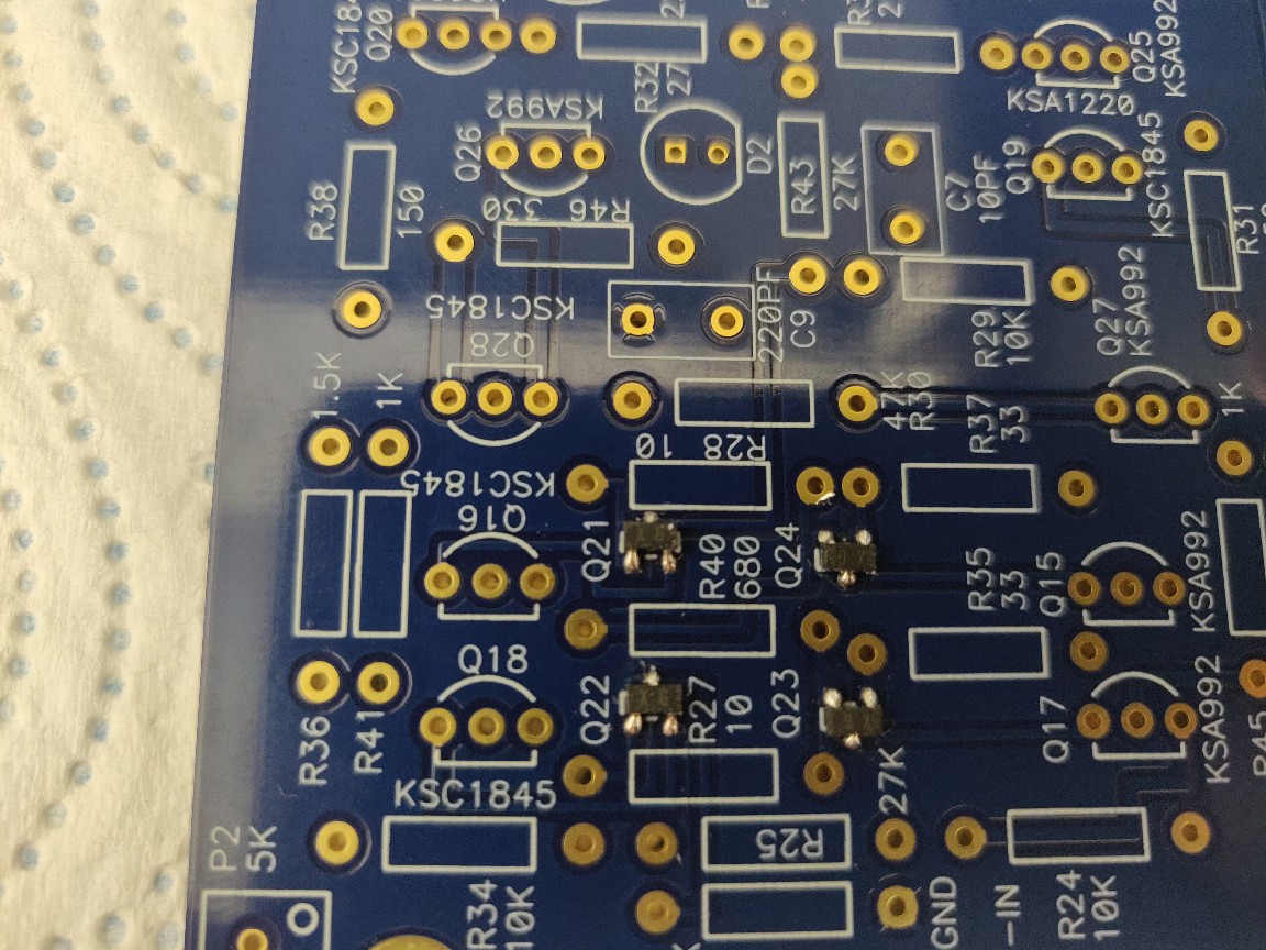

This is the best solution I've found (so far) for getting the SMD transistors soldered;
Take some masking tape and cut a very thin (1 MM or thereabouts) and long 50-75mm (2-3") strip. Put the SMD in the middle of the strip - now you have a long enough handle you can place and align it easily with two hands and then stick it down. Solder one leg. Once the first leg is done it won't move and finish the other two. Easy!
I think this may work better than helping hands w/bamboo sticker! Can't wait to try!

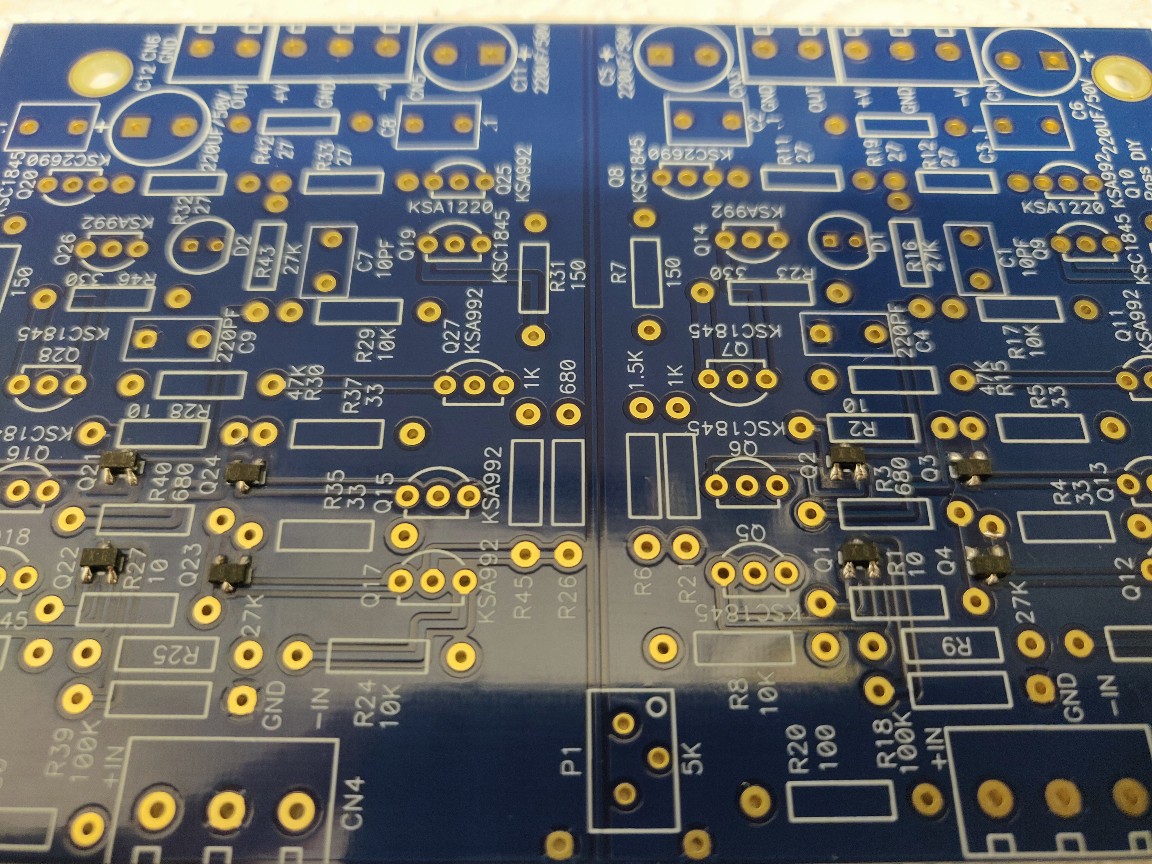

I could'nt be bothered to wait for my gel flux to turn up so I used some BluTack to hold mine in place while I soldered the first couple of legs, then removed the BluTack to finish them off. Turned out great!

Like an idiot despite taking my time I ended up soldering the KSA1220AYS output transistors the wrong way round as I wasn't quite paying attention to the flat of the silkscreen. As a result I had a hard time desoldering one of them and it got a bit warm. Anyway I am a little concerned about the component now but I switched them round the right way regardless but have not powered up the board yet. Is there a way to test in the circuit if one of the output transistors has failed? What would I need to check or look out for? Any help would be greatly appreciated.
Okay I've sussed it. Powered it up anyway and measured and adjusted the DC offset and got it bang on zero for both channels. Next step to build it into an enclosure. I am going to use the same Hammond enclosure as I did for the Whammy. Everything will fit nice and snug. 🙂

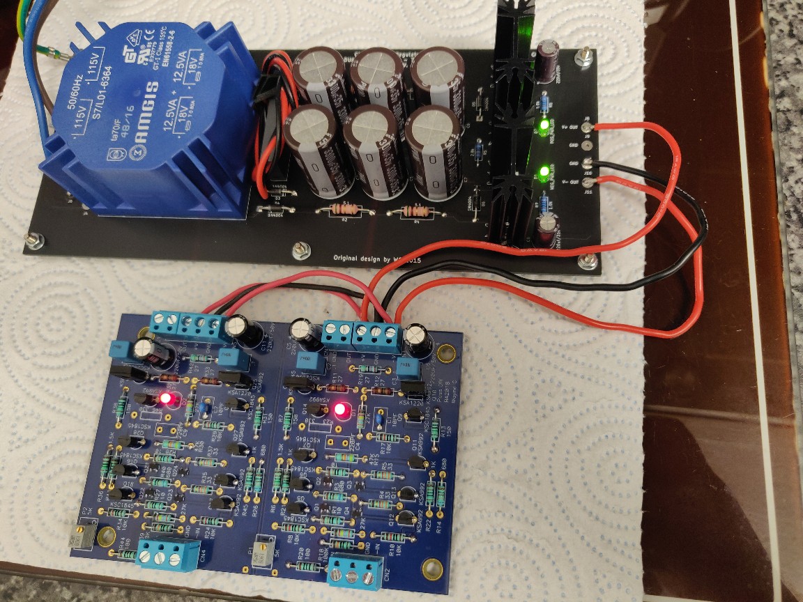

I recently rewired this preamp, reversing which side power input was with the side with input RCAs. This allowed use of one of Teabag's I-Select relay boards which have pads for Alps blue pot. One volume pot shaft extender and associated wiring later, ready to fire up.
My original build was with smaller outputs, with rewire I used another pair (older mono boards w/o mounting holes.)
This set of boards with larger outputs is more stable ( of my 2 builds ) with DC output than the smaller version. It is possible that something about the original build (bad solder on jfet?) or parts that caused this difference. One board was stable around 2-3 mv, while the other would adjust the same, it always seemed to drift up to 7-17 mv.
Sonically the large outputs seem fine. I'm letting it burn in a bit, but initially it seems a little less forgiving than the smaller outputs easier sound.

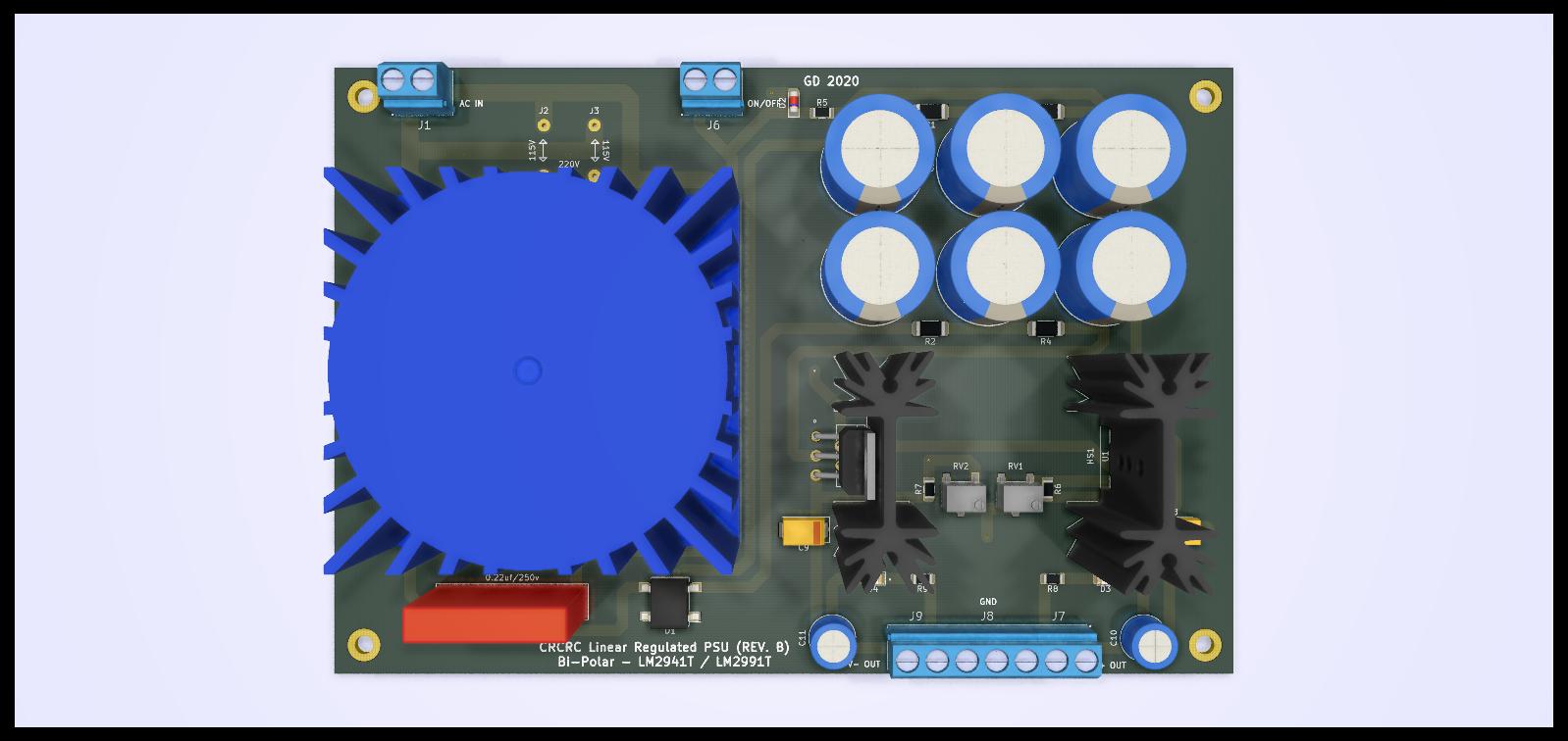

Okay a little surprise for you guys! I was looking at a power supply recently that Pete Millett built using the LM2941T and LM2991T regulators with the 5 pins and I was quite impressed how much better they were than the old 78xx and 79xx regulators. I decided it was time to build another PSU and this time I was going to make it smaller. My new design slides straight into a Hammond 1455T2201 enclosure leaving plenty of room for the BA2018 LineStage PCB. I have attached some pics for your reference. And yes there are SMD components but ones that are easy to solder by hand. 😉 Size is just 159mm x 108mm so much smaller than the last one! 🙂

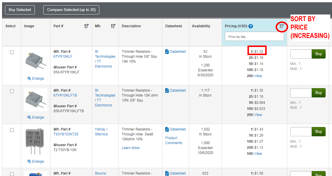

Hmm, the TO-220 chips are not bolted to the heatsinks, and the top side of the transformer has no markings at all. No part number, no indication of primary winding vs secondary winding, no manufacturer's logo.

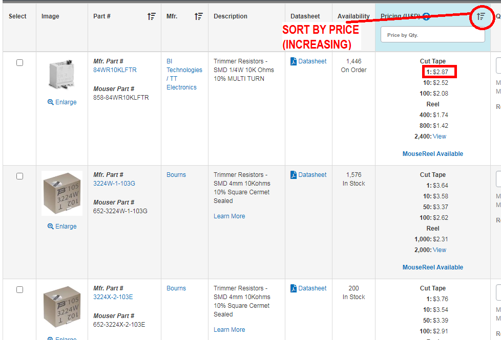

I'm surprised that you chose trimmer potentiometers in surface mount packages. At least at mouser.com, multiturn SMD trimmers are significantly more expensive than multiturn thru-hole trimmers, and the SMD units aren't any smaller.
