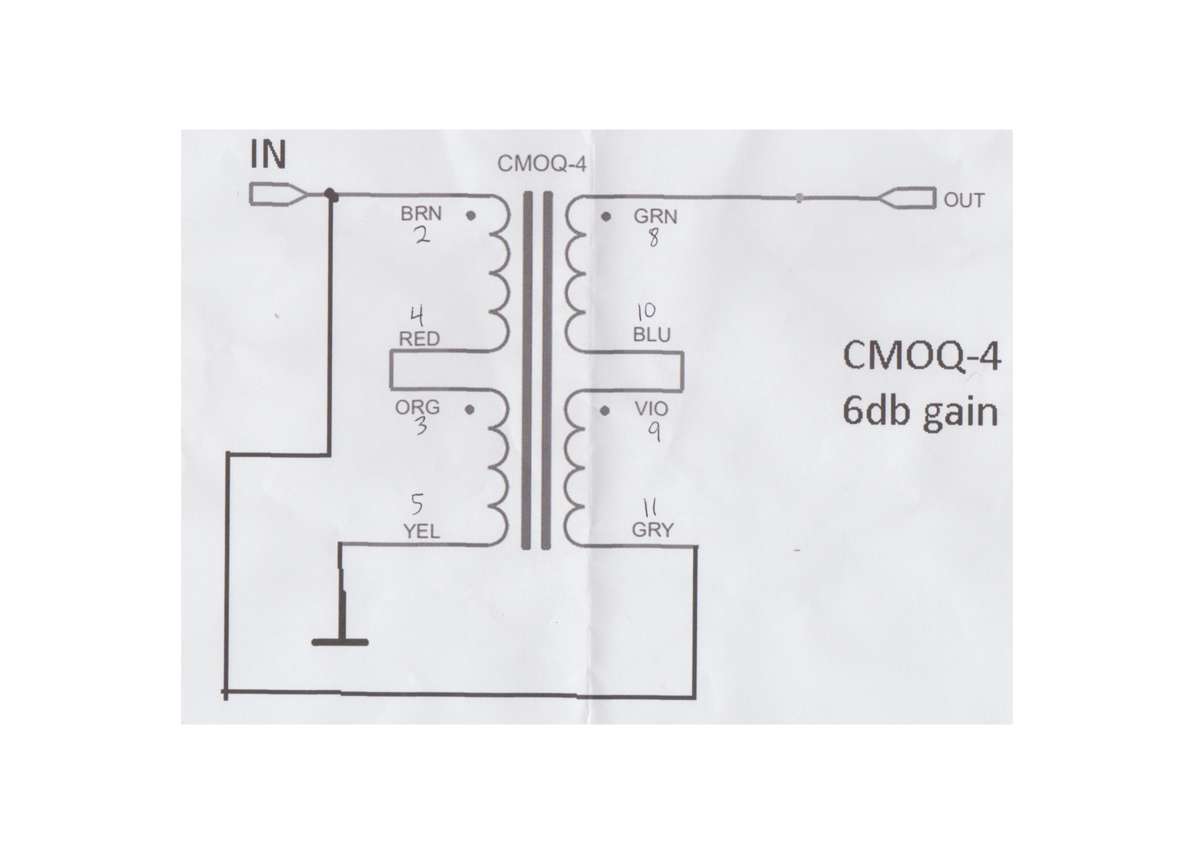

Wayne's LS has a really nice low output impedance and low DC offset, so I have found that I like an autoformer on the output for more gain (+6). I use the 80% nickel Cinemags (CMOQ-4H). The Jensens's from the F6 work well too. Slightly different character.
Yes, that looks like a perfect solution for what I want. I saw your builds while going through the thread earlier today and realized 6 dB gain using transformers were exactly what I was looking for--and hadn't realized it until I saw it. Thanks for the inspiration!

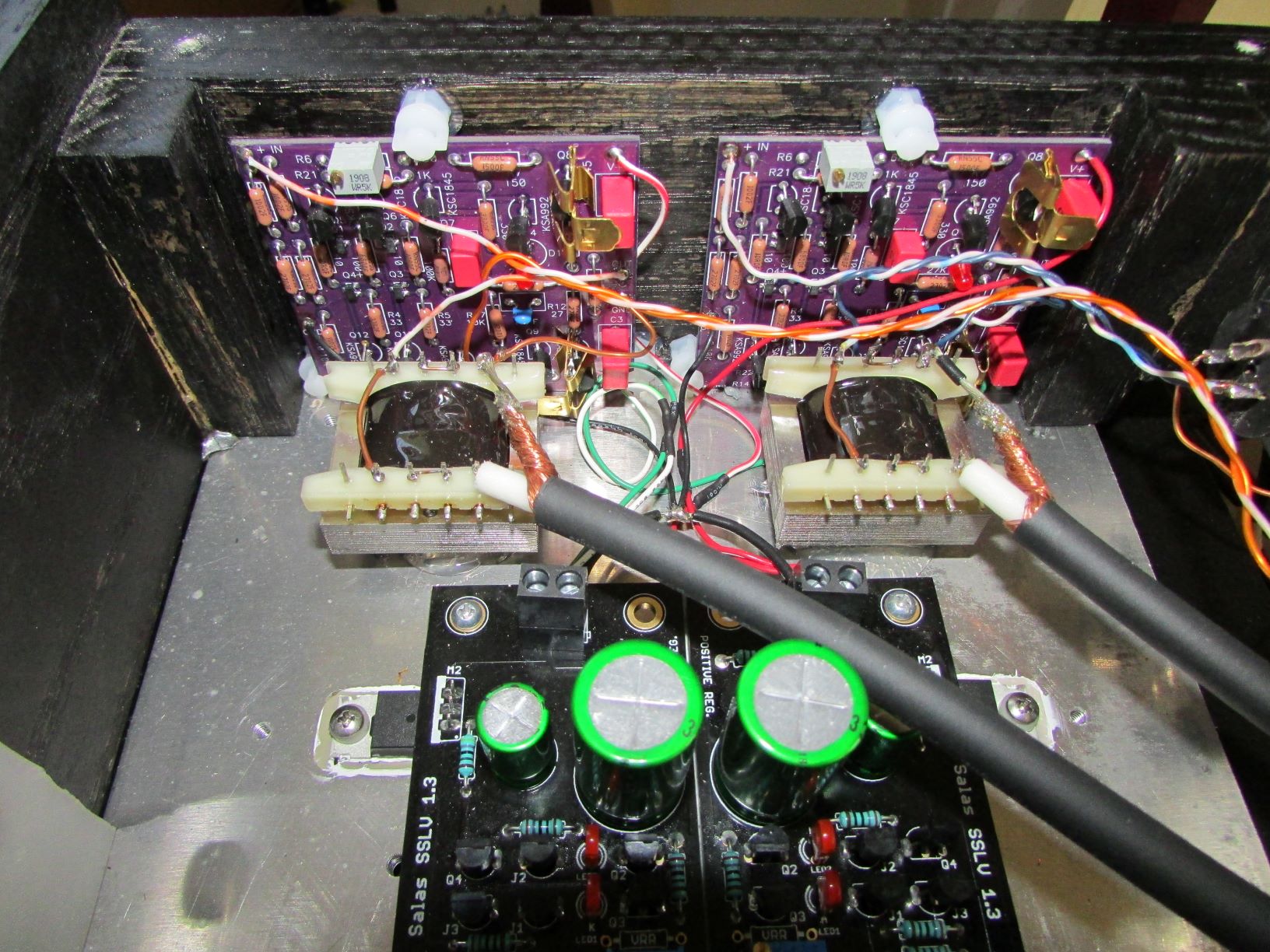

That will prove useful to me, thanks, William. Do you have a photo of the Cinemags in situ, just so I can be 100% confident that I install them correctly?

Not my best work with the coax. I was just trying to bypass an intermittent RCA connector that was causing some frustration.

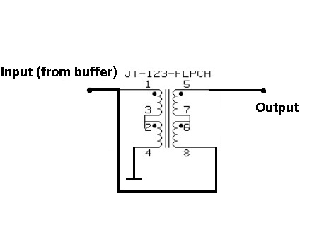

I've got the diagram for the Jensen somewhere too if someone needs it.
Unless you already posted it, I asked about this back when you first added the transformers, I believe they were jensens at first? You may have posted it then. Otherwise I would like to see this with jensen, with my rebuild (got a new board from store) I would like an alternate out with this. One out regular, one out hooked to transformers.
