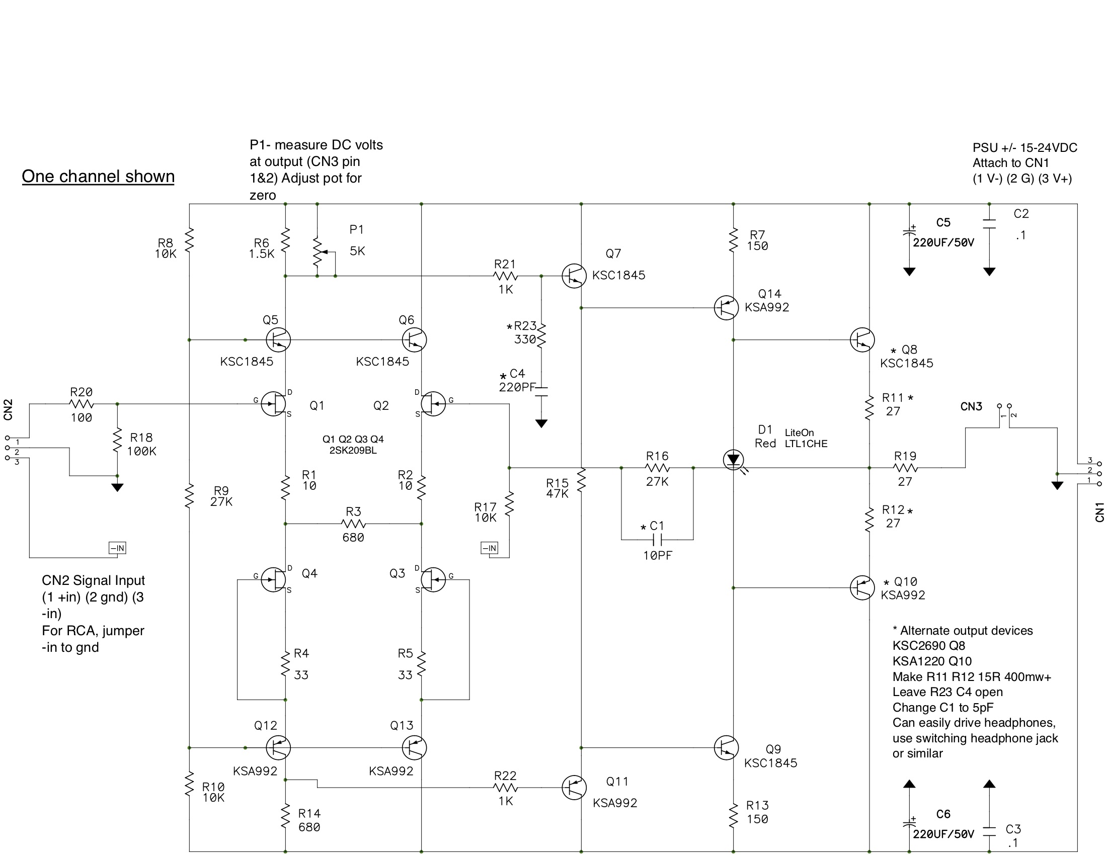

Folks:
I don't really understand the advantages of using KSA1220 and KSC2690 at Q10, Q20 and Q8, Q20, respectively, but I do have two of each available if they are worthwhile substitutions. Do they need to be matched in any way? And if I do use them, do I understand correctly that R11, R12, R32 and R33 should all be changed to 15R / 1W? At what point does using larger output devices become worthwhile? I expect my rails to be running at just over 18+/- VDC.
Scott

If you are planning on having the ability to easily drive headphones, use the big output transistors and their associated 15R resistors. If you plan on using just as a linestage, the smaller package transistors work beautifully.
There really isn’t a right or a wrong answer.

Also, I used 15 ohm / 1/2 watt resistor on R11, R12 with large output transistors. Is that okay?

1/2 watt resistors are great! You can always use bigger dissipation resistors. And the difference between a .4W and a 1/2W is minuscule.

Yes.
Here's a schematic with some notes, I'm going to include these in the parts kit, but it needs to be here as well. 🙂

The circuit works just fine with normal metal films and common caps. There's nothing special about the parts in the kit, aside that it has all the parts required to configure it with either the big or the small output devices.

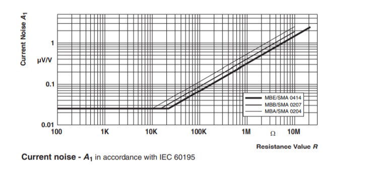

Mouser has the KSC1845FTA back in stock so I have worked up a Mouser Project BOM for the BA2018. I did some research on Vishay resistors and found that the quietest ones are actually the Vishay/Beyschlag MBA-series. Quieter than the SFR-series typically spec'd by Papa. They are also slightly less expensive and generally more available than the RN55-series preferred by 6L6, with the downsides of no printed values on the body and 100% tin plating on the copper leads instead of tin/lead plating.
This BOM does not have the high power output transistor option. It does have everything in stock as of this posting. I've included a separate excel spreadsheet that includes the device numbers from both channels of Wayne's schematics.
Spreadsheet also has lead spacings and critical part dimensions in case you want to do substitutions. Due to space limitations, the Mouser BOM only shows device key numbers for one channel but the quantities are correct.

Awesome. I am excited to try this out and compare it to my BA3FE. Not sure if it will be powerful enough for an F4, but I am also building M2x mono blocks to use this linestage. A couple more questions I have:
- Can resistor 11 and 12 be changed to 18 ohm instead of 15 ohm? I have a few in my stash.
- As for matching, I saw a few posts that matching is not needed for any of the devices. I just wanted to make sure this is correct.

Those resistors will work just fine and you are correct no matching is needed.
Perfect. I would want to integrate a headphone amp and use the larger 2690 and 1220 for q8 and q10 so I wanted to make sure the 18 ohm would work for R11 and R12

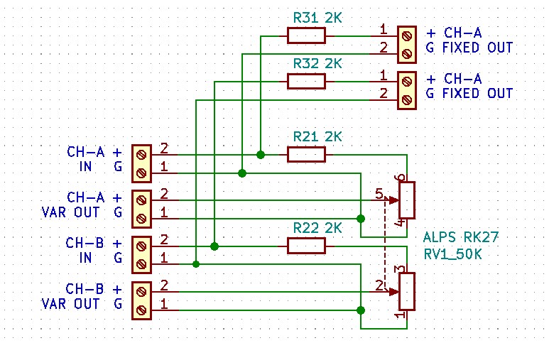

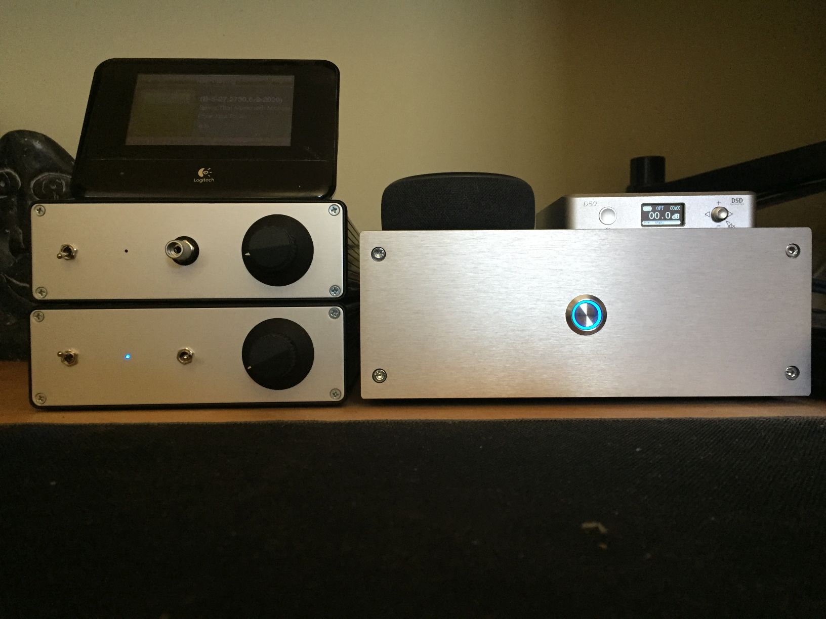

Thanks for the advice, Jeff. I've modified the power supply board for wider HV trace clearance. For anyone interested, I've attached a zip file with the schematic and the gerber files. Also, a picture of my BA2018 preamp built to match my Whammy HPA.
I split the feed from the preamp input selector switch using isolation resistors and fed it a pair of RCA jacks that connect to the Whammy input. Not sure I needed the iso resistors. Each unit uses a 50K pot, effectively 25K in parallel. They are there in case other setups might create too much source loading and to prevent or reduce possible control interaction.
