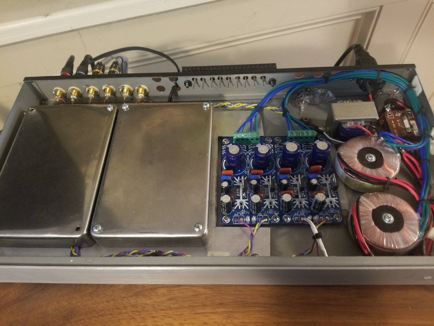

I finally got my BA2018 Linestage going. I'm not a good writer....

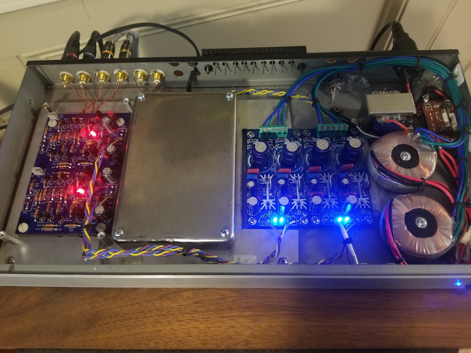

Few lousy pics so ZM doesn't yell at me.
Just using LM317/LM317 PSU dual Mono. Shielding covers for good measure. I am considering putting the NS10 under the other cover. I use a separate arduino / remote controlled relay attenuator so no POT in there....
