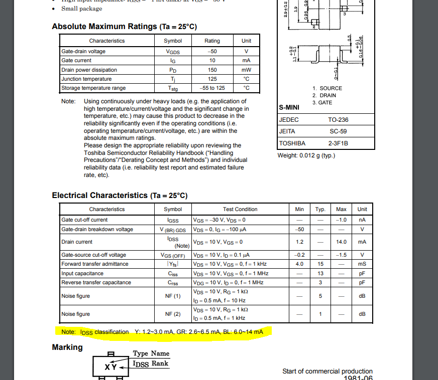

Thanks Jim. Mouser now has the 2SK209 in stock. Buy 10 for the better price then just 8.
2sk209 Semiconductors | Mouser
Mouser currently has the GR
Jim pointed to the BL at Digikey
I can only see one datasheet. Did Wayne spec the grade?
I am unaware of any high end manufacturers that might be using them - even in $100,000.00 plus amps!!
Reading the Vishay data sheet for them, they state they are specifically made for high end audio, so it would be nice to find out who is actually using them, as Vishay would not be making them if they did not sell.
I know that Khozmo use them for their highend attenuators for the shunt attenuators. They use it for the serie resistor. Leg spacing fits for this kind of resistor. Apart from that I have not seen them in use.
You want the BL grade Toshiba.
EDIT 31MARCH'19 - GR or BL work fine in the circuit.
