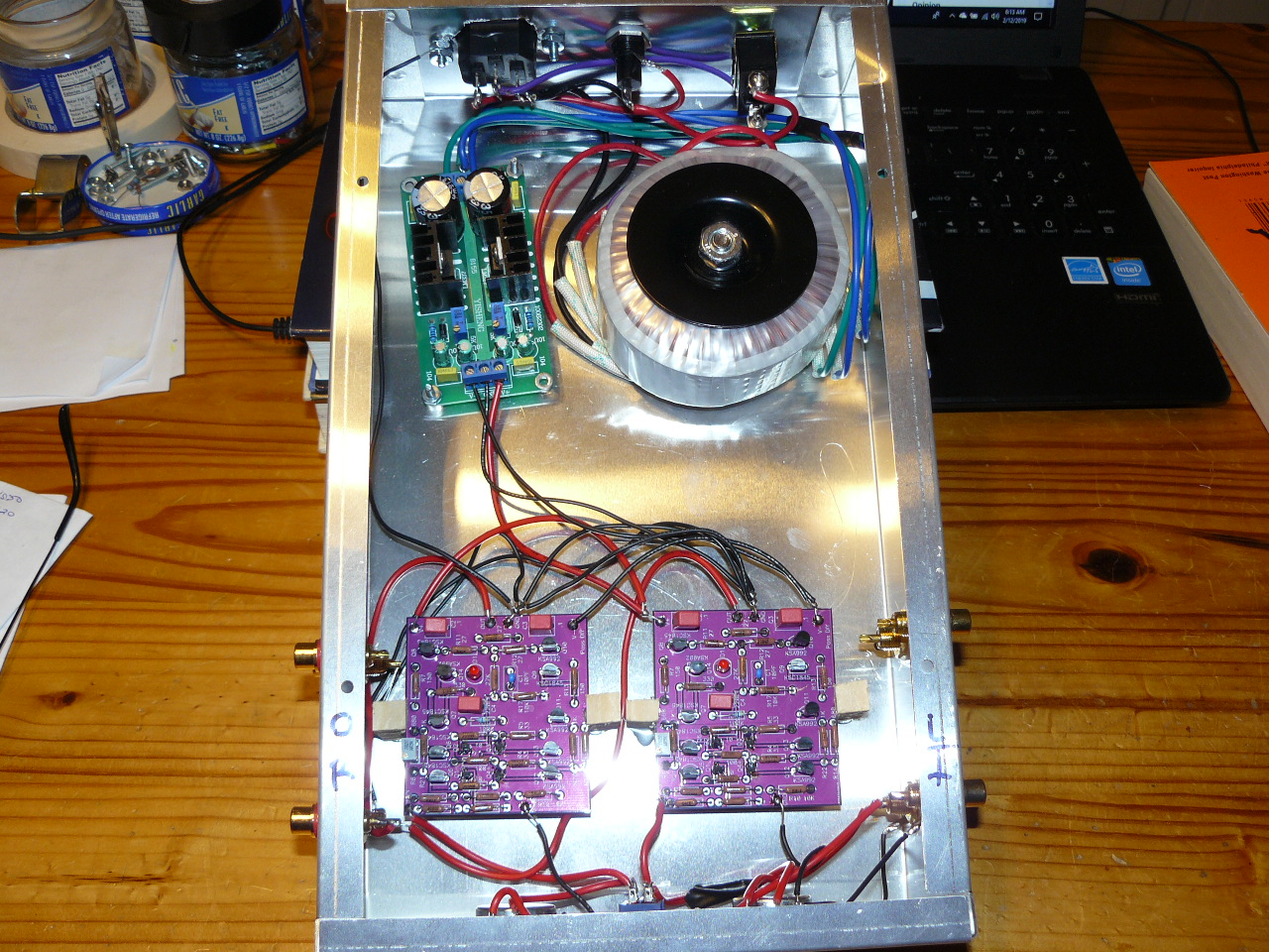

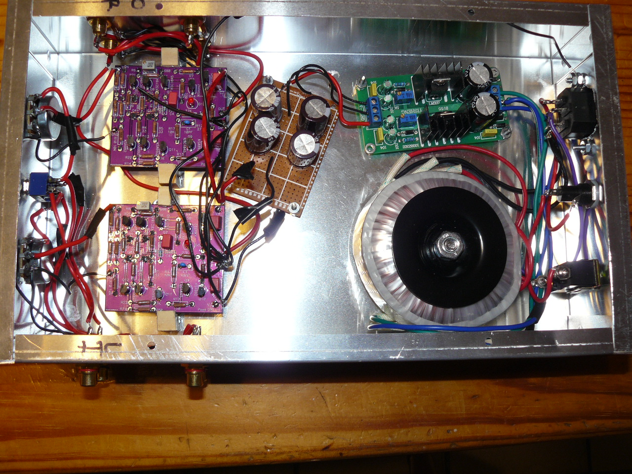

Russell, I had a touch too much hum on my build as well. This is with very efficient horn speakers and a cheap Ebay switcher. As I said in a previous post I just added some more capacitance after the switcher much as Nelson has done of some of his projects using a switcher and lowered my hum to an acceptable level. Why not give it a try first. Something in the neighborhood of 1500uf to 2200uf caps.
That doesn't look like a switcher?
Your correct, regulated PS. Two brain farts of late.

Russell, what kind of transformer are you using?
The Antek 6L6 suggested a few posts back.

Even Nelson has said there is a lot of variances in Toroid's. Have you tried placing the toroid far away, outside the case, and see if you still have the hum? There is a member on this forum who had a bad hum on a M2 build. He spent a lot of time and money before moving the transformer outside the case. It was the toroid causing the hum.
I actually had it dead quiet. Then did the cap swap 6l6 noted. Killed a cap, should have replacements any day. Must have had a bad solder joint which surprised me....generally very careful, but there you have it! I mean there was no hum, stone dead quiet.
