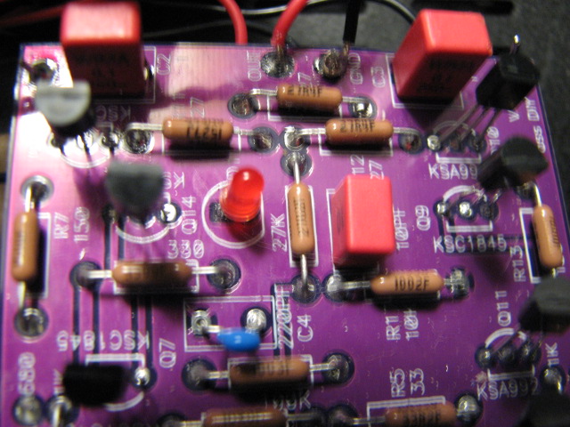

Do not know if it will even work without the jumper underneath the board but I have to ask. Did you install the jumper underneath the board, V1R0 boards?

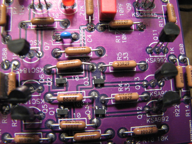

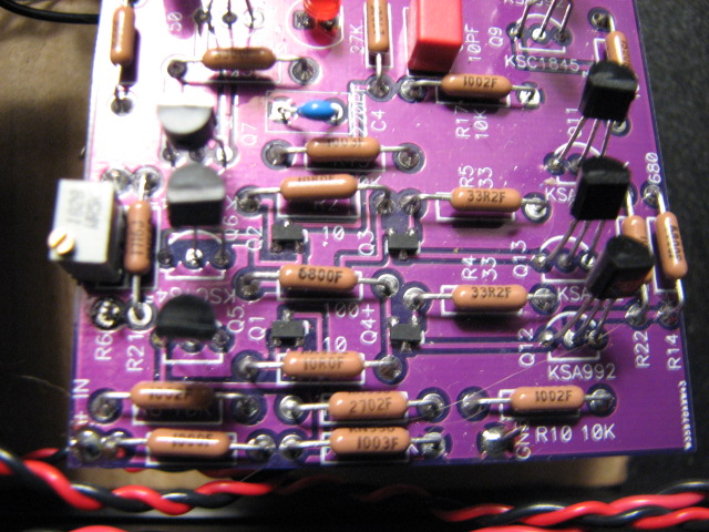

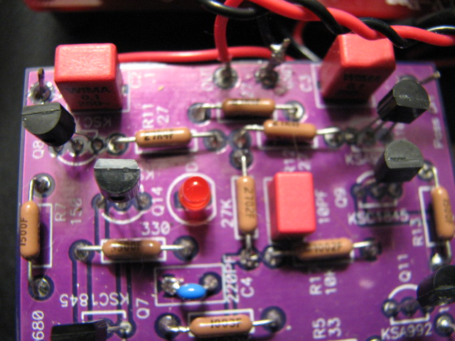

Probably of no use, but here is a few closer up pics, all the three legged devices are in the right place and oriented correctly. re flowed one of the pots three legs, seemed offset would jump around when I put the screw driver to it, or took it away.
UT OH...what board? You mean power supply?
