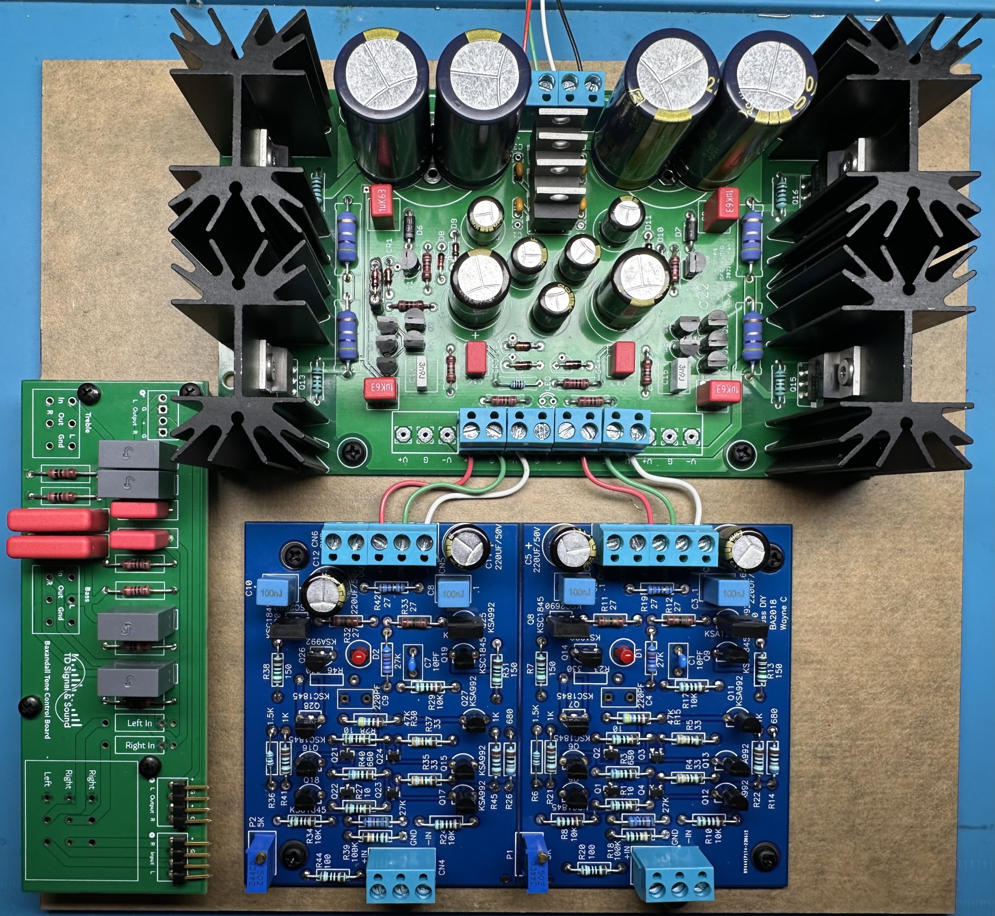

Yes, and then a ground loop breaker. And gather those ground wires into one connection point, instead of leaving two inches between them as loop area.
The current setup is bound to hum. And remember: the ground loop breaker / resistor DOES NOT go between PSU and amp boards, but between PSU and chassis.
As a quick test to help troubleshooting, simply disconnect the wires from the VRDN to chassis. Listen, any difference? Then, gather the grounds to each VRDN into one socket instead of spreading them around. Then, put a wire between the two BA2018 halves’ ground sockets, and listen. Quiet now? If not, look elswehere than grounding issues for faults.
If lifting the chassis connections by and itself solves it, use a GLB. A simple resistor may not solve it.
Btw: have you tested the BA2018 circuit and confirmed it works as it should, noise free?
Do this systematically. From your follow up posts, it is difficult to discern what you have and have not done.
PS: One channel at a time.
Hugz and spanks,
Andy
Right channel, run alone, wow, finally quiet. Add in another resistor to the left channel, power it up and...noise returns to both channels. So geez, there is some dark voodoo going on when two or more VRDNs are up and running. Will ponder off into the darkness...I'm still missing something.
If the right channel run alone is quiet that is a start.
Things to try:
-Left channel run alone. Quiet or noisy?
-Right channel with left channel power supply, run alone. Quiet or noisy?
-Left channel with right channel power supply, run alone. Quiet or noisy?

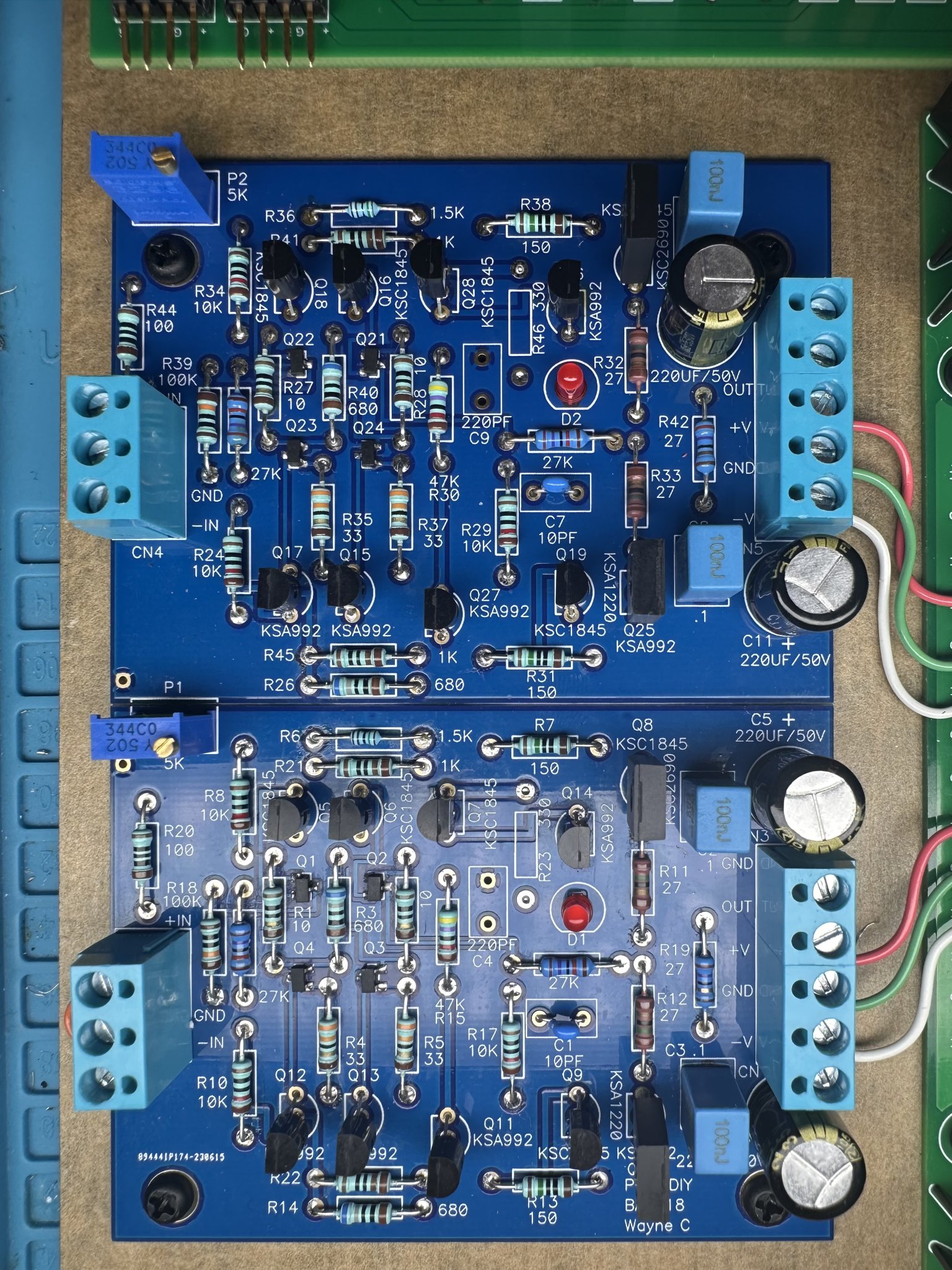

Hi everyone. Great thread! I just finished this build and doing some final checks and noticed that I'm getting 14v at one of the outputs. I was able to get the other side down to zero using P1, but no matter how much and in which direction I turn P1, i can't get the voltage to drop at all. I've confirmed that the POT works because as I've noticed that making adjustments to P1 changes the resistance on R36. I've checked resistance on all the rest of the resistors and for the most part they're all spot on with the exception of R10/R24 which start at 8k and slowly creep up. this happens on both sides though.
Any thoughts? thanks in advance everyone!
-Thanh
Note: R6 and R36 are smaller because I swapped them out to test. They're good quality 1/4 watt vishays. I'm probably going to put the original ones back since swapping them out didn't resolve the issue
You can look at my comments at #4333 and #4336 to a member with a similar failure mode.

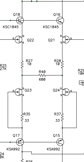

Ohm's Law is a formula used to calculate the relationship between voltage, current, and resistance in an electrical circuit. If we know two of those parameters, we can calculate the third with an extremely simple calculation. Is there any current flowing through Q21, Q22, Q23, and Q24 (and associated components) on your defective board? R35 and R37 would be a fantastic place to check for that. If you know the resistor value, and you know the voltage across it (measure w/ DMM), you can very easily calculate the current through it.
Although things look pretty darn beautiful, touch up the SMD soldering on the non-operative side. That's usually the culprit when you've got lots of DC on the output.
Also check that Q9(Q19) and Q14(Q26) are stuffed with the proper device.
Thanks for the assist guys. Turns out one of the JFETs was bad.
