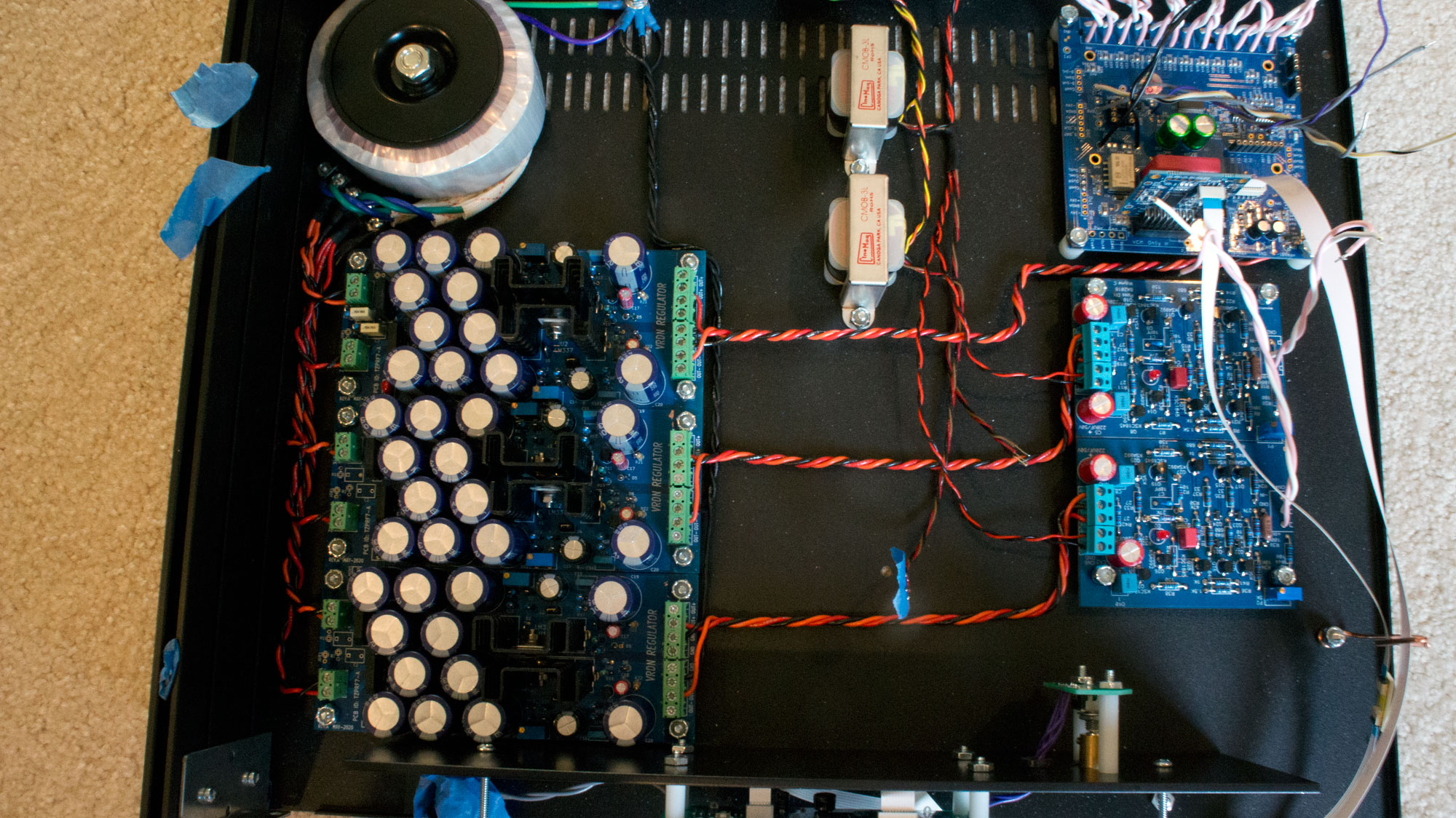

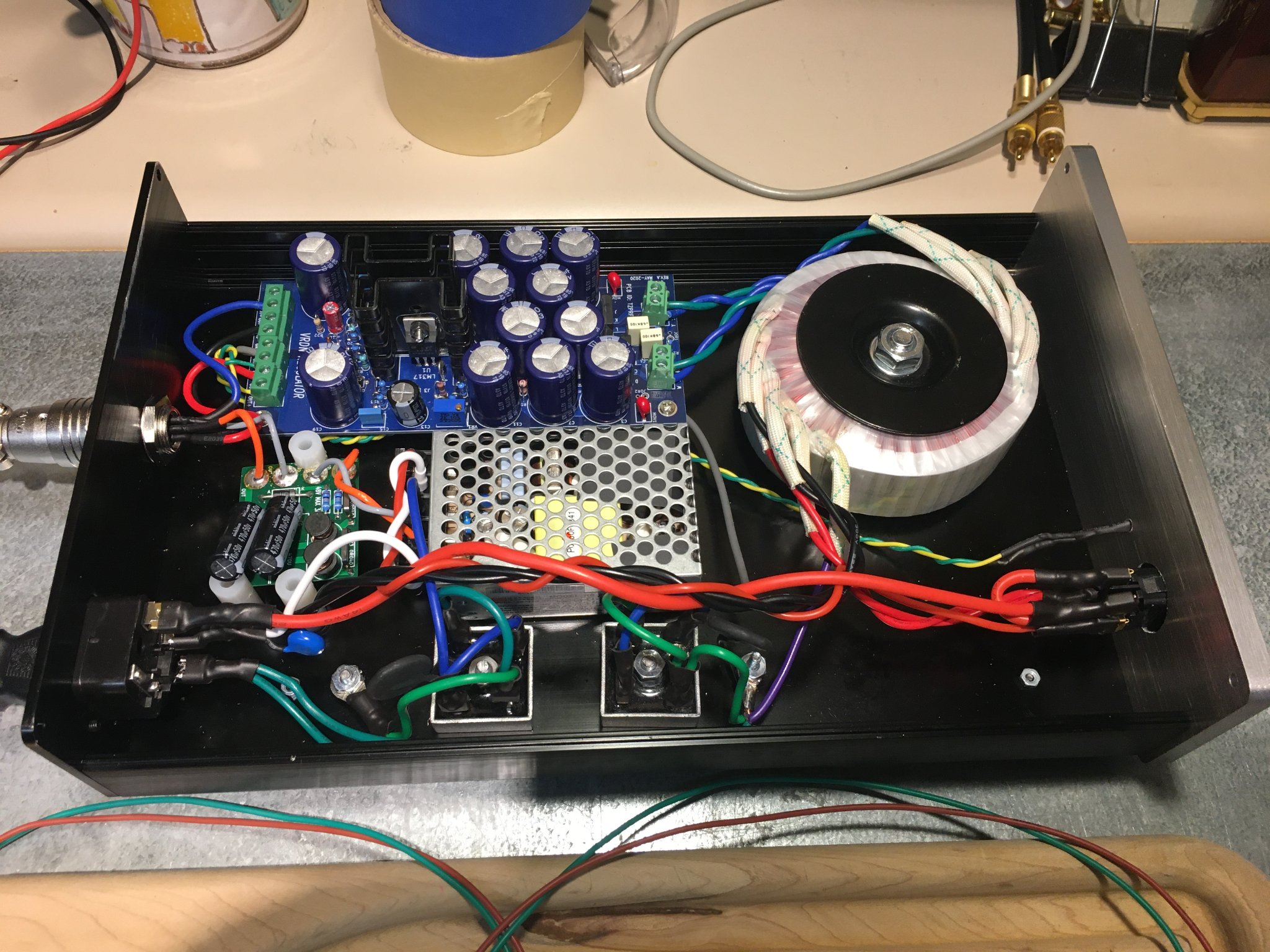

Post pictures of your build. Include pictures that show the whole chassis layout.

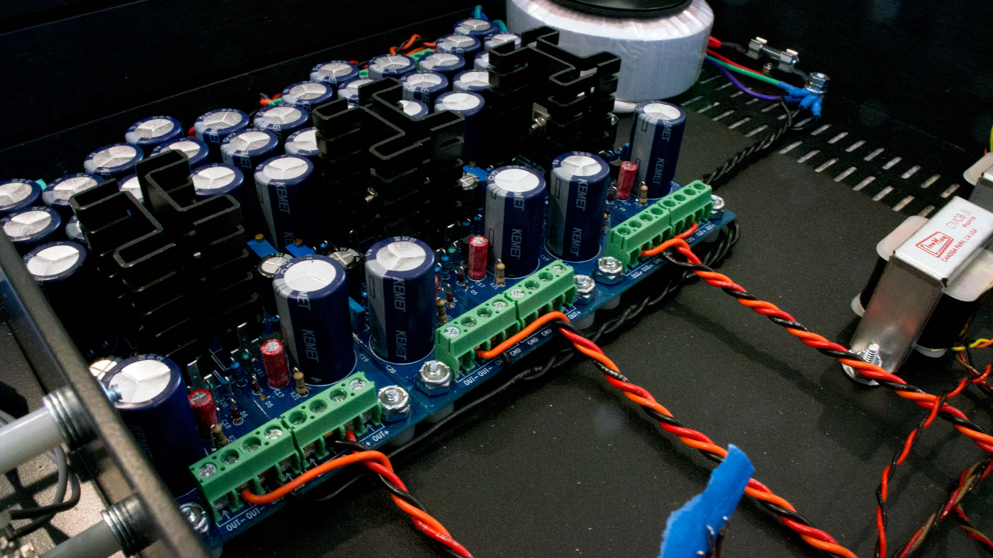

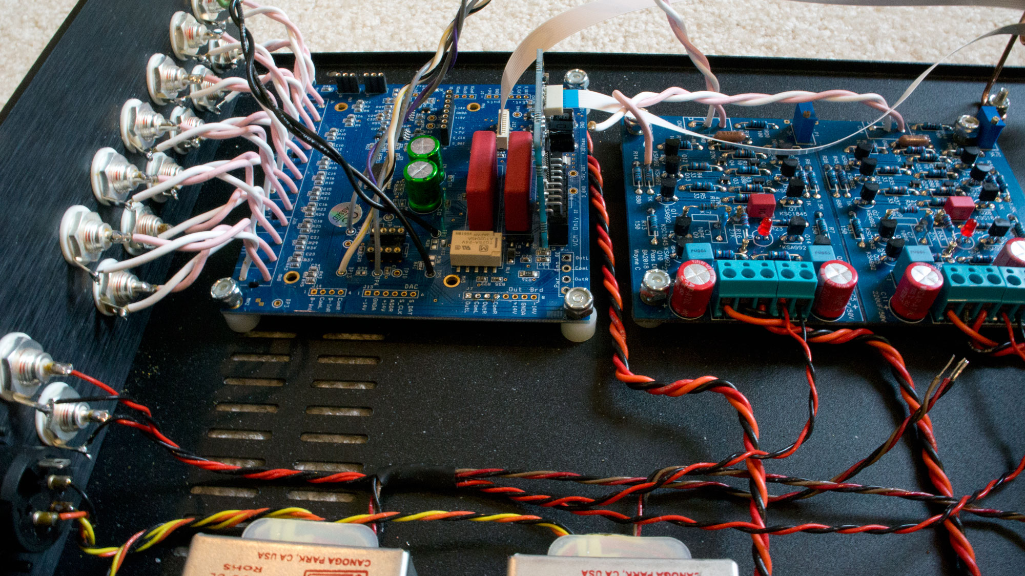

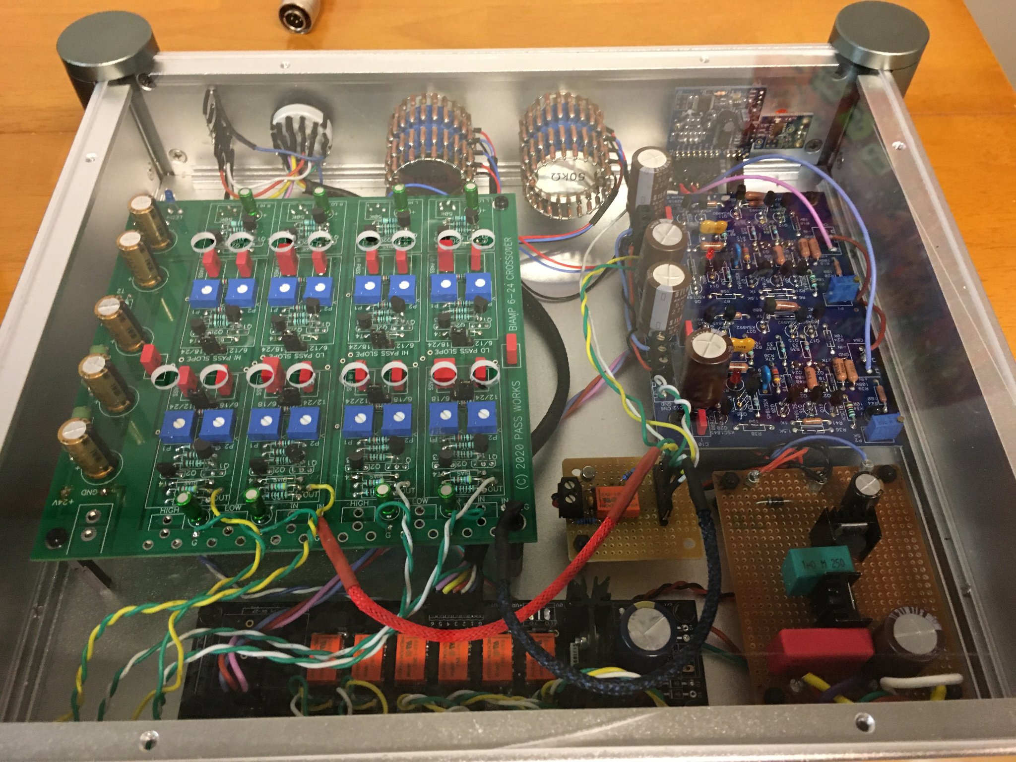

Pics attached. Over the last few days I have tried a number of things, none of which have made any difference to the good old fashioned ground noise.

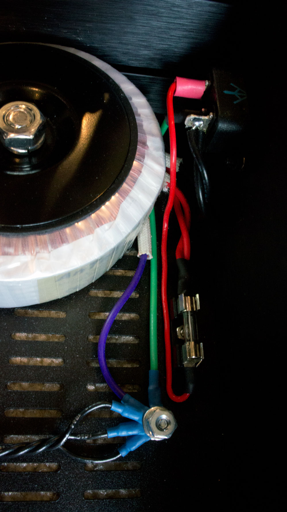

One thing that occurred to me is that the noise happens with and without the ISS board attached, and with and without that board even being powered up. So with the two BA2018 channels running with no inputs I still get noise at the outputs; this suggests to me that my problem may lie with the general power system. The Antek AS0518 purple wire has been connected to chassis ground as seen on the photos, but did I miss something else in the transformer installation? Seems to be a rather straightforward thing to do.
The three VRDNs all test correctly as much as I can tell. The VRDN for the ISS board is set at +/-15V and the two VRDN boards for the BA2018s are set at +/-18V. I did notice that directly on the VRDN boards, with no loads or BA2018 boards connected, 0V to +V showed 0L Ohm, but 0V to -V showed -1.8M Ohm. Seemed a bit odd to me, but in testing the actual output I get the specified +18V and -18V.
Finally, although they appear in the photos, the output transformers are not yet connected to anything,
I'm stumped and wishing I had a 'scope. Thanks for any help or suggestions. More pics? Just ask. thx BH

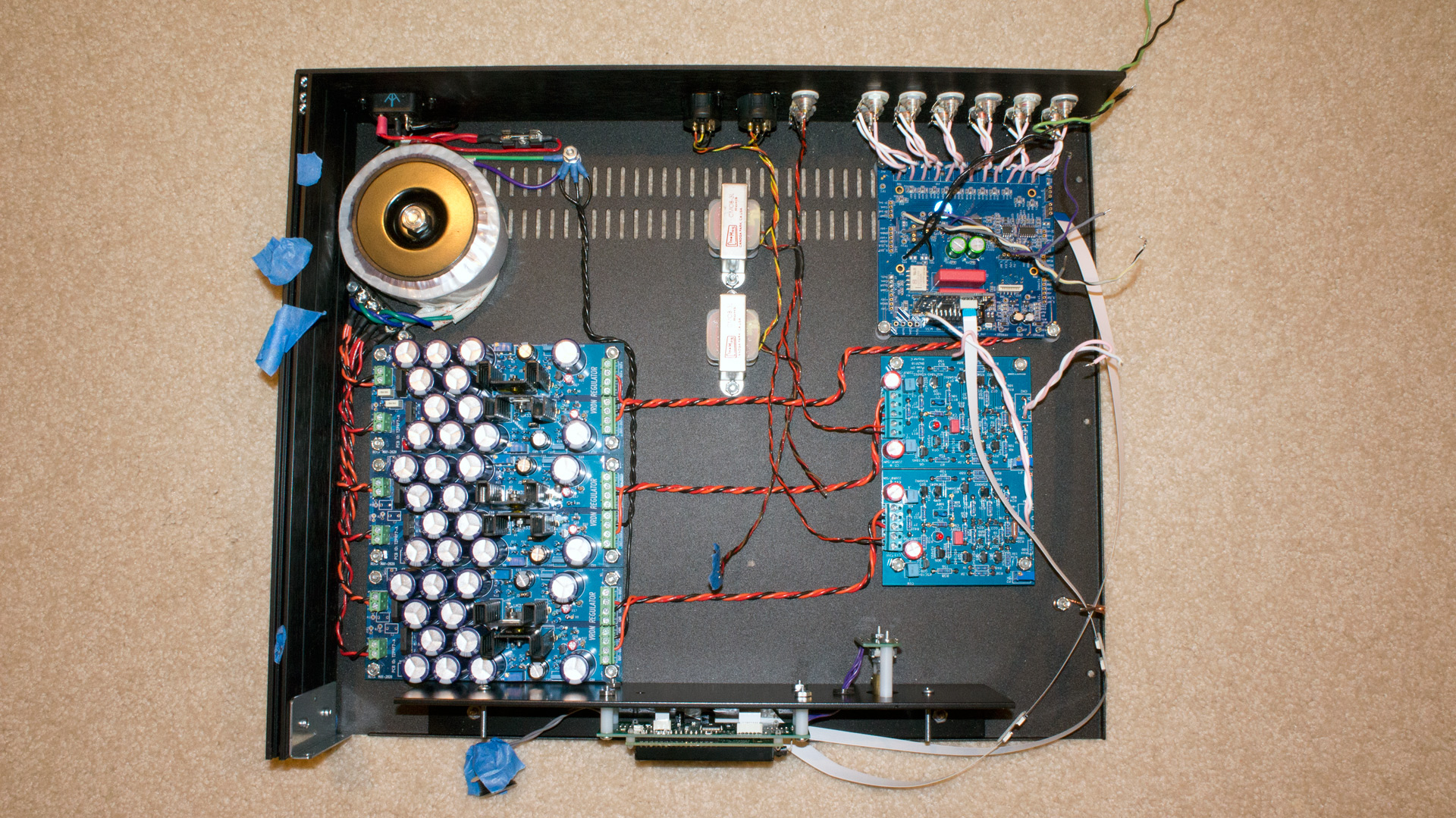

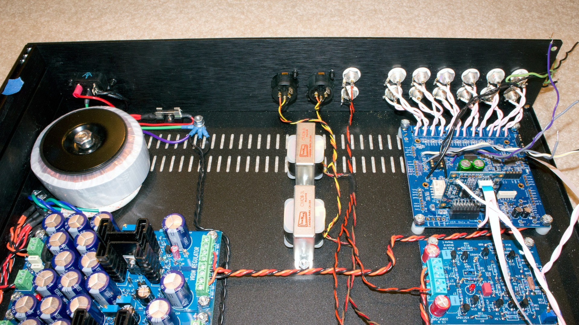

Please post a top view picture showing the whole chassis, including all four sides and their components/switches/connectors. The information is incomplete with the pictures that have been posted.
A few comments based on what I can see:
- The location of the power transformer close to the signal wires, signal transformers, and signal inputs on the back panel is problematic.
- A better location for the power transformer would be at the front left corner of the chassis, and run the AC wires against the left side of the chassis to the power transformer.
- Locate the signal transformers as far away from the power transformer as possible.
-After relocation, rotate the power transformer to find the orientation that produces the least amount of noise.
-After relocation, a transformer shield or steel sheeting to shield the power transformer from the rest of the components may be helpful. An alternate would be to place a steel sheet between the power transformer/power supplies and the audio components. Hopefully though shielding will not be needed.
-Check that the screws attaching the PCBs to the chassis are not shorting the Ground on the PCB to chassis.

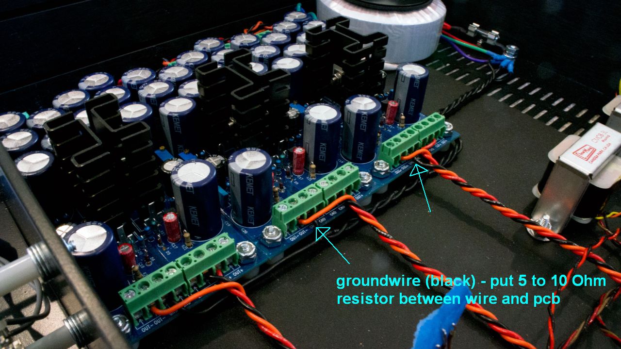

Hello bhjazz,
I fully agree with the tips from Ben Mah.
You could also try a groundloopbreaker. You put a 5 Ohm to 10 Ohm -resistor between the black groundwire (coming from the BA2018 pcb) to your ground on the VRDN-board. Use resistors of minimum 1 W. Do this on both channels. Can be done / checked fast.
Greets
Dirk

You could also try a ground loop breaker.
My last test was to only have the following in play: transformer, two VRDN regulators, both BA2018 channels.
All other components (ISS, front display, input jacks, etc.) were disconnected.
The chassis-mounted output jacks were also disconnected from the BA2018 boards. Instead I used alligator clips to connect the BA2018 outputs to RCA cables, then fed those to a battery-powered headphone amp. The noise remained until I put a finger on the star ground point, then 98% silence unless the amp was turned up to 11. This smells of ground loop...
I'm out of 5 to 10 Ohm 1 watt resistors, but will grab some this week and test.

Here are more pics, as requested. First one is whole chassis, second one is the rear panel, posted for clarity. Front panel only has the display system and the power switch which only operates the Muses/ISS board. That is, when there is power connected: both BA2018 boards get power, and the Muses/ISS board will toggle on or off with a momentary contact switch. Hopefully that's clear.
I agree but this seems like a tradeoff - either isolate incoming AC to the back corner/side and run DC to the rest of the system, or run AC to the front of the chassis and have that line possibly radiating electrical field. I chose the former.
The Antek power transformer radiates a stronger field than the twisted AC wires. That was the reason why I also suggested rotating the transformer as it seems to me that Antek transformers radiate a stronger field from the points where the leads exit the transformer. You can temporarily relocate the power transformer outside of the chassis as a check.

If you have some lower wattage resistors you can still try the resistor ground lift. If there is no fault that causes high current to ground then a lower wattage resistor. Or you can combine some resistors to equal approximately 10R and a total higher wattage. Keep the same minimum setup with only the transformer, regulators, and preamp channels. Place the ground lift resistors between the regulators' output ground and chassis ground.

I have seen ground loop breakers with a 0.1µF cap in parallel. I'm not completely clear about why this might help but is there any reason why I wouldn't want to do the same?
I may have to head that way, mhenschel...
To note: Ben, great ideas from you: don't forget to short the inputs and try a different headphone amp. Both of those helped in tonight's diagnosis. Thank you for calling those out.
So tonight's testing was with a couple of 5W 5 Ohm resistors wired up just like cubicincher had described. Crazy oversized for the task but found them easy enough at the local parts joint.
Right channel, run alone, wow, finally quiet. Add in another resistor to the left channel, power it up and...noise returns to both channels. So geez, there is some dark voodoo going on when two or more VRDNs are up and running. Will ponder off into the darkness...I'm still missing something.
