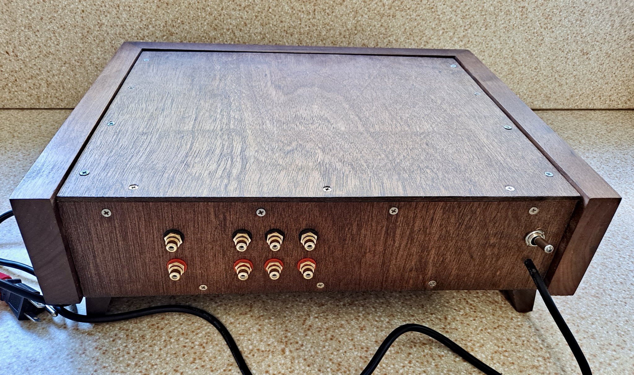

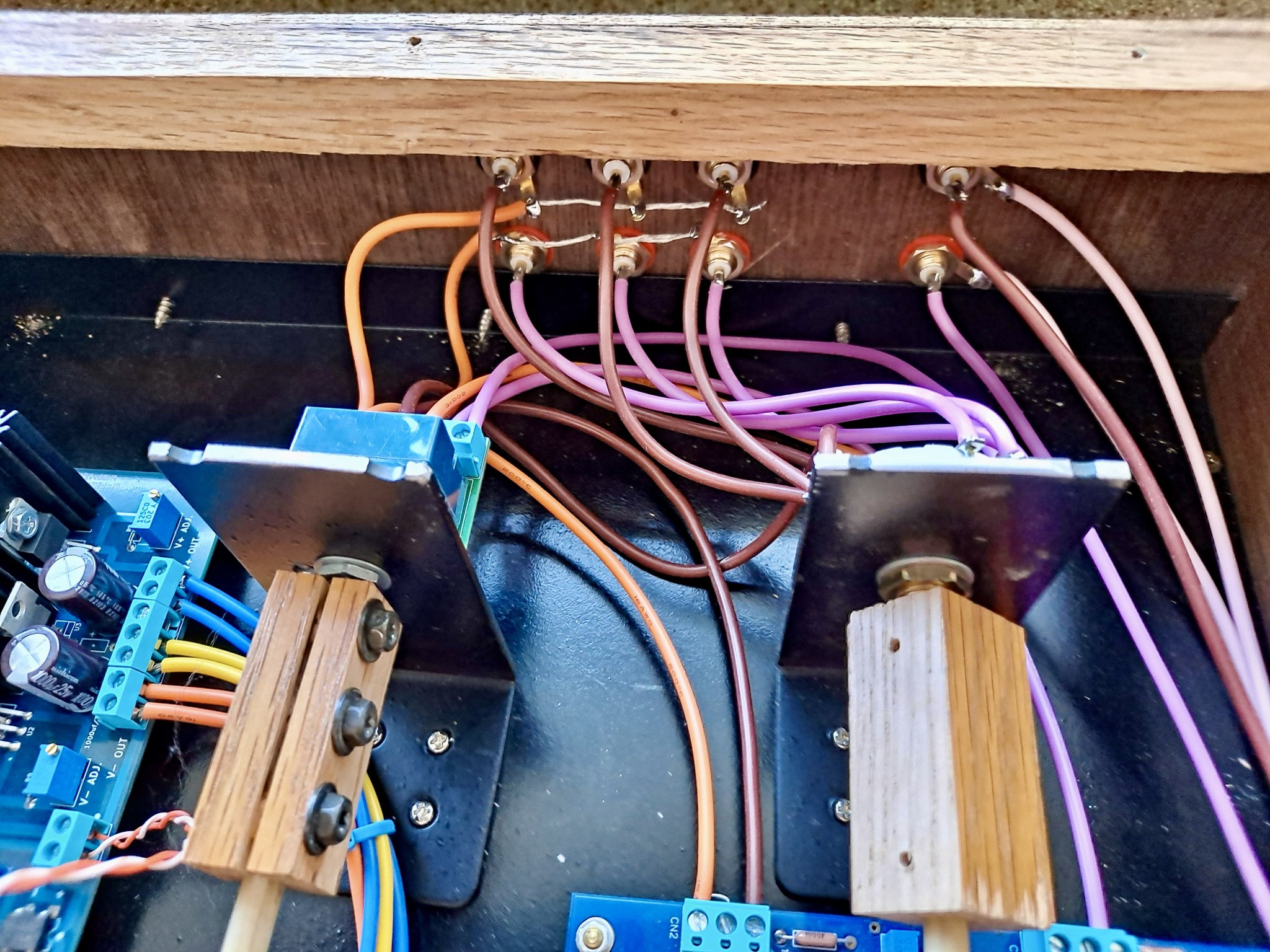

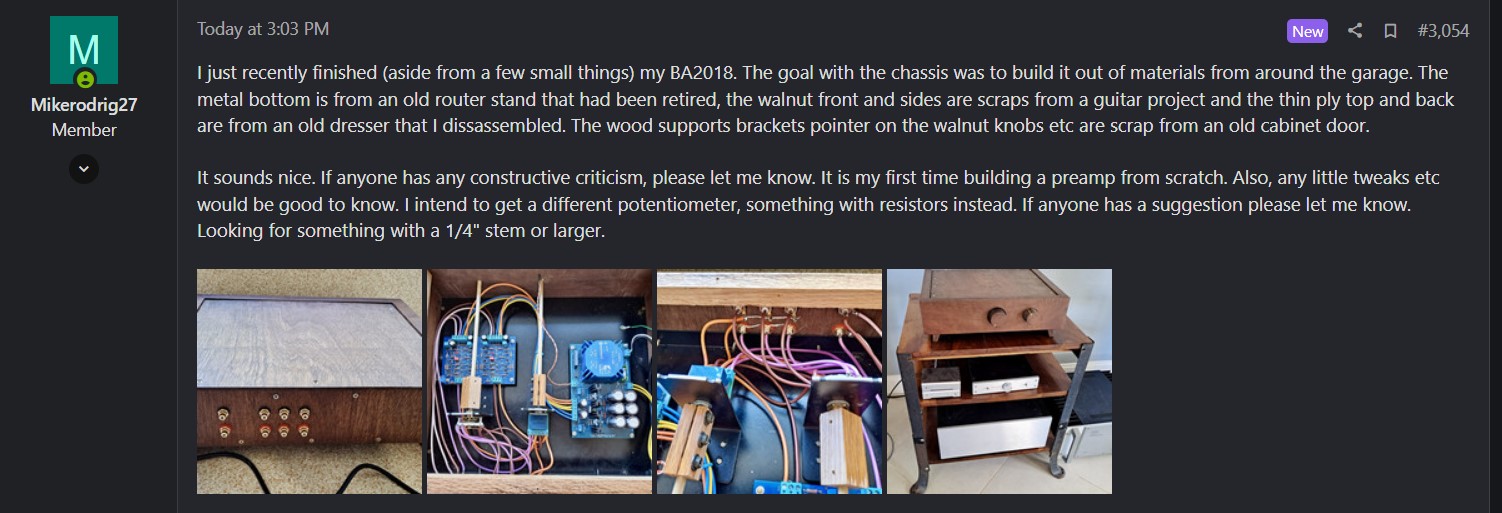

Okay awesome thanks guys I will do that when I get home. I don't think I'll be able to edit the post but I will just repost the pics
Okay, these are the images from my earlier post #3054. I uploaded them on DIYaudio so that they won't get lost as suggested. Thanks for everything guys!
View attachment 1005755View attachment 1005756View attachment 1005757View attachment 1005758

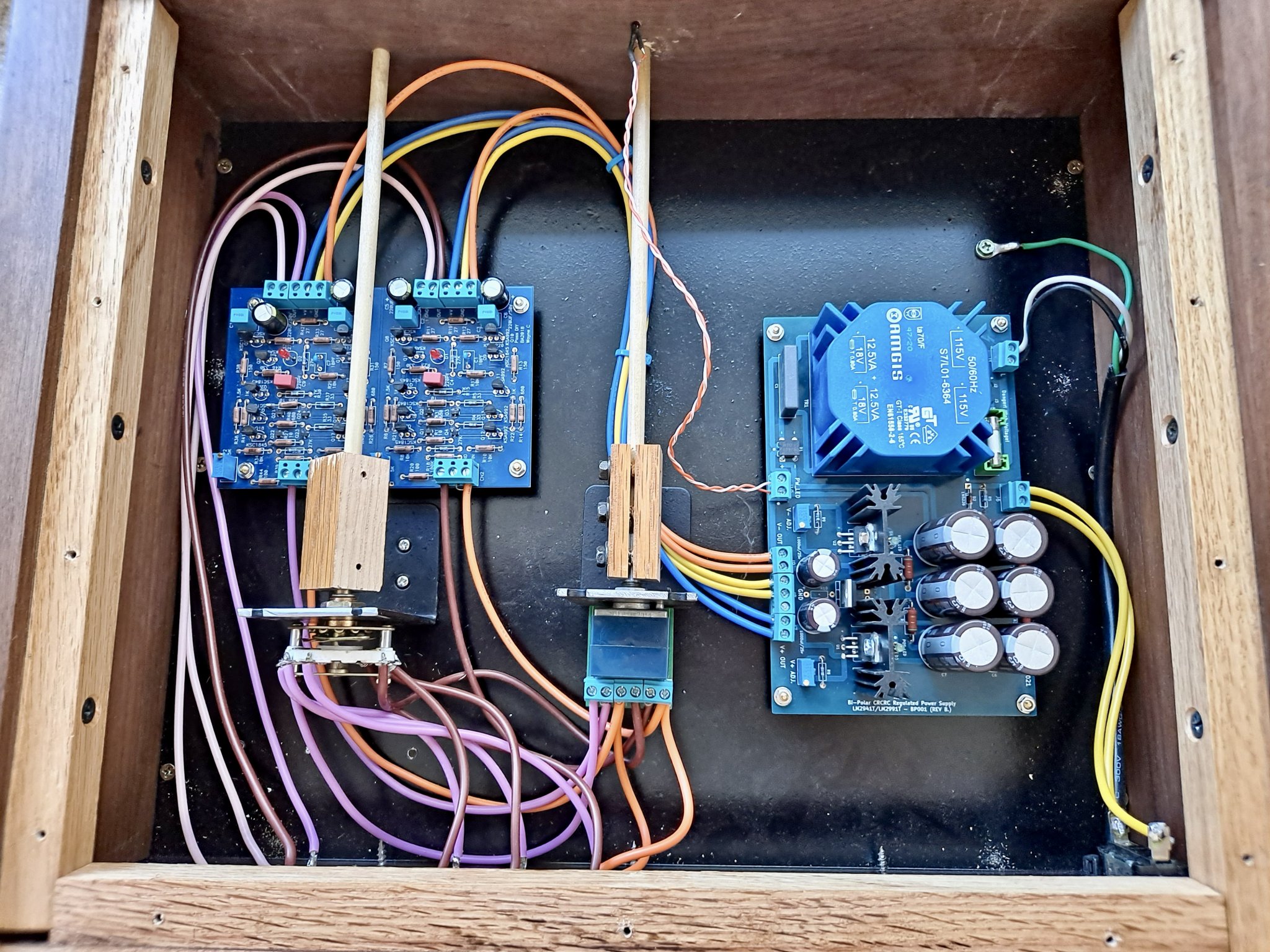

What are the wooden looking pieces in the two middle internal shot photos? Thanks.

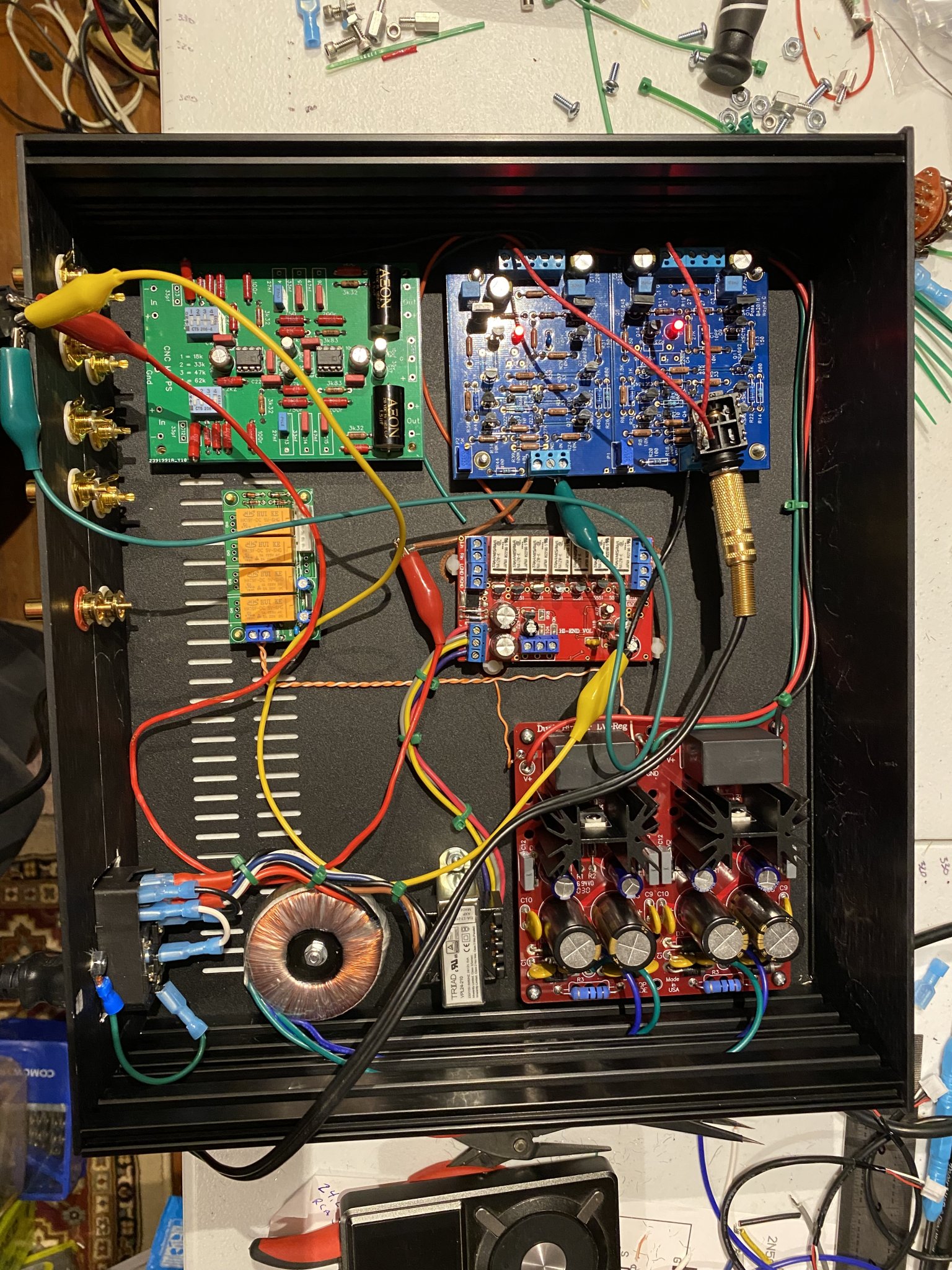

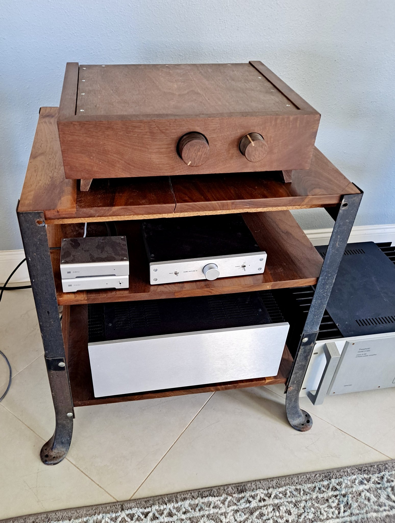

Hey Now,
Another one lives. I’m pleased to say it worked perfectly from first power up. Adjusted DC offset and it’s been playing ever since. Amazing sound. It’s just jury rigged at the moment. I’m making it as a gift for my son, a nice little four input w/ MM phono, relay volume and selector. Finished power wiring so on to ins and outs. Boy it does sound good, you know it when you find yourself listening to a known track and hearing it like with fresh ears.
Zen,shaft couplers
Thanks for the info.
Going back and looking at the photos it is now clear, the one on the left (third pic), I can see how it is coupled, but the one on the right still looks like a cover to me. But since you have the brains, I will go with what you stated.
The one on the left for the for the volume pot was for a splined shaft. The input switcher had a shaft with a flat spot on, like how you would use a set screw to drive into. On the other side of the block are two screws, one to go into the wood shaft and one to hit the flat spot on the input selector shaft.
I hope that makes sense.
Billyk, that looks like it is going to be a very nice preamp. I bet your son ends up really liking it.

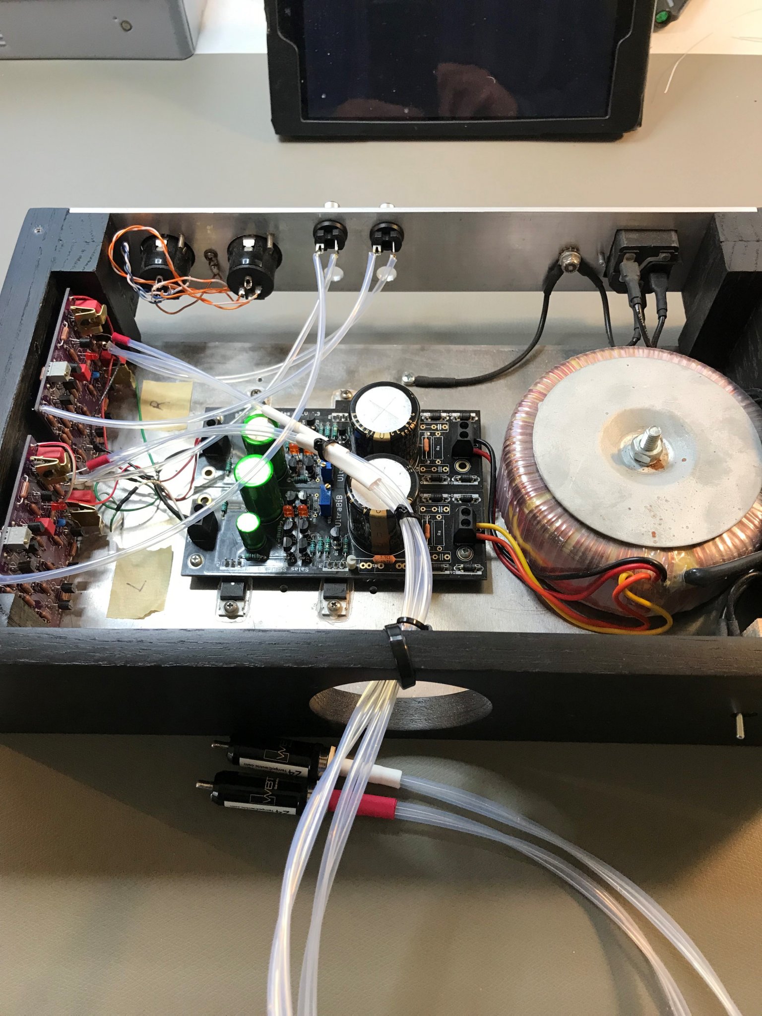

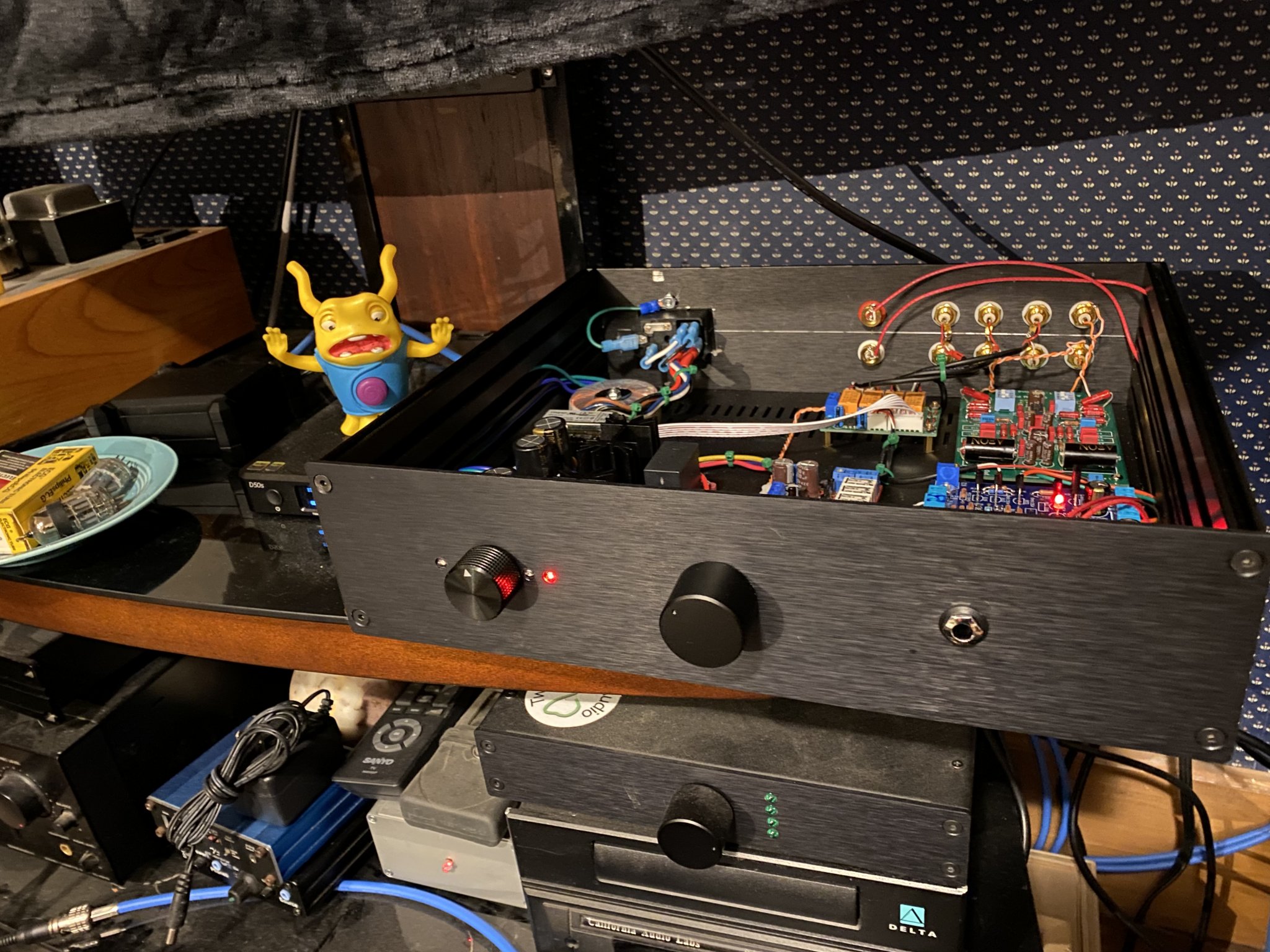

Just a quick revision on my linestage. Aquired some certified pre-owned Tempo Electric Big Twist solid silver interconnects (24 gauge). Needed a different length so went ahead and did a teardown and rebuild to work with my pre. Used some 11 gauge semi-clear Teflon jacket, because I liked the look mainly, and works well inside and out. No impressions yet, system always sounds weird for awhile as things settle back in after changes like this... No volume control or input switching needed for my own use, only need the extra gain for my amps. Linestage looks ugly, but is hidden behind my monoblocks anyhow. Plan to do a full dual mono renovation someday, in a larger chassis.

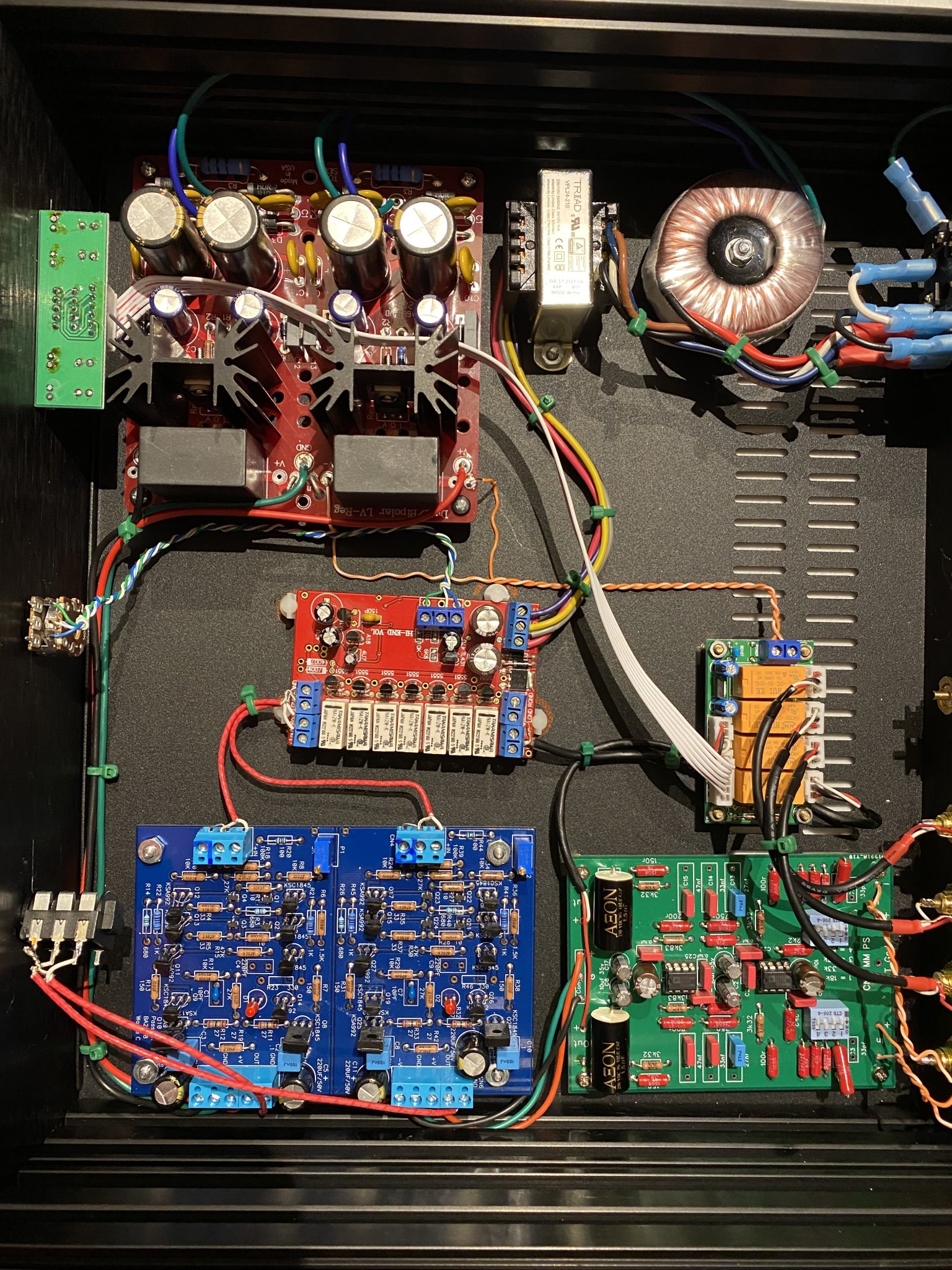

All done but for some tidying up here and there. Oh and a TT ground binding post I forgot about.
All but the output cabling from the jack to the RCAs in the back.
Here it is playing beautiful music. Wow I’m very happy with the sound. I’m going to compare them all this, Korg B1, ACP+. WooHoo.
