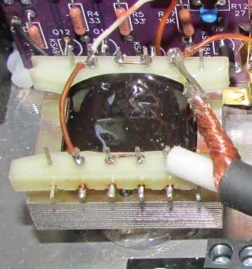

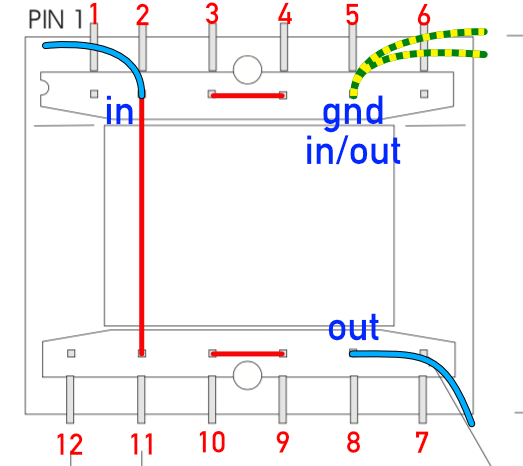

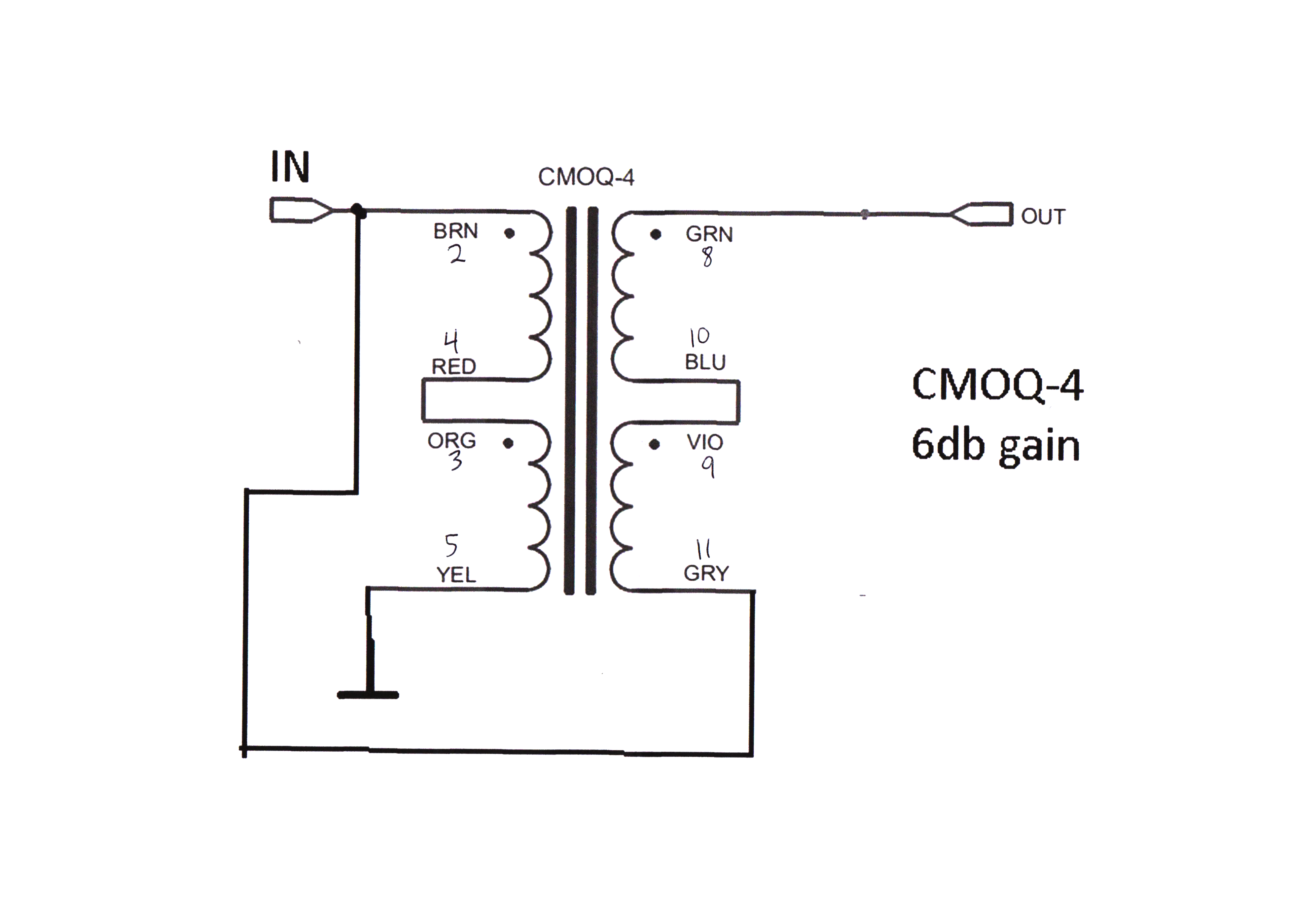

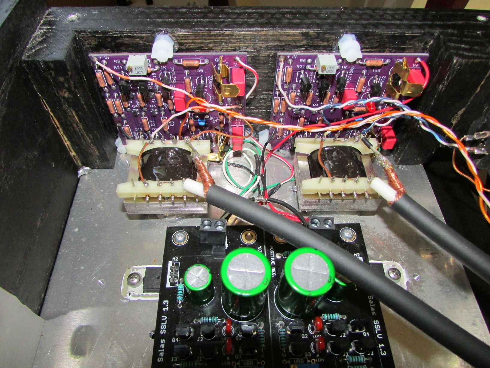

Just to confirm the wiring…
Hi William and all others
Sorry to bother you with this again, but...
I am finally trying to follow your footsteps and hooking up the cinemags.
Thanks for sharing all the infos...
I'm a bit stuck in trying to relate the picture of your work with the schematic...
Attached are

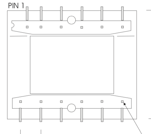

drawing of the CMOQ-4, viewed from underside
wiring diagram (which you provided)
2 pics of how you did it...
The wire-bridges on the CMOQ-4 are obvious. But I am not sure about the input/output…
- INPUT (from line-stage) is at pin 2
- OUTPUT (to output-connector) is at pin 11
- GND (both from input + output are at pin 5
Is this the way to go?
(I still don't "feel" schematics, so the gap between the looks of the real transformer and its schematic representation make me feel dizzy... took me 3 days to understand the pin-numbers run clockwise around the thing, and not in two rows left-to-right)

Hi David, I will try to edit the transformer drawing to hopefully make it more clear. I'm at work right now so it will be later on today. Output connector goes to pin 8. There are three jumper wires on the transformer, as seen on my picture you attached there: 3-4, 9-10, and 2-11. And yes, you are correct, all grounds go to pin 5.
