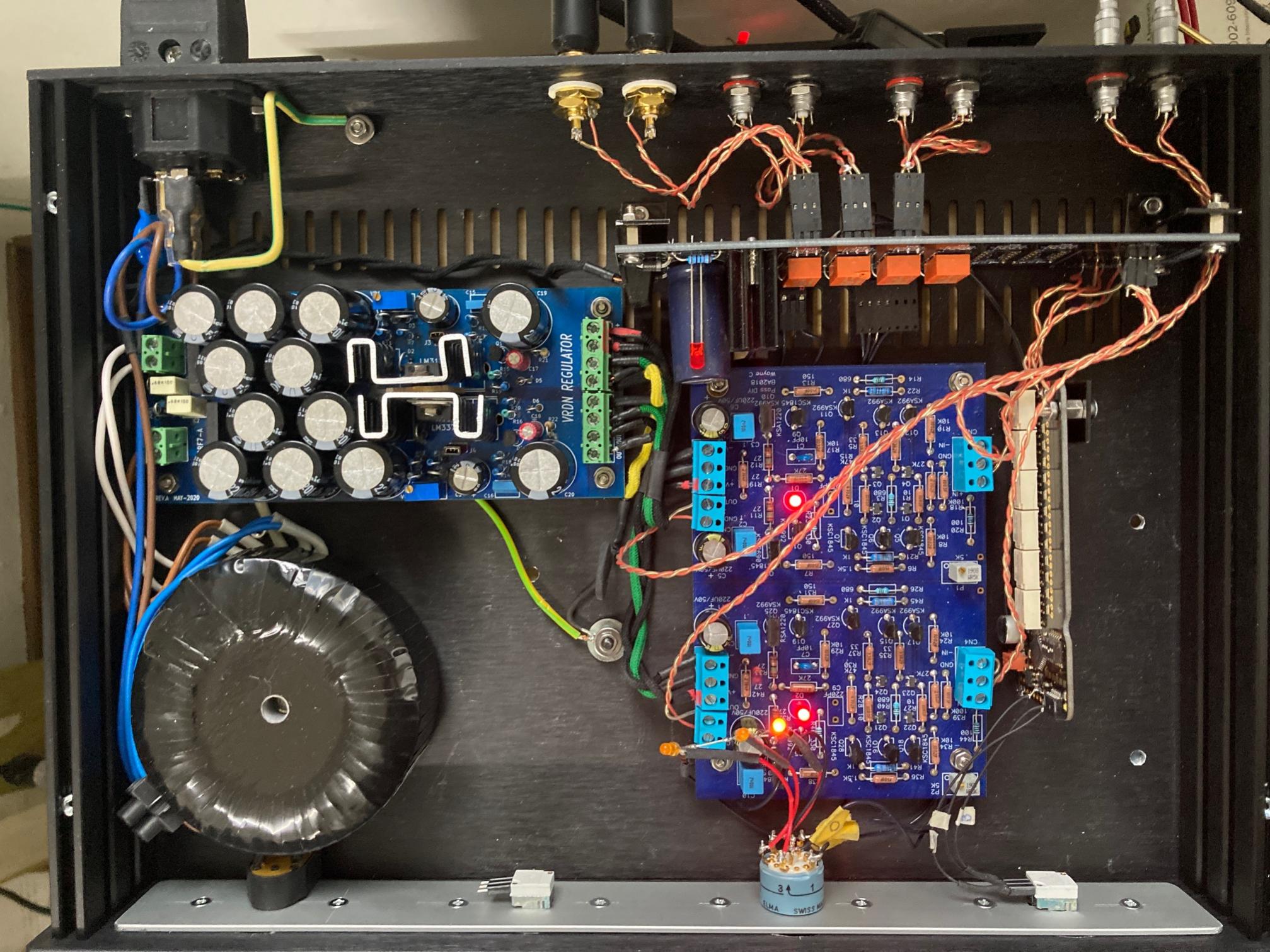

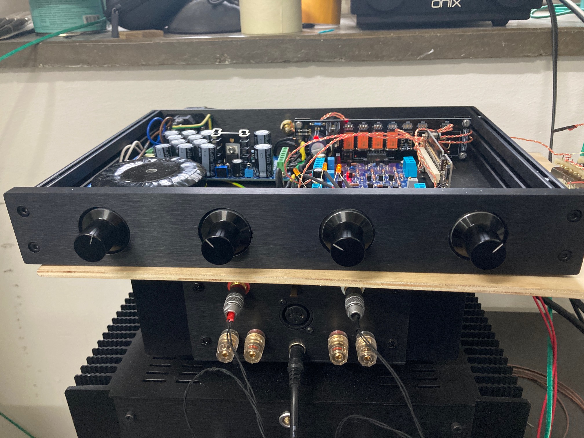

ah, and of course, the pics...
wiring still a rat's nest, and the layout, well, is working. Could have been much much nicer...
My first chassis-work, or second preamp after dcb1, and 4th build, 5th when counting bugle2.
the second, empty knob will be the output-selector, HP—0dB—16dB
Headphone-connector still missing...

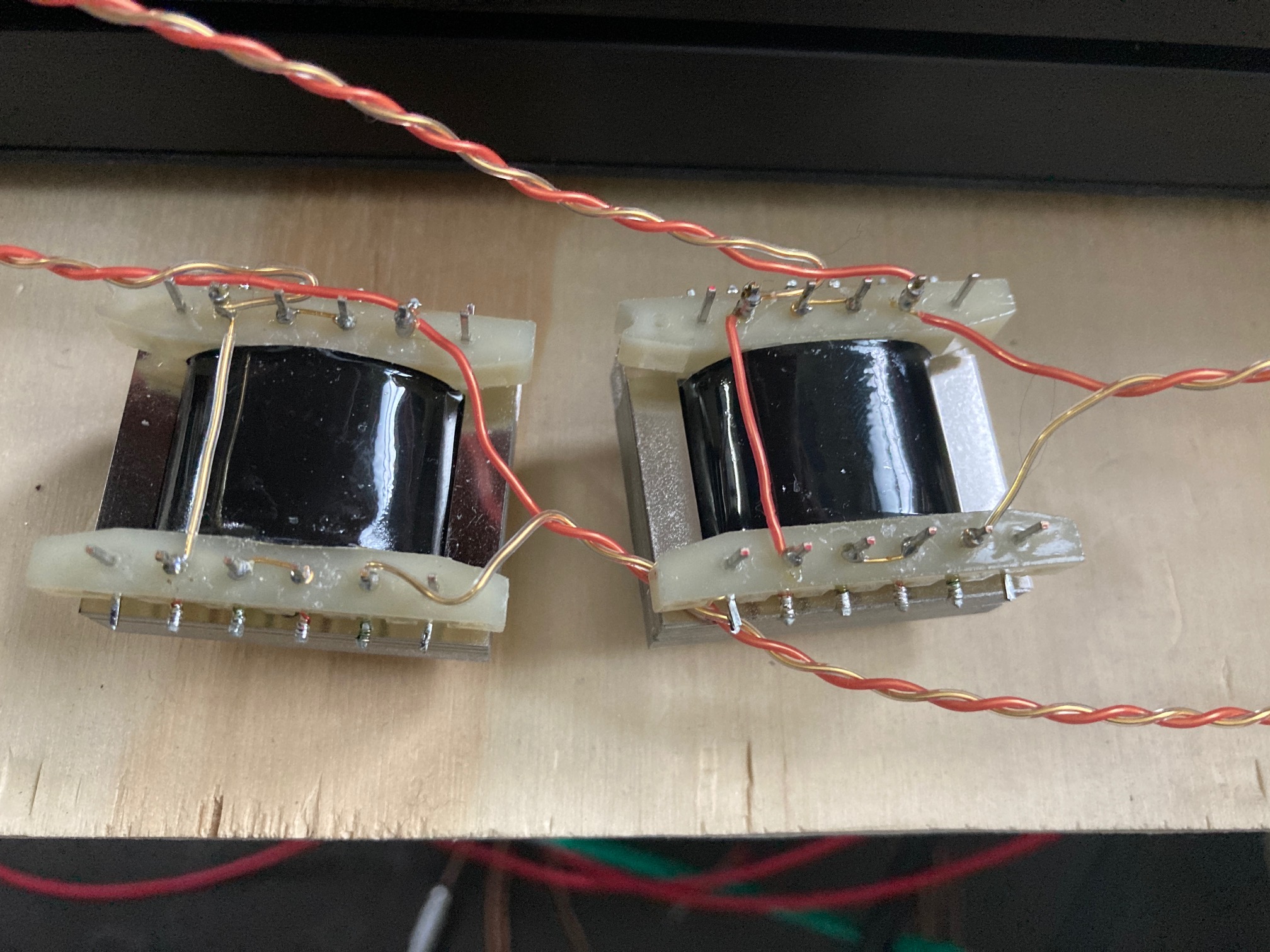

Any reason you guys are using the Cinemag transformers for 1:2 (6dB step up gain) when you can set various gains (by adjusting R16/R17 ratio) on the WBA2018 anyway?
https://www.diyaudio.com/forums/gro...fier-hpa-melbourne-db-buy-56.html#post5819841
Perhaps galvanic isolation or just cause you have a pair of Cinemag's you'd like to use...

I had Jensen's on my F6 not being used. So I carefully extracted those from the pcb's to try this autoformer thing I kept seeing here for some extra gain. With the BA2018 and the F4, I needed just a little more gain, but with my shiny new VFET amp I do not need that extra 6db. So I quickly found out to just jumper past the autoformer with that pairing. Why? I just like experimenting I guess. Wayne's preamp has a nice low output impedance, and my other amps are easy to drive. Why not? And signal iron is "cool".😎
