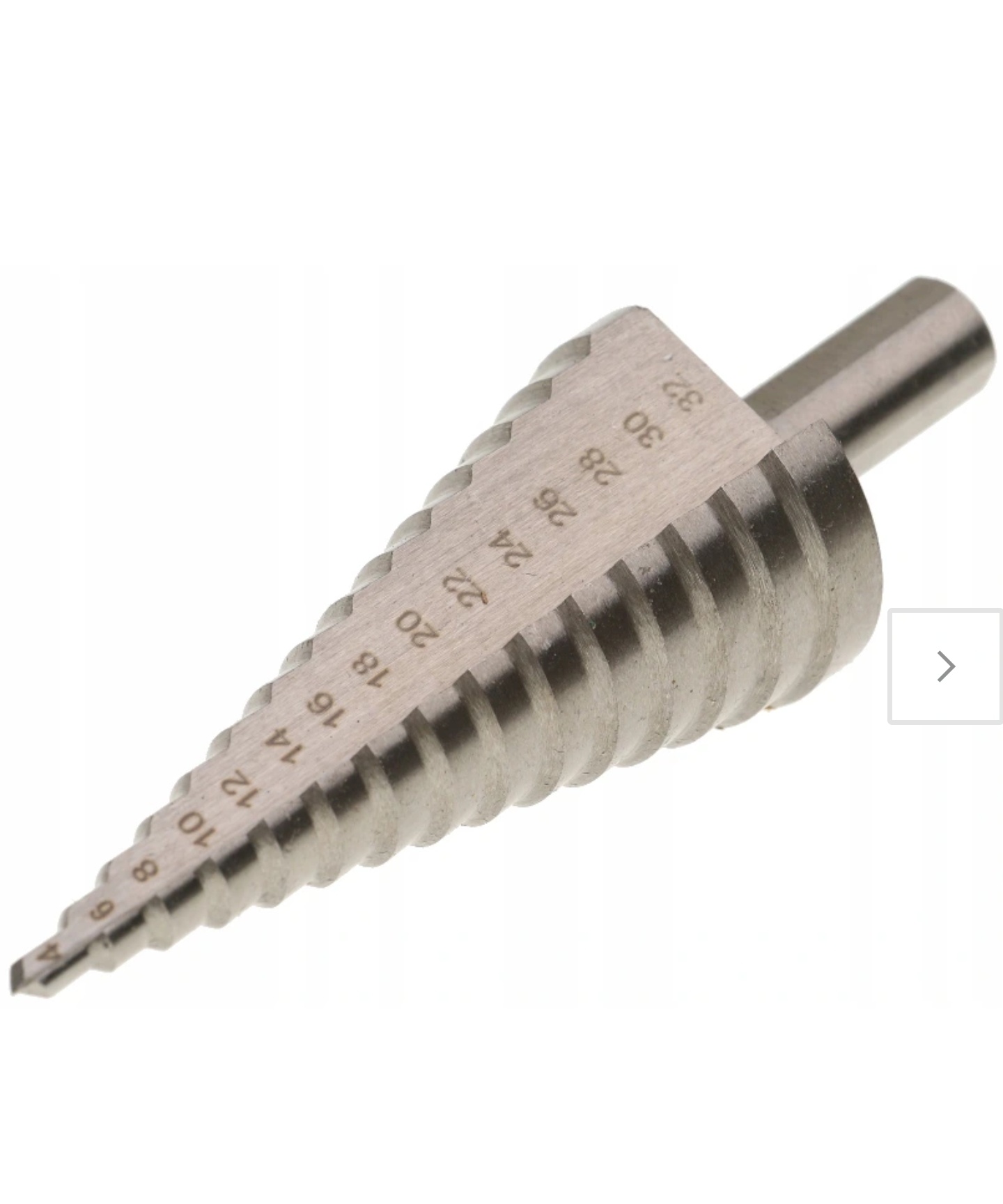

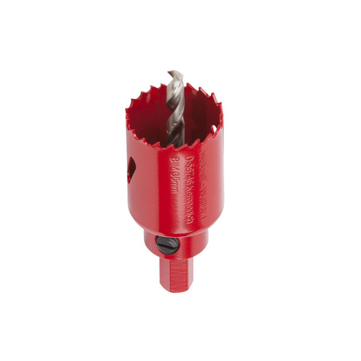

Am working the front-plate... since yesterday.
If anyone ever tried to cut a 30mm hole into a 100 aluminium-plate with a hand-drilling machine, chapeau! (If not, it's a hard job, believe me).
And then, right on the first hole, the 2.5mm drill-bit I was using as "lead" for the following bigger ones got stuck and broke apart. Had to fret saw around it and "recreate" a properly centered hole to be able to keep the frontplate. Now I'm at hole N° 3, the hard part still in front of me ...
I only did that once. The multi day agony of that experience, convinced me that a low priced "tabletop drill press" from Amazon, would save me so much time and prevent so much misery, that it was worth far more than the USD 120 selling price. I've never regretted the purchase.
