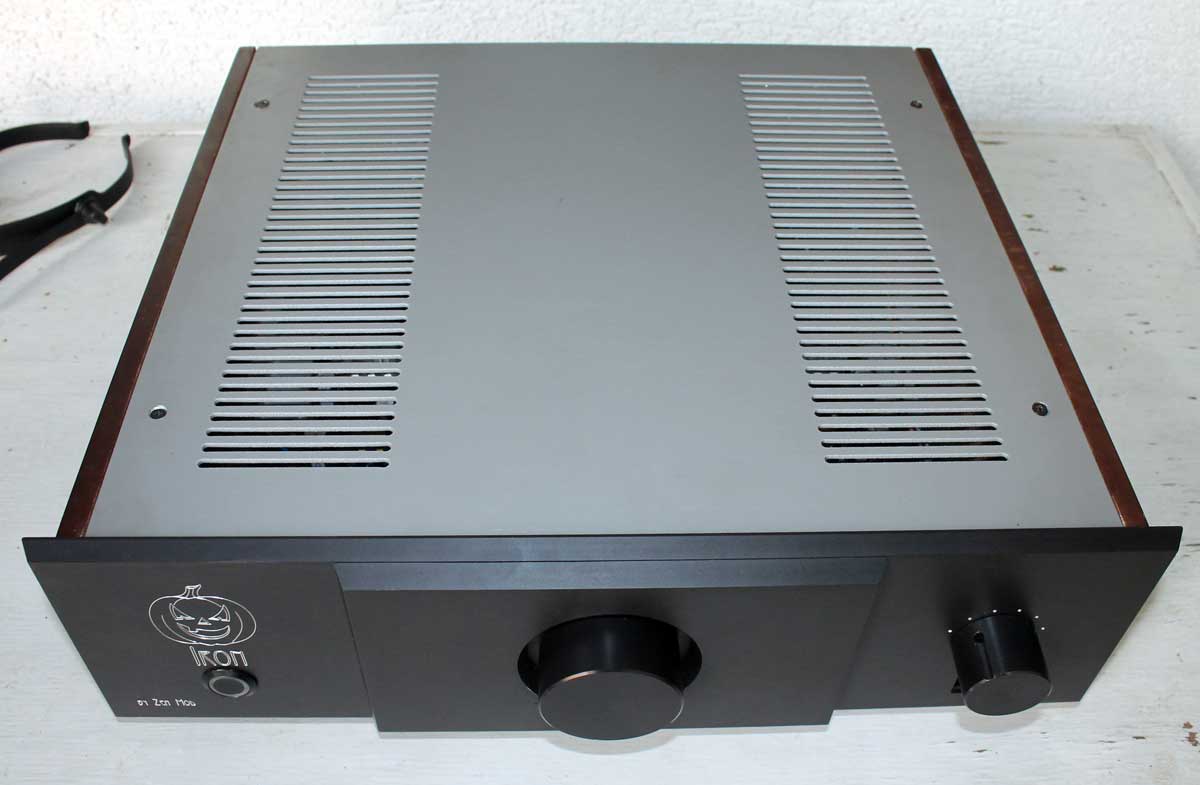

looking back..
Gawd, this thing is beautiful....
