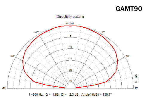

I have AM35 which is "home" version of TPL150. Very natural sounding but limited vertical dispersion, highly recommended. Haven't used with a horn. GAMT90 at 800Hz below. For good dispersion use JMLC-1000 with LCY ribbon.

Hi Jacek,
Thanks a lot for your reply. Do I read the graph correctly, if it shows that horizontal is app. 80° at 800 Hz?
