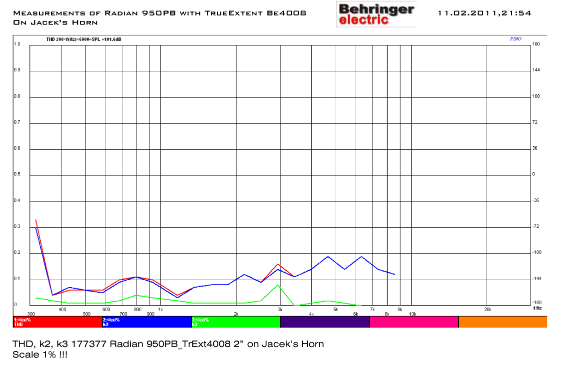

I have been in communication with a local driver designer here in Australia that wont even consider compression drivers because of their distortion levels.
Distortion level of Radian 950PB/Truextent in JMLC-350 at 101.6dB.

Distortion.
Wow that is good. I want to buy radian drivers next. Cant afford the flash frams though.Tar for that.
Most compression drivers are like that.Wow that is good. I want to buy radian drivers next. Cant afford the flash frams though.Tar for that.

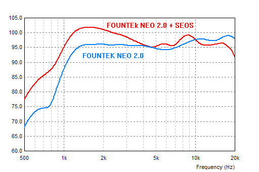

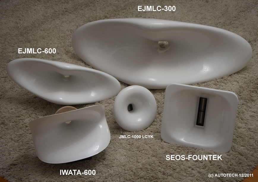

New horns: Iwata-600, EJMLC-600, SEOS-FOUNTEK (Neo 2.0), JMLC-1000 LCYK (LCY ribbbon).
Beautiful E horns. Have you had a chance to listen to the ribbons much yet?
Any consideration to making a waveguide for the BG Neo3? Would make an already excellent driver near-perfect.

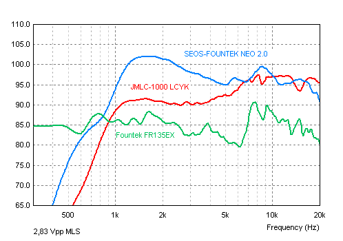

Sensitivity comparison.

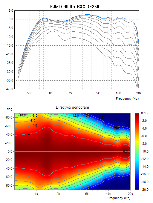

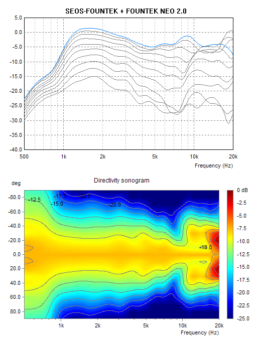

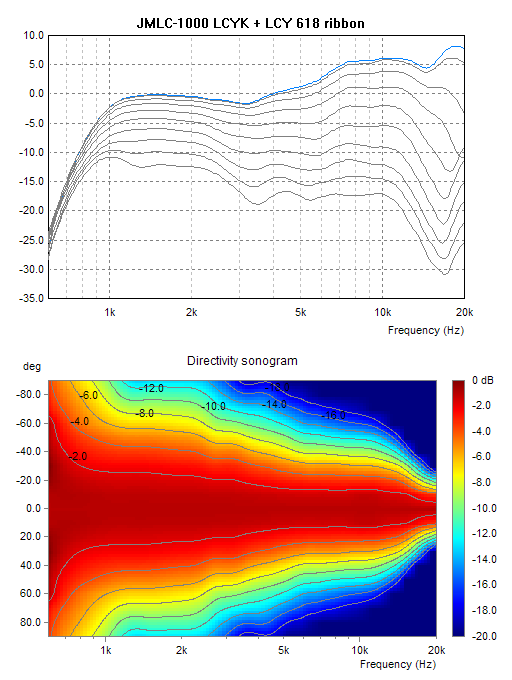

Gorgeous results on the LCY ribbon!
How so?
The directivity variation w/freq is nice and smooth, but decreasing, i.e. not CD.
How so?
Not to speak for John, but that those horns seem to be shaped to beam. So the driver's doing what it's technically supposed to do on that horn.
That does have me wondering what such a driver would look like on a OS waveguide, though I suspect it would ultimately be too fragile and not go low enough to be useful.
